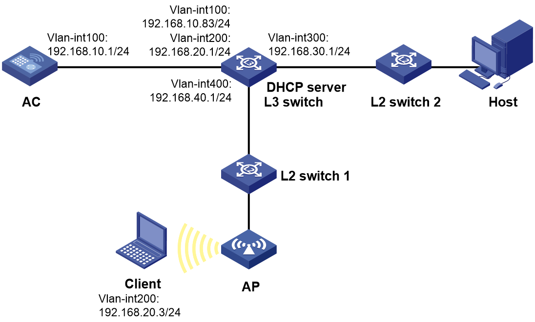

Example: Configuring an AP to associate with the AC at Layer 3
As shown in Figure 1, the AC is attached to the Layer 3 switch and the Layer 3 switch acts as a DHCP server to assign IP addresses to the AP, client, and host. Assume centralized forwarding is used in this example.
Configure the following settings for the client to communicate with the host:
·     Configure the client to access the WLAN through VLAN 200, and the host to access the network through VLAN 300.
·     Assign the AC to VLAN 100 and the AP to VLAN 400, and configure the AC to establish tunnels with the AP through a Layer 3 network.
·     Configure Layer 2 switch 1 to supply power to the AP through PoE.
Figure 1 Network diagram
Analysis
·     For the AP, the client, and the host to obtain IP addresses through DHCP, enable the DHCP server feature on the Layer 3 switch.
·     For the AC to reach the Layer 3 switch, configure a static route on the AC with the Layer 3 switch as the next hop.
·     For the AP to establish tunnels with the AC, configure the DHCP server to send the AC's IP address to the AP through DHCP Option 43.
·     For Layer 2 switch 1 to supply power to the AP, enable PoE on the switch.
·     For the client to access the network, configure wireless services on the AC.
When you configure AP's association with the AC at Layer 3, follow these restrictions and guidelines:
·     Use the serial ID labeled on the AP's rear panel to specify an AP.
·     Configure the switch's interface that connects Layer 2 switch 1 to the AP as an access port.
