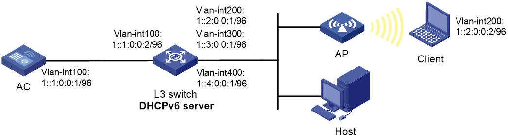

Example: Configuring an AP to associate with the AC at Layer 3 (IPv6)
As shown in Figure 1, the AC acts as a DHCPv6 server to assign IPv6 addresses to the AP, client, and host. Assume centralized forwarding is used in this example.
Configure wireless services to enable the client to access the wireless services and communicate with the host.
Figure 1 Network diagram

 service-template enable
 port link-type trunk
 undo port trunk permit vlan 1
 port trunk permit vlan 100 200
ipv6 route-static 1::4:0:0:0 96 1::1:0:0:2
wlan ap ap1 model WA6320
 serial-id 219801A28N819CE0002T
 wlan ap-group group1
 ap ap1
 ap-model WA6320
radio 1
  radio enable
  service-template 1 vlan 200
 radio 2
·     Layer 3 switch:
vlan 100
vlan 200
vlan 300
vlan 400
ipv6 dhcp pool 1
 network 1::2:0:0:0/96
ipv6 dhcp pool 2
network 1::3:0:0:0/96
ipv6 dhcp pool 3
 network 1::4:0:0:0/96
 option 52 hex 00010000000000000001000000000001
interface Vlan-interface100
 ipv6 address 1::1:0:0:2/96
interface Vlan-interface200
 ipv6 dhcp select server
 ipv6 dhcp server apply pool 1
 ipv6 address 1::2:0:0:1/96
 ipv6 nd autoconfig managed-address-flag
 ipv6 nd autoconfig other-flag
 undo ipv6 nd ra halt
interface Vlan-interface300
 ipv6 dhcp server apply pool 2
 ipv6 address 1::3:0:0:1/96
interface Vlan-interface400
 ipv6 dhcp server apply pool 3
 ipv6 address 1::4:0:0:1/96
 port trunk permit vlan 200 400
 port trunk pvid vlan 400
 port access vlan 300
Related documentation
·     AP and WT Management Command Reference in H3C Access Controllers Command References
·     AP and WT Management Configuration Guide in H3C Access Controllers Configuration Guides
·     Network Connectivity Command Reference in H3C Access Controllers Command References
·     Network Connectivity Configuration Guide in H3C Access Controllers Configuration Guides
