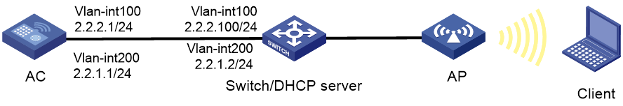

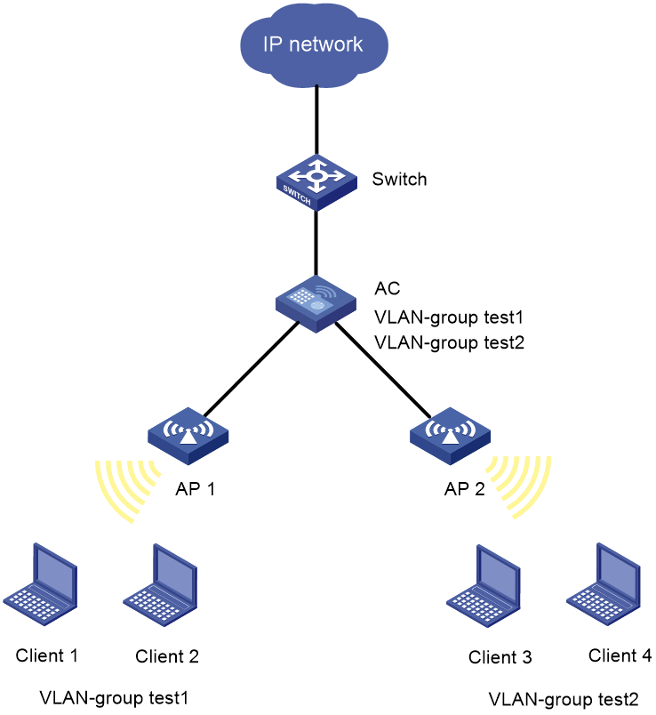

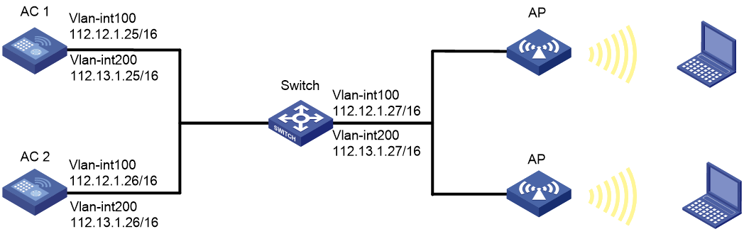

Network requirements
As shown in Figure 1, the APs connect to AC 1 and AC 2 through the switch and the APs provide wireless service for clients. Set the SSID to service and enable AP license synchronization on AC 1 and AC 2. The two ACs back up licenses for each other.
When the master AC fails, the backup AC will take over and becomes the new master AC. The licenses synchronized to the new master AC will be valid for a 30-day grace period.

Configuring the switch
# Create VLAN 100 and VLAN 200. The switch will use VLAN 100 to forward the traffic on CAPWAP tunnels between the AC and APs, and will use VLAN 200 to forward client traffic.
<Switch> system-view
[Switch] vlan 100
[Switch-vlan100] quit
[Switch] vlan 200
[Switch-vlan200] quit
# Configure GigabitEthernet 1/0/1 that connects the switch to the AC 1 as a trunk port.
[Switch] interface gigabitethernet1/0/1
[Switch-GigabitEthernet1/0/1] port link-type trunk
# Remove the trunk port from VLAN 1, and assign the port to VLAN 100 and VLAN 200.
[Switch-GigabitEthernet1/0/1] undo port trunk permit vlan 1
[Switch-GigabitEthernet1/0/1] port trunk permit vlan 100 200
[Switch-GigabitEthernet1/0/1] quit
# Configure GigabitEthernet 1/0/2 that connects the switch to the AC 2 as a trunk port.
[Switch] interface gigabitethernet1/0/2
[Switch-GigabitEthernet1/0/2] port link-type trunk
[Switch-GigabitEthernet1/0/2] undo port trunk permit vlan 1
[Switch-GigabitEthernet1/0/2] port trunk permit vlan 100 200
[Switch-GigabitEthernet1/0/2] quit
# Configure the interface GigabitEthernet 1/0/3 that is connected to APs as an access port, and assign the port to VLAN 100.
[Switch] interface gigabitethernet1/0/3
[Switch-GigabitEthernet1/0/3] port link-type access
[Switch-GigabitEthernet1/0/3] port access vlan 100
# Enable PoE on GigabitEthernet 1/0/3.
[Switch-GigabitEthernet1/0/3] poe enable
[Switch-GigabitEthernet1/0/3] quit
# Specify 112.12.1.27/16 as the IP address of the VLAN 100.
[Switch-Vlan-interface100] ip address 112.12.1.27 16
# Specify 112.13.1.27/16 as the IP address of the VLAN 200.
[Switch] interface vlan-interface 200
[Switch-Vlan-interface200] ip address 112.13.1.27 16
[Switch-Vlan-interface200] quit
# Enable DHCP.
[Switch] dhcp enable
# Create DHCP IP pool 100 to assign IP addresses to APs, and specify the IP address range for the IP pool.
[Switch] dhcp server ip-pool 100
[Switch-dhcp-pool-100] network 112.12.0.0 mask 255.255.0.0
# Specify gateway IP address 112.12.1.27 in the DHCP IP pool.
[Switch-dhcp-pool-100] gateway-list 112.12.1.27
[Switch-dhcp-pool-100] quit
# Create DHCP IP pool 200 to assign IP addresses to clients, and specify the IP address range for the DHCP IP pool.
[Switch] dhcp server ip-pool 200
[Switch-dhcp-pool-200] network 112.13.0.0 mask 255.255.255.0
# Specify gateway IP address 112.13.1.27 in the DHCP IP pool.
[Switch-dhcp-pool-200] gateway-list 112.13.1.27
# Specify the DNS server according to the actual network plan. In this example, the gateway is specified as the DNS server.
[Switch-dhcp-pool-200] dns-list 112.13.1.27
[Switch-dhcp-pool-200] quit
