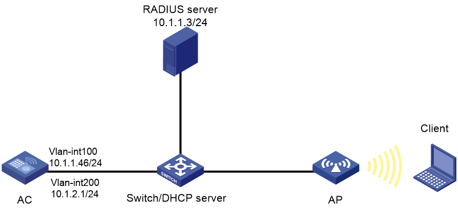

Example: Configuring remote 802.1X authentication in WPA3-Enterprise mode
As shown in Figure 1, the switch acts as a DHCP server to assign IP addresses to the AP and the client. The RADIUS server is an IMC server.
Configure the AC, the client, the switch, and the RADIUS server to meet the following requirements:
·     The AC uses the RADIUS server to perform authentication, authorization, and accounting for the wireless client. The 802.1X EAP-PEAP authentication method is used.
·     The AC uses the open system authentication for the client at the data link layer. This is the default authentication method at the data link layer.
·     The AC uses the 802.1X AKM mode to secure data transmission between the client and the AP.
·     The cipher suite is GCMP and the security mode is WPA3-Enterprise.
Figure 1 Network diagram
Use the serial ID labeled on the AP's rear panel to specify an AP.

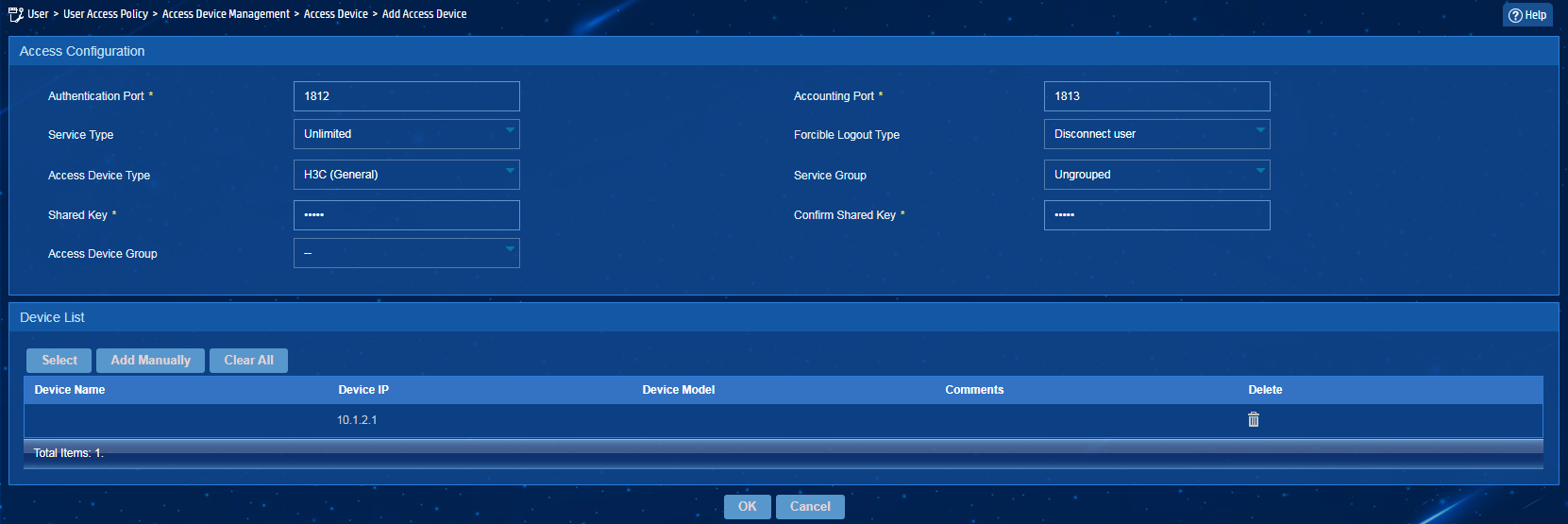

Adding the AC as an access device to IMC
1.     Log in to IMC and click the User tab.
2.     From the navigation tree, select User Access Policy > Access Device Management > Access Device.
3.     Click Add.
The Add Access Device page opens.
4.     In the Access Configuration area, configure the following parameters, as shown in Figure 2:
¡     Enter 12345 in the Shared Key and Confirm Shared Key fields. The shared key must be the same as the authentication and accounting shared keys configured on the AC.
¡     Use the default values for other parameters.
5.     In the Device List area, click Select or Add Manually to add the AC at 10.1.2.1 as an access device.
The IP address must be the source IP address specified for outgoing RADIUS packets in the RADIUS scheme on the AC.
6.     Click OK.
Figure 2 Adding an access device

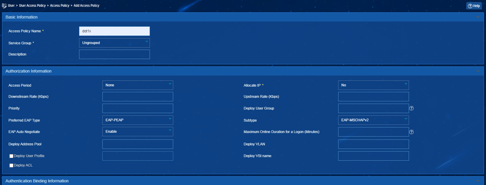

Adding an access policy
1.     From the navigation tree, select User Access Policy > Access Policy.
2.     Click Add.
3.     On the Add Access Policy page, configure the following parameters, as shown in Figure 3:
¡     Enter dot1x in the Access Policy Name field.
¡     Select EAP-PEAP from the Preferred EAP Type list, and select EAP-MSCHAPv2 from the Subtype list.
The certificate subtype on the IMC server must be the same as the identity authentication method configured on the client.
4.     Click OK.
Figure 3 Adding an access policy

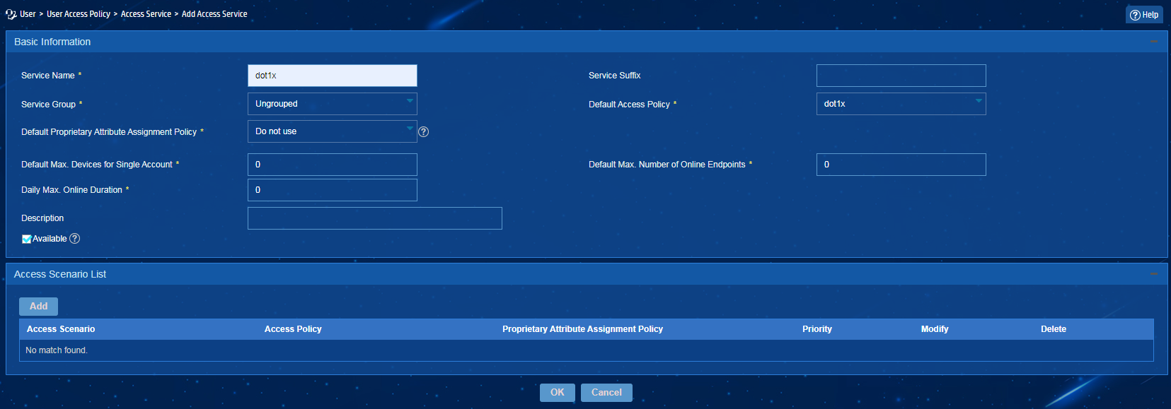

Adding an access service
1.     From the navigation tree, select User Access Policy > Access Service.
2.     Click Add.
3.     On the Add Access Service page, configure the following parameters, as shown in Figure 4:
¡     Enter dot1x in the Service Name field.
¡     Select dot1x from the Default Access Policy list.
4.     Click OK.
Figure 4 Adding an access service

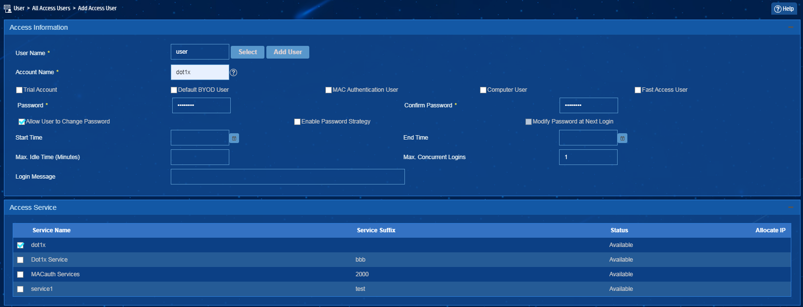

Adding an access user
1.     From the navigation tree, select Access User > Access User.
The access user list opens.
2.     Click Add.
The Add Access User page opens.
3.     In the Access Information area, configure the following parameters, as shown in Figure 5:
a.     Click Select or Add User to associate the user with IMC Platform user user.
b.     Enter dot1x in the Account Name field.
c.     Enter dot1x123 in the Password and Confirm Password fields.
4.     In the Access Service area, select dot1x from the list.
5.     Click OK.
Figure 5 Adding an access user account
