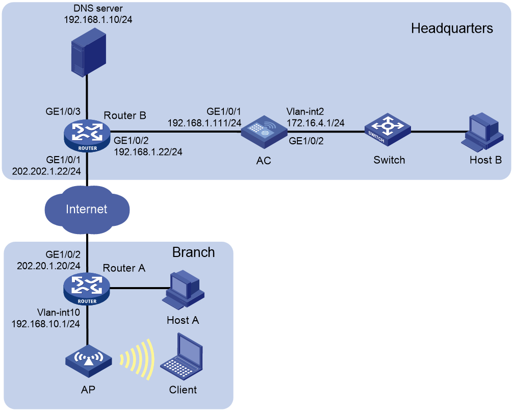

As shown in Figure 1, the AC is deployed at the headquarters and an AP is deployed at the branch. Router A and Router B act as the gateways for the branch and the headquarters, respectively. The AP associates with the AC across the Internet.
Configure network settings to meet the following requirements:
· Packets destined to the headquarters are forwarded by the AC and packets destined to the branch or Internet are forwarded by the AP.
· The AP obtains IP addresses from Router A and the client obtains IP addresses from the AC.
Analysis
· For the AP to discover the AC through the Internet, configure Option 43 and manually specify the IP address of the AC on Router A.
· For the AP to communicate with the AC, configure NAT on both Router A and Router B.
· To simplify configurations when a large number of APs are deployed at branches, enable auto AP and auto AP conversion on the AC.
· For both the AP and the AC to forward packets, configure policy-based forwarding on the AC.
· For the AP to obtain configurations automatically from the AC, use a text editor to create an AP configuration file and upload the file to the AC.
Make sure devices in the network can reach each other.

[AC-GigabitEthernet1/0/2] undo port trunk permit vlan 1
[AC-GigabitEthernet1/0/2] port trunk permit vlan 2
[AC-GigabitEthernet1/0/2] quit
# Configure static routes to GigabitEthernet1/0/2 of Router A, GigabitEthernet1/0/1 of Router B, and headquarters' network segment 172.16.5.0/24.
[AC] ip route-static 202.20.1.0 24 192.168.1.22
[AC] ip route-static 202.202.1.0 24 192.168.1.22
[AC] ip route-static 172.16.5.0 24 172.16.4.2
3. Configure DHCP:
# Enable DHCP.
[AC] dhcp enable
# Create DHCP address pool sta, specify the subnet for dynamic allocation as 172.16.4.0/24, and specify the gateway address as 172.16.4.1.
[AC] dhcp server ip-pool sta
[AC-dhcp-pool-sta] network 172.16.4.0 mask 255.255.255.0
[AC-dhcp-pool-sta] gateway-list 172.16.4.1
# Specify the DNS server address as 192.168.1.10.
[AC-dhcp-pool-sta] dns-list 192.168.1.10
# Exclude IP addresses 172.16.4.1 and 172.16.4.3 from dynamic allocation in DHCP address pool sta.
[AC-dhcp-pool-sta] forbidden-ip 172.16.4.1 172.16.4.3
[AC-dhcp-pool-sta] quit
4. Enable auto AP and auto AP conversion.
[AC] wlan auto-ap enable
[AC] wlan auto-persistent enable
5. Configure policy-based forwarding:
# Create IPv4 advanced ACL 3001, and configure ACL rules to permit DNS, BOOTPC, and BOOTPS packets and packets from 172.16.4.0/24 to 172.16.4.0/24 or 172.16.5.0/24.
[AC] acl advanced 3001
[AC-acl-ipv4-adv-3001] rule 0 permit udp source-port eq dns
[AC-acl-ipv4-adv-3001] rule 1 permit udp destination-port eq dns
[AC-acl-ipv4-adv-3001] rule 2 permit udp source-port eq bootpc
[AC-acl-ipv4-adv-3001] rule 3 permit udp destination-port eq bootps
[AC-acl-ipv4-adv-3001] rule 4 permit ip source 172.16.4.0 0.0.0.255 destination 172.16.4.0 0.0.0.255
[AC-acl-ipv4-adv-3001] rule 5 permit ip source 172.16.4.0 0.0.0.255 destination 172.16.5.0 0.0.0.255
[AC-acl-ipv4-adv-3001] quit
# Create forwarding policy remote, and configure the forwarding policy to perform centralized forwarding on packets that match ACL 3001.
[AC] wlan forwarding-policy remote
[AC-wlan-fp-remote] classifier acl 3001 behavior remote
[AC-wlan-fp-remote] quit
# Create service template chn, set the SSID to CHN, and assign clients coming online through the service template to VLAN 2.
[AC] wlan service-template chn
[AC-wlan-st-chn] ssid CHN
[AC-wlan-st-chn] vlan 2
# Enable APs to forward client traffic, apply forwarding policy remote to the service template, and enable the forwarding policy.
[AC-wlan-st-chn] client forwarding-location ap
[AC-wlan-st-chn] client forwarding-policy-name remote
[AC-wlan-st-chn] client forwarding-policy enable
# Set the PSK AKM mode and specify plaintext string 12345678 as the preshared key.
[AC-wlan-st-chn] akm mode psk
[AC-wlan-st-chn] preshared-key pass-phrase simple 12345678
# Set the CCMP cipher suite and enable RSN security IE.
[AC-wlan-st-chn] cipher-suite ccmp
[AC-wlan-st-chn] security-ie rsn
# Enable the service template.
[AC-wlan-st-chn] service-template enable
[AC-wlan-st-chn] quit
# Deploy configuration file map-OnAP.txt to WA6320 APs in the default AP group.
[AC] wlan ap-group default-group
[AC-wlan-ap-group-default-group] ap-model WA6320
[AC-wlan-ap-group-default-group-ap-model-WA6320] map-configuration flash:/map-OnAP.txt
# Bind service template chn to radio 1 and enable radio 1.
[AC-wlan-ap-group-default-group-ap-model-WA6320] radio 1
[AC-wlan-ap-group-default-group-ap-model-WA6320-radio-1] service-template chn
[AC-wlan-ap-group-default-group-ap-model-WA6320-radio-1] radio enable
[AC-wlan-ap-group-default-group-ap-model-WA6320-radio-1] quit
[AC-wlan-ap-group-default-group-ap-model-WA6320] quit
[AC-wlan-ap-group-default-group] quit
# Verify that the AP has associated with the AC.
[AC] display wlan ap all
Total number of APs: 1
Total number of connected APs: 1
Total number of connected manual APs: 1
Total number of connected auto APs: 0
Total number of connected common APs: 1
Total number of connected WTUs: 0
Total number of inside APs: 0
Maximum supported APs: 2048
Remaining APs: 2047
Total AP licenses: 32
Local AP licenses: 32
Server AP licenses: 0
Remaining local AP licenses: 31
Sync AP licenses: 0
AP information
State : I = Idle, J = Join, JA = JoinAck, IL = ImageLoad
C = Config, DC = DataCheck, R = Run, M = Master, B = Backup
AP name APID State Model Serial ID
0015-005e-9348 2 R/M WA6320 219801A28N819CE0002T
# Verify that the AP is in Run state, the discovery type is DHCP, and the AP's IP address is 202.20.1.20.
[AC] display wlan ap name 0015-005e-9348 verbose
AP name : 0015-005e-9348
AP ID : 2
AP group name : default-group
State : Run
Backup type : Master
Online time : 1 days 5 hours 25 minutes 22 seconds
System up time : 1 days 6 hours 30 minutes 4 seconds
Model : WA6320
Region code : CN
Region code lock : Disabled
Serial ID : 219801A28N819CE0002T
MAC address : 70f9-6dd3-61e0
IP address : 202.20.1.20
UDP control port number : 1099
UDP data port number : 1102
H/W version : Ver.C
S/W version : R2215
Boot version : 7.10
USB state : N/A
Power Level : N/A
PowerInfo : N/A
Description : Not configured
Priority : 4
Echo interval : 10 seconds
Echo count : 3 counts
Keepalive interval : 10 seconds
Statistics report interval : 50 seconds
Fragment size (data) : 1500
Fragment size (control) : 1450
MAC type : Local MAC & Split MAC
Tunnel mode : Local Bridging & 802.3 Frame & Native Frame
Discovery type : DHCP
Retransmission count : 3
Retransmission interval : 5 seconds
Firmware upgrade : Enabled
Sent control packets : 34001
Received control packets : 34001
Echo requests : 10591
Lost echo responses : 3
Average echo delay : 3
Last reboot reason : User soft reboot
Latest IP address : 202.20.1.20
Tunnel down reason : Processed join request in Run state
Connection count : 15
Backup Ipv4 : Not configured
Backup Ipv6 : Not configured
Tunnel encryption : Disabled
LED mode : Normal
Remote configuration : Disabled
Radio 1:
Basic BSSID : 70f9-6dd3-61e0
Admin state : Up
Radio type : 802.11ac
Antenna type : internal
Client dot11ac-only : Disabled
Client dot11n-only : Disabled
Channel band-width : 20/40/80MHz
Active band-width : 20/40/80MHz
Secondary channel offset : SCA
Short GI for 20MHz : Supported
Short GI for 40MHz : Supported
Short GI for 80MHz : Supported
Short GI for 160MHz : Not supported
A-MSDU : Enabled
A-MPDU : Enabled
LDPC : Not Supported
STBC : Supported
Operational VHT-MCS Set:
Mandatory : Not configured
Supported : NSS1 0,1,2,3,4,5,6,7,8,9
NSS2 0,1,2,3,4,5,6,7,8,9
Multicast : Not configured
Operational HT MCS Set:
Supported : 0, 1, 2, 3, 4, 5, 6, 7, 8, 9,
10, 11, 12, 13, 14, 15
Channel : 149(auto)
Channel usage(%) : 0
Max power : 20 dBm
Operational rate:
Mandatory : 6, 12, 24 Mbps
Multicast : Auto
Supported : 9, 18, 36, 48, 54 Mbps
Disabled : Not configured
Distance : 1 km
ANI : Enabled
Fragmentation threshold : 2346 bytes
Beacon interval : 100 TU
Protection threshold : 2346 bytes
Long retry threshold : 4
Short retry threshold : 7
Maximum rx duration : 2000 ms
Noise floor : -105 dBm
Smart antenna : Enabled
Smart antenna policy : Auto
Protection mode : cts-to-self
Continuous mode : N/A
HT protection mode : No protection
Radio 2:
Basic BSSID : 70f9-6dd3-61f0
Admin state : Down
Radio type : 802.11n(2.4GHz)
Channel band-width : 20MHz
Active band-width : 20MHz
Secondary channel offset : SCN
A-MSDU : Enabled
A-MPDU : Enabled
STBC : Supported
Channel : 6(auto)
Max power : 20 dBm
Preamble type : Short
Operational rate:
Mandatory : 1, 2, 5.5, 11 Mbps
Multicast : Auto
Supported : 6, 9, 12, 18, 24, 36, 48, 54 Mbps
Distance : 1 km
ANI : Enabled
Noise floor : 0 dBm
# Verify that the client has come online with an IP address in subnet 172.16.4.0/24, and the forwarding policy is remote.
[AC] display wlan client
Total number of clients: 1
MAC address User name AP name RID IP address VLAN
0015-005e-9348 N/A 0015-005e-9348 1 172.16.4.11 2
[AC] display wlan client verbose
MAC address : 0015-005e-9348
IPv4 address : 172.16.4.11
IPv6 address : N/A
Username : N/A
AID : 1
AP ID : 2
Radio ID : 1
SSID : CHN
VLAN ID : 2
Sleep count : 0
Wireless mode : 802.11an
Channel bandwidth : 40MHz
20/40 BSS Coexistence Management : Not supported
SM power save : Disabled
STBC RX capability : Supported
STBC TX capability : Not supported
LDPC RX capability : Not supported
Block Ack : N/A
Supported HT MCS set : 0, 1, 2, 3, 4, 5, 6, 7,
8, 9, 10, 11, 12, 13, 14,
15
Supported rates : 6, 9, 12, 18, 24, 36,
48, 54 Mbps
QoS mode : WMM
Listen interval : 100
RSSI : 0
Rx/Tx rate : 0/0
Authentication method : Open system
Security mode : PRE-RSNA
AKM mode : N/A
Cipher suite : N/A
User authentication mode : Bypass
Authorization ACL ID : N/A
Authorization user profile : N/A
Roam status : N/A
Key derivation : N/A
PMF status : N/A
Forwarding policy name : remote
Online time : 0days 0hours 0minutes 33seconds
FT status : Inactive
# Verify that IP addresses (172.16.4.2, 172.16.5.1, and 172.16.5.2) in the headquarters' network can be pinged successfully.
C:\Users\h3c>ping 172.16.4.2
Pinging 172.16.4.2 with 32 bytes of data:
Reply from 172.16.4.2: bytes=32 time=6ms TTL=255
Reply from 172.16.4.2: bytes=32 time=3ms TTL=255
Reply from 172.16.4.2: bytes=32 time=1ms TTL=255
Ping statistics for 172.16.4.2:
Minimum = 1ms, Maximum = 6ms, Average = 4ms
C:\Users\h3c>ping 172.16.5.1
Pinging 172.16.5.1 with 32 bytes of data:
Reply from 172.16.5.1: bytes=32 time=9ms TTL=255
Reply from 172.16.5.1: bytes=32 time=1ms TTL=255
Reply from 172.16.5.1: bytes=32 time=5ms TTL=255
Ping statistics for 172.16.5.1:
Minimum = 1ms, Maximum = 9ms, Average = 4ms
C:\Users\h3c>ping 172.16.5.2
Pinging 172.16.5.2 with 32 bytes of data:
Reply from 172.16.5.2: bytes=32 time=8ms TTL=255
Reply from 172.16.5.2: bytes=32 time=2ms TTL=255
Reply from 172.16.5.2: bytes=32 time=5ms TTL=255
Reply from 172.16.5.2: bytes=32 time=3ms TTL=255
Ping statistics for 172.16.5.2:
Minimum = 2ms, Maximum = 8ms, Average = 4ms
# Verify that a website on the Internet (for example, www.baidu.com) can be pinged successfully.
C:\Users\h3c>ping www.baidu.com
Pinging www.baidu.com [202.202.1.188] with 32 bytes of data:
Reply from 202.202.1.188: bytes=32 time=7ms TTL=255
Reply from 202.202.1.188: bytes=32 time=3ms TTL=255
Reply from 202.202.1.188: bytes=32 time=2ms TTL=255
Ping statistics for 202.202.1.188:
Minimum = 2ms, Maximum = 7ms, Average = 3ms
