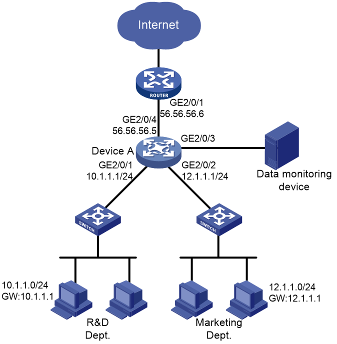

As shown in Figure 1, the departments of a company use IP addresses on different subnets. The R&D department uses subnet 10.1.1.0/24, and the marketing department uses subnet 12.1.1.0/24. Configure local port mirroring, so that the data monitoring device can monitor the traffic from the R&D department and marketing department to Internet and the traffic between the two departments.

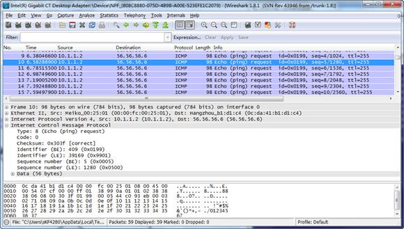

# Ping 56.56.56.6 from a host at 10.1.1.2 in the R&D department. Capture the packets on the data monitoring device, as shown in Figure 2.
Figure 2 Packets captured by Wireshark
The captured packets show that the local port mirroring function takes effect. The data monitoring device can successfully monitor the specified traffic.
