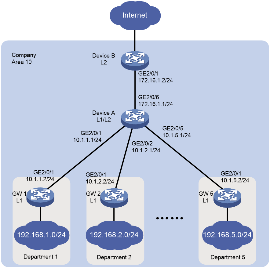

As shown in Figure 1, the company's headquarters and the branch run IS-IS. The partner runs OSPF.
Configure the routers to meet the following requirements:
·     The Marketing department can reach the F&A department, the branch, and the partner.
·     The F&A department and the branch cannot reach each other, and the branch does not have a route to the F&A department.
·     When the IS-IS process on Router C restarts, the communication is not interrupted.
Figure 1 Network diagram

Example: Configuring IS-IS route summarization
As shown in Figure 2, the five departments of a company use IS-IS to connect to the backbone network. The five departments are assigned the networks 192.168.1.0/24, 192.168.2.0/24, 192.168.3.0/24, 192.168.4.0/24, and 192.168.5.0/24, respectively. Configure IS-IS route summarization to reduce routing entries and save system resources for Device B.
Figure 2 Network diagram
Analysis
Configure route summarization on Device A, because route summarization applies only to locally generated LSPs.
To avoid blackhole routes, set the summary route to 192.168.0.0/21.
Software versions used
This configuration example was created and verified on R9141P16 of the SR6608-M device.

# Configure an IP address for GigabitEthernet 1/0/6 on Device A.
<DeviceA> system-view
[DeviceA] interface gigabitethernet 1/0/6
[DeviceA-GigabitEthernet1/0/6] ip address 172.16.1.1 24
[DeviceA-GigabitEthernet1/0/6] quit
# Configure IP addresses for other interfaces as shown in Figure 2 in the same way GigabitEthernet 1/0/6 is configured. (Details not shown.)
# Configure IS-IS route summarization on Device A.
[DeviceA] isis 1
[DeviceA-isis-1] address-family ipv4
[DeviceA-isis-1-ipv4] summary 192.168.0.0 21
# Display IS-IS routing information on Device B.
[DeviceB] display isis route
                         Route information for IS-IS(1)
                         Level-2 IPv4 Forwarding Table
 IPv4 Destination     IntCost    ExtCost ExitInterface   NextHop         Flags
 10.1.1.0/24          20         NULL    GE1/0/1         172.16.1.1      R/-/-
 10.1.2.0/24          20         NULL    GE1/0/1         172.16.1.1      R/-/-
 10.1.3.0/24          20         NULL    GE1/0/1         172.16.1.1      R/-/-
 10.1.4.0/24          20         NULL    GE1/0/1         172.16.1.1      R/-/-
 10.1.5.0/24          20         NULL    GE1/0/1         172.16.1.1      R/-/-
 172.16.1.0/24        10         NULL    GE1/0/1         Direct          D/L/-
 192.168.0.0/21       30         NULL    GE1/0/1         172.16.1.1      R/-/-
      Flags: D-Direct, R-Added to Rib, L-Advertised in LSPs, U-Up/Down Bit Set
The output shows that the networks have been summarized into a single network 192.168.0.0/21.
