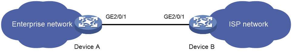

As shown in Figure 1, the enterprise network and the ISP network are connected through their respective edge devices, Device A and Device B. Configure Ethernet OAM to monitor the status of the link between Device A and Device B, which helps identify whether the ISP network reliability meets the Service Level Agreement (SLA) with the enterprise customer. The specific requirements are as follows:
· Enable Ethernet OAM on Device A and Device B to auto-detect link errors between the two devices.
· Enable the administrator to identify whether a critical link event occurs for the link between Device A and Device B.
· Enable the administrator to dynamically obtain the link status by observing Ethernet OAM link error event statistics.
Analysis
To set up an OAM connection between Device A and Device B, you must set at least the interface on one end to operate in active mode. You can skip this configuration, because all interfaces on the device operate in active Ethernet OAM mode by default. In this example, configure GigabitEthernet 2/0/1 on Device A to operate in active Ethernet OAM mode, and configure GigabitEthernet 2/0/1 on Device B to operate in passive Ethernet OAM mode.
The Ethernet OAM link error events that can be monitored by Ethernet OAM include errored symbol events, errored frame events, errored frame period events, and errored frame seconds events. By default, an interface enabled with Ethernet OAM adopts the global link error detection settings. You can edit the detection settings as needed based on actual network conditions. This example takes the configuration of the errored frame event detection settings for illustration.
Software versions used
This configuration example was created and verified on R9141P16 of the SR6608-M device.
To change the Ethernet OAM mode on an Ethernet OAM-enabled interface, first disable Ethernet OAM on the interface.
Procedures
