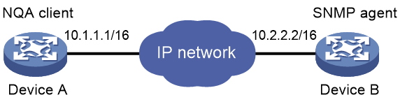

Example: Configuring a UDP jitter operation
As shown in Figure 1, configure a UDP jitter operation to test the jitter, delay, and round-trip time between Device A and Device B.
Figure 1 Network diagram
Software version used
This configuration example was created and verified on R9141P16 of the SR6608-M device.
When you configure a UDP jitter operation, follow these restrictions and guidelines:
·     Make sure the devices can reach each other before you start the UDP jitter operation.
·     Configure Device B as the NQA server before you start the UDP jitter operation.
·     You cannot modify the operation configuration for a running NQA operation.

Example: Configuring a UDP echo operation
As shown in Figure 4, configure a UDP echo operation to test the round-trip time between Device A and Device B. The destination port number is 8000.
Figure 4 Network diagram

Example: Configuring a voice operation
As shown in Figure 5, configure a voice operation to test the jitter, delay, MOS, and ICPIF between Device A and Device B.
Figure 5 Network diagram

Example: Configuring a DLSw operation
As shown in Figure 6, configure a DLSw operation to test the response time of the DLSw device.
Figure 6 Network diagram
