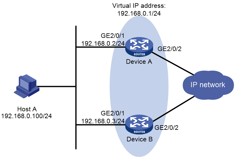

As shown in Figure 1, two gateway devices are deployed at the network egress of Host A. Device A and Device B form a VRRP group that acts as the default gateway for Host A. The network requirements are as follows:
·     Device A operates as the master to forward packets from Host A to Host B.
·     When Device A fails, Device B takes over to forward packets for Host A.
·     When Device A recovers, Device A acts as the gateway again.
Figure 1 Network diagram
Analysis
·     To enable Device A to become the master in the VRRP group, you need to configure a higher priority for Device A.
·     To enable the master to automatically adjust its VRRP priority according to uplink interface state, configure preemption mode and uplink interface monitoring settings for the VRRP group. This configuration implements master/backup switchover upon a role change in the VRRP group.
·     To avoid frequent role changes in the VRRP group, configure a preemption delay.

Configuring Device A
# Configure an IP address for interface GigabitEthernet 2/0/1.
<DeviceA> system-view
[DeviceA] interface gigabitethernet 2/0/1
[DeviceA-GigabitEthernet2/0/1] ip address 192.168.0.2 24
# Create VRRP group 1 and configure the virtual IP address for VRRP group 1 as 192.168.0.1.
[DeviceA-GigabitEthernet2/0/1] vrrp vrid 1 virtual-ip 192.168.0.1
# Assign Device A a higher priority than Device B in VRRP group 1, so Device A can become the master.
[DeviceA-GigabitEthernet2/0/1] vrrp vrid 1 priority 110
# Configure Device A to operate in preemptive mode, so it can become the master whenever it operates correctly. Set the preemption delay to five seconds to avoid frequent status switchover.
[DeviceA-GigabitEthernet2/0/1] vrrp vrid 1 preempt-mode delay 5
[DeviceA-GigabitEthernet2/0/1] quit
# Create track entry 1 associated with the physical state of uplink interface GigabitEthernet 2/0/2.
[DeviceA] track 1 interface gigabitethernet 2/0/2
# Create track entry 1. When the track entry transits to Negative state, Device A decreases its priority by 50 in the VRRP group.
[DeviceA-GigabitEthernet2/0/1] vrrp vrid 1 track 1 priority reduced 50
Configuring Device B
<DeviceB> system-view
[DeviceB] interface gigabitethernet 2/0/1
[DeviceB-GigabitEthernet2/0/1] ip address 192.168.0.3 24
[DeviceB-GigabitEthernet2/0/1] vrrp vrid 1 virtual-ip 192.168.0.1
# Set the priority of Device B to 100 in VRRP group 1.
[DeviceB-GigabitEthernet2/0/1] vrrp vrid 1 priority 100
# Configure Device B to operate in preemptive mode, and set the preemption delay to five seconds.
[DeviceB-GigabitEthernet2/0/1] vrrp vrid 1 preempt-mode delay 5
[DeviceB-GigabitEthernet2/0/1] quit
# Ping Host B from Host A. (Details not shown.)

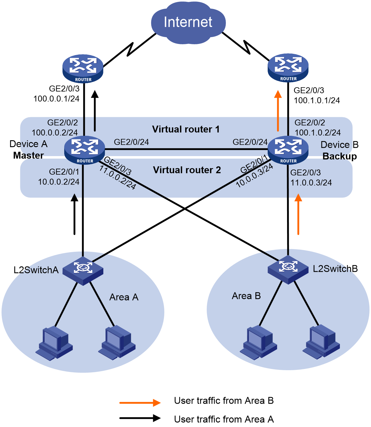

As shown in Figure 2, to achieve gateway redundancy and load balancing for internal host traffic, a company deploys two devices at the internal network egress. Two devices formed two VRRP groups in load balancing mode as default gateways for areas A and B, respectively. The network requirements are as follows:
·     Device A operates as the master in VRRP group 1. Device B operates as the master in VRRP group 2. Typically, Device A forwards user data in area A, and Device B forwards user data in area B.
·     When Device A or its uplink interface fails, Device B takes over to forward host traffic in area A. When Device A recovers, it acts as the gateway for VRRP group 1 again.
·     When Device B or its uplink interface fails, Device A takes over to forward host traffic in area B. When Device B recovers, it acts as the gateway for VRRP group 2 again.
Figure 2 Network diagram
Analysis
·     To enable Device A to become the master in VRRP group 1, you need to configure a higher priority for Device A in VRRP group 1. To enable Device B to become the master in VRRP group 2, you need to configure a higher priority for Device B in VRRP group 2.
·     To avoid frequent role changes in the VRRP groups, configure a preemption delay.
[DeviceA-GigabitEthernet2/0/1] ip address 10.0.0.2 24
# Assign IP addresses to other interfaces in Figure 2 in the same way. (Details not shown.)
# Create VRRP group 1 and configure the virtual IP address for VRRP group 1 as 10.0.0.1. Assign Device A a higher priority than Device B in VRRP group 1, so Device A can become the master.
[DeviceA-GigabitEthernet2/0/1] vrrp vrid 1 virtual-ip 10.0.0.1
[DeviceA-GigabitEthernet2/0/1] vrrp vrid 1 priority 120
# Create VRRP group 2 and configure the virtual IP address for VRRP group 2 as 11.0.0.1.
[DeviceA] interface gigabitethernet 2/0/3
[DeviceA-GigabitEthernet2/0/3] vrrp vrid 2 virtual-ip 11.0.0.1
[DeviceA-GigabitEthernet2/0/3] quit
# Configure Device A to operate in preemptive mode, and set the preemption delay to five seconds.
# Create track entry 1. When the track entry transits to Negative state, Device A decreases its priority by 50 in VRRP group 1.
[DeviceB-GigabitEthernet2/0/1] ip address 10.0.0.3 24
[DeviceB-GigabitEthernet2/0/1] vrrp vrid 1 virtual-ip 10.0.0.1
# Create VRRP group 2 and configure the virtual IP address for VRRP group 2 as 11.0.0.1. Assign Device B a higher priority than Device A in VRRP group 2, so Device B can become the master.
[DeviceB] interface gigabitethernet 2/0/3
[DeviceB-GigabitEthernet2/0/3] vrrp vrid 2 virtual-ip 11.0.0.1
[DeviceB-GigabitEthernet2/0/3] vrrp vrid 2 priority 120
[DeviceB-GigabitEthernet2/0/3] vrrp vrid 2 preempt-mode delay 5
[DeviceB-GigabitEthernet2/0/3] quit
# Create track entry 2 associated with the physical state of uplink interface GigabitEthernet 2/0/2.
[DeviceB] track 2 interface gigabitethernet 2/0/2
# Create track entry 2. When the track entry transits to Negative state, Device B decreases its priority by 50 in VRRP group 2.
[DeviceB-GigabitEthernet2/0/3] vrrp vrid 2 track 2 priority reduced 50

2.     Use the display vrrp verbose command to verify the configuration.
# Display detailed VRRP group information Device A. Verify that Device A is the master in VRRP group 1 and backup in VRRP group 2.
[DeviceA] display vrrp verbose
IPv4 Virtual Router Information:
 Running Mode       : Standard
 Total number of virtual routers : 2
   Interface GigabitEthernet2/0/1
     VRID           : 1                    Adver Timer  : 100
     Admin Status   : Up                   State        : Master
     Config Pri     : 120                  Running Pri  : 120
     Preempt Mode   : Yes                  Delay Time   : 5
     Auth Type      : None
     Virtual IP     : 10.0.0.1
     Virtual MAC    : 0000-5e00-0101
     Master IP      : 10.0.0.2
   VRRP Track Information:
     Track Object   : 1                   State : Positive   Pri Reduced : 50
   Interface GigabitEthernet2/0/3
     VRID           : 2                    Adver Timer  : 100
     Admin Status   : Up                   State        : Backup
     Config Pri     : 100                  Running Pri  : 100
     Preempt Mode   : Yes                  Delay Time   : 0
     Auth Type      : None
     Become Master  : 3550ms left
     Virtual IP     : 11.0.0.1
     Master IP      : 11.0.0.3
# Display detailed VRRP group information Device B. Verify that Device B is the backup in VRRP group 1 and master in VRRP group 2.
[DeviceB] display vrrp verbose
     Auth Type      : None
     Become Master  : 3500ms left
     Auth Type      : None
     Virtual MAC    : 0000-5e00-0102
     Track Object   : 2                   State : Positive   Pri Reduced : 50
# When Device A becomes faulty, execute the display vrrp verbose command to display detailed VRRP group information on Device B. Verify that Device B preempts as the master in VRRP group 1.
     Auth Type      : None
     Master IP      : 10.0.0.3
     Auth Type      : None
The output shows that the hosts in area A and area B can still ping the external network when Device A becomes faulty.
# After Device A recovers, display detailed VRRP group information on Device A.
     Auth Type      : None
     Auth Type      : None
The output shows that after Device A recovers, it resumes the original priority and becomes the master in VRRP group 1 again to forward host traffic from area A to the external network.

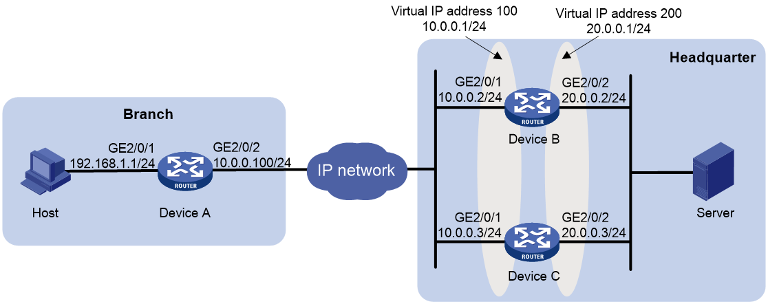

Example: Configuring VRRP with IPsec
As shown in Figure 4, Device A is the gateway for an enterprise branch, and Device B and Device C are gateways for the enterprise headquarters. Configure VRRP on Device B and Device C to implement device redundancy backup for higher reliability. Hosts within the branch can access resources on internal servers at the enterprise headquarters. The network requirements are as follows:
·     In normal situation, Device B acts as the master to forward traffic.
·     When Device B fails, Device C takes over the traffic forwarding for Device B.
·     Deploy an IPsec tunnel between Device A and the enterprise headquarters egress gateway for data integrity and confidentiality between branch network 192.168.1.0/24 and the headquarters network 20.0.0.0/24.
Figure 4 Network diagram
Analysis
·     To ensure security of data between hosts and servers, establish a point-to-point IPsec tunnel between Device A and the master in VRRP group 100.
·     To prevent IPsec tunnel interruption due to switchover in the VRRP group, configure Dead Peer Detection (DPD) to ensure that Device A can detect the peer router status in time and perform IKE renegotiation with other routers in the VRRP group.
·     To enable Device B to become the master in the VRRP group, you need to configure a higher priority for B.
·     To enable the master to automatically adjust its VRRP priority according to state of interface GigabitEthernet 2/0/2 connected to the headquarters internal network, configure preemption mode and uplink interface monitoring settings for the VRRP group. This configuration implements master/backup switchover upon a role change in the VRRP group.
Software versions used
This configuration example was created and verified on R9141P16 of the SR6608-M device.

[DeviceA] ike keychain test
[DeviceA-ike-keychain-test] pre-shared-key address 10.0.0.1 key simple 123456
[DeviceA-ike-keychain-test] quit
# Create an IKE profile named test, specify IKE keychain test, configure the local ID with the identity type as IP address and the value as 10.0.0.100, and specify IP address 10.0.0.1 as the peer ID.
[DeviceA] ike profile test
[DeviceA-ike-profile-test] keychain test
[DeviceA-ike-profile-test] local-identity address 10.0.0.100
[DeviceA-ike-profile-test] match remote identity address 10.0.0.1
[DeviceA-ike-profile-test] quit
# Create an IPsec transform set named test, and use the default encapsulation mode and security protocol settings.
[DeviceA] ipsec transform-set test
# Specify the encryption and authentication algorithms for ESP as DES (64-bit key) and MD5, respectively.
[DeviceA-ipsec-transform-set-test] esp encryption-algorithm des-cbc
[DeviceA-ipsec-transform-set-test] esp authentication-algorithm md5
[DeviceA-ipsec-transform-set-test] quit
# Create an IKE-based IPsec policy entry with name test and sequence number 1.
[DeviceA] ipsec policy test 1 isakmp
# Specify the local IP address of the IPsec tunnel as 10.0.0.100.
[DeviceA-ipsec-policy-isakmp-test-1] local-address 10.0.0.100
# Specify the remote IP address of the IPsec tunnel as 10.0.0.1.
[DeviceA-ipsec-policy-isakmp-test-1] remote-address 10.0.0.1
# Apply ACL 3000.
[DeviceA-ipsec-policy-isakmp-test-1] security acl 3000
# Apply IPsec transform set test.
[DeviceA-ipsec-policy-isakmp-test-1] transform-set test
# Apply IKE profile test.
[DeviceA-ipsec-policy-isakmp-test-1] ike-profile test
[DeviceA-ipsec-policy-isakmp-test-1] quit
# Apply IPsec policy test to GigabitEthernet 2/0/2.
[DeviceA] interface gigabitethernet 2/0/2
[DeviceA-GigabitEthernet2/0/2] ipsec apply policy test
[DeviceA-GigabitEthernet2/0/2] quit
# Configure IP addresses for interfaces.
[DeviceB-GigabitEthernet2/0/1] ip address 10.0.0.2 255.255.255.0
[DeviceB] interface gigabitethernet 2/0/2
[DeviceB-GigabitEthernet2/0/2] ip address 20.0.0.2 255.255.255.0
[DeviceB-GigabitEthernet2/0/2] quit
# Configure a static route destined to network 192.168.1.0/24.
[DeviceB] ip route-static 192.168.1.0 255.255.255.0 10.0.0.100
# Create ACL 3000 to identify data flows from subnet 20.0.0.0/24 to subnet 192.168.1.0/24.
[DeviceB] acl number 3000
[DeviceB-acl-adv-3000] rule 0 permit ip source 20.0.0.0 0.0.0.255 destination 192.168.1.0 0.0.0.255
[DeviceB-acl-adv-3000] quit
# Create IKE keychain test, and set the preshared key to be used for IKE negotiation with peer 10.0.0.100 to 123456.
[DeviceB] ike keychain test
[DeviceB-ike-keychain-test] pre-shared-key address 10.0.0.100 key simple 123456
[DeviceB-ike-keychain-test] quit
# Create an IKE profile named test, specify IKE keychain test, configure the local ID with the identity type as IP address and the value as 10.0.0.1, and specify IP address 10.0.0.100 (IP address of the uplink interface of Device A) as the peer ID.
[DeviceB] ike profile test
[DeviceB-ike-profile-test] keychain test
[DeviceB-ike-profile-test] local-identity address 10.0.0.1
[DeviceB-ike-profile-test] match remote identity address 10.0.0.100
[DeviceB-ike-profile-test] quit
[DeviceB] ipsec transform-set test
[DeviceB-ipsec-transform-set-test] esp encryption-algorithm des-cbc
[DeviceB-ipsec-transform-set-test] esp authentication-algorithm md5
[DeviceB-ipsec-transform-set-test] quit
[DeviceB] ipsec policy test 1 isakmp
# Specify the local IP address of the IPsec tunnel as 10.0.0.1.
[DeviceB-ipsec-policy-isakmp-test-1] local-address 10.0.0.1
# Specify the remote IP address of the IPsec tunnel as 10.0.0.100.
[DeviceB-ipsec-policy-isakmp-test-1] remote-address 10.0.0.100
# Apply ACL 3000.
[DeviceB-ipsec-policy-isakmp-test-1] security acl 3000
[DeviceB-ipsec-policy-isakmp-test-1] transform-set test
[DeviceB-ipsec-policy-isakmp-test-1] ike-profile test
[DeviceB-ipsec-policy-isakmp-test-1] quit
# Apply IPsec policy test to GigabitEthernet 2/0/1.
[DeviceB-GigabitEthernet2/0/1] ipsec apply policy test
# Create track entry 1 to monitor the state of interface GigabitEthernet 2/0/2.
[DeviceB] track 1 interface gigabitethernet 2/0/2
# Create VRRP group 100, and configure the virtual IP address for VRRP group 100 as 10.0.0.1.
[DeviceB-GigabitEthernet2/0/1] vrrp vrid 100 virtual-ip 10.0.0.1
# Set the priority of Device B to 150 in VRRP group 100.
[DeviceB-GigabitEthernet2/0/1] vrrp vrid 100 priority 150
# Create track entry 1. When the track entry transits to Negative state, Device B decreases its priority by 60 (lower than the default priority 100) in VRRP group 100.
[DeviceB-GigabitEthernet2/0/1] vrrp vrid 100 track 1 priority reduce 60
# Create track entry 2 to monitor the state of interface GigabitEthernet 2/0/1.
[DeviceB] track 2 interface gigabitethernet 2/0/1
# Create VRRP group 200, and configure the virtual IP address for VRRP group 200 as 20.0.0.1.
[DeviceB-GigabitEthernet2/0/2] vrrp vrid 200 virtual-ip 20.0.0.1
# Set the priority of Device B to 150 in VRRP group 200.
[DeviceB-GigabitEthernet2/0/2] vrrp vrid 200 priority 150
# Create track entry 2. When the track entry transits to Negative state, Device B decreases its priority by 60 (lower than the default priority 100) in VRRP group 200.
[DeviceB-GigabitEthernet2/0/2] vrrp vrid 200 track 2 priority reduce 60
Configuring Device C
<DeviceC> system-view
[DeviceC] interface gigabitethernet 2/0/1
[DeviceC-GigabitEthernet2/0/1] ip address 10.0.0.3 255.255.255.0
[DeviceC-GigabitEthernet2/0/1] quit
[DeviceC] interface gigabitethernet 2/0/2
[DeviceC-GigabitEthernet2/0/2] ip address 20.0.0.3 255.255.255.0
[DeviceC-GigabitEthernet2/0/2] quit
[DeviceC] ip route-static 192.168.1.0 255.255.255.0 10.0.0.100
[DeviceC] acl number 3000
[DeviceC-acl-adv-3000] rule 0 permit ip source 20.0.0.0 0.0.0.255 destination 192.168.1.0 0.0.0.255
[DeviceC-acl-adv-3000] quit
[DeviceC] ike keychain test
[DeviceC-ike-keychain-test] pre-shared-key address 10.0.0.100 key simple 123456
[DeviceC-ike-keychain-test] quit
[DeviceC] ike profile test
[DeviceC-ike-profile-test] keychain test
[DeviceC-ike-profile-test] local-identity address 10.0.0.1
[DeviceC-ike-profile-test] match remote identity address 10.0.0.100
[DeviceC-ike-profile-test] quit
[DeviceC] ipsec transform-set test
[DeviceC-ipsec-transform-set-test] esp encryption-algorithm des-cbc
[DeviceC-ipsec-transform-set-test] esp authentication-algorithm md5
[DeviceC-ipsec-transform-set-test] quit
[DeviceC] ipsec policy test 1 isakmp
[DeviceC-ipsec-policy-isakmp-test-1] local-address 10.0.0.1
[DeviceC-ipsec-policy-isakmp-test-1] remote-address 10.0.0.100
# Apply ACL 3000.
[DeviceC-ipsec-policy-isakmp-test-1] security acl 3000
[DeviceC-ipsec-policy-isakmp-test-1] transform-set test
[DeviceC-ipsec-policy-isakmp-test-1] ike-profile test
[DeviceC-ipsec-policy-isakmp-test-1] quit
[DeviceC-GigabitEthernet2/0/1] ipsec apply policy test
[DeviceC-GigabitEthernet2/0/1] vrrp vrid 100 virtual-ip 10.0.0.1
[DeviceC-GigabitEthernet2/0/2] vrrp vrid 200 virtual-ip 20.0.0.1
1.     View detailed VRRP group information on Device B and Device C. Verify that Device B is the master in VRRP groups 100 and 200, and Device C is the backup.
# Display detailed VRRP group information on Device B.
     VRID           : 100                 Adver Timer  : 100
     Config Pri     : 150                 Running Pri  : 150
     Auth Type      : None
     Virtual MAC    : 0000-5e00-0164
     Track Object   : 1                   State : Positive   Pri Reduced : 60
   Interface GigabitEthernet2/0/2
     VRID           : 200                 Adver Timer  : 100
     Auth Type      : None
     Virtual IP     : 20.0.0.1
     Master IP      : 20.0.0.2
     Track Object   : 2                   State : Positive   Pri Reduced : 60
# Display detailed VRRP group information on Device C.
[DeviceC] display vrrp verbose
     Become Master  : 3480ms left
     Auth Type      : None
     Become Master  : 2820ms left
     Auth Type      : None
2.     Ping the headquarters gateway IP address 20.0.0.1 from the branch to trigger IKE negotiation. The IP address can be pinged after the SA negotiation succeeds.
<DeviceA> ping -a 192.168.1.1 20.0.0.1
  PING 30.1.1.123: 56  data bytes, press CTRL_C to break
    Request time out
    Reply from 20.0.0.1: bytes=56 Sequence=1 ttl=127 time=2 ms
    Reply from 20.0.0.1: bytes=56 Sequence=2 ttl=127 time=1 ms
    Reply from 20.0.0.1: bytes=56 Sequence=3 ttl=127 time=1 ms
    Reply from 20.0.0.1: bytes=56 Sequence=4 ttl=127 time=2 ms
  --- 20.0.0.1 ping statistics ---
    5 packet(s) transmitted
    4 packet(s) received
    20.00% packet loss
    round-trip min/avg/max = 1/1/2 ms
3.     Execute the diplay ike sa command on Device A and Device B to verify the IKE SA setup status.
# Display IKE SA information on Device A. You can see that the peer address of the IKE SA on Device A is the virtual IP address of the VRRP group.
[DeviceA] display ike sa
    Connection-ID   Remote                Flag         DOI
    29              10.0.0.1              RD           IPSEC
Flags:
RD--READY RL--REPLACED FD-FADING
# Display IKE SA information on Device B. You can see that the peer address of the IKE SA on Device B is the IP address of GigabitEthernet 2/0/2 on Device A.
[DeviceB] display ike sa
    17              10.0.0.100            RD           IPSEC
Flags:
4.     Execute the display ipsec sa brief command on Device A and Device B to verify the IKE SA setup status. You can see that the IPsec tunnel has been successfully established.
# Display IPsec SA information on Device A.
[DeviceA] display ipsec sa brief
Interface/Global    Dst Address       SPI         Protocol    Status
GE1/0/2               10.0.0.1          4051765865  ESP         active
GE1/0/2               10.0.0.100        1860835944  ESP         active
# Display IPsec SA information on Device B.
[DeviceB] display ipsec sa brief
GE1/0/1               10.0.0.100        1860835944  ESP         active
GE1/0/1               10.0.0.1          4051765865  ESP         active
5.     Manually shut down interface GigabitEthernet 2/0/1 on Device B. Then Device B becomes the backup and Device C becomes the master in the VRRP group. Ping the headquarters IP address 20.0.0.1 from the branch again. Upon detecting no response from the IKE peer in the DPD detection, the device removes the local SA configuration and starts IKE negotiation with Device C again. Upon successful SA setup, the headquarters IP address can be pinged.
# Display VRRP group state on Device B.
 Interface          VRID   State       Run     Adver   Auth     Virtual
                                       Pri     Timer   Type        IP
 GE1/0/1              100    Initialize  150     1       None     10.0.0.1
 GE1/0/2              200    Backup      90      1       None     20.0.0.1
# Display VRRP group state on Device C. Device C changes from backup to master.
                                       Pri     Timer   Type        IP
 GE1/0/1              100    Master      100     1       None     10.0.0.1
 GE1/0/2              200    Master      100     1       None     20.0.0.1
# Ping the headquarters gateway IP address 20.0.0.1 on Device A. The ping operation succeeds.
  PING 20.0.0.1: 56  data bytes, press CTRL_C to break
    Reply from 20.0.0.1: bytes=56 Sequence=0 ttl=127 time=2 ms
    Reply from 20.0.0.1: bytes=56 Sequence=1 ttl=127 time=1 ms
    5 packet(s) received
    0.00% packet loss
# Execute the display ike sa command on Device A. You can see that Device A has renegotiated SA from the Connection-Id field in the command output.
    30              10.0.0.1              RD           IPSEC
  flag meaning
  RD--READY ST--STAYALIVE RL--REPLACED FD--FADING TO--TIMEOUT RK--REKEY
# Display the IKE SA on Device C.
[DeviceC] display ike sa
    3               10.0.0.100            RD           IPSEC
  flag meaning
[DeviceC] display ipsec sa brief
 total phase-2 IPv4 SAs: 2
GE1/0/1               10.0.0.100        1235764751  ESP         active
GE1/0/1               10.0.0.1          799485439   ESP         active
6.     When interface GE 1/0/1 comes up again on Device B, the VRRP state transits to master. Traffic from the branch to the headquarters switches back to Device B again. With the DPD feature, Device A removes the SA configuration and performs IKE renegotiation with Device B. Upon successful negotiation, traffic from the branch to the headquarters is transmitted through the new IPsec tunnel. Verify the configuration in the same way as in the previous step. (Details not shown.)
Configuration files
·     Device A:
interface GigabitEthernet2/0/1
 port link-mode route
interface GigabitEthernet2/0/2
 ip address 10.0.0.100 255.255.255.0
ip route-static 20.0.0.0 255.255.255.0 10.0.0.1
acl number 3000
 rule 0 permit ip source 192.168.1.0 0.0.0.255 destination 20.0.0.0 0.0.0.255
 transform-set test
 security acl 3000
 ike-profile test
 ike dpd interval 10 on-demand
ike profile test
 keychain test
 match remote identity address 10.0.0.1 255.255.255.0
ike keychain test
 pre-shared-key address 10.0.0.1 255.255.255.255 key cipher $c$3$VPq7TeKUusm/5GG8rHfZGHQR+Rbrhbk=
·     Device B:
acl number 3000
 transform-set test
 security acl 3000
 ike-profile test
ike profile test
 keychain test
 match remote identity address 10.0.0.100 255.255.255.0
ike keychain test
 pre-shared-key address 10.0.0.100 255.255.255.255 key cipher $c$3$VPq7TeKUusm/5GG8rHfZGHQR+Rbrhbk=
·     Device C:
acl number 3000
 transform-set test
 security acl 3000
 ike-profile test
ike profile test
 keychain test
ike keychain test
Related documentation
·     High Availability Configuration Guide in H3C SR6608-M Router Configuration Guides(V9)
·     High Availability Command Reference in H3C SR6608-M Router Command References(V9)
·     Security Configuration Guide in H3C SR6608-M Router Configuration Guides(V9)
·     Security Command Reference in H3C SR6608-M Router Command References(V9)
