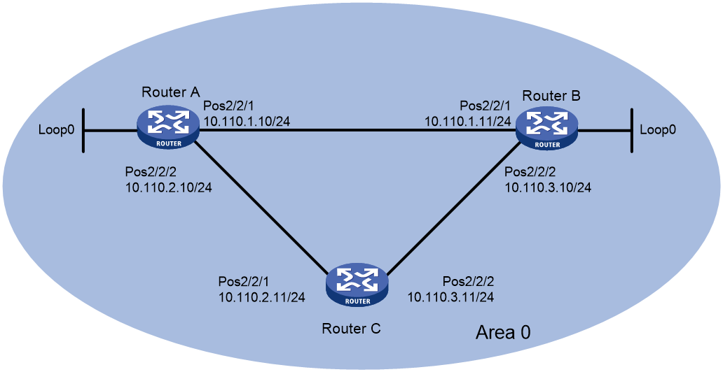

Use a pair of single-mode fibers (one Tx and one Rx) to directly connect the POS interfaces of Router A and Router B, Router A and Router C, and Router B and Router C through PPP. Each device uses the Open Shortest Path First (OSPF) protocol to connect to the other two devices. Configure the network to meet the following requirements:
· When the link between Router A and Router B is intact, the traffic forwarding path from Router A to Router B is Router A -> Router B.
· When Router A receives the multiplexer section remote defect indication (MS-RDI) signals from the peer Router B and the MS-RDI signals continue for 100ms, the physical state of the interface will be automatically set to down.
· When interface POS 2/1/1 on Router A is down, the traffic forwarding path from Router A to Router B is Router A—>Router C—>Router B.
Figure 1 Network diagram
Analysis
· To automatically set the physical state of the interface to down upon receiving an MS-RDI signal from the peer, configure the action to take when alarms are received on the current interface. An RDI alarm occurs if the device receives MS-RDI signals from the remote end.
· To ensure that the POS interface is shut down if the MS-RDI signal persists for 100ms rather than immediately upon receiving an MS-RDI signal from the peer, configure the physical state change suppression interval as 100ms on the POS interface.
Software versions used
This configuration example was created and verified on R9141P16 of the SR6608-M device.
When the POS interfaces of two routers are directly connected, configure one end to use the master clock mode and the other end to use the slave clock mode.

# Configure interface POS 2/1/1 on Router A to go down when it continuously receives RDI alarms for 100 milliseconds.
<RouterA> display interface pos 2/1/1 brief
Brief information on interfaces in route mode:
Link: ADM - administratively down; Stby - standby
Protocol: (s) - spoofing
Interface Link Protocol Primary IP Description
Pos2/1/1 DOWN DOWN --
# When interface POS 2/1/1 on Router A is down, check the route information for IP address 2.2.2.2/32. Verify that Router A and Router B have switched to communicate through Router C.
<RouterA> display ip routing-table 2.2.2.2 verbose
Summary Count : 1
Destination: 2.2.2.2/32
Protocol: OSPF Process ID: 1
SubProtID: 0x1 Age: 04h20m37s
Cost: 2 Preference: 10
IpPre: N/A QosLocalID: N/A
Tag: 0 State: Active Adv
OrigTblID: 0x0 OrigVrf: default-vrf
TableID: 0x2 OrigAs: 0
NBRID: 0x26000002 LastAs: 0
AttrID: 0xffffffff Neighbor: 0.0.0.0
Flags: 0x1008c OrigNextHop: 10.110.2.11
Label: NULL RealNextHop: 10.110.2.11
BkLabel: NULL BkNextHop: N/A
Tunnel ID: Invalid Interface: Pos2/1/2
BkTunnel ID: Invalid BkInterface: N/A
FtnIndex: 0x0 TrafficIndex: N/A
Connector: N/A
