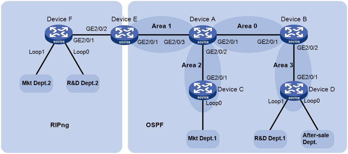

Example: Configuring OSPF route filtering
As shown in Figure 1, the devices of an enterprise reside in OSPF and RIP domains. Configure route redistribution between OSPF and RIP to interconnect the devices. Configure route filtering on Device E, Device C, and Device D to meet the following requirements:
·     The route destined for R&D department 2 is not redistributed to OSPF.
·     Marketing department 1 cannot reach R&D department 1.
·     R&D department 1 and the After-sale service department cannot reach Marketing department 2.
Figure 1 Network diagram
Device
Interface
IP address
Device
Interface
IP address
Device A
GE1/0/1
10.1.1.1/24
Device B
GE1/0/1
10.1.1.2/24
GE1/0/2
10.2.1.1/24
GE1/0/2
10.3.1.1/24
GE1/0/3
10.4.1.1/24
Device C
GE1/0/1
10.2.1.2/24
Device D
GE1/0/1
10.3.1.2/24
Loop0
192.168.3.1/24
Loop0
192.168.1.1/24
Loop1
192.168.2.1/24
Device E
GE1/0/1
10.4.1.2/24
Device F
GE1/0/1
10.5.1.2/24
GE1/0/2
10.5.1.1/24
Loop0
192.168.4.1/24
Loop1
192.168.5.1/24

# Verify that the After-sale service department cannot reach Marketing department 2.
[DeviceD] ping -a 192.168.1.1 192.168.5.1
Ping 192.168.5.1 (192.168.5.1) from 192.168.1.1: 56 data bytes, press CTRL_C to
break
Request time out
Request time out
Request time out
Request time out
Request time out
--- Ping statistics for 192.168.5.1 ---
5 packet(s) transmitted, 0 packet(s) received, 100.0% packet loss
# Verify that R&D department 1 cannot reach Marketing department 2.
[DeviceD] ping -a 192.168.2.1 192.168.5.1
Ping 192.168.5.1 (192.168.5.1) from 192.168.2.1: 56 data bytes, press CTRL_C to
break
Request time out
Request time out
Request time out
Request time out
Request time out
The output on Device C and Device D shows that Device E has filtered the route destined for R&D development 2.
Configuration files
Device A
ospf 1
 area 0.0.0.0
  network 10.1.1.0 0.0.0.255
 area 0.0.0.1
network 10.4.1.0 0.0.0.255
area 0.0.0.2
  network 10.2.1.0 0.0.0.255
 port link-mode route
 ip address 10.2.1.1 255.255.255.0
 ip address 10.4.1.1 255.255.255.0
Device B
ospf 1
 area 0.0.0.0
 area 0.0.0.3
  network 10.3.1.0 0.0.0.255
 ip address 10.1.1.2 255.255.255.0
 ip address 10.3.1.1 255.255.255.0
Device C
ospf 1
 filter-policy 2000 import
 area 0.0.0.2
  network 192.168.3.0 0.0.0.255
interface LoopBack0
 ip address 192.168.3.1 255.255.255.0
 ip address 10.2.1.2 255.255.255.0
acl number 2000
 rule 0 deny source 192.168.2.0 0.0.0.255
rule 5 permit
Device D
ospf 1
 area 0.0.0.3
  network 192.168.1.0 0.0.0.255
  network 192.168.2.0 0.0.0.255
interface LoopBack0
interface LoopBack1
 ip address 192.168.2.1 255.255.255.0
 ip address 10.3.1.2 255.255.255.0
acl number 2000
 rule 0 deny source 192.168.5.0 0.0.0.255
rule 5 permit
Device E
ospf 1
 import-route direct
 import-route rip 1
 filter-policy 2000 export rip 1
 area 0.0.0.1
rip 1
 undo summary
 version 2
 network 10.5.1.0 0.0.0.255
 import-route direct
 import-route ospf 1
 ip address 10.4.1.2 255.255.255.0
 ip address 10.5.1.1 255.255.255.0
acl number 2000
 rule 0 deny source 192.168.4.0 0.0.0.255
rule 5 permit
Device F
rip 1
 undo summary
 version 2
 network 192.168.4.0
 network 192.168.5.0
interface LoopBack0
 ip address 192.168.4.1 255.255.255.0
interface LoopBack1
 ip address 192.168.5.1 255.255.255.0
 ip address 10.5.1.2 255.255.255.0
