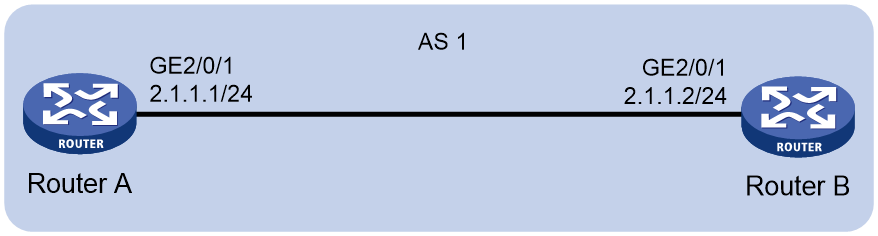

Example: Configuring an EAA monitor policy to suppress route flapping
As shown in Figure 1, Router A and Router B run BGP. To prevent network route flapping when BGP peers comes up and goes down repeatedly, configure an EAA monitor policy on Router B to meet the following requirements:
·     Disable the BGP peer relationship automatically when the BGP peer comes up and goes down three times in 10 minutes.
·     Enable BGP peer relationship every 60 minutes.
Figure 1 Network diagram
Analysis
·     For Router A and Router B to automatically disable the BGP peer relations when the BGP peer comes up and goes down consecutively, configure an EAA monitoring policy for them.
·     To enable BGP peer relations between Router A and Router B every 60 minutes, configure a schedule task for them.

Configure Router A
1.     Assign IP addresses to interfaces.
# Assign an IP address to GigabitEthernet 2/0/1.
<RouterA> system-view
[RouterA] interface gigabitethernet 2/0/1
[RouterA-GigabitEthernet2/0/1] ip address 2.1.1.1 255.255.255.0
[RouterA-GigabitEthernet2/0/1] quit
2.     Configure BGP routing.
# Create BGP instance 1 and enter its view. Set the Router ID for BGP to 2.1.1.1. Create BGP peer 2.1.1.2 and set its AS number to 1.
[RouterA] bgp 1
[RouterA-bgp] router-id 2.1.1.1
[RouterA-bgp] peer 2.1.1.2 as-number 1
# Create the BGP IPv4 unicast address family and enter its view. Enable BGP to redistribute direct routes.
[RouterA-bgp] address-family ipv4 unicast
[RouterA-bgp-ipv4] import-route direct
# Enable BGP to exchange IPv4 unicast routing information with peer 2.1.1.2.
[RouterA-bgp-ipv4] peer 2.1.1.2 enable
[RouterA-bgp-ipv4] quit
Configure Router B
<RouterB> system-view
[RouterB] interface gigabitethernet 2/0/1
[RouterB-GigabitEthernet2/0/1] ip address 2.1.1.2 255.255.255.0
[RouterB-GigabitEthernet2/0/1] quit
# Create BGP instance 1 and enter its view. Set the Router ID for BGP to 2.1.1.1. Create BGP peer 2.1.1.1 and set its AS number to 1.
[RouterB] bgp 1
[RouterB-bgp] router-id 2.1.1.2
[RouterB-bgp] peer 2.1.1.1 as-number 1
[RouterB-bgp] address-family ipv4 unicast
[RouterB-bgp-ipv4] import-route direct
# Enable BGP to exchange IPv4 unicast routing information with peer 2.1.1.1.
[RouterB-bgp-ipv4] peer 2.1.1.1 enable
[RouterB-bgp-ipv4] quit
3.     Configure a CLI monitor policy.
# Create CLI monitor policy 1.
[RouterB] rtm cli-policy 1
# Add a CLI event that occurs when a log message that contains "2.1.1.1 state has changed from ESTABLISHED to IDLE" is displayed 3 times within 10 minutes (600 seconds) and the log priority is higher or equal to 5.
[RouterB-rtm-1] event syslog priority 5 msg "2.1.1.1 state has changed from ESTABLISHED to IDLE" occurs 3 period 600
# Add an action that enters system view when the event occurs.
[RouterB-rtm-1] action 0 cli system-view
# Add an action that enters BGP view when the event occurs.
[RouterB-rtm-1] action 1 cli bgp 1
# Add an action that enters BGP IPv4 unicast address family view when the event occurs.
[RouterB-rtm-1] action 2 cli address-family ipv4 unicast
# Add an action that disables BGP from exchanging IPv4 unicast routing information with peer 2.1.1.1 in the IPv4 unicast address family view when the event occurs.
[RouterB-rtm-1] action 3 cli undo peer 2.1.1.1 enable
# Specify the network-admin user role for executing the policy.
[RouterB-rtm-1] user-role network-admin
# Enable CLI monitor policy 1.
[RouterB-rtm-1] commit
[RouterB-rtm-1] quit
4.     Configure a scheduled task.
# Create a job named 1 and enter its view.
[RouterB] scheduler job 1
# Assign a command to the job to enter system view.
[RouterB-job-1] command 0 system-view
# Assign a command to the job to enter BGP view.
[RouterB-job-1] command 1 bgp 1
# Assign a command to the job to enter BGP IPv4 unicast address family view.
[RouterB-job-1] command 2 address-family ipv4 unicast
# Assign a command to the job to enable BGP to exchange IPv4 unicast routing information with peer 2.1.1.1 in the IPv4 unicast address family view.
[RouterB-job-1] command 3 peer 2.1.1.1 enable
[RouterB-job-1] quit
5.     Configure a schedule.
# Create a schedule named 1 and enter its view.
[RouterB] scheduler schedule 1
# Allocate the job named 1 to the schedule.
[RouterB-schedule-1] job 1
# Configure the device to execute the schedule every 60 minutes.
[RouterB-schedule-1] time repeating interval 60
[RouterB-schedule-1] quit
# Execute the display rtm policy registered command to verify that a CLI-defined monitor policy named 1 has been created.
<RouterB> display rtm policy registered
Total number: 1
Type  Event      TimeRegistered       PolicyName
CLI   SYSLOG     Jun 18 09:41:06 2014 1
# If the following log is generated on Router B when the BGP peer of Router A and Router B comes up and goes down three times within 10 minutes, the policy is running successfully.
%Jun 18 14:19:26:246 2014 Router RTM/6/RTM_POLICY: CLI policy 1 is running successfully.
# Enter BGP view on Router B and verify that BGP is disabled from exchanging IPv4 unicast routing information with peer 2.1.1.1 in the BGP IPv4 unicast address family view.
[RouterB-bgp] display this
bgp 1
 router-id 2.1.1.2
  import-route direct
Return
# Enter BGP view on Router B 60 minutes later. Verify that BGP is enabled to exchange IPv4 unicast routing information with peer 2.1.1.1 in the BGP IPv4 unicast address family view.
bgp 1
 router-id 2.1.1.2
  import-route direct
  peer 2.1.1.1 enable
Return
[RouterB-bgp] quit
# Execute the display bgp peer ipv4 command to verify that Router A and Router B  has established a BGP peer relationship.
[RouterB] display bgp peer ipv4
 BGP local router ID: 2.1.1.2
 Local AS number: 1
 Total number of peers: 1                  Peers in established state: 1
  Peer                    AS  MsgRcvd  MsgSent OutQ PrefRcv Up/Down  State
  2.1.1.1                  1       23       23    0       1 00:16:04 Established

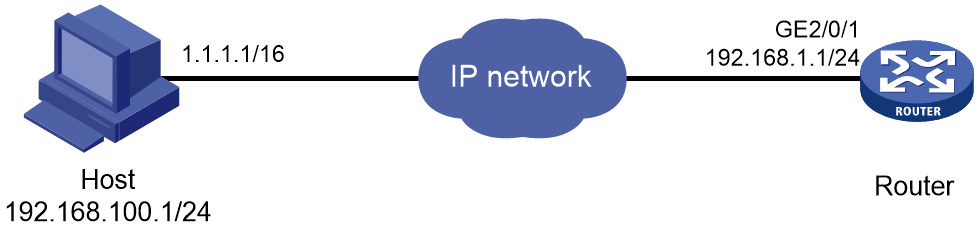

Example: Configuring an EAA monitor policy for automatic configuration rollback
As shown in Figure 2, the administrator remotely configures the router. To avoid network disconnectivity caused by certain configurations, back up the configuration file in advance. Use NQA to monitor network connectivity. Configure EAA monitor policy to automatically restore the available backup configuration and restart the device when the network is disconnected.

2.     Configure an NQA operation.
# Create an ICMP echo-type NQA operation with administrator name admin and operation tag test. Specify 192.168.100.1 as the destination IP address.
[Router] nqa entry admin test
[Router-nqa-admin-test] type icmp-echo
[Router-nqa-admin-test-icmp-echo] data-size 20
[Router-nqa-admin-test-icmp-echo] destination ip 192.168.100.1
# Configure the operation to repeat every 1000 milliseconds and set the probe timeout time to 500 milliseconds.
[Router-nqa-admin-test-icmp-echo] frequency 1000
[Router-nqa-admin-test-icmp-echo] probe timeout 500
# Set the maximum number of history records that can be saved to 10.
[Router-nqa-admin-test-icmp-echo] history-record enable
[Router-nqa-admin-test-icmp-echo] history-record number 10
# Create reaction entry 1 for monitoring the probe failures in ICMP echo operation. Before the NQA operation starts, the initial state of the reaction entry is invalid. If the total number of probe failures reaches or exceeds 5, the state of the entry is set to over-threshold. If it is below the threshold, the state of the entry is set to below-threshold.
[Router-nqa-admin-test-icmp-echo] reaction 1 checked-element probe-fail threshold-type consecutive 5 action-type none
[Router-nqa-admin-test-icmp-echo] quit
# Schedule the operation with administrator name test and operation tag test to start immediately and last forever.
[Router] nqa schedule admin test start-time now lifetime forever
# Enable SNMP.
[Router] snmp-agent
3.     Configure a CLI-defined EAA monitor policy.
# Create CLI monitoring policy 1.
[Router] rtm cli-policy 1
# Add a CLI event: Configure the system to check the value of MIB object 1.3.6.1.4.1.25506.8.3.1.13.1.11.1.49.1.49.1 every 5 seconds. Trigger and execute the monitor policy and disable monitoring when the value is 2. Restart monitoring when the value is 3.
[Router-rtm-1] event snmp oid 1.3.6.1.4.1.25506.8.3.1.13.1.11.1.49.1.49.1 monitor-obj get start-op eq start-val 2 restart-op eq restart-val 3 interval 5
# Add an action that specifies eaa_test_backup.cfg as the next-startup configuration file when the event occurs.
[Router-rtm-1] action 0 cli startup saved-configuration eaa_test_backup.cfg
# Add an action that reboots the device when the event occurs.
[Router-rtm-1] action 1 reboot
# Enable CLI-defined monitor policy 1.
[Router-rtm-1] commit
[Router-rtm-1] quit
[Router] display rtm policy registered
Total number: 1
CLI   SNMP       Jul 10 15:31:37 2014 1
# Change the IP address of GigabitEthernet 2/0/1 on the router, making the router disconnected from the host.
[Router] interface gigabitethernet 2/0/1
[Router-GigabitEthernet2/0/1] ip address 10.1.1.1 24
[Router-GigabitEthernet2/0/1] quit
# Verify that the device reboots.
%Jul 10 15:33:40:112 2024 Router DEV/5/SYSTEM_REBOOT: System is rebooting now.
System is starting...
Press Ctrl+D to access BASIC-BOOTWARE MENU...
Press Ctrl+T to start heavy memory test
Booting Normal Extended BootWare
The Extended BootWare is self-decompressing....Done.
*                  BootWare, Version 9.1.063                               *
Copyright (c) 2004-2024 New H3C Technologies Co., Ltd.
Compiled Date       : Apr  1 2024
CPU ID              : 0x3
Memory Type         : DDR3 SDRAM
Memory Size         : 2048MB
BootWare Size       : 1024KB
Flash Size          : 8MB
cfa0 Size           : 497MB
CPLD Version        : 2.0
PCB Version         : 2.0
BootWare Validating...
Press Ctrl+B to access EXTENDED-BOOTWARE MENU...
Loading the main image files...
System image is starting...
Line con1 is available.
Press ENTER to get started.
<Router>%Jul 10 16:15:08:059 2024 Router SHELL/5/SHELL_LOGIN: Console logged in from con1.
<Router>

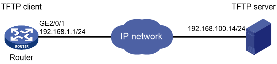

Example: Configuring an EAA monitor policy to monitor and maintain the device running status automatically
As shown in Figure 3, the router has network connectivity to the TFTP server. To prevent high CPU usage on the router, configure an EAA monitor policy to monitor the CPU usage of the router automatically and perform the following actions when the CPU usage exceeds 80%:
·     Display the memory information, interface statistics, and routing table information at the time when the CPU usage exceeds 80%, and save them to a specified file.
·     Upload the file to the TFTP server.
·     After uploading the file to the TFTP server, delete the local file.
Figure 3 Network diagram
Software version used
This configuration example was created and verified on R9141P16 of the SR6608-M router.

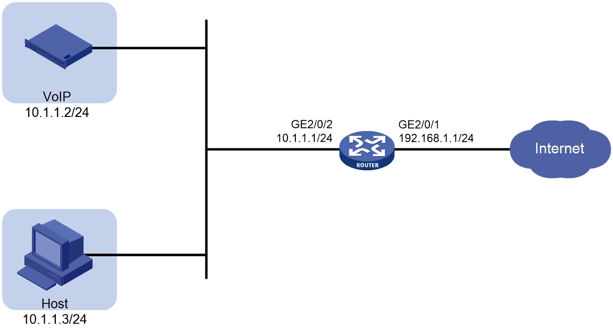

Example: Configuring an EAA monitor policy for automatic bandwidth assurance for video conferencing
As shown in Figure 4, a host and a VoIP video system access the Internet through the router. When a video conference is held, it requires a significant amount of bandwidth, and it is necessary to limit the Internet traffic of the host. Configure an EAA monitor policy on the router to meet the following requirements:
·     When the video traffic is greater than or equal to 100000 packets per second, disallow host packets to pass and allow only video package to pass.
·     When the video traffic is less than 100000 packets per second, allow both video and host packets to pass.
Figure 4 Network diagram
·     You can configure only one event and runtime for an EAA monitor policy.  If you execute the event or running-time command multiple times, the most recent configuration that has been committed takes effect.
·     If two actions have the same ID, the most recent configured action that has been committed takes effect.
·     After configuring an event, action, user role, and runtime for a CLI-defined monitor policy, you must execute the commit command to commit configuration for the configuration to take effect.
<Router> system-view
[Router-GigabitEthernet2/0/1] ip address 192.168.1.1 255.255.255.0
# Assign an IP address to GigabitEthernet 2/0/2.
[Router] interface gigabitethernet 2/0/2
[Router-GigabitEthernet2/0/2] ip address 10.1.1.1 255.255.255.0
[Router-GigabitEthernet2/0/2] quit
2.     Configuring an ACL policy
# Configure ACL 3001 to permit packets only from source address 10.1.1.2.
[Router] acl number 3001
[Router-acl-adv-3001] rule 0 permit ip source 10.1.1.2 0
[Router-acl-adv-3001] quit
# Create ACL 3002 to deny packets from source address 10.1.1.2 and permit other packets.
[Router] acl number 3002
[Router-acl-adv-3002] rule 0 deny ip source 10.1.1.2 0
[Router-acl-adv-3002] rule 5 permit ip
[Router-acl-adv-3002] quit
# Apply ACL 3001 on the inbound traffic direction on GigabitEthernet 2/0/2 to filter packets.
[Router-GigabitEthernet2/0/2] qos car inbound acl 3001 cir 1000
3.     Enable SNMP and configure an environment variable.
# Enable SNMP agent.
[Router] snmp-agent
# Create an environment variable video and set its value to 0.
[Router] rtm environment video 0
4.     Configure CLI monitor policy 1
# Add a CLI event: Configure the system to check the number of packets (MIB object 1.3.6.1.4.1.25506.2.8.2.2.3.1.31.1.3001.0) every 10 seconds. Trigger and execute the policy when the value is greater than or equal to 0.
[Router-rtm-1] event snmp oid 1.3.6.1.4.1.25506.2.8.2.2.3.1.31.1.3001.0 monitor-obj get start-op ge start-val 0 restart-op ge restart-val 0 interval 10
# Add an action that clears ACL 3001 statistics when the event occurs.
[Router-rtm-1] action 0 cli reset acl counter 3001
# Add an action that enters Tcl configuration view from user view when the event occurs.
[Router-rtm-1] action 1 cli tclsh
# Add an action that enters system view from user view when the event occurs.
[Router-rtm-1] action 2 cli system-view
# Add an action that checks the number of received messages from the video device when the event occurs. If the number reaches 100000, permit only video traffic from 10.1.1.2 on GigabitEthernet 2/0/2 and limit the committed information rate of other traffic to 1024 kbps.
[Router-rtm-1] action 3 cli if { $_oid_value >= 100000 && $video == 0 } { rtm environment video 1; interface gigabitethernet 2/0/2; qos car inbound acl 3002 cir 1024}
# Add an action that checks the number of received messages from the video device when the event occurs. If the number is less than 100000, permit not only video traffic but also other traffic on GigabitEthernet 2/0/2.
[Router-rtm-1] action 4 cli if { $_oid_value < 100000 && $video == 1 } { rtm environment video 0; interface gigabitethernet 2/0/2; undo qos car inbound acl 3002}
[Router-rtm-1] quit
Total number: 1
CLI   SNMP       Jul 11 16:07:51 2014 1
# When the video traffic on GigabitEthernet 2/0/2 reaches or exceeds 100000 packets per second, a log is displayed that EAA monitor policy 1 has been executed successfully.
%Jul 11 16:13:46:552 2014 Router RTM/6/RTM_POLICY: CLI policy 1 is running successfully.
Configuration files
acl number 3001
acl number 3002
 rule 5 permit ip
interface GigabitEthernet2/0/1
 port link-mode route
interface GigabitEthernet2/0/2
snmp-agent
rtm cli-policy 1
 action 1 cli tclsh
 action 3 cli if { $_oid_value >= 100000 && $video == 0 } { rtm environment video 1; interface GigabitEthernet2/0/2; qos car inbound acl 3002 cir 1024}
 action 4 cli if { $_oid_value < 100000 && $video == 1 } { rtm environment video 0; interface GigabitEthernet2/0/2; undo qos car inbound acl 3002}
 commit

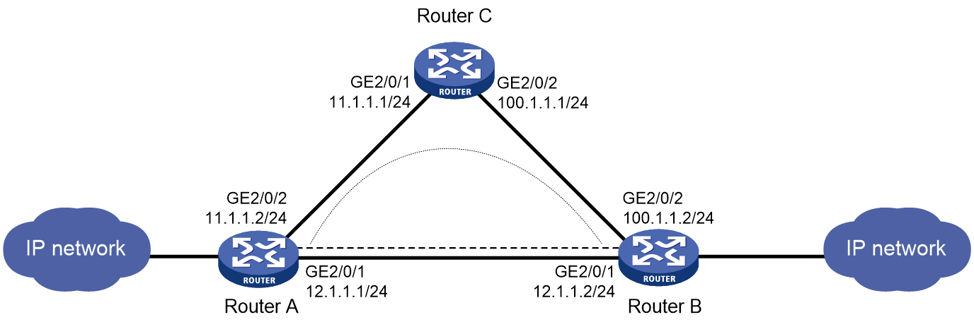

Example: Configuring an EAA monitor policy to enable primary/backup link switchover based on the link quality
As shown in Figure 5, Router A and Router B are reachable to each other. Typically, the direct link between Router A and Router B acts as the primary link, and the link through Router C acts as the backup link. Configure an EAA monitor policy on Router A to meet the following requirements:
·     When the primary link has a packet loss rate exceeding 20% or a delay greater than 200 ms, switch over the traffic to the backup link.
·     When the primary link does not have packet loss and has a latency less than 100 ms, switch back the traffic to the primary link.
Figure 5 Network diagram
Analysis
Use an EAA monitor policy to monitor the state of the NQA reaction entry. When the monitored object exceeds the threshold of the specified type, the EAA monitor policy is automatically triggered. The NQA reaction entry state (MIB value) is as follows:
·     When the state is invalid (MIB value is 1), the NQA operation is not started.
·     When the state is overThreshold (MIB value is 2), the monitored object exceeds the threshold of the specified type.
·     When the state is belowThreshold (MIB value is 3), the monitored object does not exceed the threshold of the specified type.
Configure Router A
[RouterA-GigabitEthernet2/0/1] port link-mode route
[RouterA-GigabitEthernet2/0/1] ip address 12.1.1.1 255.255.255.0
[RouterA] interface gigabitethernet 2/0/2
[RouterA-GigabitEthernet2/0/2] port link-mode route
[RouterA-GigabitEthernet2/0/2] ip address 11.1.1.2 255.255.255.0
[RouterA-GigabitEthernet2/0/2] quit
# Create an ICMP echo-type NQA operation with administrator name 1 and operation tag 1. Specify 12.1.1.2 as the destination IP address.
[RouterA] nqa entry 1 1
[RouterA-nqa-1-1] type icmp-echo
[RouterA-nqa-1-1-icmp-echo] destination ip 12.1.1.2
# Configure the operation to repeat every 15000 milliseconds and set the probe timeout time to 800 milliseconds. Configure the ICMP echo operation to perform 15 probes.
[RouterA-nqa-1-1-icmp-echo] frequency 15000
[RouterA-nqa-1-1-icmp-echo] probe timeout 800
[RouterA-nqa-1-1-icmp-echo] probe count 15
# Create reaction entry 1 for monitoring the ICMP-echo probe duration, and set the upper limit to 200 milliseconds and lower limit to 0 milliseconds. Before the NQA operation starts, the initial state of the reaction entry is invalid. After the operation, the average probe duration is checked. If it exceeds the upper limit, the state is set to over-threshold. If it is below the lower limit, the state of the reaction entry is set to below-threshold.
[RouterA-nqa-1-1-icmp-echo] reaction 1 checked-element probe-duration threshold-type average threshold-value 200 0 action-type none
# Create reaction entry 2 for monitoring the number of ICMP-echo probe failures. Before the NQA operation starts, the initial state of the reaction entry is invalid. If the total number of probe failures reaches or exceeds 3, the state of the entry is set to over-threshold. If it is below the threshold, the state of the entry is set to below-threshold.
[RouterA-nqa-1-1-icmp-echo] reaction 2 checked-element probe-fail threshold-type accumulate 3 action-type none
# Create reaction entry 3 for monitoring the ICMP-echo probe duration, and set the upper limit to 100 milliseconds and lower limit to 0 milliseconds. Before the NQA operation starts, the initial state of the reaction entry is invalid. After the operation, the average probe duration is checked. If it reaches the upper limit, the state is set to over-threshold. If it is below the lower limit, the state of the reaction entry is set to below-threshold.
[RouterA-nqa-1-1-icmp-echo] reaction 3 checked-element probe-duration threshold-type average threshold-value 100 0 action-type none
# # Create reaction entry 4 for monitoring the probe failures in ICMP echo operation. Before the NQA operation starts, the initial state of the reaction entry is invalid. If the total number of probe failures reaches or exceeds 1, the state of the entry is set to over-threshold. If it is below the threshold, the state of the entry is set to below-threshold.
[RouterA-nqa-1-1-icmp-echo] reaction 4 checked-element probe-fail threshold-type accumulate 1 action-type none
[RouterA-nqa-1-1-icmp-echo] quit
# Enable the NQA client.
[RouterA] nqa agent enable
# Schedule the operation with administrator name 1 and operation tag 1 to start immediately and last forever.
[RouterA] nqa schedule 1 1 start-time now lifetime forever
[RouterA] snmp-agent
3.     Configure environment variables for the monitor policy.
# Create environment variable delay for the monitor policy and set its value to 0.
[RouterA] rtm environment delay 0
# Create environment variable loss for the monitor policy and set its value to 0.
[RouterA] rtm environment loss 0
# Create environment variable backup for the monitor policy and set its value to 0.
[RouterA] rtm environment backup 0
4.     Configure CLI-defined monitor policy 1.
# Create CLI-defined monitor policy 1.
[RouterA] rtm cli-policy 1
# Configure the system to check the value of MIB object 1.3.6.1.4.1.25506.8.3.1.13.1.11.1.49.1.49.1 every 10 seconds. Trigger and execute the monitor policy and disable monitoring when the value of the MIB object is 2 and restart monitoring is when the value is 3.
[RouterA-rtm-1] event snmp oid 1.3.6.1.4.1.25506.8.3.1.13.1.11.1.49.1.49.1 monitor-obj get start-op eq start-val 2 restart-op eq restart-val 3 interval 10
[RouterA-rtm-1] action 0 cli tclsh
[RouterA-rtm-1] action 1 cli system-view
# Add an action that changes the value of environment variable delay from 0 to 1.
[RouterA-rtm-1] action 2 cli if { $delay==0 } { rtm environment delay 1 }
# Add an action that changes the value of environment variable backup from 0 to 1, and configures a static route destined to 100.1.1.0/24 with next hop 11.1.1.1 and priority 10.
[RouterA-rtm-1] action 3 cli if { $backup==0 } { rtm environment backup 1; ip route-static 100.1.1.0 24 11.1.1.1 preference 10 }
[RouterA-rtm-1] commit
[RouterA-rtm-1] quit
5.     Configure CLI monitor policy 2.
# Create CLI monitor policy 2
[RouterA] rtm cli-policy 2
# Add a CLI event: Configure the system to check the value of MIB object 1.3.6.1.4.1.25506.8.3.1.13.1.11.1.49.1.49.2 every 10 seconds. Trigger and execute the monitor policy and disable monitoring when the value of the MIB object is 2 and restart monitoring is when the value is 3.
[RouterA-rtm-2] event snmp oid 1.3.6.1.4.1.25506.8.3.1.13.1.11.1.49.1.49.2 monitor-obj get start-op eq start-val 2 restart-op eq restart-val 3 interval 10
[RouterA-rtm-2] action 0 cli tclsh
[RouterA-rtm-2] action 1 cli system-view
# Add an action that changes the value of environment variable loss from 0 to 1 when the event occurs.
[RouterA-rtm-2] action 2 cli if { $loss==0 } { rtm environment loss 1 }
# Add an action that changes the value of environment variable backup from 0 to 1, and configures a static route destined to 100.1.1.0/24 with next hop 11.1.1.1 and priority 10 when the event occurs.
[RouterA-rtm-2] action 3 cli if { $backup==0 } { rtm environment backup 1; ip route-static 100.1.1.0 24 11.1.1.1 preference 10 }
# Enable CLI monitoring policy 2.
[RouterA-rtm-2] user-role network-admin
[RouterA-rtm-2] commit
6.     Configure CLI monitoring policy 3
# Create CLI monitoring policy 3.
[RouterA] rtm cli-policy 3
# Add a CLI event: Configure the system to check the value of MIB object 1.3.6.1.4.1.25506.8.3.1.13.1.11.1.49.1.49.3 every 10 seconds. Trigger and execute the monitor policy and disable monitoring when the value of the MIB object is 2 and restart monitoring is when the value is 3.
[RouterA-rtm-3] event snmp oid 1.3.6.1.4.1.25506.8.3.1.13.1.11.1.49.1.49.3 monitor-obj get start-op eq start-val 3 restart-op eq restart-val 2 interval 10
[RouterA-rtm-3] action 0 cli tclsh
[RouterA-rtm-3] action 1 cli system-view
# Add an action that changes the value of environment variable delay from 0 to 1 when the event occurs.
[RouterA-rtm-3] action 2 cli if { $delay==1 } { rtm environment delay 0 }
# Add an action that waits for 5000 milliseconds after the event occurs.
[RouterA-rtm-3] action 3 cli after 5000
# Add an action that changes the value of environment variables backup and loss to 0, and delete the static route destined to 100.1.1.0/24 with next hop 11.1.1.1 and priority 10.
[RouterA-rtm-3] action 4 cli if { $backup==1 && $loss==0 } { undo ip route-static 100.1.1.0 24 11.1.1.1 preference 10; rtm environment backup 0 }
# Enable CLI monitor policy 3.
[RouterA-rtm-3] user-role network-admin
[RouterA-rtm-3] commit
7.     Configure CLI monitor policy 4.
# Create CLI monitor policy 4.
[RouterA] rtm cli-policy 4
# Add a CLI event: Configure the system to check the value of MIB object 1.3.6.1.4.1.25506.8.3.1.13.1.11.1.49.1.49.4 every 10 seconds. Trigger and execute the monitor policy and disable monitoring when the value of the MIB object is 2 and restart monitoring is when the value is 3.
[RouterA-rtm-4] event snmp oid 1.3.6.1.4.1.25506.8.3.1.13.1.11.1.49.1.49.4 monitor-obj get start-op eq start-val 3 restart-op eq restart-val 2 interval 10
[RouterA-rtm-4] action 0 cli tclsh
[RouterA-rtm-4] action 1 cli system-view
# Add an action that changes the value of environment variable loss from 1 to 0 when the event occurs.
[RouterA-rtm-4] action 2 cli if { $loss==1 } { rtm environment loss 0 }
[RouterA-rtm-4] action 3 cli after 5000
# Add an action that keeps the value of environment variables backup and delay at 0, and configures a static route destined to 100.1.1.0/24 with next hop 11.1.1.1 and priority 10 when the event occurs.
[RouterA-rtm-4] action 4 cli if { $backup==1 && $delay==0 } { undo ip route-static 100.1.1.0 24 11.1.1.1 preference 10;  rtm environment backup 0 }
# Enable CLI monitor policy 4.
[RouterA-rtm-4] user-role network-admin
[RouterA-rtm-4] commit
[RouterA-rtm-4] quit
Configure Router B
1.     Assign IP addresses to interfaces:
[RouterB-GigabitEthernet2/0/1] port link-mode route
[RouterB-GigabitEthernet2/0/1] ip address 12.1.1.2 255.255.255.0
[RouterB] interface gigabitethernet 2/0/2
[RouterB-GigabitEthernet2/0/2] port link-mode route
[RouterB-GigabitEthernet2/0/2] ip address 100.1.1.2 255.255.255.0
[RouterB-GigabitEthernet2/0/2] quit
2.     Configure OSPF routing to enable network connectivity between Router C and Router B.
[RouterB] ospf 1
[RouterB-ospf-1] area 0.0.0.0
[RouterB-ospf-1-area-0.0.0.0] network 12.1.1.0 0.0.0.255
[RouterB-ospf-1-area-0.0.0.0] network 100.1.1.0 0.0.0.255
[RouterB-ospf-1-area-0.0.0.0] quit
[RouterB-ospf-1] quit
Configure Router C
<RouterC> system-view
[RouterC] interface gigabitethernet 2/0/1
[RouterC-GigabitEthernet2/0/1] port link-mode route
[RouterC-GigabitEthernet2/0/1] ip address 11.1.1.1 255.255.255.0
[RouterC-GigabitEthernet2/0/1] quit
[RouterC] interface gigabitethernet 2/0/2
[RouterC-GigabitEthernet2/0/2] port link-mode route
[RouterC-GigabitEthernet2/0/2] ip address 100.1.1.1 255.255.255.0
[RouterC-GigabitEthernet2/0/2] quit
2.     Configure OSPF routing to enable network connectivity between Router B and Router C.
[RouterC] ospf 1
[RouterC-ospf-1] area 0.0.0.0
[RouterC-ospf-1-area-0.0.0.0] network 11.1.1.0 0.0.0.255
[RouterC-ospf-1-area-0.0.0.0] network 100.1.1.0 0.0.0.255
[RouterC-ospf-1-area-0.0.0.0] quit
[RouterC-ospf-1] quit
# Display detailed information about all EAA monitor policies.
<RouterA> display rtm policy registered  verbose
  Total number: 4
   Policy Name: 1
   Policy Type: CLI
    Event Type: SNMP
TimeRegistered: Jul 14 15:04:24 2014
     User-role: network-admin
   Policy Name: 2
   Policy Type: CLI
    Event Type: SNMP
TimeRegistered: Jul 14 15:14:50 2014
   Policy Name: 3
   Policy Type: CLI
    Event Type: SNMP
TimeRegistered: Jul 14 15:17:32 2014
   Policy Name: 4
   Policy Type: CLI
    Event Type: SNMP
TimeRegistered: Jul 14 15:18:33 2014
1.     When the message delay from Router A to Router B is 300 milliseconds, exceeding the threshold of 200 milliseconds, observe the information displayed on Router A.
# The log information shows that EAA policy 1 has been successfully executed.
%Jul 14 14:50:16:677 2014 RouterA RTM/6/RTM_POLICY: CLI policy 1 is running successfully.
# Execute the display rtm environment command to display the user-defined EAA environment variables. Verify that the value of environment variable backup changes to 1, and the value of delay changes to 1.
[RouterA] display rtm environment
 Name                 Value
 backup               1
 delay                1
 loss                 0
# Execute the display this command to display the effective configuration in the current view. Verify that a static route to 100.1.1.0/24 exists and traffic from Router A to Router B have been switched over to the backup link.
[RouterA] display this
 sysname RouterA
 snmp-agent
 snmp-agent local-engineid 800063A280000605B36B9E00000001
 snmp-agent sys-info version v3
Return
2.     When the packet loss rate from Router A to Router B is 25%, exceeding the threshold, observe the information displayed on Router A.
# The log information shows that EAA policy 2 has been executed successfully.
%Jul 14 15:15:23:802 2014 RouterA RTM/6/RTM_POLICY: CLI policy 2 is running successfully.
# Execute the display rtm environment command to display the user-defined EAA environment variables. Verify that the value of environment variable loss changes to 1.
 Name                 Value
 backup               1
 delay                1
 loss                 1
# Execute the display this command to display the effective configuration in the current view. Verify that the traffic from Router A still reach Router B over the backup link.
 sysname RouterA
 snmp-agent

3.     When the message delay between Router A and Router B falls to the normal range, and the packet loss rate remains at 25%, observe the information displayed on Router A.
# The log information shows that EAA policy 3 has been successfully executed.
%Jul 14 15:19:13:771 2014 RouterA RTM/6/RTM_POLICY: CLI policy 3 is running successfully.
# Execute the display rtm environment command to display the user-defined EAA environment variables. Verify that the value of environment variable delay changes to 0.
 Name                 Value
 backup               1
 delay                0
 loss                 1
# Execute the display this to display the effective configuration in the current view. Verify that the traffic from Router A still reaches Router B via the backup link.
 sysname RouterA
 snmp-agent
Return
4.     When both the message delay and packet loss rate between Router A and Router B fall to the normal range, observe the information displayed on Router A.
# The log information shows that EAA policy 4 has been executed successfully.
%Jul 14 15:19:13:771 2014 RouterA RTM/6/RTM_POLICY: CLI policy 4 is running successfully.
# Execute the display rtm environment command to display the user-defined EAA environment variables. Verify that the values of environment variables backup, delay, and loss change to 0.
 Name                 Value
 backup               0
 delay                0
 loss                 0
 sysname RouterA
 snmp-agent
Return
Configuration files
·     Router A:
nqa entry 1 1
 type icmp-echo
  frequency 15000
  probe count 15
  probe timeout 800
 snmp-agent
rtm cli-policy 1
 action 0 cli tclsh
rtm cli-policy 2
 event snmp oid 1.3.6.1.4.1.25256.8.3.1.13.1.11.1.49.1.49.2 monitor-obj get start-op eq start-val 2 restart-op eq restart-val 3 interval 10
 action 0 cli tclsh
rtm cli-policy 3
 action 0 cli tclsh
rtm cli-policy 4
 action 0 cli tclsh
·     Router B:
ospf 1
 area 0.0.0.0
·     Router C:
ospf 1
 area 0.0.0.0
