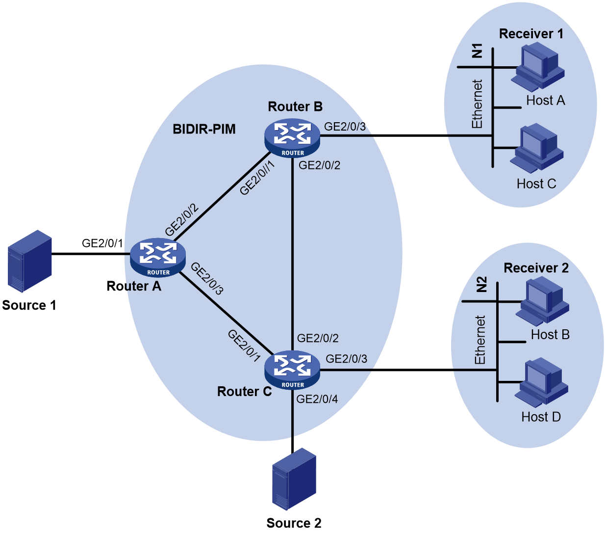

As shown in Figure 1:
·     Router A, Router B, and Router C run OSPF.
·     Source 1 and Source 2 send multicast data to multicast group 225.1.1.1.
·     Host A and Host B are member hosts of multicast group 225.1.1.1.
Configure BIDIR-PIM on the routers to implement multicast forwarding.
Figure 1 Network diagram

Analysis
To meet the network requirements, perform the following tasks:
·     To establish the bidirectional RPT, configure GigabitEthernet 2/0/2 on Router A as a C-RP.
·     To use the BSR mechanism to dynamically elect the RP, configure GigabitEthernet 2/0/2 on Router A as a C-BSR.
·     To avoid multicast forwarding interruption when the RP fails, specify the unused IP address 10.13.1.4/24 as the static RP. In this way, the link on the subnet 10.13.1.0/24 becomes the RPL. Router A and Router C on the link function as the RPs.
