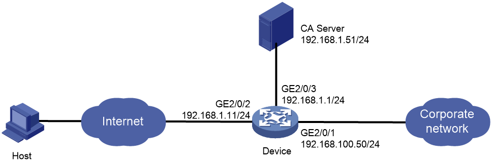

Example: Configuring L2TP over IPsec based on certificate authentication using the iNode client
As shown in Figure 1, establish an L2TP tunnel between the PPP user's host and the device. The specific requirements are as follows:
·     Use the Windows Server 2003 as the CA server.
·     Configure access to the corporate network through the L2TP tunnel.
·     Encrypt the L2TP tunnel data through IPsec.
·     Establish an IPsec tunnel by using the RSA certificate authentication method.
Figure 1 Network diagram
Analysis
To establish an IPsec tunnel using the certificate authentication method, you must execute the local-identity command to specify the DN in the local certificate as the local ID for the IKE profile.
Software versions used
This configuration example was created and verified on R9141P16 of the SR6608-M device.
Procedures
Configuring the device

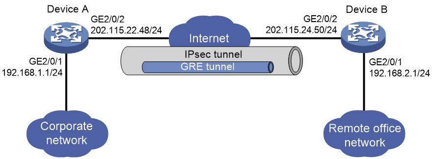

Example: Configuring IPsec over GRE
As shown in Figure 2, the enterprise remote office network accesses the headquarters through IPsec VPN. Configure the network to transmit IPsec encrypted data between the corporate network and the remote office network through a GRE tunnel.
Figure 2 Network diagram
Analysis
To process data with IPsec first and then encapsulate it with GRE, you must configure an ACL to identify the packets to be protected and apply the IPsec policy to the GRE tunnel interface on each device.
To encapsulate the data transmitted between networks with IPsec first and then with GRE, you must configure the remote IP address of the IPsec tunnel as the interface address of the GRE tunnel on each device.
Procedures
Configuring Device A
Table 7 Configure IP addresses for interfaces:
# Assign IP address 192.168.1.1 to interface GigabitEthernet 2/0/1.
<DeviceA> system-view
[DeviceA-GigabitEthernet2/0/1] ip address 192.168.1.1 255.255.255.0
[DeviceA-GigabitEthernet2/0/1] tcp mss 1350
[DeviceA-GigabitEthernet2/0/1] quit
# Assign IP address 202.115.22.48 to interface GigabitEthernet 2/0/2.
[DeviceA] interface gigabitethernet 2/0/2
[DeviceA-GigabitEthernet2/0/2] ip address 202.115.22.48 255.255.255.0
[DeviceA-GigabitEthernet2/0/2] quit
Table 8 Configure the GRE tunnel:
# Create tunnel interface Tunnel 0, and specify the tunnel mode as GRE/IPv4.
[DeviceA] interface tunnel 0 mode gre
# Assign an IP address to interface Tunnel 0.
[DeviceA-Tunnel0] ip address 10.1.1.1 255.255.255.0
# Configure the source address of interface Tunnel 0 (as the IP address of GigabitEthernet 2/0/2 on Device A).
[DeviceA-Tunnel0] source 202.115.22.48
# Configure the destination address of interface Tunnel 0 (as the IP address of GigabitEthernet 2/0/2 on Device B).
[DeviceA-Tunnel0] destination 202.115.24.50
[DeviceA-Tunnel0] quit
# Configure a static route from Device A through interface Tunnel 0 to the remote office network.
[DeviceA] ip route-static 192.168.2.1 255.255.255.0 tunnel 0
Table 9 Configure the IPsec VPN:
# Create an IKE keychain.
[DeviceA] ike keychain keychain1
[DeviceA-ike-keychain-keychain1] pre-shared-key address 10.1.1.2 255.255.255.0 key simple 123
[DeviceA-ike-keychain-keychain1] quit
# Specify ACL 3000 to identify the traffic to be protected.
[DeviceA] acl number 3000
[DeviceA-acl-adv-3000] rule 0 permit ip source 192.168.1.0 0.0.0.255 destination 192.168.2.0 0.0.0.255
[DeviceA-acl-adv-3000] quit
# Create an IPsec transform set.
[DeviceA] ipsec transform-set tran1
[DeviceA-ipsec-transform-set-tran1] esp encryption-algorithm des
[DeviceA-ipsec-transform-set-tran1] esp authentication-algorithm sha1
[DeviceA-ipsec-transform-set-tran1] quit
# Create an IKE-based IPsec policy entry. Specify the policy name as policy1 and set the sequence number to 1.
[DeviceA] ipsec policy policy1 1 isakmp
[DeviceA-ipsec-policy-isakmp-policy1-1] security acl 3000
[DeviceA-ipsec-policy-isakmp-policy1-1] remote-address 10.1.1.2
[DeviceA-ipsec-policy-isakmp-policy1-1] transform-set tran1
[DeviceA-ipsec-policy-isakmp-policy1-1] quit
# Apply IPsec policy policy1 to interface Tunnel 0.
[DeviceA-Tunnel0] ipsec apply policy policy1
Configuring Device B
Table 10 Configure IP addresses for interfaces:
# Assign IP address 192.168.2.1 to interface GigabitEthernet 2/0/1.
<DeviceB> system-view
[DeviceB-GigabitEthernet2/0/1] ip address 192.168.2.1 255.255.255.0
[DeviceB-GigabitEthernet2/0/1] tcp mss 1350
[DeviceB-GigabitEthernet2/0/1] quit
# Assign IP address 202.115.24.50 to interface GigabitEthernet 2/0/2.
[DeviceB] interface gigabitethernet 2/0/2
[DeviceB-GigabitEthernet2/0/2] ip address 202.115.24.50 255.255.255.0
[DeviceB-GigabitEthernet2/0/2] quit
Table 11 Configure the GRE tunnel:
[DeviceB] interface tunnel 0 mode gre
# Assign an IP address to Tunnel 0.
[DeviceB-Tunnel0] ip address 10.1.1.2 255.255.255.0
# Configure the source address of interface Tunnel 0 (as the IP address of GigabitEthernet 2/0/2 on Device B).
[DeviceB-Tunnel0] source 202.115.24.50
# Configure the destination address of interface Tunnel 0 (as the IP address of GigabitEthernet 2/0/2 on Device A).
[DeviceB-Tunnel0] destination 202.115.22.48
[DeviceB-Tunnel0] quit
# Configure a static route from Device B through Tunnel 0 to the corporate network.
[DeviceB] ip route-static 192.168.1.1 255.255.255.0 tunnel 0
Table 12 Configure the IPsec VPN:
[DeviceB] ike keychain keychain1
[DeviceB-ike-keychain-keychain1] pre-shared-key address 10.1.1.1 255.255.255.0 key simple 123
[DeviceB-ike-keychain-keychain1] quit
[DeviceB] acl number 3000
[DeviceB-acl-adv-3000] rule 0 permit ip source 192.168.2.0 0.0.0.255 destination 192.168.1.0 0.0.0.255
[DeviceB-acl-adv-3000] quit
[DeviceB] ipsec transform-set tran1
[DeviceB-ipsec-transform-set-tran1] esp encryption-algorithm des
[DeviceB-ipsec-transform-set-tran1] esp authentication-algorithm sha1
[DeviceB-ipsec-transform-set-tran1] quit
[DeviceB] ipsec policy policy1 1 isakmp
[DeviceB-ipsec-policy-isakmp-policy1-1] security acl 3000
[DeviceB-ipsec-policy-isakmp-policy1-1] remote-address 10.1.1.1
[DeviceB-ipsec-policy-isakmp-policy1-1] transform-set tran1
[DeviceB-ipsec-policy-isakmp-policy1-1] quit
# Apply IPsec policy policy1 to Tunnel 0.
[DeviceB-Tunnel0] ipsec apply policy policy1
# Initiate a connection from the host at 192.168.1.2 in the corporate network to the host at 192.168.2.2 in the remote office network to trigger IKE negotiation. Verify that you can successfully ping 192.168.2.2 from 192.168.1.2 after the IPsec tunnel is successfully established.
C:\Users\corporatenetwork> ping 192.168.2.2
Pinging 192.168.2.2 with 32 bytes of data:
Request timed out.
Reply from 192.168.2.2: bytes=32 time=2ms TTL=254
Reply from 192.168.2.2: bytes=32 time=1ms TTL=254
Ping statistics for 192.168.2.2:
    Packets: Sent = 4, Received = 3, Lost = 1 (25% loss),
Minimum = 1ms, Maximum = 2ms, Average = 1ms
# Execute the display ike sa command to view the IKE SA on Device A.
<DeviceA> display ike sa
    Connection-ID   Remote                Flag         DOI
    1               10.1.1.2              RD           IPSEC
Flags:
RD--READY RL--REPLACED FD-FADING RK-REKEY
# Execute the display ipsec sa command to view the IPsec SA information on Device A.
<DeviceA> display ipsec sa
Interface: Tunnel0
  IPsec policy: policy1
  Sequence number: 1
  Mode: isakmp
    Tunnel id: 0
    Encapsulation mode: tunnel
    Perfect forward secrecy:
    Path MTU: 1419
    Tunnel:
        local  address: 10.1.1.1
        remote address: 10.1.1.2
    Flow:
    sour addr: 192.168.1.1/255.255.255.255  port: 0  protocol: ip
    dest addr: 192.168.2.1/255.255.255.255  port: 0  protocol: ip
    [Inbound ESP SAs]
      SPI: 3128557135 (0xba79fe4f)
      Transform set:  ESP-ENCRYPT-DES-CBC ESP-AUTH-SHA1
      SA duration (kilobytes/sec): 1843200/3600
      SA remaining duration (kilobytes/sec): 1843199/3550
      Max received sequence-number: 3
      Anti-replay check enable: Y
      Anti-replay window size: 64
      UDP encapsulation used for NAT traversal: N
      Status: Active
    [Outbound ESP SAs]
      SPI: 2643166978 (0x9d8b8702)
      Max sent sequence-number: 3
      Status: Active
# Execute the display interface tunnel 0 command to view information about the traffic transmitted through the GRE tunnel on Device A.
<DeviceA> display interface tunnel 0
Tunnel0
Current state: UP
Line protocol state: UP
Description: Tunnel0 Interface
Bandwidth: 64kbps
Maximum Transmit Unit: 1476
Internet Address is 10.1.1.1/24 Primary
Tunnel source 202.115.22.48, destination 202.115.24.50
Tunnel keepalive disabled
Tunnel TTL 255
Tunnel protocol/transport GRE/IP
    GRE key disabled
    Checksumming of GRE packets disabled
Output queue - Urgent queuing: Size/Length/Discards 0/100/0
Output queue - Protocol queuing: Size/Length/Discards 0/500/0
Output queue - FIFO queuing: Size/Length/Discards 0/75/0
Last clearing of counters: Never
Last 300 seconds input rate: 0 bytes/sec, 0 bits/sec, 0 packets/sec
Last 300 seconds output rate: 0 bytes/sec, 0 bits/sec, 0 packets/sec
Input: 40 packets, 3300 bytes, 0 drops
Output: 41 packets, 3464 bytes, 0 drops
# Initiate a connection from a host in the remote office network to a host in the corporate network to verify the connectivity. (Details not shown.)
Configuration files
·     Device A:
interface GigabitEthernet2/0/1
 tcp mss 1350
interface GigabitEthernet2/0/2
interface Tunnel0 mode gre
ip route-static 192.168.2.1 24 Tunnel0
acl number 3000
 esp encryption-algorithm des-cbc
 transform-set tran1
 security acl 3000
 pre-shared-key address 10.1.1.2 255.255.255.0 key cipher $c$3$n6jdlYtuR+K6mijQ8qp4hMMjV/iteA==
·     Device B:
 tcp mss 1350
ip route-static 192.168.1.1 24 Tunnel0
acl number 3000
 transform-set tran1
 security acl 3000
 pre-shared-key address 10.1.1.1 255.255.255.0 key cipher $c$3$n6jdlYtuR+K6mijQ8qp4hMMjV/iteA==

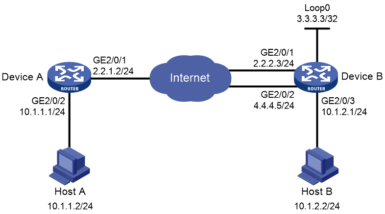

Example: Configuring GRE over IPsec
As shown in Figure 3, the enterprise remote office network transmits data to the headquarters through a GRE tunnel. Configure the network to encrypt the data passing through the GRE tunnel using IPsec.
Figure 3 Network diagram
Analysis
To encrypt the data encapsulated by GRE with IPsec, you must apply the IPsec policy on the physical interface connected to the peer device, and configure the source and destination addresses for the ACL as the physical interface address on each device.
To have IPsec protect the entire GRE tunnel, make sure the physical interface applying the IPsec policy and the GRE tunnel source or destination interface are the same interface.
Procedures
Table 1 Configure IP addresses for interfaces:
Table 2 Configure the GRE tunnel:
Table 3 Configure the IPsec VPN:
[DeviceA-ike-keychain-keychain1] pre-shared-key address 202.115.24.50 255.255.255.0 key simple 123
[DeviceA-acl-adv-3000] rule 0 permit gre source 202.115.22.48 0 destination 202.115.24.50 0
[DeviceA-ipsec-policy-isakmp-policy1-1] remote-address 202.115.24.50
# Apply IPsec policy policy1 to GigabitEthernet 2/0/2.
[DeviceA-GigabitEthernet2/0/2] ipsec apply policy policy1
# Assign IP address192.168.2.1 to interface GigabitEthernet 2/0/1.
# Configure a static route from Device B through interface Tunnel 0 to the corporate network.
[DeviceB-ike-keychain-keychain1] pre-shared-key address 202.115.22.48 255.255.255.0 key simple 123
[DeviceB-acl-adv-3000] rule 0 permit gre source 202.115.24.50 0 destination 202.115.22.48 0
[DeviceB-ipsec-policy-isakmp-policy1-1] remote-address 202.115.22.48
# Apply IPSec policy policy1 to GigabitEthernet 2/0/2.
[DeviceB-GigabitEthernet2/0/2] ipsec apply policy policy1
Request timed out.
    2               202.115.24.50         RD           IPSEC
Flags:
Interface: GigabitEthernet2/0/2
  Sequence number: 1
  Mode: isakmp
    Tunnel id: 0
    Path MTU: 1443
    Tunnel:
        local  address: 202.115.22.48
        remote address: 202.115.24.50
    Flow:
    sour addr: 202.115.22.48/255.255.255.255  port: 0  protocol: gre
    dest addr: 202.115.24.50/255.255.255.255  port: 0  protocol: gre
    [Inbound ESP SAs]
      SPI: 2130348402 (0x7efa8972)
      SA remaining duration (kilobytes/sec): 1843199/3573
      Status: Active
    [Outbound ESP SAs]
      SPI: 2811839266 (0xa7994322)
      Status: Active
Tunnel0
Current state: UP
Bandwidth: 64kbps
Tunnel TTL 255
    GRE key disabled
Input: 43 packets, 3480 bytes, 0 drops
Output: 45 packets, 3740 bytes, 2 drops
Configuration files
·     Device A:
acl number 3000
 transform-set tran1
 security acl 3000
 pre-shared-key address 202.115.24.50 255.255.255.0 key cipher $c$3$n6jdlYtuR+K6mijQ8
qp4hMMjV/iteA==
·     Device B:
acl number 3000
 transform-set tran1
 security acl 3000
 pre-shared-key address 202.115.22.48 255.255.255.0 key cipher $c$3$n6jdlYtuR+K6mijQ8
qp4hMMjV/iteA==
Example: Configuring dual IPsec tunnels operating in backup mode
As shown in Figure 4, configure two IPsec tunnels operating in backup mode between Device A and Device B to secure the communication between subnet 10.1.1.0/24 and subnet 10.1.2.0/24.
·     Configure the two tunnels to use the security protocol ESP, the encryption algorithm DES, and the authentication algorithm SHA1-HMAC-96. Use IKE for IPsec SA negotiation.
·     Configure a shared source interface policy on Device B to achieve smooth traffic switchover between the two interfaces.
Figure 4 Network diagram
Procedures
# Assign IP address 2.2.1.2 to interface GigabitEthernet 2/0/1.
[DeviceA-GigabitEthernet2/0/1] ip address 2.2.1.2 255.255.255.0
# Assign IP address 10.1.1.1 to interface GigabitEthernet 2/0/2.
[DeviceA-GigabitEthernet2/0/2] ip address 10.1.1.1 255.255.255.0
# Configure a static route to subnet 10.1.2.0.
[DeviceA] ip route-static 10.1.2.0 255.255.255.0 2.2.2.3
[DeviceA] ip route-static 10.1.2.0 255.255.255.0 4.4.4.5
# Configure a static route to the Loopback0 interface on Device B.
[DeviceA] ip route-static 3.3.3.3 255.255.255.255 2.2.2.3
[DeviceA] ip route-static 3.3.3.3 255.255.255.255 4.4.4.5
Table 2 Configure the IPsec VPN:
[DeviceA-ike-keychain-keychain1] pre-shared-key address 3.3.3.3 255.255.255.255 key simple 123
[DeviceA-acl-adv-3000] rule 0 permit ip source 10.1.1.0 0.0.0.255 destination 10.1.2.0 0.0.0.255
[DeviceA-ipsec-policy-isakmp-policy1-1] remote-address 3.3.3.3
# Apply IPsec policy policy1 to GigabitEthernet 2/0/1.
[DeviceA-GigabitEthernet2/0/1] ipsec apply policy policy1
# Assign IP address 2.2.2.3 to interface GigabitEthernet 2/0/1.
[DeviceB-GigabitEthernet2/0/1] ip address 2.2.2.3 255.255.255.0
# Assign IP address 4.4.4.5 to interface GigabitEthernet 2/0/2.
[DeviceB-GigabitEthernet2/0/2] ip address 4.4.4.5 255.255.255.0
# Assign IP address 10.1.2.1 to interface GigabitEthernet 2/0/3.
[DeviceB] interface gigabitethernet 2/0/3
[DeviceB-GigabitEthernet2/0/3] ip address 10.1.2.1 255.255.255.0
[DeviceB-GigabitEthernet2/0/3] quit
# Assign an IP address to Loopback 0.
[DeviceB] interface loopback 0
[DeviceB-LoopBack0] ip address 3.3.3.3 255.255.255.0
[DeviceB-LoopBack0] quit
# Configure a static route to subnet 10.1.1.0.
[DeviceB] ip route-static 10.1.1.0 255.255.255.0 gigabitethernet 1/0/1 2.2.1.2
[DeviceB] ip route-static 10.1.1.0 255.255.255.0 gigabitethernet 2/0/2 2.2.1.2
[DeviceB-ike-keychain-keychain1] pre-shared-key address 2.2.1.2 255.255.255.0 key simple 123
[DeviceB-acl-adv-3000] rule 0 permit ip source 10.1.2.0 0.0.0.255 destination 10.1.1.0 0.0.0.255
[DeviceB-ipsec-policy-isakmp-policy1-1] remote-address 2.2.1.2
[Device-ipsec-policy-isakmp-policy1-1] quit
[DeviceB-GigabitEthernet2/0/1] ipsec apply policy policy1
# Configure IPsec policy policy1 as a shared source interface policy, and bind it to source interface Loopback 0.
[DeviceB] ipsec policy policy1 local-address loopback 0
# Initiate a connection from Host A to Host B to trigger IPsec negotiation. Verify that you can successfully ping Host B after the IPsec tunnel is established.
C:\Users\hosta> ping 10.1.2.2
Pinging 10.1.2.2 with 32 bytes of data:
Request timed out.
Reply from 10.1.2.2: bytes=32 time=3ms TTL=126
Reply from 10.1.2.2: bytes=32 time=1ms TTL=126
Reply from 10.1.2.2: bytes=32 time=5ms TTL=126
Ping statistics for 10.1.2.2:
Minimum = 1ms, Maximum = 5ms, Average = 3ms
[DeviceA] display ike sa
    9               3.3.3.3               RD           IPSEC
Flags:
[DeviceA] display ipsec sa
Interface: GigabitEthernet2/0/1
  Sequence number: 1
  Mode: isakmp
    Tunnel id: 0
    Path MTU: 1443
    Tunnel:
        local  address: 2.2.1.2
        remote address: 3.3.3.3
    Flow:
    sour addr: 10.1.1.0/255.255.255.0  port: 0  protocol: ip
    dest addr: 10.1.2.0/255.255.255.0  port: 0  protocol: ip
    [Inbound ESP SAs]
      SPI: 1851852454 (0x6e6106a6)
      SA remaining duration (kilobytes/sec): 1843199/3035
      Status: Active
    [Outbound ESP SAs]
      SPI: 718692851 (0x2ad661f3)

# Initiate a connection from Host B to Host A to verify the connectivity. (Details not shown.)
Configuration files
·     Device A:
ip route-static 3.3.3.3 32 2.2.2.3
ip route-static 3.3.3.3 32 4.4.4.5
ip route-static 10.1.2.0 24 2.2.2.3
ip route-static 10.1.2.0 24 4.4.4.5
acl number 3000
 transform-set tran1
 security acl 3000
 pre-shared-key address 3.3.3.3 255.255.255.255 key cipher $c$3$n6jdlYtuR+K6mijQ8qp4hMMjV/iteA==
·     Device B:
interface LoopBack0
interface GigabitEthernet2/0/3
ip route-static 10.1.1.0 24 GigabitEthernet2/0/1 2.2.1.2
ip route-static 10.1.1.0 24 GigabitEthernet2/0/2 2.2.1.2
acl number 3000
 transform-set tran1
 security acl 3000
ipsec policy policy1 local-address LoopBack0
 pre-shared-key address 2.2.1.2 255.255.255.0 key cipher $c$3$n6jdlYtuR+K6mijQ8
qp4hMMjV/iteA==
