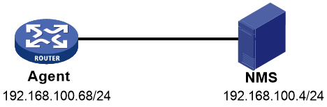

As shown in Figure 1, configure SNMPv1/SNMPv2c to meet the following requirements:
· The server manages the device and backs up the configuration files of the device as an NMS via SNMPv1/SNMPv2c.
· The device proactively sends an notification to the NMS when a fault occurs.

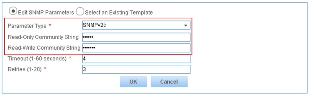

Table 2 Configure SNMP parameters:
a. Expand the SNMP Settings section.
b. Click Configure. Configure the following parameters:
- Select SNMPv2c from the Parameter Type list.
- Enter readtest in the Read-Only Community String field.
- Enter writetest in the Read-Write Community String field.
- Use the default values for other parameters.
- Click OK.
Figure 3 Configuring SNMP parameters

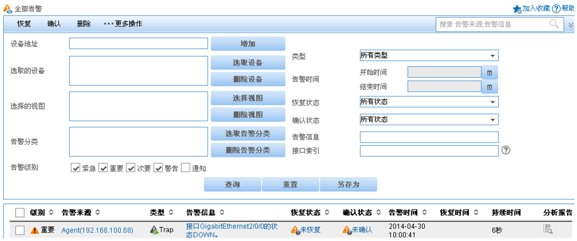

Table 4 Verify that the device sends notifications to the NMS when the link state of an interface changes.
a. Execute the shutdown or undo shutdown command for an idle interface on the device to shut down or bring up the interface.
b. Log in to the NMS. Navigate to the Alarm > Alarm Browse > All Alarms page and verify that the NMS receives notifications about interface changes from the device.
Figure 5 All alarms displayed on the NMS

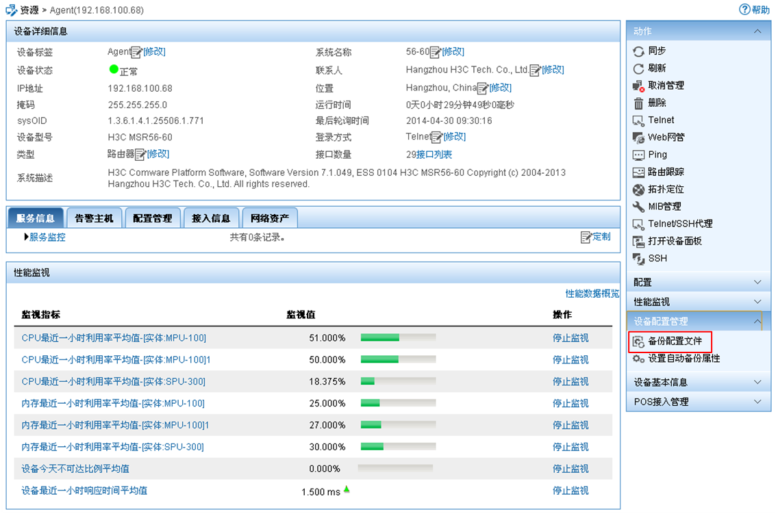

Table 5 Back up the configuration files of the device from the NMS.
# Navigate to the Resource > Device View > Agent page, and then click Backup Configuration File at the right.
Figure 6 Backing up configuration files of the device

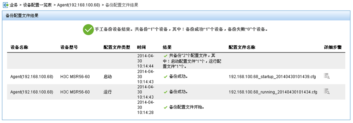

# Information as follows is displayed if the configuration files are backed up successfully.
Figure 7 Configuration files backed up successfully
