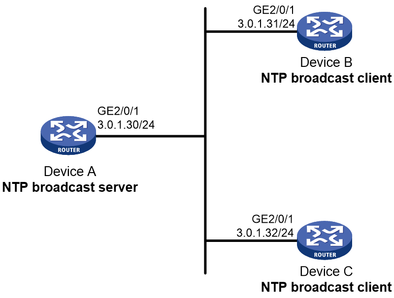

Example: Configuring the NTP client/server mode
As shown in Figure 1, Device A on the network can be used as a time server to provide accurate time synchronization. Configure the NTP client/server mode to enable all devices to synchronize the time with Device A.
Figure 1 Network diagram
Software versions used
This configuration example was created and verified on R9141P16 of the SR6608-M router.
Configuring Device A
# Assign an IP address to GigabitEthernet2/0/1.
<DeviceA> system-view
[DeviceA] interface gigabitethernet 2/0/1
[DeviceA-GigabitEthernet2/0/1] ip address 1.0.1.11 24
[DeviceA-GigabitEthernet2/0/1] quit
# Enable NTP.
[DeviceA] ntp-service enable
# Specify the local clock as the reference source, with stratum level 2.
[DeviceA] ntp-service refclock-master 2
Configuring Device B
# Assign IP addresses to interfaces. (Details not shown.).
# Enable NTP.
<DeviceB> system-view
[DeviceB] ntp-service enable
# Specify NTP for obtaining the system time.
[DeviceB] clock protocol ntp
# Specify Device A as the NTP server of Device B.
[DeviceB] ntp-service unicast-server 1.0.1.11
Configuring Device C
# Enable NTP.
<DeviceC> system-view
[DeviceC] ntp-service enable
[DeviceC] clock protocol ntp
# Specify Device A as the NTP server of Device C.
[DeviceC] ntp-service unicast-server 1.0.1.11
# Verify that Device B and Device C have synchronized the time with Device A. Device B is used in this example.
[DeviceB] display ntp-service status
 Clock status: synchronized
 Clock stratum: 3
 System peer: 1.0.1.11
 Local mode: client
 Reference clock ID: 1.0.1.11
 Leap indicator: 00
 Clock jitter: 0.003479 s
 Stability: 0.000 pps
 Clock precision: 2^-16
 Root delay: 1.95313 ms
 Root dispersion: 28.38135 ms
 Reference time: d5ed8cd5.577006ea  Wed, Sep 25 2017 16:24:53.341
System poll interval: 8 s
The command output shows that Device B has synchronized the time with Device A. Its stratum level is 3, which is 1 stratum higher than Device A.
# Verify that an NTP association has been established between Device B and Device A.
[DeviceB] display ntp-service sessions
        source          reference       stra reach poll  now offset  delay disper
[12345]1.0.1.11        127.127.1.0        2   255   64   38 -10.22 1.9531 3.3416
Notes: 1 source(master), 2 source(peer), 3 selected, 4 candidate, 5 configured.
 Total sessions: 1

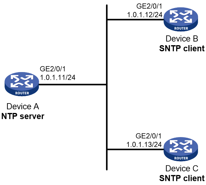

Example: Configuring the IPv6 NTP client/server mode
As shown in Figure 2, Device A on the IPv6 network can be used as a time server to provide accurate time synchronization. Configure the IPv6 NTP client/server mode to enable all devices to synchronize the time with Device A.
Figure 2 Network diagram
Software version used
Procedures
# Assign an IPv6 address to GigabitEthernet 2/0/1.
[DeviceA-GigabitEthernet2/0/1] ipv6 address 3000::34 64
# Enable the NTP service.
# Specify the local clock as the reference source, with the stratum level 2.
# Assign an IPv6 address to the interface. (Details not shown.)
# Specify NTP for obtaining the time.
[DeviceB] ntp-service ipv6 unicast-server 3000::34
[DeviceC] ntp-service ipv6 unicast-server 3000::34
 Clock stratum: 3
 System peer: 3000::34
 Local mode: client
 Reference clock ID: 95.197.17.40
 Leap indicator: 00
 Clock precision: 2^-18
 Reference time: d5ed8cd5.577006ea  Wed, Sep 25 2013 16:24:53.341
# Verify that an IPv6 NTP association has been established between Device B and Device A.
[DeviceB] display ntp-service ipv6 sessions
 Source:   [12345] 3000::34
 Reference: 127.127.1.0           Clock stratum: 2
 Reachabilities: 127              Poll interval: 64
 Last receive time: 6             Offset: -0.123
 Roundtrip delay: 0.3356          Dispersion: 5.3405
 Total sessions: 1

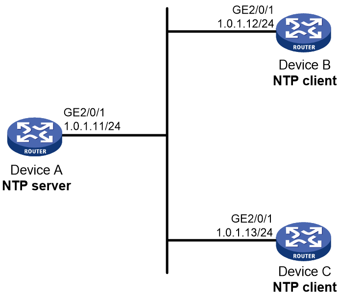

Example: Configuring NTP authentication in client/server association mode
·     Configure Device A's local clock as its reference source, with stratum level 2.
·     Configure Device B to operate in client mode and specify Device A as the NTP server of Device B.
·     Configure NTP authentication on both Device A and Device B.
Figure 3 Network diagram
# Specify an IP address for GigabitEthernet 2/0/1.
# Enable NTP authentication on Device A.
[DeviceA] ntp-service authentication enable
# Create authentication key 42 and set the key value of aNiceKey, in plain text.
[DeviceA] ntp-service authentication-keyid 42 authentication-mode md5 simple aNiceKey
# Specify key 42 as a trusted key.
[DeviceA] ntp-service reliable authentication-keyid 42

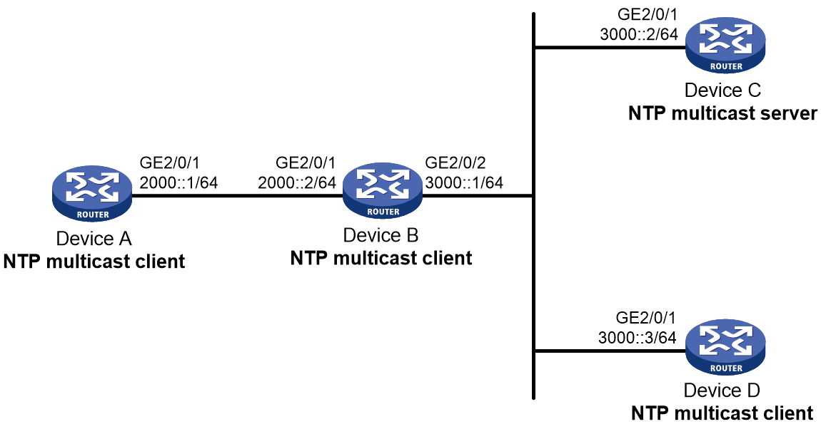

Example: Configuring NTP multicast association mode
As shown in Figure 4, configure Device C as the NTP server for multiple devices on different network segments so that these devices synchronize the time with Device C.
Figure 4 Network diagram
Assign an IP address to each interface, and make sure the devices can reach each other, as shown in Figure 4. (Details not shown.)
# Enable NTP.
[DeviceC] ntp-service refclock-master 2
# Assign an IP address to GigabitEthernet 2/0/1.
[DeviceC] interface gigabitethernet 2/0/1
[DeviceC-GigabitEthernet2/0/1] ip address 3.0.1.31 24
# Configure Device C to operate in multicast server mode and send multicast messages from GigabitEthernet 2/0/1.
[DeviceC-GigabitEthernet2/0/1] ntp-service multicast-server
[DeviceC-GigabitEthernet2/0/1] quit
Configuring Device D
# Enable NTP.
<DeviceD> system-view
[DeviceD] ntp-service enable
[DeviceD] clock protocol ntp
[DeviceD] interface gigabitethernet 2/0/1
[DeviceD-GigabitEthernet2/0/1] ip address 3.0.1.32 24
# Configure Device D to operate in multicast client mode and receive multicast messages on GigabitEthernet 2/0/1.
[DeviceD-GigabitEthernet2/0/1] ntp-service multicast-client
[DeviceD-GigabitEthernet2/0/1] quit
# Enable NTP.
# Configure Device B to operate in multicast client mode and receive multicast messages on GigabitEthernet 1/0/2.
[DeviceB] interface gigabitethernet 1/0/2
[DeviceB-GigabitEthernet1/0/2] ip address 3.0.1.30 24
[DeviceB-GigabitEthernet1/0/2] ntp-service multicast-client
[DeviceB-GigabitEthernet1/0/2] quit
Because Device A and Device C are on different subnets, you must enable the multicast functions on Device B before Device A can receive multicast messages from Device C.
# Enable the IP multicast function.
[DeviceB] multicast routing
[DeviceB-mrib] quit
[DeviceB-GigabitEthernet1/0/2] pim dm
[DeviceB] interface gigabitethernet 2/0/1
[DeviceB-GigabitEthernet2/0/1] ip address 1.0.1.10 24
[DeviceB-GigabitEthernet2/0/1] igmp enable
[DeviceB-GigabitEthernet2/0/1] igmp static-group 224.0.1.1
[DeviceB-GigabitEthernet2/0/1] quit
# Enable NTP.
[DeviceA] clock protocol ntp
# Configure Device A to operate in multicast client mode and receive multicast messages on GigabitEthernet 2/0/1.
[DeviceA-GigabitEthernet2/0/1] ntp-service multicast-client
# Verify that Device A has synchronized its time with Device C, and the clock stratum level of Device A is 3.
[DeviceA] display ntp-service status
 Clock stratum: 3
 System peer: 3.0.1.31
 Local mode: bclient
 Reference clock ID: 3.0.1.31
 Leap indicator: 00
 Clock jitter: 0.000061 s
 Root delay: 1.69373 ms
 Root dispersion: 1950.18005 ms
 Reference time: d5ee9b15.2f3a684d  Thu, Sep 26 2017 11:37:57.184
The command output shows that Device A has synchronized the time with Device C. Its stratum level is 3, which is 1 stratum higher than Device C.
Configuration files
·     Device A:
clock protocol ntp
 ntp-service enable
interface  GigabitEthernet2/0/1
 ip address 1.0.1.11 255.255.255.0
·     Device B:
clock protocol ntp
ntp-service enable
multicast routing
 ip address 3.0.1.30 255.255.255.0
 pim dm
 ip address 1.0.1.10 255.255.255.0
 igmp enable
·     Device C:
 ntp-service enable
 ip address 3.0.1.31 255.255.255.0
·     Device D:
clock protocol ntp
 ntp-service enable
 ip address 3.0.1.32 255.255.255.0

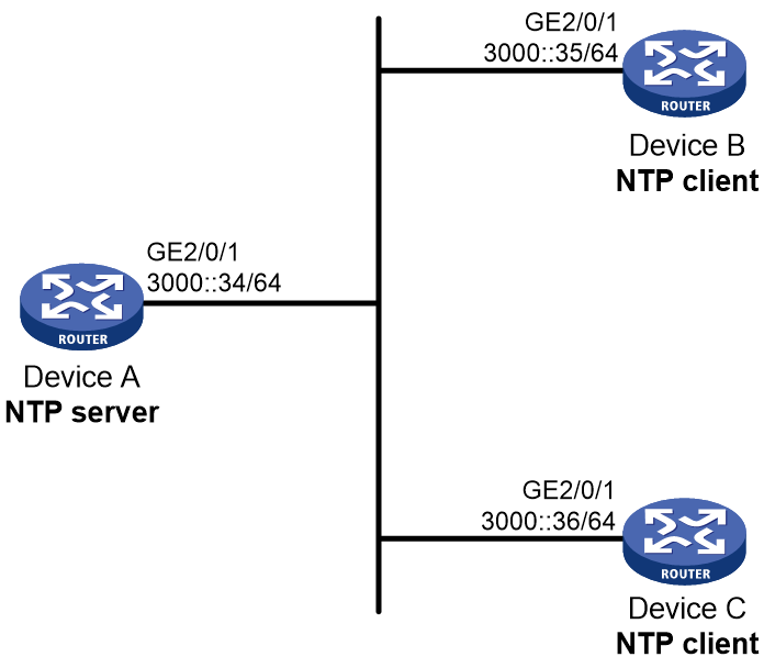

Example: Configuring the IPv6 NTP multicast mode
As shown in Figure 5, the IPv6 network has many devices distributed on different subnets. Device C on the network can be used as a time server to provide accurate time synchronization. Configure the IPv6 NTP multicast mode to enable all devices to synchronize the time with Device C.
Figure 5 Network diagram
Procedures
# Configure routing protocols so that all devices can reach each other. (Details not shown.)
[DeviceC-GigabitEthernet2/0/1] ipv6 address 3000::2 64
# Configure Device C to operate in IPv6 multicast server mode and send multicast messages from GigabitEthernet 2/0/1 to multicast address FF24::1.
[DeviceC-GigabitEthernet2/0/1] ntp-service ipv6 multicast-server ff24::1
# Configure routing protocols and assign IP addresses to interfaces so that devices can reach each other. (Details not shown.)
# Configure Device D to operate in IPv6 multicast client mode and receive multicast messages on GigabitEthernet 2/0/1.
[DeviceD-GigabitEthernet2/0/1] ntp-service ipv6 multicast-client ff24::1
# Configure routing protocols and assign an IP address to each interface so that devices can reach each other. (Details not shown.)
# Configure Device B to operate in IPv6 multicast client mode and receive multicast messages on GigabitEthernet 1/0/2.
[DeviceB-GigabitEthernet1/0/2] ntp-service ipv6 multicast-client ff24::1
Device A and Device C are on different subnets. For Device A to receive multicast messages from Device C, you must enable IPv6 multicast on Device B.
# Enable IPv6 multicast.
[DeviceB] ipv6 multicast routing
[DeviceB-mrib6] quit
[DeviceB-GigabitEthernet1/0/2] ipv6 pim dm
[DeviceB-GigabitEthernet2/0/1] mld enable
[DeviceB-GigabitEthernet2/0/1] mld static-group ff24::1
# Configure routing protocols and assign IP address to interfaces so that devices can reach each other. (Details not shown.)
# Configure Device A to operate in IPv6 multicast client mode and receive multicast messages on GigabitEthernet 2/0/1.
[DeviceA-GigabitEthernet2/0/1] ntp-service ipv6 multicast-client ff24::1
# Verify that the devices have synchronized the time with Device C. Device A is used an example.
 Clock stratum: 3
 System peer: 3000::2
 Local mode: bclient
 Reference clock ID: 165.84.121.65
 Leap indicator: 00
 Reference time: d5ee9b15.2f3a684d  Thu, Sep 26 2013 11:37:57.184
Configuration files
·     Device A:
 ntp-service enable
 ipv6 address 2000::1/64
·     Device B:
ntp-service enable
mld-snooping
 ipv6 address 3000::1/64
 ipv6 pim dm
 ipv6 address 2000::2/64
 mld enable
·     Device C:
 ntp-service enable
 ipv6 address 3000::2/64
·     Device D:
 ntp-service enable
 ipv6 address 3000::3/64

Example: Configuring the NTP broadcast mode with authentication
As shown in Figure 7, many devices are on the network and all of them are on the same network segment (3.0.1.0/24).
·     Configure the NTP broadcast mode to ensure that all devices in the network have consistent time.
·     To ensure secure clock synchronization and prevent attackers from disguising themselves as clock servers and launching attacks on device clocks, configure NTP authentication so that authentication is performed before time synchronization.
Figure 7 Network diagram
Procedures
Configure Device A
# Enable NTP authentication. Configure an NTP authentication key, with the key ID of 88 and key value of 123456.
[DeviceA] ntp-service authentication-keyid 88 authentication-mode md5 simple 123456
[DeviceA] ntp-service reliable authentication-keyid 88
# Specify Device A as an NTP broadcast server, and associate key 88 with Device A.
[DeviceA-GigabitEthernet2/0/1] ip address 3.0.1.30 24
[DeviceA-GigabitEthernet2/0/1] ntp-service broadcast-server authentication-keyid 88
Configure Device B
# Enable NTP authentication. Specify exactly the same authentication key ID and key as Device A.
[DeviceB] ntp-service authentication enable
[DeviceB] ntp-service authentication-keyid 88 authentication-mode md5 simple 123456
[DeviceB] ntp-service reliable authentication-keyid 88
# Configure Device B to operate in NTP broadcast client mode and receive NTP broadcast messages on GigabitEthernet 2/0/1.
[DeviceB-GigabitEthernet2/0/1] ntp-service broadcast-client
[DeviceB-GigabitEthernet2/0/1] ip address 3.0.1.31 24
# Configure Device C in the same way Device B is configured. (Details not shown.)
# Verify that the devices have synchronized the time with Device A. Device B is used an example.
 Clock stratum: 3
 System peer: 3.0.1.30
 Local mode: bclient
 Reference clock ID: 3.0.1.30
 Leap indicator: 00
 Clock jitter: 0.000092 s
 Root delay: 2.42615 ms
 Root dispersion: 1950.98877 ms
 Reference time: d5eed631.2f498d71  Thu, Sep 26 2013 15:50:09.184
Configuration files
·     Device A:
 ntp-service enable
 ntp-service authentication-keyid 88 authentication-mode md5 cipher $c$3$iJudDKiqCVO+gOaG53
63/fz4M3dQvHo2Fw==
·     Device B and Device C:
 ntp-service enable
 ntp-service authentication-keyid 88 authentication-mode md5 cipher $c$3$pU6KvpS80MadhM2zM
CCSR07HX4qEbJhHvQ==
