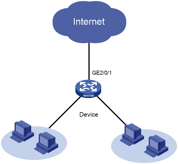

Example: Policing the ICMP packets sent to a control plane
As shown in Figure 1, the device might receive a large number of ICMP packets from the Internet, which causes high CPU usage and degraded device performance. Apply a QoS policy to a control plane to police incoming ICMP packets to 640 kbps.

Example: Policing the ARP packets sent to a control plane
As shown in Figure 2, the device might receive a large number of ARP packets from the Internet, which causes high CPU usage and degraded device performance. Apply a QoS policy to a control plane to police incoming ARP packets to 1000 kbps.
