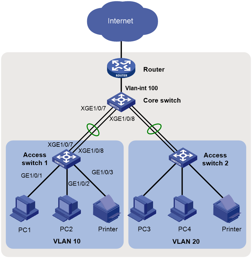

The following information uses an example to describe the basic procedure for configuring a small-sized campus network.
As shown in Figure 1, in a small-sized campus network, the S5130 or S5130S Ethernet switches series are deployed on the access layer. The S5560X or S6520X Ethernet switches series are deployed on the core layer, and an MSR series router is used as the egress router.
Configure the devices to meet the following requirements:
·     Configure the spanning tree feature on all the switches to prevent loops.
·     Configure link aggregation on the access switches and the core switch to provide high availability.
·     Configure VLANs to accommodate services of different departments in the campus and configure VLAN interfaces to provide Layer 3 connectivity for inter-department services.
·     Configure the core switch as the DHCP server to dynamically assign IP addresses to campus users.
·     Enable DHCP snooping on the access switches to prevent unauthorized DHCP servers from assigning IP addresses to intranet users. Additionally, enable IPSG to prevent intranet users from changing their IP addresses.
Figure 1 Small-sized campus network diagram

·     Access switch 1: Uplink aggregate interface Bridge-Aggregation 1
·     Access switch 2: Uplink aggregate interface Bridge-Aggregation 1
·     Core switch: Downlink aggregate interface Bridge-Aggregation 1
Access switches and the core switch are connected through aggregate links.
Port link type
·     Port connected to a PC: Access port
·     Port connected to a switch: Trunk port
N/A
VLAN IDs
·     Access switch 1: VLAN 10
·     Access switch 2: VLAN 20
·     Core switch: VLAN 100, VLAN 10, and VLAN 20
To isolate Department A and Department B at Layer 2, configure VLAN 10 for Department A and VLAN 20 for Department B.
The core switch connects to the egress router through VLAN-interface 100.

[ACCSW1] display vlan 10
 VLAN ID: 10
 VLAN type: Static
 Route interface: Not configured
 Description: VLAN 0010
 Tagged ports:   None
 Untagged ports:
    Bridge-Aggregation1
    GigabitEthernet1/0/1          GigabitEthernet1/0/2
    GigabitEthernet1/0/3          Ten-GigabitEthernet1/0/7
    Ten-GigabitEthernet1/0/8
5.     Enable BPDU guard globally.
[ACCSW1] stp bpdu-protection
6.     Configure DHCP snooping:
# Enable DHCP snooping.
[ACCSW1] dhcp snooping enable
# Configure Bridge-Aggregation 1 as a trusted port.
[ACCSW1] interface bridge-aggregation 1
[ACCSW1-Bridge-Aggregation1] dhcp snooping trust
[ACCSW1-Bridge-Aggregation1] quit
7.     Configure IPSG:
# Enable IPv4SG on GigabitEthernet 1/0/1 and verify the source IPv4 address and MAC address for dynamic IPSG, and enable recording of client information in DHCP snooping entries on the interface.
[ACCSW1] interface gigabitethernet 1/0/1
[ACCSW1-GigabitEthernet1/0/1] ip verify source ip-address mac-address
[ACCSW1-GigabitEthernet1/0/1] dhcp snooping binding record
[ACCSW1-GigabitEthernet1/0/1] quit
# Enable IPv4SG on GigabitEthernet 1/0/2 and verify the source IPv4 address and MAC address for dynamic IPSG, and enable recording of client information in DHCP snooping entries on the interface.
[ACCSW1] interface gigabitethernet 1/0/2
[ACCSW1-GigabitEthernet1/0/2] ip verify source ip-address mac-address
[ACCSW1-GigabitEthernet1/0/2] dhcp snooping binding record
[ACCSW1-GigabitEthernet1/0/2] quit
8.     Save the configuration:
# Save the running configuration on the access switches. This example uses access switch 1.
[ACCSW1] save
The current configuration will be written to the device. Are you sure? [Y/N]:y
Please input the file name(*.cfg)[flash:/startup.cfg]
(To leave the existing filename unchanged, press the enter key):
flash:/startup.cfg exists, overwrite? [Y/N]:y
Validating file. Please wait...
Saved the current configuration to mainboard device successfully.
Configuring the core switch
1.     Log in to the device.
For more information about logging in to the device, see "Log in to the device through the console port (first device access):."
2.     Configure IP addresses and Telnet login.
For more information about configuring IP addresses and Telnet login, see "Configure IP addresses and Telnet login:."
3.     Configure VLANs and VLAN interfaces:
# Create VLAN 10, VLAN 20, and VLAN 100.
<Sysname> system-view
[Sysname] sysname CORESW1
[CORESW1] vlan 10 20
[CORESW1] vlan 100
[CORESW1-vlan100] port gigabitethernet 1/0/1
[CORESW1-vlan100] quit
# Create VLAN-interface 10, and assign IP address 10.10.10.1/24 to it.
[CORESW1] interface vlan-interface 10
[CORESW1-Vlan-interface10]ip address 10.10.10.1 24
[CORESW1-Vlan-interface10] quit
# Create VLAN-interface 20, and assign IP address 10.10.20.1/24 to it.
[CORESW1] interface vlan-interface 20
[CORESW1-Vlan-interface20]ip address 10.10.20.1 24
[CORESW1-Vlan-interface20] quit
# Create VLAN-interface 100, and assign IP address 10.10.100.1/24 to it.
[CORESW1] interface vlan-interface 100
[CORESW1-Vlan-interface100]ip address 10.10.100.1 24
[CORESW1-Vlan-interface100] quit
4.     Configure link aggregation:
# Create Layer 2 aggregate interface Bridge-Aggregation 1, and set the link aggregation mode to dynamic.
[CORESW1] interface bridge-aggregation 1
[CORESW1-Bridge-Aggregation1] link-aggregation mode dynamic
[CORESW1-Bridge-Aggregation1] quit
# Assign Ten-GigabitEthernet 1/0/7 and Ten-GigabitEthernet 1/0/8 to aggregation group 1.
[CORESW1] interface ten-gigabitethernet 1/0/7
[CORESW1-Ten-GigabitEthernet1/0/7] port link-aggregation group 1
[CORESW1-Ten-GigabitEthernet1/0/7] quit
[CORESW1] interface ten-gigabitethernet 1/0/8
[CORESW1-Ten-GigabitEthernet1/0/8] port link-aggregation group 1
[CORESW1-Ten-GigabitEthernet1/0/8] quit
# Configure Bridge-Aggregation 1 as a trunk port, and assign it to VLAN 10.
[CORESW1-Bridge-Aggregation1] port link-type trunk
[CORESW1-Bridge-Aggregation1] port trunk permit vlan 10
# Display detailed information about Bridge-Aggregation 1 to verify the link aggregation configuration.
[CORESW1] display link-aggregation verbose Bridge-Aggregation 1
Loadsharing Type: Shar -- Loadsharing, NonS -- Non-Loadsharing
Port Status: S -- Selected, U -- Unselected, I -- Individual
Port: A -- Auto port, M -- Management port, R -- Reference port
Flags:  A -- LACP_Activity, B -- LACP_Timeout, C -- Aggregation,
        G -- Defaulted, H -- Expired
Aggregate Interface: Bridge-Aggregation1
Creation Mode: Manual
Aggregation Mode: Dynamic
Management VLANs: None
System ID: 0x8000, 000f-e267-6c6a
Local:
  Port                Status   Priority Index    Oper-Key               Flag
  XGE1/0/7(R)         S        32768    61       2                      {ACDEF}
  XGE1/0/8            S        32768    62       2                      {ACDEF}
Remote:
  Actor               Priority Index    Oper-Key SystemID               Flag
  XGE1/0/7            32768    111      2        0x8000, 000f-e267-57ad {ACDEF}
  XGE1/0/8            32768    112      2        0x8000, 000f-e267-57ad {ACDEF}
# Display information about VLAN 10 to verify the configuration.
[CORESW1] display vlan 10
 VLAN ID: 10
 VLAN type: Static
 Route interface: Configured
 IPv4 address: 10.10.10.1
 IPv4 subnet mask: 255.255.255.0
 Tagged ports:   None
 Untagged ports:
    Bridge-Aggregation1
    Ten-GigabitEthernet1/0/7      Ten-GigabitEthernet1/0/8
# Display information about VLAN 100 to verify the configuration.
[CORESW1] display vlan 100
 VLAN ID: 100
 VLAN type: Static
 IPv4 address: 10.10.100.1
 Description: VLAN 0100
 Tagged ports:   None
 Untagged ports:   None
5.     Configure the DHCP server feature:
# Enable DHCP.
[CORESW1] dhcp enable
# Create DHCP address pool 1. In this pool, specify network segment 10.10.10.0/24, gateway address 10.10.10.1, DNS server address 202.101.100.199, set the lease duration to 30 days, and bind IP address 10.10.10.254/24 to the printer.
[CORESW1] dhcp server ip-pool 1
[CORESW1-dhcp-pool-1] network 10.10.10.0 mask 255.255.255.0
[CORESW1-dhcp-pool-1] gateway-list 10.10.10.1
[CORESW1-dhcp-pool-1] dns-list 202.101.100.199
[CORESW1-dhcp-pool-1] expired day 30
[CORESW1-dhcp-pool-1] static-bind ip-address 10.10.10.254 24 client-identifier aabb-cccc-dd
[CORESW1-dhcp-pool-1] quit
# Create DHCP address pool 2. In this pool, specify network segment 10.10.20.0/24, gateway address 10.10.20.1, DNS server address 202.101.100.199, and set the lease duration to 30 days.
[CORESW1] dhcp server ip-pool 2
[CORESW1-dhcp-pool-2] network 10.10.20.0 mask 255.255.255.0
[CORESW1-dhcp-pool-2] gateway-list 10.10.20.1
[CORESW1-dhcp-pool-2] dns-list 202.101.100.199
[CORESW1-dhcp-pool-2] expired day 30
[CORESW1-dhcp-pool-2] quit
# Enable the DHCP server on VLAN-interface 10, and apply DHCP address pool 1 to VLAN-interface 10.
[CORESW1-Vlan-interface10] dhcp select server
[CORESW1-Vlan-interface10] dhcp server apply ip-pool 1
# Enable the DHCP server on VLAN-interface 20, and apply DHCP address pool 2 to VLAN-interface 20.
[CORESW1 interface vlan-interface 20
[CORESW1-Vlan-interface20] dhcp select server
[CORESW1-Vlan-interface20] dhcp server apply ip-pool 2
# Display information about DHCP address pools.
[CORESW1] display dhcp server pool
Pool name: 1
  Network: 10.10.10.0 mask 255.255.255.0
  expired 30 0 0 0
  static bindings:
    ip-address 10.10.10.254 mask 255.255.255.0
Pool name: 2
  Network: 10.10.20.0 mask 255.255.255.0
  expired 30 0 0 0
6.     Configure a static route and display routing table information:
# Configure a default static route with next hop 10.10.100.2 (the IP address of the router).
[CORESW1] ip route-static 0.0.0.0 0 10.10.100.2
# Display routing table information.
[CORESW1] display ip routing-table
Destinations : 21       Routes : 21
Destination/Mask   Proto   Pre Cost        NextHop         Interface
0.0.0.0/0          Static  60  0           10.10.100.2     Vlan100
0.0.0.0/32         Direct  0   0           127.0.0.1       InLoop0
10.10.10.0/24      Direct  0   0           10.10.10.1      Vlan10
10.10.10.0/32      Direct  0   0           10.10.10.1      Vlan10
10.10.10.1/32      Direct  0   0           127.0.0.1       InLoop0
10.10.10.255/32    Direct  0   0           10.10.10.1      Vlan10
10.10.20.0/24      Direct  0   0           10.10.20.1      Vlan20
10.10.20.0/32      Direct  0   0           10.10.20.1      Vlan20
10.10.20.1/32      Direct  0   0           127.0.0.1       InLoop0
10.10.20.255/32    Direct  0   0           10.10.20.1      Vlan20
10.10.100.0/24     Direct  0   0           10.10.100.1     Vlan100
10.10.100.0/32     Direct  0   0           10.10.100.1     Vlan100
10.10.100.1/32     Direct  0   0           127.0.0.1       InLoop0
10.10.100.255/32   Direct  0   0           10.10.100.1     Vlan100
127.0.0.0/8        Direct  0   0           127.0.0.1       InLoop0
127.0.0.0/32       Direct  0   0           127.0.0.1       InLoop0
127.0.0.1/32       Direct  0   0           127.0.0.1       InLoop0
127.255.255.255/32 Direct  0   0           127.0.0.1       InLoop0
224.0.0.0/4        Direct  0   0           0.0.0.0         NULL0
7.     Save the configuration:
# Save the running configuration on the core switch.
[CORESW1] save
Configuring the egress router
1.     Log in to the router.
For more information about logging in to the router, see "Log in to the device through the console port (first device access):."
3.     Assign IP addresses to the public network interface and the internal network interface:
# Assign IP address 202.101.100.2/30 to GigabitEthernet 0/2 (the public network interface).
[Router] interface GigabitEthernet 0/2
[Router-GigabitEthernet0/2] ip address 202.101.100.2 30
[Router-GigabitEthernet0/2] quit
# Assign IP address 10.10.100.2/24 to GigabitEthernet 0/1 (the internal network interface).
[Router] interface GigabitEthernet 0/1
[Router-GigabitEthernet0/1] ip address 10.10.100.2 24
[Router-GigabitEthernet0/1] quit
4.     Configure packet filtering:
# Configure ACL 2000.
[Router] acl basic 2000
[Router-acl-ipv4-basic-2000] rule permit source 10.10.10.0 0.0.0.255
[Router-acl-ipv4-basic-2000] rule permit source 10.10.20.0 0.0.0.255
[Router-acl-ipv4-basic-2000] rule permit source 10.10.100.0 0.0.0.255
[Router-acl-ipv4-basic-2000] quit
# Apply ACL 2000 to GigabitEthernet 0/1 to filter incoming packets.
[Router] interface gigabitethernet 0/1
[Router-GigabitEthernet0/1] packet-filter 2000 inbound
# Set the packet filtering default action to deny.
[Router] packet-filter default deny
# Display configuration and match statistics for ACL 2000.
[Router] display acl 2000
Basic IPv4 ACL 2000, 3 rules,
ACL's step is 5, start ID is 0
 rule 0 permit source 10.10.10.0 0.0.0.255
 rule 5 permit source 10.10.20.0 0.0.0.255
 rule 10 permit source 10.10.100.0 0.0.0.255
# Display ACL application information for inbound packet filtering on GigabitEthernet 0/1.
[Router] display packet-filter interface gigabitethernet 0/1 inbound
Interface: GigabitEthernet 0/1
 Inbound policy:
  IPv4 ACL 2000
5.     Configure static routes to the intranet and the public network:
[Router] ip route-static 10.10.10.0 255.255.255.0 10.10.100.1
[Router] ip route-static 10.10.20.0 255.255.255.0 10.10.100.1
[Router] ip route-static 0.0.0.0 0.0.0.0 202.101.100.1
6.     Configure DNS:
[Router] dns server 202.101.100.199
[Router] dns proxy enable
# Save the running configuration on the egress router.
[Router] save
1.     Verify that two PCs in the same department can ping each other. This example uses PC 1 and PC 2 in Department A.
# Ping PC 2 from PC 1.
<PC1> ping 10.10.10.20
Ping 10.10.10.20 (10.10.10.20): 56 data bytes, press CTRL+C to break
56 bytes from 10.10.10.20: icmp_seq=0 ttl=255 time=1.015 ms
56 bytes from 10.10.10.20: icmp_seq=1 ttl=255 time=2.338 ms
56 bytes from 10.10.10.20: icmp_seq=2 ttl=255 time=1.951 ms
56 bytes from 10.10.10.20: icmp_seq=3 ttl=255 time=1.719 ms
56 bytes from 10.10.10.20: icmp_seq=4 ttl=255 time=1.629 ms
--- Ping statistics for 10.10.10.20 ---
round-trip min/avg/max/std-dev = 1.015/1.730/2.338/0.434 ms
The output shows that PC 1 can ping PC 2.
2.     Verify that two PCs in different departments can ping each other. This example uses PC 1 in Department A and PC 3 in Department B. Assume that PC3 obtains IP address 10.10.20.10 through DHCP.
# Ping PC 3 from PC 1.
<PC1> ping 10.10.20.10
Ping 10.10.20.10 (10.10.20.10): 56 data bytes, press CTRL+C to break

Access switch ACCSW1
 sysname ACCSW1
 telnet server enable
vlan 5
vlan 10
 stp bpdu-protection
interface Bridge-Aggregation1
 dhcp snooping trust
interface Vlan-interface5
 ip address 10.10.1.1 255.255.255.0
 port link-mode bridge
 port access vlan 10
 stp edged-port
 port access vlan 10
 stp edged-port
 port access vlan 10
 stp edged-port
interface Ten-GigabitEthernet1/0/7
interface Ten-GigabitEthernet1/0/8
interface Ten-GigabitEthernet1/0/10
 port access vlan 5
line vty 0 63
 authentication-mode scheme
local-user admin class manage
 password hash $h$6$/up8ijTTulpXAAkL$s9fFDXwWVzNd0j2F8Rq/ZQEiMbA2s8uW31kkcaDoGHoNyvE/zZLV9HoLp+i0+VcV6Jpm48ufEAxbuKvi6qtWmg==
 service-type telnet
 authorization-attribute user-role network-admin
Access switch ACCSW2
The configuration file of ACCSW2 is the same as that of ACCSW1 except the VLAN IDs, management VLAN interface address, and aggregate interface number. (Details not shown.)
Core switch CORESW1
 sysname CORESW1
vlan 10
vlan 20
vlan 100
 expired day 30
 static-bind ip-address 10.10.10.254 mask 255.255.255.0 client-identifier aaaa-cccc-dd
 expired day 30
interface Vlan-interface10
 ip address 10.10.10.1 255.255.255.0
interface Vlan-interface20
 ip address 10.10.20.1 255.255.255.0
interface Vlan-interface100
 ip address 10.10.100.1 255.255.255.0
 port access vlan 100
Egress router
 sysname Router
 dns proxy enable
interface GigabitEthernet0/1
 port link-mode route
 ip address 10.10.100.2 255.255.255.0
interface GigabitEthernet0/2
 ip address 202.101.100.2 255.255.255.252
 ip route-static 0.0.0.0 0 202.101.100.1
 ip route-static 10.10.10.0 24 10.10.100.1
 ip route-static 10.10.20.0 24 10.10.100.1
acl basic 2000

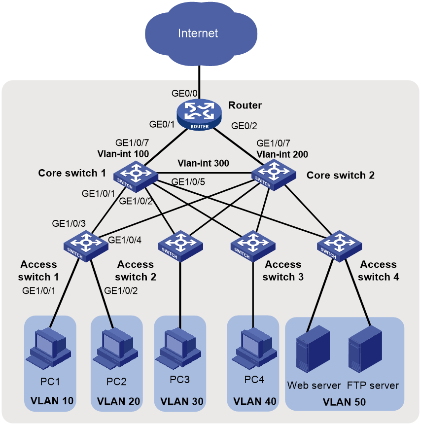

Deploying a small- to medium-sized campus network
Introduction
The following information uses an example to describe the basic procedure for configuring a small- to medium-sized campus network.
As shown in Figure 1, in a small- to medium-sized campus network, the S5130 or S5130S Ethernet switches series are deployed on the access layer. The S5560X or S6520X Ethernet switches series are deployed on the core layer, and an MSR series router is used as the egress router.
·     Configure VRRP on the core switches to provide high availability.
·     Configure VLANs to accommodate services of different departments and configure VLAN interfaces on the core switches to provide Layer 3 connectivity for inter-department services.
·     Configure the core switches as the DHCP servers to dynamically assign IP addresses to campus users.
·     Configure per-IP address rate liming on the egress router to limit the rate of incoming and outgoing traffic.
Figure 3 Small- to medium-sized campus network diagram
Analysis and data preparation
Table 2 shows the procedure of deploying a small-l to medium-sized campus network.
Table 2 Procedure of deploying a small- to medium-sized campus network
Step
Item
Configuration data
Remarks
1.     Log in to the devices.
Console login
Communication parameters (the transmission rate, for example).
Use a PC to log in to the devices through a terminal emulation program.
2.     Configure the management IP and Telnet login.
Management VLAN
VLAN 5
VLAN 1 is the default VLAN. Do not configure VLAN 1 as the management VLAN.
This example uses VLAN 5 as the management VLAN.
IP address of the management Ethernet interface or management VLAN interface
10.10.1.1/24
This example uses ACCSW1.
For a switch that has a management Ethernet interface, use the IP address of M-GigabitEthernet 0/0/0 for device login.
For a switch that does not have a management Ethernet interface, use the IP address of the management VLAN interface for device login.
3.     Configure interfaces and VLANs.
Port link type
·     Port connected to a PC: Access or hybrid port
·     Port connected to a switch: Trunk or hybrid port
N/A
VLAN IDs
·     Access switch 1: VLANs 10 and 20
·     Core switch: VLANs 10, 20, 30, 40, 50, 100, and 300
4.     Configure the DHCP server on the core switches.
DHCP server
Core switch 1
Core switch 2
Configure the DHCP server feature on core switch 1 and core switch 2.
DHCP address pools
·     VLAN 10: DHCP address pool 1
·     VLAN 20: DHCP address pool 2
PCs in Department A and Department B obtain IP addresses from DHCP address pool 1 and DHCP address pool 2, respectively.
5.     Configure routes on the core switches.
IP addresses
Core switch 1:
·     VLAN-interface 10: 192.168.10.1/24
·     VLAN-interface 20: 192.168.20.1/24
·     VLAN-interface 100: 172.16.1.1/24
·     VLAN-interface 300: 172.16.3.1/24
VLAN-interface100 is used for the communication between core switch 1 and the egress router.
VLAN-interface 300 is used for the communication between core switch 1 and core switch 2.
Assign IP addresses to VLAN-interface 10 and VLAN-interface 20 to allow Department A and Department B to visit each other.
6.     Configure the egress router.
IP address of the public network interface
GE0/0: 202.101.100.2/30
GE0/0 on the egress router is the public network interface that connects the router to the Internet.
Public network gateway address
202.101.100.1/30
The egress router communicates with the service provider device through the public network gateway address.
To forward intranet packets to the external network, you must configure a default route with the next hop as the public network gateway address.
DNS server address
202.101.100.199
The DNS server translates domain names into IP addresses.
IP addresses of the internal network interfaces
GE0/1: 172.16.1.2/24
GE0/2: 172.16.2.2/24
GE0/1 and GE0/2 on the egress router are used for connection between the egress router and the intranet.
The egress router connects to the master device and the backup device through GE0/1 and GE0/2, respectively.
7.     Configure DHCP snooping and IP source guard on the access switches.
Trusted ports
GE1/0/1
GE1/0/2
A trusted port can forward DHCP messages correctly to ensure that the clients get IP addresses from authorized DHCP servers.
Configuring the access switches
The procedure of configuring access switch 1 is the same as the procedure of configuring access switches 2, 3, and 4. This section uses access switch 1 as an example.

Configuring the core switches
The procedure of configuring core switch 1 is similar to the procedure of configuring core switch 2. This section uses core switch 1 as an example. Unless otherwise stated, the configuration of core switch 2 is the same as that of core switch 1.
1.     Configure interfaces and VLANs:
# Create VLAN 10, VLAN 20, VLAN 30, VLAN 40, VLAN 50, VLAN 100, and VLAN 300.
[CORESW1] vlan 10 20 30 40 50 100 300
# Configure GigabitEthernet 1/0/1 as a trunk port, and assign it to VLAN 10 and VLAN 20.
[CORESW1] interface gigabitethernet 1/0/1
[CORESW1-GigabitEthernet1/0/1] port link-type trunk
[CORESW1-GigabitEthernet1/0/1] port trunk permit vlan 10 20
[CORESW1-GigabitEthernet1/0/1] quit
# Configure GigabitEthernet 1/0/5 as a trunk port, and assign it to VLAN 300.
[CORESW1] interface gigabitethernet 1/0/5
[CORESW1-GigabitEthernet1/0/5] port link-type trunk
[CORESW1-GigabitEthernet1/0/5] port trunk permit vlan 300
[CORESW1-GigabitEthernet1/0/5] quit
# Configure the link type and permit VLANs for other interfaces in a similar way. (Details not shown.)
2.     Configure VLAN interfaces:
# Create VLAN-interface 10, and assign IP address 192.168.10.1/24 to it.
[CORESW1-Vlan-interface10]ip address 192.168.10.1 24
# Create VLAN-interface 20, and assign IP address 92.168.20.1/24 to it.
[CORESW1-Vlan-interface20]ip address 192.168.20.1 24
# Create VLAN-interface 100, and assign IP address 172.16.1.1/24 to it.
[CORESW1-Vlan-interface100]ip address 172.16.1.1 24
# Create VLAN-interface 300, and assign IP address 172.16.3.1/24 to it.
[CORESW1] interface vlan-interface 300
[CORESW1-Vlan-interface300]ip address 172.16.3.1 24
[CORESW1-Vlan-interface300] quit
# Create other VLAN interfaces and assign IP addresses to them in a similar way. (Details not shown.)
# Display information about VLAN 10.
 VLAN ID: 10
 VLAN type: Static
 IPv4 address: 192.168.10.1
 Tagged ports:
# Display information about VLAN 20.
[CORESW1] display vlan 20
 VLAN ID: 20
 VLAN type: Static
 IPv4 address: 192.168.20.1
 Description: VLAN 0020
 Tagged ports:
# Display information about VLAN 100.
 VLAN ID: 100
 VLAN type: Static
 IPv4 address: 172.16.1.1
 Tagged ports:   None
# Display information about VLAN 300.
[CORESW1] display vlan 300
 VLAN ID: 300
 VLAN type: Static
 IPv4 address: 172.16.3.1
 Description: VLAN 0300
 Tagged ports:
3.     Configure VRRP:
Use core switch 1 and core switch 2 to form a VRRP group. Core switch 1 operates as the master to process intranet packets. When core switch 1 fails or the upstream link of core switch 1 fails, core switch 2 takes over to process intranet packets.
# On core switch 1, create VRRP group 1 and set its virtual IP address to 172.16.3.10.
[CORESW1-Vlan-interface300] vrrp vrid 1 virtual-ip 172.16.3.10
# Assign core switch 1 a higher priority than core switch 2 in VRRP group 1, so core switch 1 can become the master.
[CORESW1-Vlan-interface300] vrrp vrid 1 priority 120
# Configure core switch 1 to operate in preemptive mode, so it can become the master whenever it operates correctly. Set the preemption delay to 5000 centiseconds to avoid frequent status switchover.
[CORESW1-Vlan-interface300] vrrp vrid 1 preempt-mode delay 5000
# Create track entry 1 to monitor the upstream link status of GigabitEthernet 1/0/7. When the upstream link fails, the track entry transits to Negative.
[CORESW1] track 1 interface gigabitethernet 1/0/7
[CORESW1-track-1] quit
# Configure the VFs in VRRP group 1 to monitor track entry 1, and decrease their weights by 30 when the track entry transits to Negative.
[CORESW1-Vlan-interface300] vrrp vrid 1 track 1 priority reduced 30
# On core switch 2, create VRRP group 1 and set its virtual IP address to 172.16.3.10.
[Sysname] sysname CORESW2
[CORESW2] interface vlan-interface 300
[CORESW2-Vlan-interface300] vrrp vrid 1 virtual-ip 172.16.3.10
# Set the priority of core switch 2 to 100 in VRRP group 1.
[CORESW2-Vlan-interface300] vrrp vrid 1 priority 100
# Configure core switch 2 to operate in preemptive mode, and set the preemption delay to 5000 centiseconds.
[CORESW2-Vlan-interface300] vrrp vrid 1 preempt-mode delay 5000
[CORESW2-Vlan-interface300] quit
# Display detailed information about VRRP group 1 on core switch 1.
[CORESW1] display vrrp verbose
IPv4 Virtual Router Information:
 Running mode : Standard
 Total number of virtual routers : 1
   Interface Vlan-interface300
     VRID             : 1                   Adver Timer  : 100
     Admin Status     : Up                  State        : Master
     Config Pri       : 120                 Running Pri  : 120
     Preempt Mode     : Yes                 Delay Time   : 5000
     Auth Type        : None
     Virtual IP       : 172.16.3.10
     Virtual MAC      : 0000-5e00-0101
     Master IP        : 172.16.3.1
   VRRP Track Information:
     Track Object   : 1                   State : Positive   Pri Reduced : 30
# Display detailed information about VRRP group 1 on core switch 2.
[CORESW2] display vrrp verbose
     Admin Status     : Up                  State        : Backup
     Config Pri       : 100                 Running Pri  : 100
     Become Master    : 27810ms left
     Auth Type        : None
The output shows that core switch 1 is operating as the master and core switch 2 is operating as the backup in VRRP group 1.
4.     Configure the DHCP server feature:
# Enable DHCP.
# Create DHCP address pool 1. In this pool, specify network segment 192.168.10.0/24, gateway address 192.168.10.1, DNS server address 202.101.100.199, set the lease duration to 30 days, and bind IP address 192.168.10.254/24 to the printer.
[CORESW1-dhcp-pool-1] network 192.168.10.0 mask 255.255.255.0
[CORESW1-dhcp-pool-1] gateway-list 192.168.10.1
[CORESW1-dhcp-pool-1] static-bind ip-address 192.168.10.254 24 client-identifier aabb-cccc-dd
# Create DHCP address pool 2. In this pool, specify network segment 192.168.20.0/24, gateway address 192.168.20.1, DNS server address 202.101.100.199, and set the lease duration to 30 days.
# Configure DHCP address pool 2 to assign IP addresses and other configuration parameters to clients on subnet 192.168.10.0/24.
[CORESW1-dhcp-pool-2] network 192.168.20.0 mask 255.255.255.0
[CORESW1-dhcp-pool-2] gateway-list 192.168.20.1
# Enable the DHCP server on VLAN-interface 20, and apply DHCP address pool 2 to VLAN-interface 10.
# Display DHCP address pool information.
Pool name: 1
  Network: 192.168.10.0 mask 255.255.255.0
  expired 30 0 0 0
  static bindings:
    ip-address 192.168.10.254 mask 255.255.255.0
Pool name: 2
  Network: 192.168.20.0 mask 255.255.255.0
  expired 30 0 0 0
5.     Configure OSPF:
# Configure OSPF on core switch 1.
[CORESW1] ospf 100 router-id 2.2.2.2
[CORESW1-ospf-100] area 0
[CORESW1-ospf-100-area-0.0.0.0] network 172.16.1.0 0.0.0.255
[CORESW1-ospf-100-area-0.0.0.0] network 172.16.3.0 0.0.0.255
[CORESW1-ospf-100-area-0.0.0.0] network 192.168.10.0 0.0.0.255
[CORESW1-ospf-100-area-0.0.0.0] network 192.168.20.0 0.0.0.255
[CORESW1-ospf-100-area-0.0.0.0] quit
[CORESW1-ospf-100] quit
# Configure OSPF on core switch 2.
[CORESW2] ospf 100 router-id 3.3.3.3
[CORESW2-ospf-100] area 0
[CORESW2-ospf-100-area-0.0.0.0] network 172.16.2.0 0.0.0.255
[CORESW2-ospf-100-area-0.0.0.0] network 172.16.3.0 0.0.0.255
[CORESW2-ospf-100-area-0.0.0.0] network 192.168.10.0 0.0.0.255
[CORESW2-ospf-100-area-0.0.0.0] network 192.168.20.0 0.0.0.255
[CORESW2-ospf-100-area-0.0.0.0] quit
[CORESW2-ospf-100] quit
# Display OSPF neighbor information on core switch 1.
[CORESW1] display ospf peer
         OSPF Process 100 with Router ID 2.2.2.2
               Neighbor Brief Information
 Area: 0.0.0.0
 Router ID       Address         Pri Dead-Time  State             Interface
 3.3.3.3         172.16.3.2      1   33         Full/DR           Vlan300
# Display OSPF neighbor information on core switch 2.
[CORESW2] display ospf peer
         OSPF Process 100 with Router ID 3.3.3.3
 Area: 0.0.0.0
 2.2.2.2         172.16.3.1      1   36         Full/BDR          Vlan300
6.     Save the configuration:
# Save the running configuration on the core switches. This example uses core switch CORESW1.
[CORESW1] save

3.     Configure OSPF:
# Configure a default static route, whose next hop address is 202.101.100.1 (the public network gateway address).
# Configure OSPF and redistribute a default route into the OSPF routing domain.
[Router] ospf 10 router-id 1.1.1.1
[Router-ospf-10] default-route-advertise always
[Router-ospf-10] area 0
[Router-ospf-10-area-0.0.0.0] network 172.16.1.0 0.0.0.255
[Router-ospf-10-area-0.0.0.0] network 172.16.2.0 0.0.0.255
[Router-ospf-10-area-0.0.0.0] quit
[Router-ospf-10] quit
# Display OSPF neighbor information on the egress router.
[Router] display ospf peer
         OSPF Process 100 with Router ID 1.1.1.1
 Area: 0.0.0.0
 2.2.2.2         172.16.1.1      1   31         Full/DR           GE0/1
 3.3.3.3         172.16.2.1      1   39         Full/BDR          GE0/2
[CORESW1] display ospf routing
                  Routing Table
                Topology base (MTID 0)
 Routing for network
 Destination        Cost     Type    NextHop         AdvRouter       Area
 172.16.1.0/24      1        Transit 0.0.0.0         2.2.2.2         0.0.0.0
 172.16.2.0/24      2        Transit 172.16.3.2      1.1.1.1         0.0.0.0
 172.16.2.0/24      2        Transit 172.16.1.2      1.1.1.1         0.0.0.0
 172.16.3.0/24      1        Transit 0.0.0.0         3.3.3.3         0.0.0.0
 Routing for ASEs
 Destination        Cost     Type    Tag         NextHop         AdvRouter
 0.0.0.0/0          1        Type2   1           172.16.1.2      1.1.1.1
 Total nets: 5
 Intra area: 4  Inter area: 0  ASE: 1  NSSA: 0
[CORESW2] display ospf routing
                  Routing Table
 Routing for network
 172.16.1.0/24      2        Transit 172.16.3.1      2.2.2.2         0.0.0.0
 172.16.1.0/24      2        Transit 172.16.2.2      2.2.2.2         0.0.0.0
 172.16.2.0/24      1        Transit 0.0.0.0         1.1.1.1         0.0.0.0
 Routing for ASEs
 0.0.0.0/0          1        Type2   1           172.16.2.2      1.1.1.1
 Total nets: 5

Core switch CORESW1
 sysname CORESW1
track 1 interface GigabitEthernet1/0/7
 area 0.0.0.0
 dhcp enable
vlan 10
vlan 20
vlan 30
vlan 40
vlan 50
vlan 100
vlan 300
ftth
 expired day 30
 static-bind ip-address 192.168.10.254 mask 255.255.255.0 client-identifier aabb-cccc-dd
 expired day 30
 ip address 192.168.10.1 255.255.255.0
 ip address 192.168.20.1 255.255.255.0
 ip address 172.16.1.1 255.255.255.0
interface Vlan-interface300
 ip address 172.16.3.1 255.255.255.0
 port trunk permit vlan 20
interface GigabitEthernet1/0/5
Core switch CORESW2
The configuration file of core switch CORESW2 is the same as that of CORESW1 except the VLAN IDs, interface numbers, OSPF router ID, and VRRP group 1's priority. (Details not shown.)
Egress router
 sysname Router
 qos carl 1 source-ip-address range 192.168.10.1 to 192.168.10.254 per-address shared-bandwidth
 qos carl 2 source-ip-address range 192.168.20.1 to 192.168.20.254 per-address shared-bandwidth
 qos carl 3 destination-ip-address range 192.168.10.1 to 192.168.10.254 per-address shared-bandwidth
 qos carl 4 destination-ip-address range 192.168.20.1 to 192.168.20.254 per-address shared-bandwidth
 area 0.0.0.0
 dns proxy enable
 ip address 172.16.1.2 255.255.255.0
 qos car inbound carl 1 cir 512 cbs 32000 ebs 0 green pass red discard yellow pass
 qos car inbound carl 2 cir 512 cbs 32000 ebs 0 green pass red discard yellow pass
 qos car outbound carl 3 cir 512 cbs 32000 ebs 0 green pass red discard yellow pass
 qos car outbound carl 4 cir 512 cbs 32000 ebs 0 green pass red discard yellow pass
 ip address 172.16.2.2 255.255.255.0
interface GigabitEthernet0/0
acl basic 2000
 rule 0 permit source 192.168.10.0 0.0.0.255
 rule 5 permit source 192.168.20.0 0.0.0.255
 rule 10 permit source 172.16.1.0 0.0.0.255
 rule 15 permit source 172.16.2.0 0.0.0.255
 rule 20 permit source 172.16.3.0 0.0.0.255
