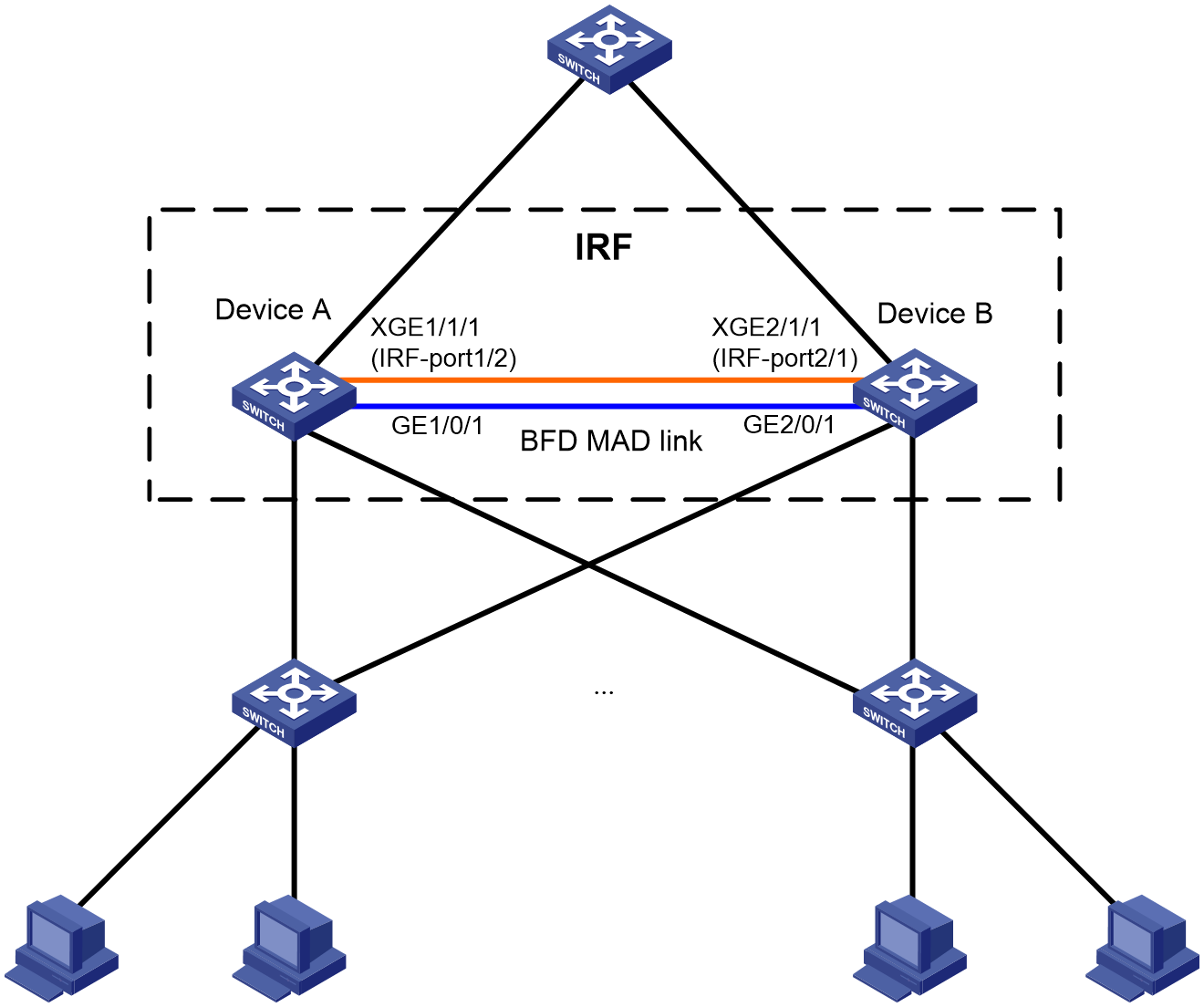

The Intelligent Resilient Framework (IRF) technology enables you to add device nodes for forwarding capacity expansion without changing network topology. The following information uses an example to describe the basic procedure for two-member IRF fabric setup.
As shown in Figure 1, add Device B to expand Device A at the core layer of a network into a two-member IRF fabric to accommodate growing traffic without changing the network topology.

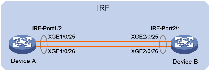

This example uses the configuration data in Table 1 for IRF setup.
Device |
IRF member ID |
IRF member priority |
IRF port bindings |
Device A |
1 (default) |
32 |
IRF port: irf-port 1/2 IRF physical interfaces: · Ten-GigabitEthernet 1/0/25 · Ten-GigabitEthernet 1/0/26 |
Device B |
2 |
1 (default) |
IRF port: irf-port 2/1 IRF physical interfaces: · Ten-GigabitEthernet 2/0/25 · Ten-GigabitEthernet 2/0/26 |
IRF ports are numbered in member-id/port-id format, with port-id being 1 or 2. To set up an IRF fabric, make sure the peer IRF ports connected between neighboring member devices have different port IDs. If you use IRF-port member-id/1 on one member device, you must connect it to IRF-port member-id/2 on the other.
For example, Device A has a member ID of 1 and Device B has a member ID of 2. You can use either of the following IRF port connection schemes:
· IRF-port 1/2 (Device A) to IRF-port 2/1 (Device B). This example uses this connection scheme.
· IRF-port 1/1 (Device A) to IRF-port 2/2 (Device B).

# Connect the IRF physical interfaces on Device B to their peer IRF physical interfaces on Device A, as shown in Figure 1.
Activating the IRF port settings
# Activate the IRF port settings on Device A.
[DeviceA] irf-port-configuration active
# Activate the IRF port settings on Device B.
[DeviceB] irf-port-configuration active
Device B and Device perform master election automatically. With a lower priority than Device A, Device B fails master election and reboots to form an IRF fabric with Device A. The system name of the IRF fabric is Device A.
# Verify that the IRF fabric has been established.
<DeviceA> display irf
MemberID Slot Role Priority CPU-Mac Description
*+1 0 Master 32 0210-fc01-0000 ---
2 0 Standby 1 0210-fc02-0000 ---
* indicates the device is the master.
+ indicates the device through which the user logs in.
The Bridge MAC of the IRF is: 3822-d60f-2800
Auto upgrade : yes
Mac persistent : always
Domain ID : 0
Auto merge : yes
The output shows that the IRF fabric has been established.
