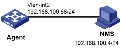

As shown in Figure 1, configure the device (agent) and IMC server (NMS) to meet the following requirements:
·     Enable the IMC server to monitor and manage the device through SNMPv1/SNMPv2c as an NMS.
·     Enable the device to automatically send notifications to report events to the NMS as an agent.
Figure 1 Network diagram
·     The configuration procedure is the same for SNMPv1 and SNMPv2c. SNMPv2c is configured in this example.
·     Configure the same SNMP version and community string on the device and the NMS so that the NMS can monitor and manage the device.

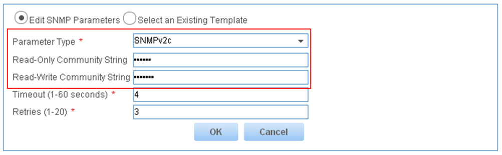

3.     Edit SNMP parameters:
a.     Select the SNMPv2c parameter type.
b.     Set the read-only community string to readtest.
c.     Set the read-write community string to writetest.
d.     Use the default values for other parameters.
e.     Click OK.

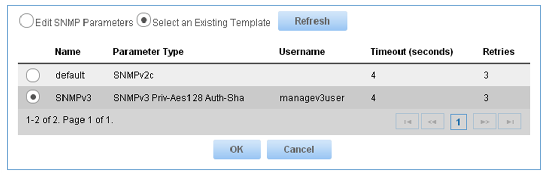

a.     Select the Select an Existing Template option.
b.     Select the SNMP template named SNMPv3.
c.     Click OK.
e.     Click OK.
Figure 12 Configuring SNMP parameters
