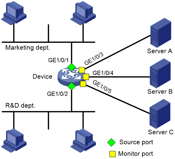

The following information uses an example to describe the basic procedure for configuring local port mirroring.
The departments of a company use IP addresses on different subnets. The R&D department uses subnet 10.1.1.0/24, and the marketing department uses subnet 12.1.1.0/24. Configure local port mirroring, so that the data monitoring device can monitor the traffic from the R&D department and marketing department to Internet and the traffic between the two departments.
Figure 1 Network diagram
·     For a local mirroring group to take effect, you must configure the mirroring source ports and monitor port for the group. Make sure the monitor port is not the member port of any other mirroring group.
·     A monitor port can receive both mirrored packets copied from source ports and normally forwarded packets from other ports. Use a monitor port only for port mirroring, so the data monitoring device receives and analyzes only the mirrored traffic.
# Assign IP address 10.1.1.1/24 to GigabitEthernet 1/0/1, which connects to the device of the R&D department.

# Create a local mirroring group.
[DeviceA] mirroring-group 1 local
# Configure the local mirroring group to mirror the incoming packets of interfaces GigabitEthernet 1/0/1 and GigabitEthernet 1/0/2.
[DeviceA] mirroring-group 1 mirroring-port gigabitethernet 1/0/1 gigabitethernet 1/0/2 inbound
# Configure interface GigabitEthernet 1/0/3 as the monitor port.
[DeviceA] mirroring-group 1 monitor-port gigabitethernet 1/0/3

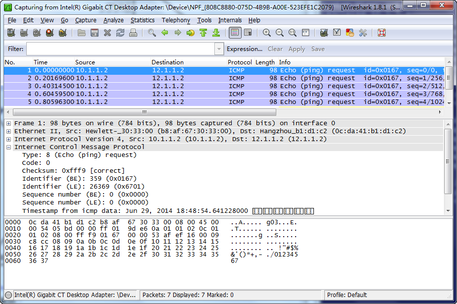

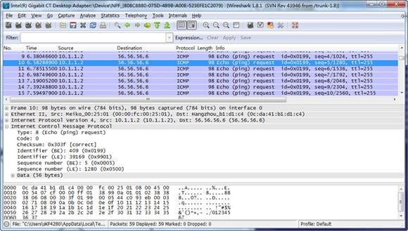

# Ping 56.56.56.6 from a host at 10.1.1.2 in the R&D department. Capture the packets on the data monitoring device, as shown in Figure 2. In this example, use Wireshark to capture packets.
Figure 2 Packets captured by Wireshark
The captured packets show that the local port mirroring function takes effect. The data monitoring device can successfully monitor the specified traffic.

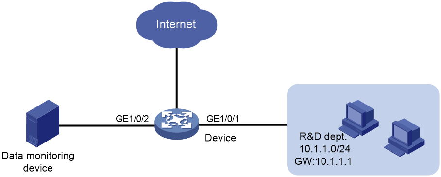

Configuring 1-to-1 local port mirroring
Introduction

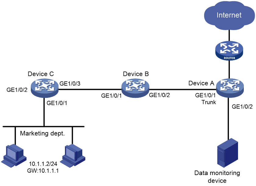

The following information uses an example to describe the basic procedure to configure 1-to-1 local port mirroring. 1-to-1 mirroring copies the packets of a single mirroring source port to a single monitor port.
The R&D department connects to Device through interface GigabitEthernet 1/0/1. Configure mirroring, so that the data monitoring device Server can monitor and analyze the incoming and outgoing packets of the R&D department.
Figure 3 Network diagram
·     For a local mirroring group to take effect, you must configure mirroring source ports and monitor ports for the group. Make sure each monitor port is not the member port of any other mirroring group.
·     A monitor port can receive both mirrored packets copied from mirroring source ports and normally forwarded packets from other ports. Use monitor ports only for port mirroring, so the data monitoring devices analyze only the mirrored packets copied from mirroring source ports.
# Create local mirroring group 1.
<Device> system-view
[Device] mirroring-group 1 local
# Configure GigabitEthernet 1/0/2 to monitor both the incoming packets and outgoing packets of GigabitEthernet 1/0/1 in local mirroring group 1.
[Device] mirroring-group 1 mirroring-port gigabitethernet 1/0/1 both
[Device] mirroring-group 1 monitor-port gigabitethernet 1/0/2
# Disable the spanning tree protocol on monitor port GigabitEthernet 1/0/2.
[Device] interface gigabitethernet 1/0/2
[Device-GigabitEthernet1/0/2] undo stp enable
[Device-GigabitEthernet1/0/2] quit
# Display the configuration information of all mirroring groups.
<Device> display mirroring-group all
Mirroring group 1:
    Type: Local
    Status: Active
    Mirroring port:
        GigabitEthernet1/0/1  Both
    Monitor port: GigabitEthernet1/0/2
Verify that you can monitor the incoming packets and outgoing packets of the R&D department on Server.

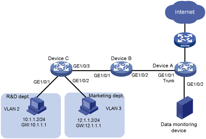

The following information uses an example to describe the basic procedure to configure 1-to-N local port mirroring. 1-to-N mirroring copies the packets of a single mirroring source port to many monitor ports.
The R&D department connects to Device through interface GigabitEthernet 1/0/1. Configure mirroring, so that data monitoring devices Server A, Server B, and Server C can monitor and analyze the incoming packets and outgoing packets of the R&D department.
Figure 4 Network diagram

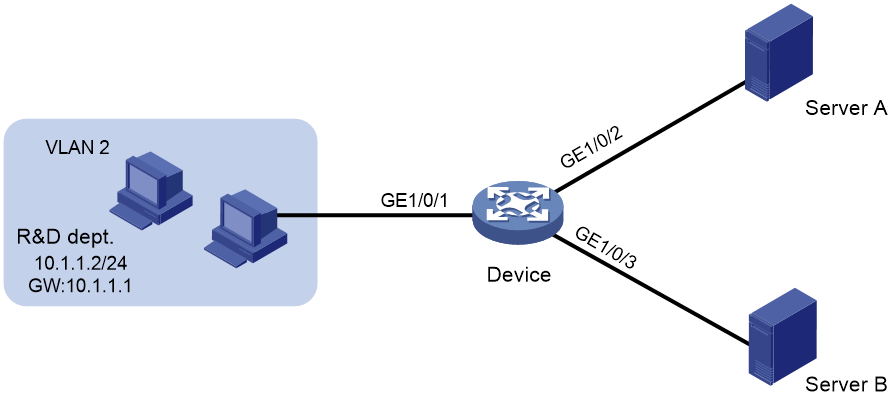

Configuring M-to-N local port mirroring
Introduction

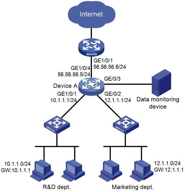

The following information uses an example to describe the basic procedure to configure M-to-N local port mirroring. M-to-N mirroring copies the packets of M mirroring source ports to N monitor ports.
The marketing department and the R&D department connect to Device through GigabitEthernet 1/0/1 and GigabitEthernet 1/0/2, respectively. Configure mirroring, so that different data monitoring devices Server A, Server B, and Server C can monitor and analyze the incoming packets and outgoing packets of the marketing department and the R&D department.
Figure 5 Network diagram
# Configure GigabitEthernet 1/0/3, GigabitEthernet 1/0/4, and GigabitEthernet 1/0/5 to monitor both the incoming packets and outgoing packets of GigabitEthernet 1/0/1 and GigabitEthernet 1/0/2 in local mirroring group 1.
[Device] mirroring-group 1 mirroring-port gigabitethernet 1/0/1 gigabitethernet 1/0/2 both
[Device] mirroring-group 1 monitor-port gigabitethernet 1/0/3 to gigabitethernet 1/0/5
# Disable the spanning tree protocol on monitor ports GigabitEthernet 1/0/3, GigabitEthernet 1/0/4, and GigabitEthernet 1/0/5.
[Device] interface gigabitethernet 1/0/3
[Device-GigabitEthernet1/0/3] undo stp enable
[Device-GigabitEthernet1/0/3] quit
[Device] interface gigabitethernet 1/0/4
Mirroring group 1:
    Type: Local
    Status: Active
    Mirroring port:
        GigabitEthernet1/0/2  Both
    Monitor port: GigabitEthernet1/0/3
                  GigabitEthernet1/0/4
                  GigabitEthernet1/0/5
Verify that you can monitor the incoming packets and outgoing packets of the marketing department and R&D department on Server A, Server B, and Server C.

Configuring local port mirroring with multiple monitor ports through a remote probe VLAN
Introduction
The following information uses an example to describe the basic procedure for configuring local port mirroring with multiple monitor ports through the remote probe VLAN method.
The R&D department connects to Device through interface GigabitEthernet 1/0/1. Configure mirroring, so that the data monitoring devices Server A and Server B can monitor the incoming and outgoing packets of the R&D department.
Figure 6 Network diagram
When a VLAN is configured as a remote probe VLAN, use the VLAN for port mirroring exclusively.
Only a static VLAN that already exists can be configured as a remote probe VLAN. A VLAN can be configured as the remote probe VLAN for only one mirroring group.
To delete a VLAN that is configured as a remote probe VLAN, first remove the remote probe VLAN configuration.
# Create VLAN 2.
[Device] vlan 2
[Device-vlan2] quit
# Create VLAN-interface 2, and assign an IP address to it.
[Device] interface vlan-interface 2
[Device-Vlan-interface2] ip address 10.1.1.1 24
[Device-Vlan-interface2] quit
# Create VLAN 10, which is to be used as the remote probe VLAN.
[Device] vlan 10
[Device-vlan10] quit
# Set the link type of GigabitEthernet 1/0/1 to trunk, and assign it to VLAN 2.
[Device-GigabitEthernet1/0/1] port link-type trunk
[Device-GigabitEthernet1/0/1] port trunk permit vlan 2
# Create remote source group 1.
[Device] mirroring-group 1 remote-source
# Configure GigabitEthernet 1/0/1, which connects to the R&D department, as the source port of remote source group 1.
[Device] mirroring-group 1 mirroring-port gigabitethernet1/0/1 both
# Configure an unused port (GigabitEthernet 1/0/4 in this example) as the reflector port of mirroring group 1.
[Device] mirroring-group 1 reflector-port gigabitethernet1/0/4
This operation may delete all settings made on the interface. Continue? [Y/N]:y
# Assign the interfaces connecting to data monitoring devices to VLAN 10.
[Device] vlan 10
[Device-vlan10] port gigabitethernet1/0/2 to gigabitethernet1/0/3
# Configure VLAN 10 as the remote probe VLAN of mirroring group 1.
[Device] mirroring-group 1 remote-probe vlan 10
# Display information about mirroring group 1 on Device.
[DeviceA] display mirroring-group all
Mirroring group 1:
    Type: Remote source
    Status: Active
    Mirroring port:
    Reflector port: GigabitEthernet1/0/4
    Remote probe VLAN: 10

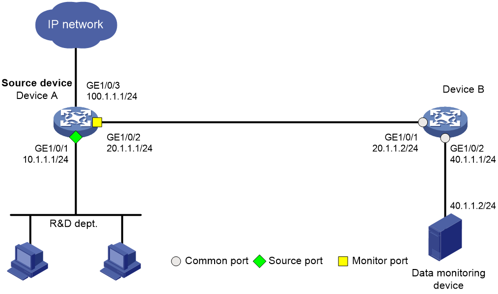

Configuring Layer 2 remote port mirroring in egress port mode
Introduction
The following information uses an example to describe the basic procedure for configuring Layer 2 remote port mirroring in egress port mode.
The departments of a company access the core device Device A through a Layer 2 network and these departments use IP addresses on different subnets. The R&D department uses subnet 10.1.1.0/24, and the marketing department uses subnet 12.1.1.0/24. Configure Layer 2 remote port mirroring in egress port mode, so that the data monitoring device can monitor the traffic from the R&D department.
Figure 7 Network diagram
To ensure correct forwarding of mirrored packets, assign the ports that connect intermediate devices to the source and destination devices to the remote probe VLAN.
As a best practice to ensure mirrored packet forwarding, configure mirroring on devices in the order of destination device, intermediate devices, and source device.
When configuring remote port mirroring on the destination device and source device, follow these restrictions and guidelines:
·     When configuring a remote probe VLAN, follow these restrictions and guidelines:
¡     Make sure the VLAN is an existing static VLAN.
¡     Use the VLAN for remote port mirroring only.
¡     The VLAN can be used by only one remote source group.
·     Make sure the remote mirroring groups on the source device and destination device use the same remote probe VLAN.
When configuring remote port mirroring on the destination device, follow these restrictions and guidelines:
·     Make sure the monitor port is not the member port of any other mirroring group.
·     Use the monitor port for port mirroring only.
When configuring remote port mirroring on the source device, follow these restrictions and guidelines:
·     For mirroring to operate correctly, do not assign source ports to the remote probe VLAN.

Configuring Device A (destination device)
# Create VLANs 2 and 3.
<DeviceA> system-view
[DeviceA] vlan 2 to 3
# Create VLAN 5, which is to be used as the remote probe VLAN.
[DeviceA] vlan 5
[DeviceA-vlan5] quit
# Create VLAN-interface 2, and assign an IP address to it, which is to be used as the gateway for the VLAN. Configure VLAN-interface 3 in the same way.
[DeviceA] interface vlan-interface 2
[DeviceA-Vlan-interface2] ip address 10.1.1.1 24
[DeviceA-Vlan-interface2] quit
[DeviceA] interface vlan-interface 3
[DeviceA-Vlan-interface3] ip address 12.1.1.1 24
[DeviceA-Vlan-interface3] quit
# Set the link type of GigabitEthernet 1/0/1 to trunk, and assign it to VLANs 2, 3, and 5.
[DeviceA-GigabitEthernet1/0/1] port link-type trunk
[DeviceA-GigabitEthernet1/0/1] port trunk permit vlan 2 3 5
[DeviceA-GigabitEthernet1/0/1] quit
# Create remote destination group 1.
[DeviceA] mirroring-group 1 remote-destination
# Configure VLAN 5 as the remote probe VLAN for the remote destination group. Configure GigabitEthernet 1/0/2, which connects to the data monitoring device, as the monitor port of remote destination group 1.
[DeviceA] mirroring-group 1 remote-probe vlan 5
[DeviceA] mirroring-group 1 monitor-port gigabitethernet 1/0/2
# Add the monitor port to the remote probe VLAN. When the mirrored packets are sent to the data monitoring device, they do not carry the tag of the remote probe VLAN. Therefore, set the link type of the interface to access.
[DeviceA] interface gigabitethernet 1/0/2
[DeviceA-GigabitEthernet1/0/2] port access vlan 5
# Disable the spanning tree protocol on the monitor port, GigabitEthernet 1/0/2.
[DeviceA-GigabitEthernet1/0/2] undo stp enable
[DeviceA-GigabitEthernet1/0/2] quit
Configuring Device B (intermediate device)
<DeviceB> system-view
[DeviceB] vlan 2 to 3
[DeviceB] vlan 5
[DeviceB-vlan5] quit
[DeviceB-GigabitEthernet1/0/1] port link-type trunk
[DeviceB-GigabitEthernet1/0/1] port trunk permit vlan 2 3 5
[DeviceB-GigabitEthernet1/0/1] quit
# Set the link type of GigabitEthernet 1/0/2 to trunk, and assign it to VLANs 2, 3, and 5.
[DeviceB] interface gigabitethernet 1/0/2
[DeviceB-GigabitEthernet1/0/2] port link-type trunk
[DeviceB-GigabitEthernet1/0/2] port trunk permit vlan 2 3 5
[DeviceB-GigabitEthernet1/0/2] quit
Configuring Device C (source device)
<DeviceC> system-view
[DeviceC] vlan 2 to 3
# Assign GigabitEthernet 1/0/1 to VLAN 2.
[DeviceC] interface gigabitethernet 1/0/1
[DeviceC-GigabitEthernet1/0/1] port access vlan 2
[DeviceC-GigabitEthernet1/0/1] quit
# Assign GigabitEthernet 1/0/2 to VLAN 3.
[DeviceC] interface gigabitethernet 1/0/2
[DeviceC-GigabitEthernet1/0/2] port access vlan 3
[DeviceC-GigabitEthernet1/0/2] quit
[DeviceC] mirroring-group 1 remote-source
[DeviceC] vlan 5
[DeviceC-vlan5] quit
#  Configure VLAN 5 as the remote probe VLAN, configure GigabitEthernet 1/0/1 as the source port, and configure GigabitEthernet 1/0/3 as the egress port for remote source group 1.
[DeviceC] mirroring-group 1 remote-probe vlan 5
[DeviceC] mirroring-group 1 mirroring-port gigabitethernet 1/0/1 inbound
[DeviceC] mirroring-group 1 monitor-egress gigabitethernet 1/0/3
# Set the link type of GigabitEthernet 1/0/3 to trunk, and assign it to VLANs 2, 3, and 5.
[DeviceC] interface gigabitethernet 1/0/3
[DeviceC-GigabitEthernet1/0/3] port link-type trunk
[DeviceC-GigabitEthernet1/0/3] port trunk permit vlan 2 3 5
[DeviceC-GigabitEthernet1/0/3] quit
# Disable the spanning tree protocol on the egress port, GigabitEthernet 1/0/3.
[DeviceC-GigabitEthernet1/0/3] undo stp enable
# Display information about mirroring group 1 on Device C.
[DeviceC] display mirroring-group 1
Mirroring group 1:
    Type: Remote source
    Status: Active
    Mirroring port:
        GigabitEthernet1/0/1  Inbound
    Monitor egress port: GigabitEthernet1/0/3
        Remote probe VLAN: 5
# Display information about mirroring group 1 on Device A.
[DeviceA] display mirroring-group 1
Mirroring group 1:
    Type: Remote destination
    Status: Active
# Ping a host at 12.1.1.2 in the marketing department from a host at 10.1.1.2 in the R&D department. Capture the packets on the data monitoring device, as shown in Figure 8. In this example, use Wireshark to capture packets.
Figure 8 Packets captured by Wireshark
The captured packets show that the Layer 2 remote port mirroring function takes effect. The data monitoring device can monitor the packets sent by the R&D department.

Configuring Layer 2 remote port mirroring in reflector port mode
Introduction
The following information uses an example to describe the basic procedure for configuring Layer 2 remote port mirroring in reflector port mode.
The marketing department of a company connects to the core device Device A through a Layer 2 network, and uses the subnet 10.1.1.0/24. Configure Layer 2 remote port mirroring in reflector port mode, so that the data monitoring device can monitor the traffic from the marketing department.
Figure 9 Network diagram
# Set the link type of GigabitEthernet 1/0/1 to trunk, and assign it to VLANs 2 and 5.
[DeviceA-GigabitEthernet1/0/1] port trunk permit vlan 2 5
# Create VLAN 2.
[DeviceB] vlan 2
[DeviceB] vlan 5
[DeviceB-GigabitEthernet1/0/1] port trunk permit vlan 2 5
# Set the link type of GigabitEthernet 1/0/2 to trunk, and assign it to VLANs 2 and 5.
[DeviceB-GigabitEthernet1/0/2] port trunk permit vlan 2 5
# Create VLAN 2.
[DeviceC] vlan 2
[DeviceC] vlan 5
#  Configure VLAN 5 as the remote probe VLAN, configure GigabitEthernet 1/0/1 as the source port, and configure GigabitEthernet 1/0/2 as the reflector port for remote source group 1.
[DeviceC] mirroring-group 1 reflector-port gigabitethernet 1/0/2
# Set the link type of GigabitEthernet 1/0/3 to trunk, and assign it to VLANs 2 and 5.
# Display configuration information of all mirroring groups on Device A.
Mirroring group 1:
    Status: Active
# Display configuration information of all mirroring groups on Device C.
[DeviceC] display mirroring-group all
Mirroring group 1:
    Type: Remote source
    Status: Active
    Mirroring port:
        GigabitEthernet1/0/1  inbound
    Reflector port: GigabitEthernet1/0/2

Configuring Layer 3 remote port mirroring in encapsulation parameter mode
Introduction
The following information uses an example to describe the basic procedure for configuring Layer 3 remote port mirroring in encapsulation parameter mode.
The R&D department uses the subnet 10.1.1.0/24. Configure Layer 3 remote port mirroring, so that the data monitoring device can monitor the traffic from the R&D department to Internet.
Figure 10 Network diagram
If intermediate devices exist between the source device and the destination device, configure a unicast routing protocol on the intermediate devices to ensure that the source device and the destination device can reach each other at Layer 3.
Procedures
# Assign IP address 10.1.1.1 to interface GigabitEthernet 1/0/1.
[DeviceA-GigabitEthernet1/0/1] port link-mode route
[DeviceA-GigabitEthernet1/0/1] ip address 10.1.1.1 24
# Assign IP address 20.1.1.1 to interface GigabitEthernet 1/0/2.
[DeviceA-GigabitEthernet1/0/2] port link-mode route
[DeviceA-GigabitEthernet1/0/2] ip address 20.1.1.1 24
# Assign IP address 100.1.1.1 to interface GigabitEthernet 1/0/3.
[DeviceA] interface gigabitethernet 1/0/3
[DeviceA-GigabitEthernet1/0/3] port link-mode route
[DeviceA-GigabitEthernet1/0/3] ip address 100.1.1.1 24
[DeviceA-GigabitEthernet1/0/3] quit
# Configure OSPF.
[DeviceB] ospf 1
[DeviceB-ospf-1] area 0
[DeviceB-ospf-1-area-0.0.0.0] network 10.1.1.0 0.0.0.255
[DeviceB-ospf-1-area-0.0.0.0] network 20.1.1.0 0.0.0.255
[DeviceB-ospf-1-area-0.0.0.0] quit
[DeviceB-ospf-1] quit
# Configure a source port for local mirroring group 1.
[DeviceA] mirroring-group 1 mirroring-port gigabitethernet 1/0/1 inbound
# Configure the monitor port and encapsulation parameters of mirrored packets for local mirroring group 1.
[DeviceA] mirroring-group 1 monitor-port gigabitethernet 1/0/2 destination-ip 40.1.1.2 source-ip 20.1.1.1
# Assign IP address 20.1.1.2 to interface GigabitEthernet 1/0/1.
[DeviceA-GigabitEthernet1/0/1] ip address 20.1.1.2 24
# Assign IP address 40.1.1.1 to interface GigabitEthernet 1/0/2.
[DeviceA-GigabitEthernet1/0/2] ip address 40.1.1.1 24
# Configure OSPF.
[DeviceB] ospf 1
[DeviceB-ospf-1-area-0.0.0.0] network 40.1.1.0 0.0.0.255
Mirroring group 1:
    Type: Local
    Status: Active
    Mirroring port:
                  Encapsulation: Destination IP address 40.1.1.2
                                 Source IP address 20.1.1.1
                                 Destination MAC address 1025-4125-412b
Configuration files

Configuring local flow mirroring
Introduction
The following information uses an example to describe the basic procedure for configuring local flow mirroring.
The R&D department of a company uses the 10.1.1.1/24 subnet. Configure local flow mirroring to enable the data monitoring device to monitor the WWW traffic from hosts in the R&D department to Internet.
Figure 11 Network diagram
[Device-GigabitEthernet1/0/1] port link-mode route
[Device-GigabitEthernet1/0/1] ip address 10.1.1.0 24
# Create ACL 3000, and configure a rule to match the traffic from the R&D department to Internet.
[Device] acl number 3000
[Device-acl-adv-3000] rule permit tcp destination-port eq www source 10.1.1.0 0.0.0.255
[Device-acl-adv-3000] quit
# Create traffic class classifier_research, and use ACL 3000 as a match criterion.
[Device] traffic classifier classifier_research
[Device-classifier-classifier_research] if-match acl 3000
[Device-classifier-classifier_research] quit
# Create traffic behavior behavior_research, and configure an action of mirroring traffic to interface GigabitEthernet 1/0/2.
[Device] traffic behavior behavior_research
[Device-behavior-behavior_research] mirror-to interface gigabitethernet 1/0/2
[Device-behavior-behavior_research] quit
# Create QoS policy policy_research. Associate traffic class classifier_research with traffic behavior behavior_research.
[Device] qos policy policy_research
[Device-qospolicy-policy_research] classifier classifier_research behavior behavior_research
[Device-qospolicy-policy_research] quit
# Apply QoS policy policy_research to the inbound direction of interface GigabitEthernet 1/0/1.
[Device-GigabitEthernet1/0/1] qos apply policy policy_research inbound
# Display the flow mirroring configuration information on Device.
[Device] display qos policy interface
  Interface: GigabitEthernet1/0/1
  Direction: Inbound
  Policy: policy_research
   Classifier: classifier_research
     Operator: AND
     Rule(s) :
      If-match acl 3000
     Behavior: behavior_research
      Mirroring:
        Mirror to the interface: GigabitEthernet1/0/2
Configuration files
acl number 3000
 rule 0 permit tcp source 10.1.1.0 0.0.0.255 destination-port eq www
traffic classifier classifier_research operator and
 if-match acl 3000
 mirror-to interface GigabitEthernet1/0/2
 ip address 10.1.1.0 0.0.0.255
Related documentation
·     Flow mirroring configuration in the network management and monitoring configuration guide for the device.
·     Flow mirroring commands in the network management and monitoring command reference for the device.
