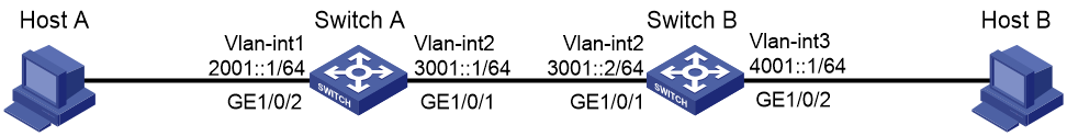

The following information uses an example to describe the basic procedure for configuring basic static route settings.
As shown in Figure 1, configure static routes so that Switch A and Switch C can communicate with each other.
Figure 1 Network diagram
Configuring Switch A
# Create a VLAN and assign a port to it. Configure the IP address of the VLAN interface.
<SwitchA> system-view
[SwitchA] vlan 100
[SwitchA-vlan100] port gigabitethernet 1/0/1
[SwitchA-vlan100] quit
[SwitchA-Vlan-interface100] ip address 10.1.1.1 24
# Configure a static route.
[SwitchA] ip route-static 20.1.1.0 24 10.1.1.2
# Save the configuration.
[SwitchA] save force
Configuring Switch B
# Create VLANs and assign ports to them. Configure the IP addresses of the VLAN interfaces.
<SwitchB> system-view
[SwitchB] vlan 100
[SwitchB-vlan100] port gigabitethernet 1/0/1
[SwitchB-vlan100] quit
[SwitchB] vlan 200
[SwitchB-vlan200] port gigabitethernet 1/0/2
[SwitchB-vlan200] quit
[SwitchB-Vlan-interface100] ip address 10.1.1.2 24
[SwitchB] interface vlan-interface 200
[SwitchB-Vlan-interface200] ip address 20.1.1.1 24
[SwitchB-Vlan-interface200] quit
[SwitchB] save force
Configuring Switch C
<SwitchC> system-view
[SwitchC] vlan 200
[SwitchC-vlan200] port gigabitethernet 1/0/1
[SwitchC-vlan200] quit
[SwitchC] interface vlan-interface 200
[SwitchC-Vlan-interface200] ip address 20.1.1.2 24
[SwitchC-Vlan-interface200] quit
[SwitchC] ip route-static 10.1.1.0 24 20.1.1.1
[SwitchC] save force
# Ping Switch C on Switch A to verify that they are connected.
[SwitchA] ping 20.1.1.2
Ping 20.1.1.2 (20.1.1.2): 56 data bytes, press CTRL+C to break
56 bytes from 20.1.1.2: icmp_seq=0 ttl=255 time=2.000 ms
56 bytes from 20.1.1.2: icmp_seq=1 ttl=255 time=0.000 ms
56 bytes from 20.1.1.2: icmp_seq=2 ttl=255 time=0.000 ms
56 bytes from 20.1.1.2: icmp_seq=3 ttl=255 time=1.000 ms
56 bytes from 20.1.1.2: icmp_seq=4 ttl=255 time=0.000 ms
--- Ping statistics for 20.1.1.2 ---
round-trip min/avg/max/std-dev = 0.000/0.600/2.000/0.800 ms

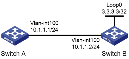

The following example describes the basic procedure to configure basic IPv6 static route settings.
As shown in Figure 2, the switches act as gateways of an enterprise, and they are required to perform stateless address autoconfiguration for Host A and Host B. Then the hosts in different subnets can access each other through IPv6 static routes. To meet the requirements, configure the associated settings as follows:
·     Connect Host A, Host B, Switch A, and Switch B through Ethernet ports. Add the Ethernet ports to corresponding VLANs. Configure IPv6 addresses for the VLAN interfaces and verify that they are connected.
·     Configure IPv6 static routes on Switch A and Switch B for interconnections between the subnets.
Figure 2 Network diagram
[SwitchA] vlan 4
[SwitchA-vlan4] port gigabitethernet 1/0/2
[SwitchA-vlan4] quit
[SwitchA] vlan 2
[SwitchA-vlan2] port gigabitethernet 1/0/1
[SwitchA-vlan2] quit
# Specify a global unicast address for VLAN-interface 2.
[SwitchA-Vlan-interface2] ipv6 address 3001::1/64
# Specify a global unicast address for VLAN-interface 4, and allow it to advertise RA messages (no interface advertises RA messages by default).
[SwitchA] interface vlan-interface 4
[SwitchA-Vlan-4] ipv6 address 2001::1/64
[SwitchA-Vlan-4] undo ipv6 nd ra halt
[SwitchA-Vlan-4] quit
# Configure an IPv6 static route with destination IPv6 address 4001::/64 and next hop address 3001::2.
[SwitchA] ipv6 route-static 4001:: 64 3001::2
[SwitchB] vlan 2
[SwitchB-vlan2] port gigabitethernet 1/0/1
[SwitchB-vlan2] quit
[SwitchB] vlan 3
[SwitchB-vlan3] port gigabitethernet 1/0/2
[SwitchB-vlan3] quit
[SwitchB-Vlan-interface2] ipv6 address 3001::2/64
[SwitchB-Vlan-interface2] quit
# Specify a global unicast address for VLAN-interface 3, and allow it to advertise RA messages (no interface advertises RA messages by default).
[SwitchB] interface vlan-interface 3
[SwitchB-Vlan-interface3] ipv6 address 4001::1/64
[SwitchB-Vlan-interface3] undo ipv6 nd ra halt
[SwitchB-Vlan-interface3] quit
# Configure an IPv6 static route with destination IPv6 address 2001::/64 and next hop address 3001::1.
[SwitchB] ipv6 route-static 2001:: 64 3001::1
Configuring Host A
Enable IPv6 for the host to automatically obtain an IPv6 address through IPv6 ND.
Configuring Host B
# Display neighbor information for GigabitEthernet 1/0/2 on Switch A.
[SwitchA] display ipv6 neighbors interface gigabitethernet 1/0/2
Type: S-Static    D-Dynamic    O-Openflow     R-Rule    IS-Invalid static
IPv6 address              MAC address    VLAN/VSI   Interface     State T  Aging
2001::15B:E0EA:3524:E791  0015-e9a6-7d14 4          GE1/0/2       REACH D  1248
FE80::215:E9FF:FEA6:7D14  0015-e9a6-7d14 4          GE1/0/2       REACH D  1238
The output shows that the IPv6 global unicast address that Host A obtained is 2001::15B:E0EA:3524:E791.
# Display neighbor information for GigabitEthernet 1/0/2 on Switch B.
[SwitchB] display ipv6 neighbors interface gigabitethernet 1/0/2
4001::B15F:BC63:DBCE:EB57 6805-ca8b-18f3 3          GE1/0/2       REACH D  46
FE80::510B:D60F:31A7:4AFF 6805-ca8b-18f3 3          GE1/0/2       REACH D  1238
The output shows that the IPv6 global unicast address that Host B obtained is 4001::B15F:BC63:DBCE:EB57.
# Ping Host B on Switch A to verify that they are connected.
[Switch A] ping ipv6 4001::B15F:BC63:DBCE:EB57
Ping6(56 data bytes) 3001::1 --> 4001::B15F:BC63:DBCE:EB57, press CTRL+C to break
56 bytes from 4001::B15F:BC63:DBCE:EB57, icmp_seq=0 hlim=64 time=1.000 ms
56 bytes from 4001::B15F:BC63:DBCE:EB57, icmp_seq=1 hlim=64 time=0.000 ms
56 bytes from 4001::B15F:BC63:DBCE:EB57, icmp_seq=2 hlim=64 time=0.000 ms
56 bytes from 4001::B15F:BC63:DBCE:EB57, icmp_seq=3 hlim=64 time=1.000 ms
56 bytes from 4001::B15F:BC63:DBCE:EB57, icmp_seq=4 hlim=64 time=0.000 ms
--- Ping6 statistics for 4001::B15F:BC63:DBCE:EB57 ---
round-trip min/avg/max/std-dev = 0.000/0.400/1.000/0.490 ms
# Ping Host A on Switch B to verify that they are connected.
[Switch B] ping ipv6 2001::15B:E0EA:3524:E791
Ping6(56 data bytes) 3001::2 --> 2001::15B:E0EA:3524:E791, press CTRL+C to break
56 bytes from 2001::15B:E0EA:3524:E791, icmp_seq=0 hlim=64 time=1.000 ms
56 bytes from 2001::15B:E0EA:3524:E791, icmp_seq=1 hlim=64 time=0.000 ms
56 bytes from 2001::15B:E0EA:3524:E791, icmp_seq=2 hlim=64 time=0.000 ms
56 bytes from 2001::15B:E0EA:3524:E791, icmp_seq=3 hlim=64 time=1.000 ms
56 bytes from 2001::15B:E0EA:3524:E791, icmp_seq=4 hlim=64 time=0.000 ms
--- Ping6 statistics for 2001::15B:E0EA:3524:E791 ---
The output shows that Host A can also ping Host B.

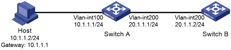

The following information uses an example to describe the basic procedure for configuring a default route.
As shown in Figure 3, configure a default route on Switch A, and specify the next hop address as 10.1.1.2/24, an IP address of the interface on Switch B . After configuration, Switch A can ping loopback interface address 3.3.3.3/32 of Switch B.
Figure 3 Network diagram
[SwitchA] vlan 100
# Configuring a default route.
[SwitchA] ip route-static 0.0.0.0 0 10.1.1.2
[SwitchB] vlan 100
# Assign an IP address to the loopback interface..
[SwitchB] interface LoopBack 0
[SwitchB-LoopBack0] ip address 3.3.3.3 32
# Ping 3.3.3.3 on Switch A without a default route configured. The Ioopback interface address cannot be pinged.
[SwitchA] ping 3.3.3.3
Ping 3.3.3.3 (3.3.3.3): 56 data bytes, press CTRL+C to break

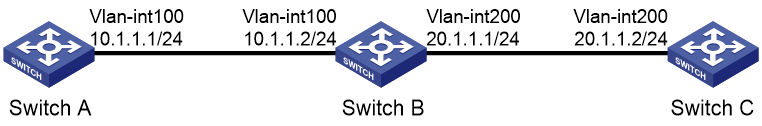

Configuring a floating static route
Introduction
The following information uses an example to describe the basic procedure for configuring a floating static route.
A floating static route is used for route backup. As shown in Figure 4, Switch A, Switch B, Switch C, and Switch D connect networks 20.1.1.0/24 and 30.1.1.0/24. Configure static routes on the switches for communication between the two networks, and configure route backup to improve network availability.
Switch A is the default gateway of the hosts in network 20.1.1.0/24. To ensure network availability, configure static routes to 30.1.1.0/24 for backup on Switch A as follows:
·     The static route with next hop Switch B acts as the master route.
·     The static route with next hop Switch C acts as the backup route. When the master route is unavailable, the backup route takes effect. Switch A forwards packets to 30.1.1.0/24 through Switch C.
·     When the master route recovers, service traffic switches back to the master route.
Figure 4 Network diagram
In this application scenario, make sure the spanning tree feature is disabled.
# Create VLANs and assign ports to them. Configure the IP address of each VLAN interface.
[SwitchA] vlan 2
[SwitchA] vlan 3
[SwitchA-vlan3] port gigabitethernet 1/0/2
[SwitchA-vlan3] quit
[SwitchA] vlan 6
[SwitchA-vlan6] port gigabitethernet 1/0/3
[SwitchA-vlan6] quit
[SwitchA-Vlan-interface2] ip address 10.1.1.1 24
[SwitchA] interface vlan-interface 3
[SwitchA-Vlan-interface3] ip address 10.3.1.1 24
[SwitchA-Vlan-interface3] quit
[SwitchA] interface vlan-interface 6
[SwitchA-Vlan-interface6] ip address 20.1.1.1 24
[SwitchA-Vlan-interface6] quit
# Configure a static route to 30.1.1.0/24 with next hop 10.1.1.2 and the default priority (60).
[SwitchA] ip route-static 30.1.1.0 24 10.1.1.2
# Configure a static route to 10.2.1.0/24 with next hop 10.1.1.2 and the default priority (60).
[SwitchA] ip route-static 10.2.1.0 24 10.1.1.2
# Configure a static route to 30.1.1.0/24 with next hop 10.3.1.3 and priority 80.
[SwitchA] ip route-static 30.1.1.0 24 10.3.1.3 preference 80
# Configure a static route to 10.4.1.0/24 with next hop 10.3.1.3 and priority 80.
[SwitchA] ip route-static 10.4.1.0 24 10.3.1.3 preference 80
[SwitchB] vlan 2
[SwitchB] vlan 5
[SwitchB-vlan5] port gigabitethernet 1/0/2
[SwitchB-vlan5] quit
[SwitchB-Vlan-interface2] ip address 10.1.1.2 24
[SwitchB] interface vlan-interface 5
[SwitchB-Vlan-interface5] ip address 10.2.1.2 24
[SwitchB-Vlan-interface5] quit
# Configure a static route to 30.1.1.0/24 with next hop 10.2.1.4.
[SwitchB] ip route-static 30.1.1.0 24 10.2.1.4
# Configure a static route to 20.1.1.0/24 with next hop 10.1.1.1.
[SwitchB] ip route-static 20.1.1.0 24 10.1.1.1
[SwitchC] vlan 3
[SwitchC-vlan3] port gigabitethernet 1/0/1
[SwitchC-vlan3] quit
[SwitchC] vlan 4
[SwitchC-vlan4] port gigabitethernet 1/0/2
[SwitchC-vlan4] quit
[SwitchC] interface vlan-interface 3
[SwitchC-Vlan-interface3] ip address 10.3.1.3 24
[SwitchC-Vlan-interface3] quit
[SwitchC] interface vlan-interface 4
[SwitchC-Vlan-interface4] ip address 10.4.1.3 24
[SwitchC-Vlan-interface4] quit
# Configure a static route to 30.1.1.0/24 with next hop 10.4.1.4.
[SwitchC] ip route-static 30.1.1.0 24 10.4.1.4
# Configure a static route to 20.1.1.0/24 with next hop 10.3.1.1.
[SwitchC] ip route-static 20.1.1.0 24 10.3.1.1
Configuring Switch D
<SwitchD> system-view
[SwitchD] vlan 4
[SwitchD-vlan4] port gigabitethernet 1/0/1
[SwitchD-vlan4] quit
[SwitchD] vlan 5
[SwitchD-vlan5] port gigabitethernet 1/0/2
[SwitchD-vlan5] quit
[SwitchD] vlan 7
[SwitchD-vlan7] port gigabitethernet 1/0/3
[SwitchD-vlan7] quit
[SwitchD] interface vlan-interface 4
[SwitchD-Vlan-interface6] ip address 10.4.1.4 24
[SwitchD-Vlan-interface6] quit
[SwitchD] interface vlan-interface 5
[SwitchD-Vlan-interface5] ip address 10.2.1.4 24
[SwitchD-Vlan-interface5] quit
[SwitchD] interface vlan-interface 7
[SwitchD-Vlan-interface7] ip address 30.1.1.1 24
[SwitchD-Vlan-interface7] quit
# Configure a static route to 20.1.1.0/24 with next hop 10.2.1.2 and the default priority (60).
[SwitchD] ip route-static 20.1.1.0 24 10.2.1.2
# Configure a static route to 10.1.1.0/24 with next hop 10.2.1.2 and the default priority (60).
[SwitchD] ip route-static 10.1.1.0 24 10.2.1.2
# Configure a static route to 20.1.1.0/24 with next hop 10.4.1.3 and priority 80.
[SwitchD] ip route-static 20.1.1.0 24 10.4.1.3 preference 80
# Configure a static route to 10.3.1.0/24 with next hop 10.4.1.3 and priority 80.
[SwitchD] ip route-static 10.3.1.0 24 10.4.1.3 preference 80
[SwitchD] save force

Configuring static routing-Track-NQA collaboration
Introduction
The following information uses an example to describe the basic procedure for configuring static routing-Track-NQA collaboration.
As shown in Figure 6:
·     Switch A is the default gateway of the hosts in network 20.1.1.0/24.
·     Switch D is the default gateway of the hosts in network 30.1.1.0/24.
·     Hosts in the two networks communicate with each other through static routes.
To ensure network availability, configure route backup and static routing-Track-NQA collaboration on Switch A and Switch D as follows:
·     On Switch A, assign a higher priority to the static route to 30.1.1.0/24 with next hop Switch B. This route is the master route. The static route to 30.1.1.0/24 with next hop Switch C acts as the backup route. When the master route is unavailable, the backup route takes effect. Switch A forwards packets to 30.1.1.0/24 through Switch C.
·     On Switch D, assign a higher priority to the static route to 20.1.1.0/24 with next hop Switch B. This route is the master route. The static route to 20.1.1.0/24 with next hop Switch C acts as the backup route. When the master route is unavailable, the backup route takes effect. Switch D forwards packets to 20.1.1.0/24 through Switch C.
Figure 6 Network diagram
Analysis
1.     Assign IP address to the devices.
2.     Configure static routes:
Assign a higher priority to the static route with Switch B as the next hop (master route) than the static route with Switch C as the next hop (backup route).
3.     Configure NQA operations:
Configure NQA operations on Switch A and Switch D to test the connectivity of the path Switch A-Switch B-Switch D. Associate Track with the NQA operations to implement collaboration between static routing, Track, and NQA.

Accessing the Web interface of a device in a different subnet
Introduction
The following information uses an example to describe the basic procedure for accessing the Web interface of a device in a different subnet.
As shown in Figure 7, the host is connected to the switches in an IP network and has a route to reach the switches. Enable the host to access the Web interface of Switch B through HTTP in a different subnet.
Figure 7 Network diagram
[SwitchA] vlan 100
[SwitchA] vlan 200
[SwitchA-vlan200] port gigabitethernet 1/0/2
[SwitchA-vlan200] quit
[SwitchA] interface vlan-interface 200
[SwitchA-Vlan-interface200] ip address 20.1.1.1 24
[SwitchA-Vlan-interface200] quit
[SwitchB] vlan 200
[SwitchB-vlan200] port gigabitethernet 1/0/1
[SwitchB-Vlan-interface200] ip address 20.1.1.2 24
# Configure username admin, authentication password hello12345, service type http, and user role network-admin.
[SwitchB] local-user admin
[SwitchB-luser-manage-admin] service-type http
[SwitchB-luser-manage-admin] authorization-attribute user-role network-admin
[SwitchB-luser-manage-admin] password simple hello12345
[SwitchB-luser-manage-admin] quit
# Enable the HTTP service.
[SwitchB] ip http enable
[SwitchB] ip route-static 10.1.1.0 24 20.1.1.1
Configuring the host
# Configure IP address 10.1.1.2, subnet mask 255.255.255.0, and gateway address 10.1.1.1 for the host. (Details not shown.)
# Ping Switch B on the host to verify that host can communicate with Switch B (assuming Windows XP is installed on the host).
C:\Documents and Settings\Administrator>ping 20.1.1.2
Pinging 20.1.1.2 with 32 bytes of data:
Reply from 20.1.1.2: bytes=32 time=1ms TTL=126
Ping statistics for 20.1.1.2:
# Enter the IP address of Switch B in the address bar of the browser on the host. The browser can display the Web login page. Enter the username and password on the page, and the click Login. After login, you can perform device configuration on the associated pages.
Figure 8 Web login page of Switch B
Configuration files
·     Switch A:
vlan 100
vlan 200
interface Vlan-interface100
interface Vlan-interface200
 ip address 20.1.1.1 255.255.255.0
 port link-mode bridge
 port access vlan 100
 port access vlan 200
·     Switch B:
vlan 200
 ip address 20.1.1.2 255.255.255.0
local-user admin class manage
 password hash $h$6$BdqhpnjJwOBmHmmt$rQ/FQ6WnS9gVhEpdZY3hjvWSYxCtI+9ngtivuAwrvFdCDVE8AepcSxtprJR5XAdrYbXQE76FumgUszLRn03a0g==
 service-type http
 authorization-attribute user-role network-operator
 ip http enable
Related documentation
·     Static routing configuration in the Layer 3—IP routing configuration guide for the device.
·     Static routing commands in the Layer 3—IP routing command reference for the device.
·     Login management configuration in the fundamentals configuration guide for the device.
·     Login management commands in the fundamentals command reference for the device.
