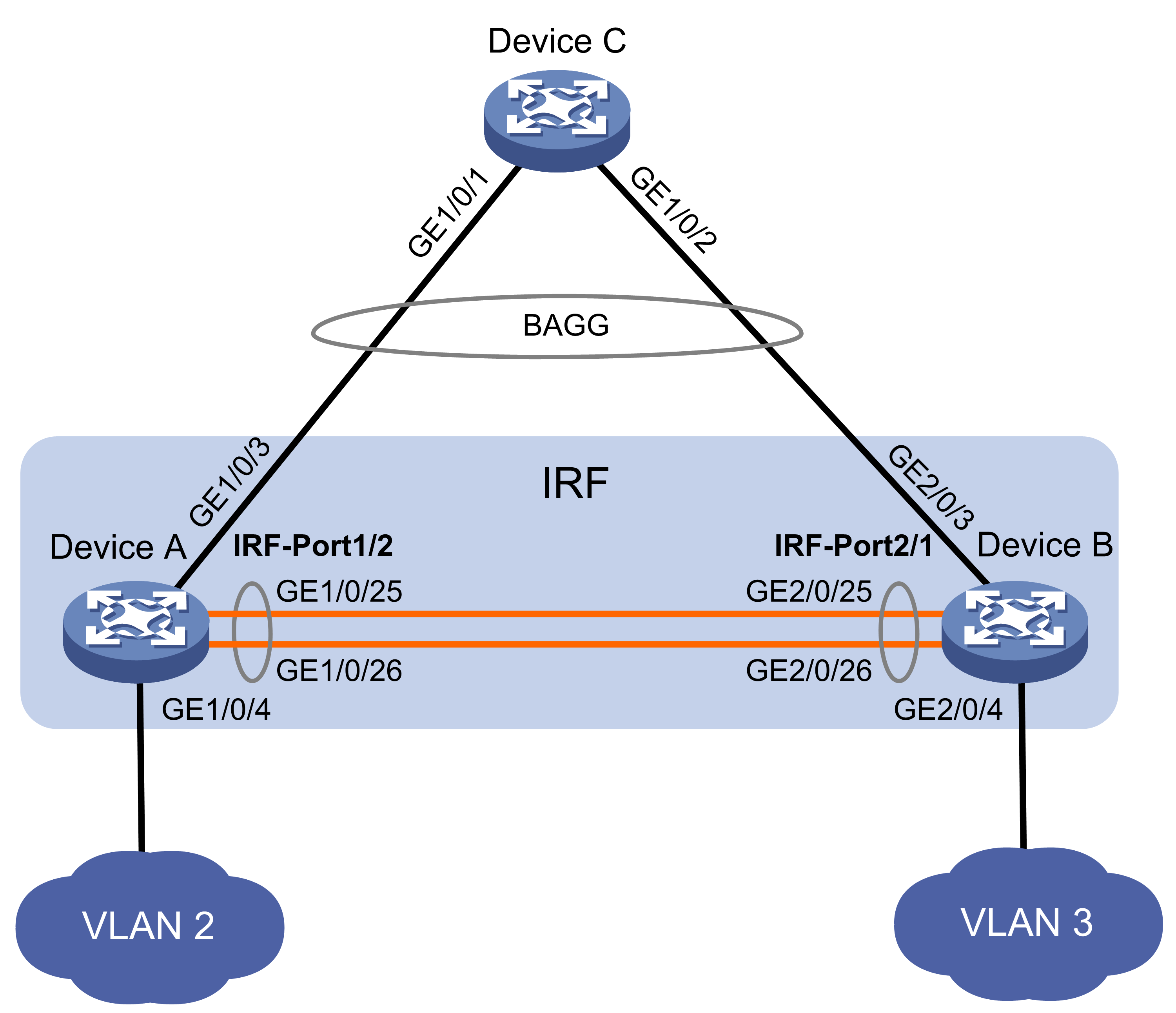

Enabling local-first load sharing for link aggregation
Introduction
The following information uses an example to describe the basic procedure for enabling local-first load sharing for link aggregation.
As shown in Figure 2:
· Device A and Device B form an IRF fabric and are aggregated across member devices via the GigabitEthernet1/0/3 and GigabitEthernet 2/0/3.
· Due to the aggregated load sharing feature, traffic from VLAN 2 and VLAN 3 is forwarded to Device C via GigabitEthernet 1/0/3 and GigabitEthernet 2/0/3, resulting in low traffic forwarding efficiency. If the bandwidth is satisfied, we want the traffic of VLAN 2 to be forwarded through GigabitEthernet 1/0/3 and the traffic of VLAN 3 to be forwarded through GigabitEthernet 2/0/3 in order to improve the traffic forwarding efficiency.
This feature is available only in IRF mode.
As a best practice, configure this feature only when the bandwidth of a single IRF device is sufficient to carry the traffic forwarding requirements. This can improve forwarding efficiency and alleviate the problem of high bandwidth carrying pressure on the IRF fabric.
For more information about IRF setup, see IRF Quick Start Configuration Guide or the Configuration Guide and Command Reference of the product.
Configuring Device A
# Enter system view, and create Layer 2 aggregate interface Bridge-Aggregation 1.
<DeviceA> system-view
[DeviceA] interface bridge-aggregation 1
[DeviceA-Bridge-Aggregation1] quit
# Assign GigabitEthernet 1/0/3 and GigabitEthernet 2/0/3 to Layer 2 aggregate interface Bridge-Aggregation 1.
[DeviceA] interface gigabitethernet 1/0/3
[DeviceA-GigabitEthernet1/0/3] port link-aggregation group 1
[DeviceA-GigabitEthernet1/0/3] quit
[DeviceA] interface gigabitethernet 2/0/3
[DeviceA-GigabitEthernet2/0/3] port link-aggregation group 1
[DeviceA-GigabitEthernet2/0/3] quit
# Configure Layer 2 aggregate interface Bridge-Aggregation 1 as a trunk port, and assign the port to all VLANs.
[DeviceA-Bridge-Aggregation1]port link-type trunk
[DeviceA-Bridge-Aggregation1]port trunk permit vlan all
[DeviceA-Bridge-Aggregation1]quit
# Enable local-first load sharing on the aggregate interface.
[DeviceA] link-aggregation load-sharing mode local-first
# Create VLAN 2 and VLAN 3.
[DeviceA] vlan 2 to 3
# Configure GigabitEthernet 1/0/4 as a trunk port, and assign the port to VLAN 2.
[DeviceA] interface gigabitethernet 1/0/4
[DeviceA-GigabitEthernet1/0/4]port link-type trunk
[DeviceA-GigabitEthernet1/0/4]undo port trunk permit vlan 1
[DeviceA-GigabitEthernet1/0/4]port trunk permit vlan 2
[DeviceA-GigabitEthernet1/0/4]quit
# Configure GigabitEthernet 2/0/4 as a trunk port, and assign the port to VLAN 3.
[DeviceA] interface gigabitethernet 2/0/4
[DeviceA-GigabitEthernet2/0/4]port link-type trunk
[DeviceA-GigabitEthernet2/0/4]undo port trunk permit vlan 1
[DeviceA-GigabitEthernet2/0/4]port trunk permit vlan 3
[DeviceA-GigabitEthernet2/0/4]quit
Configuring Device B
Configure Device B in the same way Device A is configured. (Details not shown.)
Configuring Device C
<DeviceC> system-view
[DeviceC] interface bridge-aggregation 1
[DeviceC-Bridge-Aggregation1] quit
# Assign GigabitEthernet 1/0/1 and GigabitEthernet 1/0/2 to Layer 2 aggregate interface Bridge-Aggregation 1.
[DeviceC] interface range gigabitethernet 1/0/1 to gigabitethernet 1/0/2
[DeviceC-if-range] port link-aggregation group 1
[DeviceC-if-range] quit
[DeviceC-Bridge-Aggregation1]port link-type trunk
[DeviceC-Bridge-Aggregation1]port trunk permit vlan all
[DeviceC-Bridge-Aggregation1]quit
# Use display link-aggregation verbose to display detailed information about the aggregation groups.
[DeviceA] display link-aggregation verbose
Loadsharing Type: Shar -- Loadsharing, NonS -- Non-Loadsharing
Port Status: S -- Selected, U -- Unselected, I -- Individual
Port: A -- Auto port, M -- Management port, R -- Reference port
Flags: A -- LACP_Activity, B -- LACP_Timeout, C -- Aggregation,
G -- Defaulted, H -- Expired
Aggregation Interface: Bridge-Aggregation1
Aggregation Mode: Static
Management VLANs: None
Port Status Priority Oper-Key
GE1/0/3 S 32768 1
GE2/0/3 S 32768 1
The output shows that all member ports in the static aggregation group are in the Selected state. The traffic of VLAN 2 is forwarded only through GigabitEthernet 1/0/3.
Configuration files
· Device A:
interface Bridge-Aggregation1
port link-mode bridge
interface GigabitEthernet2/0/3
interface GigabitEthernet1/0/4
interface GigabitEthernet2/0/4
· Device B:
The configuration file on Device B is the same as the configuration file on Device A.
· Device C:
Related documentation
· Ethernet link aggregation configuration in the Layer 2—LAN switching configuration guide for the device.
· Ethernet link aggregation commands in the Layer 2—LAN switching command reference for the device.
