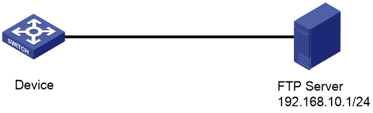

As shown in Figure 1, back up the current configuration file of the device to the FTP server.
Figure 1 Network diagram
Make sure the device can reach the FTP server.

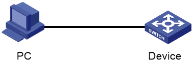

As shown in Figure 2, the device starts up with the initial configuration and skips automatic configuration.
Figure 2 Network diagram
When the device starts up with the initial configuration, log in to the device from the console port. For more information about console login, see Login Management Quick Start Configuration Guide.
