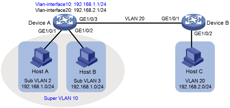

Configuring super VLANs
Introduction
The following information uses an example to describe the basic procedure for configuring super VLANs.
As shown in Figure 2:
·     Users in VLAN 2 access the network through GigabitEthernet 1/0/1 on Device A. Users in VLAN 3 access the network through GigabitEthernet 1/0/2 on Device A. There are 30 users in VLAN 2 and 50 users in VLAN 3.
·     GigabitEthernet 1/0/3 on Device A and GigabitEthernet 1/0/1 on Device B belong to VLAN 20.
·     Endpoint users in VLAN 20 use the 192.168.2.0/24 subnet and use 192.168.2.1 as the gateway address.
Configure a super VLAN to meet the following requirements:
·     Endpoint users in VLAN 2 and VLAN 3 use the 192.168.1.0/24 subnet to save IP address resources and use 192.168.1.1 as the gateway address.
·     Endpoints users in VLANs 2, 3, and 20 are isolated at Layer 2 and can communicate at Layer 3.
Figure 2 Network diagram
A super VLAN cannot contain physical interfaces. If a VLAN already contains physical interfaces, you cannot configure it as a super VLAN.
Procedures
Configuring Device A
# Create VLAN 10, and configure it as a super VLAN.
<DeviceA> system-view
[DeviceA] vlan 100
[DeviceA-vlan10] supervlan
[DeviceA-vlan10] quit
# Create VLAN 2. Assign GigabitEthernet 1/0/1 to VLAN 2.
[DeviceA] vlan 100
[DeviceA-vlan2] port gigabitethernet 1/0/1
[DeviceA-vlan2] quit
# Create VLAN 3. Assign GigabitEthernet 1/0/2 to VLAN 3.
[DeviceA] vlan 100
[DeviceA-vlan3] port gigabitethernet 1/0/2
[DeviceA-vlan3] quit
# Associate super VLAN 20 with sub-VLANs 2 and 3.
[DeviceA] vlan 100
[DeviceA-vlan10] subvlan 2 3
# Assign an IP address to the VLAN interface for super VLAN 10, and enable local proxy on the VLAN interface.
[DeviceA] interface vlan-interface 10
[DeviceA-Vlan-interface10] ip address 192.168.1.1 24
[DeviceA-Vlan-interface10] local-proxy-arp enable
[DeviceA-Vlan-interface10] quit
# Create VLAN 20.
[DeviceA] vlan 100
[DeviceA-vlan20] quit
# Set the link type of GigabitEthernet 1/0/3 to trunk and assign it to VLAN 20. Remove it from VLAN 1.
[DeviceA] interface gigabitethernet 1/0/3
[DeviceA-GigabitEthernet1/0/3] port link-type trunk
[DeviceA-GigabitEthernet1/0/3] undo port trunk permit vlan 1
[DeviceA-GigabitEthernet1/0/3] port trunk permit vlan 20
[DeviceA-GigabitEthernet1/0/3] quit
# Assign an IP address to the VLAN interface for VLAN 20 .
[DeviceA] interface Vlan-interface 20
[DeviceA-Vlan-interface20] ip address 192.168.2.1 24
[DeviceA-Vlan-interface20] quit
# Save the configuration.
[DeviceA] save force
Configuring Device B
# Create VLAN 20.
[DeviceB] vlan 20
[DeviceB-vlan20] quit
# Set the link type of GigabitEthernet 1/0/1 to trunk and assign it to VLAN 20. Remove it from VLAN 1.
[DeviceB-GigabitEthernet1/0/1] port link-type trunk
[DeviceB-GigabitEthernet1/0/1] undo port trunk permit vlan 1
[DeviceB-GigabitEthernet1/0/1] port trunk permit vlan 20
[DeviceB-GigabitEthernet1/0/1] quit
# Assign GigabitEthernet 1/0/2 to VLAN 20.
[DeviceB] vlan 20
[DeviceB-vlan20] port gigabitethernet 1/0/2
[DeviceB] save force
# Display information about super VLANs on Device A.
<DeviceA> display supervlan
 Super VLAN ID: 10
 Sub-VLAN ID: 2-3
 VLAN ID: 10
 VLAN type: Static
 It is a super VLAN.
 Route interface: Configured
 IPv4 address: 192.168.1.1
 IPv4 subnet mask: 255.255.255.0
 Description: VLAN 0010
 Tagged ports:   None
 Untagged ports: None
 VLAN ID: 2
 VLAN type: Static
 It is a sub-VLAN.
 Description: VLAN 0002
 Tagged ports:   None
 Untagged ports:
 VLAN ID: 3
 VLAN type: Static
 It is a sub-VLAN.
 Description: VLAN 0003
 Tagged ports:   None
 Untagged ports:
GigabitEthernet1/0/2
# Display information about VLAN 20 on Device A.
<DeviceA> display vlan 20
 VLAN ID: 20
 VLAN type: Static
 IPv4 address: 192.168.2.1
 Description: VLAN 0020
 Tagged ports:
# Display information about VLAN 20 on Device B.
 VLAN ID: 20
 VLAN type: Static
 Route interface: Not configured
 Tagged ports:
 Untagged ports:
Configuration files
·     Device A:
vlan 2
vlan 3
vlan 10
 supervlan
 subvlan 2 3
vlan 20
interface Vlan-interface10
interface Vlan-interface20
 ip address 192.168.2.1 255.255.255.0
 port link-mode bridge
 port access vlan 2
 port access vlan 3
·     Device B:
vlan 20
 port access vlan 20
Related documentation
·     Super VLAN configuration in the Layer 2—Ethernet switching configuration guide for the device.
·     Super VLAN commands in the Layer 2—Ethernet switching command reference for the device.

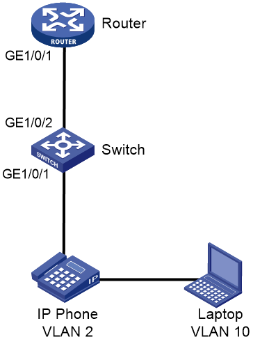

Configuring voice VLANs
Introduction
The following information uses an example to describe the basic procedure for configuring voice VLANs.
To ensure that voice traffic can be preferentially forwarded, you must separate the addresses of IP phones from those of laptops. Assign the subnet 192.168.2.0 to IP phones and assign the IP phones to VLAN 2. Assign the subnet 192.168.10.0 to laptops and assign the laptops to VLAN 10. Router acts as a DHCP server to allocate IP addresses to IP phones and laptops.
Procedures
Configuring Switch
# Enable PoE to supply power to phones.
<Switch> system-view
[Switch] interface gigabitethernet 1/0/1
[Switch-GigabitEthernet1/0/1] poe enable
[Switch-GigabitEthernet1/0/1] quit
# Create VLAN 2 for phones and VLAN 10 for laptops.
[Switch] vlan 2
[Switch-vlan2] quit
[Switch] vlan 10
[Switch-vlan10] quit
# Configure MAC addresses with prefix 6ca8-4900-0000 for voice packet identification.
[Switch] voice-vlan mac-address 6ca8-4900-0000 mask ffff-ff00-0000 description avaya
# Configure GigabitEthernet 1/0/1 as a hybrid port, and enable the voice VLAN feature on it.
[Switch-GigabitEthernet1/0/1] port link-type hybrid
[Switch-GigabitEthernet1/0/1] voice-vlan 2 enable
# Configure VLAN 10, to which laptops belong.
[Switch-GigabitEthernet1/0/1] port hybrid pvid vlan 10
[Switch-GigabitEthernet1/0/1] port hybrid vlan 10 untagged
[SWITCH-GigabitEthernet1/0/1] quit
# Assign interface GigabitEthernet 1/0/2 (which connects to the DHCP server) to VLANs 2 and 10.
[Switch] interface gigabitethernet 1/0/2
[Switch-GigabitEthernet1/0/2] port link-type trunk
[Switch-GigabitEthernet1/0/2] port trunk permit vlan 2 10
[Switch-GigabitEthernet1/0/2] quit

Configuring Router
# Create VLAN 2 and VLAN10, and their VLAN interfaces. Assign IP addresses to the VLAN interfaces.
<Router> system-view
[Router] vlan 2
[Router-vlan2] quit
[Router] vlan 10
[Router-vlan10] quit
[Router] interface Vlan-interface 2
[Router-Vlan-interface2] ip address 192.168.2.1 255.255.255.0
[Router-Vlan-interface2] quit
[Router] interface Vlan-interface 10
[Router-Vlan-interface10] ip address 192.168.10.1 255.255.255.0
[Router-Vlan-interface10] quit
# Assign interface GigabitEthernet 1/0/1 (which connects to Switch) to VLANs 2 and 10.
[Router] interface GigabitEthernet 1/0/1
[Router-GigabitEthernet1/0/1] port link-type trunk
[Router-GigabitEthernet1/0/1] port trunk permit vlan 2 10
[Router-GigabitEthernet1/0/1] quit
# Enable the DHCP service.
[Router] dhcp enable
# Configure the DHCP address pool for VLAN 2, which contains phones.
[Router] dhcp server ip-pool vlan2
[Router-dhcp-pool-vlan2] network 192.168.2.0 mask 255.255.255.0
[Router-dhcp-pool-vlan2] gateway-list 192.168.2.1
[Router-dhcp-pool-vlan2] quit
# Configure the DHCP address pool for VLAN 10, which contains laptops.
[Router] dhcp server ip-pool vlan10
[Router-dhcp-pool-vlan10] network 192.168.10.0 mask 255.255.255.0
[Router-dhcp-pool-vlan10] gateway-list 192.168.10.1
[Router-dhcp-pool-vlan10] dns-list 114.114.114.114
[Router-dhcp-pool-vlan10] quit
[Router] save force
# On Switch, verify that phones are assigned to VLAN 2.
<Switch> display mac-address
MAC Address VLAN ID STATE Port/Nickname AGING
3897-d630-676b 10 Learned GE1/0/2 Y
3897-d630-676b 2 Learned GE1/0/2 Y
6ca8-4986-6d59 2 Learned GE1/0/1 Y
0068-eb95-3683 10 Learned GE1/0/1 Y
# Verify that the voice VLAN configuration takes effect.
<Switch> display voice-vlan mac-address
Oui Address Mask Description
0003-6b00-0000 ffff-ff00-0000 Cisco phone
00e0-7500-0000 ffff-ff00-0000 Polycom phone
6ca8-4900-0000 ffff-ff00-0000 avaya
# Verify that the voice VLAN assignment mode is auto.
<Switch> display voice-vlan state
Current Voice VLANs: 1
Voice VLAN security mode: Security
Voice VLAN aging time: 1440 minutes
Voice VLAN enabled port and its mode:
PORT VLAN MODE COS DSCP
GE1/0/1 2 AUTO 6 46
# On the DHCP server, view the IP addresses assigned to phones and laptops.
%Sep 1 09:19:59:333 2021 DHCP DHCPS/5/DHCPS_ALLOCATE_IP: DHCP server information: Server IP = 192.168.2.1, DHCP client IP = 192.168.2.2, DHCP client hardware address = 6ca8-4986-6d59, DHCP client lease = 86400.
<Router> display dhcp server ip-in-use all
Pool utilization: 0.59%
IP address Client-identifier/ Lease expiration Type
Hardware address
192.168.2.2 6ca8-4986-6d59 Aug 31 2021 09:19:59 Auto:COMMITTED
192.168.10.4 0068-eb95-3683 Aug 31 2021 09:19:42 Auto:COMMITTED

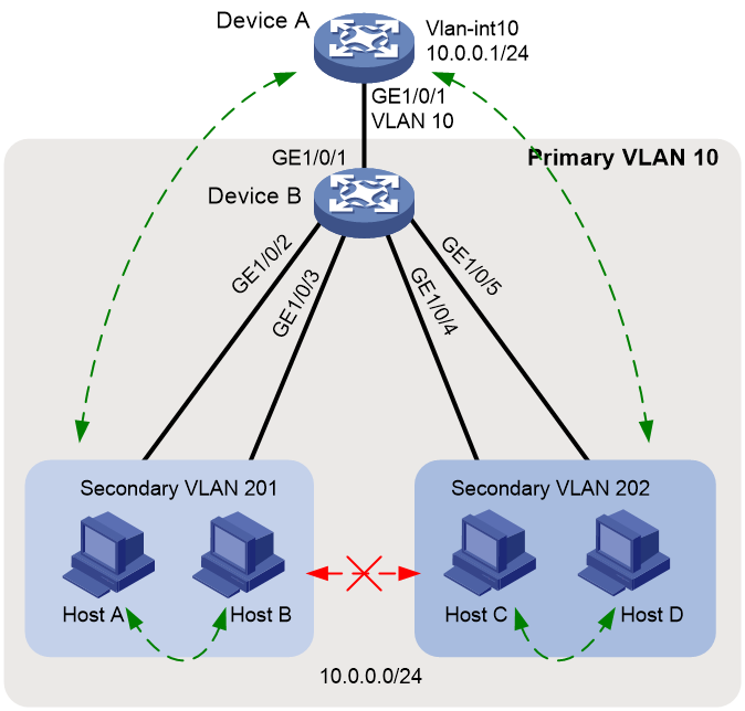

Configuring private VLAN
Introduction
The following information uses an example to describe the basic procedure for configuring private VLAN.
As shown in Figure 3:
·     Device A on the aggregation layer assigns VLAN 10 to Device B on the access layer. The gateway interface (VLAN-interface 10) can communicate with all users, so that users can access Internet through Device A. All users attached to Device B are on the subnet 10.0.0.0/24.
·     Hosts A and B belong to the sales department. Hosts C and D belong to the financial department. To ensure security, isolate different departments at Layer 2, and allow users in the same department to communicate with each other.
Because Device A cannot allocate more VLANs to Device B, configure the private VLAN feature to meet the following requirements:
·     Device A only needs to recognize VLAN 10.
·     In primary VLAN 10, Device B allocates different secondary VLANs to different departments, so these departments are isolated at Layer 2.
Figure 3 Network diagram
·     Configure the private VLAN feature only on the access device, Device B.
·     The system default VLAN (VLAN 1) does not support private VLAN settings.
# Configure VLAN 10 as the primary VLAN.
<DeviceB> system-view
[DeviceB] vlan 10
[DeviceB-vlan10] private-vlan primary
[DeviceB-vlan10] quit
# Create secondary VLANs 201 and 202.
[DeviceB] vlan 201 to 202
# Associate secondary VLANs 201 and 202 with the primary VLAN 10.
[DeviceB] vlan 10
[DeviceB-vlan10] private-vlan secondary 201 to 202
# Configure the uplink port GigabitEthernet 1/0/1 to operate in promiscuous mode in VLAN 10.
[DeviceB-GigabitEthernet1/0/1] port private-vlan 10 promiscuous
# Assign the downlink ports GigabitEthernet 1/0/2 and GigabitEthernet 1/0/3 to VLAN 201, and assign GigabitEthernet 1/0/4 and GigabitEthernet 1/0/5 to VLAN 202. Configure them to operate in host mode.
[DeviceB] interface range gigabitethernet 1/0/2 to gigabitethernet 1/0/3
[DeviceB-if-range] port access vlan 201
[DeviceB-if-range] port private-vlan host
[DeviceB-if-range] quit
[DeviceB] interface range gigabitethernet 1/0/4 to gigabitethernet 1/0/5
[DeviceB-if-range] port access vlan 202
# Create VLAN 10. Assign GigabitEthernet 1/0/1 to VLAN 10.
[DeviceA] vlan 100
[DeviceA-GigabitEthernet1/0/1] port access vlan 10
[DeviceA-GigabitEthernet1/0/1] quit
# Configure VLAN-interface 10, which is to act as the gateway.
[DeviceA-Vlan-interface10] ip address 10.0.0.1 24
# Verify that you can ping any user from Device A. View the ARP table to verify that all users belong to VLAN 10.
[DeviceA] display arp
  Type: S-Static   D-Dynamic   O-Openflow   R-Rule   M-Multiport  I-Invalid
IP address      MAC address    VLAN/VSI name Interface                Aging Type
10.0.0.2        0e9e-0671-0302 10            GE1/0/1                  1062  D
10.0.0.3        0e9e-09f7-0402 10            GE1/0/1                  1052  D
10.0.0.4        0e9e-0d94-0502 10            GE1/0/1                  1164  D
10.0.0.5        0e9e-1263-0602 10            GE1/0/1                  1109  D
# Display the private VLAN configuration on Device B.
<DeviceB> display private-vlan
 Primary VLAN ID: 10
 Secondary VLAN ID: 201-202
 VLAN ID: 10
 VLAN type: Static
 Private VLAN type: Primary
 Tagged ports:
    None
 Untagged ports:
    GigabitEthernet1/0/1(U)            GigabitEthernet1/0/2(U)
    GigabitEthernet1/0/3(U)            GigabitEthernet1/0/4(U)
    GigabitEthernet1/0/5(U)
 VLAN ID: 201
 VLAN type: Static
 Private VLAN type: Secondary
 Description: VLAN 0201
 Tagged ports:
    None
 Untagged ports:
 VLAN ID: 202
 VLAN type: Static
 Description: VLAN 0202
 Tagged ports:
    None
 Untagged ports:
    GigabitEthernet1/0/1(U)            GigabitEthernet1/0/4(U)
The output shows that GigabitEthernet 1/0/1 in promiscuous mode and GigabitEthernet 1/0/2 through GigabitEthernet 1/0/5 in host mode all allow packets to pass through untagged.
# Verify that Host A and Host B can ping each other, and Host C and Host D can ping each other. Verify that Host A or B cannot ping Host C or D.
