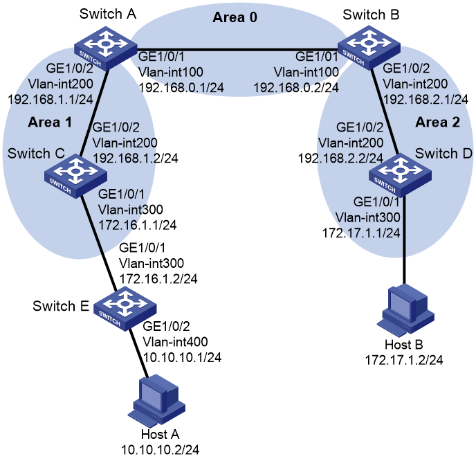

The following example describes the basic procedure to configure OSPF route redistribution.
As shown in Figure 1, Switch A, Switch B, Switch C, and Switch D run OSPF. Switch C and Switch E are configured with static routes. The AS is split into three areas. Configure the network to meet the following requirements:
·     Switch A and Switch B act as ABRs.
·     Switch C acts as an ASBR to redistribute external routes (static routes) and correctly advertise routes within the AS.
Figure 1 Network diagram
Data preparation
Device
Router ID
Interface and IP address
Subnet and OSPF area
Switch A
1.1.1.1
Physical interface: GE1/0/1
VLAN: 100
IP address: 192.168.0.1/24
Subnet: 192.168.0.0/24
OSPF area: area 0
Physical interface: GE1/0/2
VLAN: 200
IP address: 192.168.1.1/24
Subnet: 192.168.1.0/24
OSPF area: area 1
Switch B
2.2.2.2
VLAN: 100
IP address: 192.168.0.2/24
OSPF area: area 0
VLAN: 200
IP address: 192.168.2.1/24
Subnet: 192.168.2.0/24
OSPF area: area 2
Switch C
3.3.3.3
VLAN: 300
IP address: 172.16.1.1/24
Subnet: 172.16.1.0/24
OSPF area: area 1
VLAN: 200
IP address: 192.168.1.2/24
OSPF area: area 1
Switch D
4.4.4.4
VLAN: 300
IP address: 172.17.1.1/24
Subnet: 172.17.1.0/24
OSPF area: area 2
VLAN: 200
IP address: 192.168.2.2/24
OSPF area: area 2
Switch E
N/A
VLAN: 300
IP address: 172.16.1.2/24
VLAN: 400
IP address: 10.10.10.1/24
Subnet: 10.10.10.0/24
Host A
N/A
IP address: 10.10.10.2/24
Host B
N/A
IP address: 172.17.1.2/24

·     Switch C:
 router id 3.3.3.3
ospf 1
 area 0.0.0.1
  network 192.168.1.0 0.0.0.255
  network 172.16.1.0 0.0.0.255
interface Vlan-interface200
 ip address 192.168.1.2 255.255.255.0
interface Vlan-interface300
 ip address 172.16.1.1 255.255.255.0
 port access vlan 300
 port access vlan 200
·     Switch D:
 router id 4.4.4.4
ospf 1
 area 0.0.0.2
  network 192.168.2.0 0.0.0.255
  network 172.17.1.0 0.0.0.255
 ip address 192.168.2.2 255.255.255.0
 ip address 172.17.1.1 255.255.255.0
·     Switch E:
 ip address 10.10.10.1 255.255.255.0
 ip address 172.16.1.2 255.255.255.0
 ip route-static 0.0.0.0 0 172.16.1.1

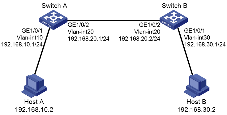

Configuring basic OSPF in a single area
Introduction
The following example describes the procedure to configure basic OSPF in a single area.
As shown in Figure 2, Switch A and Switch B run OSPF. Configure the network to ensure that Host A and Host B can access each other through Switch A and Switch B.
Figure 2 Network diagram
1.     Configure Switch A.
# Create VLAN 10 and assign GE1/0/1 to VLAN 10.
<Switch A> system-view
[Switch A] vlan 10
[Switch A-vlan10] port gigabitethernet 1/0/1
[Switch A-vlan10] quit
# Create VLAN 20 and assign GE1/0/2 to VLAN 20.
[Switch A] vlan 20
[Switch A-vlan20] port gigabitethernet 1/0/2
[Switch A-vlan20] quit
# Assign IP address 192.168.10.1/24 to VLAN-interface 10 and IP address 192.168.20.1/24 to VLAN-interface 20.
[Switch A] interface vlan 10
[Switch A-Vlan-interface10] ip address 192.168.10.1 255.255.255.0
[Switch A-Vlan-interface10] quit
[Switch A] interface vlan 20
[Switch A-Vlan-interface20] ip address 192.168.20.1 255.255.255.0
[Switch A-Vlan-interface20] quit
# Configure 1.1.1.1 as the global router ID for Switch A.
[Switch A] router id 1.1.1.1
# Enable OSPF process 1, create area 0, and then advertise subnet 192.168.10.0/24 and subnet 192.168.20.0/24.
[Switch A] ospf 1
[Switch A-ospf-1] area 0
[Switch A-ospf-1-area-0.0.0.0] network 192.168.10.0 0.0.0.255
[Switch A-ospf-1-area-0.0.0.0] network 192.168.20.0 0.0.0.255
[Switch A-ospf-1-area-0.0.0.0] quit
[Switch A-ospf-1] quit
# Save the configuration.
[Switch A] save force
2.     Configure Switch B.
# Create VLAN 30 and assign GE1/0/1 to VLAN 30.
<Switch B> system-view
[Switch B] vlan 30
[Switch B-vlan30] port gigabitethernet 1/0/1
[Switch B-vlan30] quit
[Switch B] vlan 20
[Switch B-vlan20] port gigabitethernet 1/0/2
[Switch B-vlan20] quit
# Assign IP address 192.168.30.1/24 to VLAN-interface 30 and IP address 192.168.20.2/24 to VLAN-interface 20.
[Switch B] interface vlan 30
[Switch B-Vlan-interface30] ip address 192.168.30.1 255.255.255.0
[Switch B-Vlan-interface30] quit
[Switch B] interface vlan 20
[Switch B-Vlan-interface20] ip address 192.168.20.2 255.255.255.0
[Switch B-Vlan-interface20] quit
# Configure 2.2.2.2 as the global router ID for Switch B.
[Switch B] router id 2.2.2.2
# Enable OSPF process 1, create area 0, and then advertise subnet 192.168.20.0/24 and subnet 192.168.30.0/24.
[Switch B] ospf 1
[Switch B-ospf-1] area 0
[Switch B-ospf-1-area-0.0.0.0] network 192.168.20.0 0.0.0.255
[Switch B-ospf-1-area-0.0.0.0] network 192.168.30.0 0.0.0.255
[Switch B-ospf-1-area-0.0.0.0] quit
[Switch B-ospf-1] quit
[Switch B] save force
# Use the display ospf peer command to view the OSPF neighbors of Switch A.
[Switch A] display ospf peer
         OSPF Process 1 with Router ID 1.1.1.1
               Neighbor Brief Information
 Area: 0.0.0.0
 Router ID       Address         Pri Dead-Time  State             Interface
 2.2.2.2         192.168.20.2    1   30         Full/DR -         Vlan20
# Use the display ospf routing command to view the OSPF routes of Switch A.
[Switch A] display ospf routing
                  Routing Table
                Topology base (MTID 0)
 Routing for network
 Destination        Cost     Type    NextHop         AdvRouter       Area
 192.168.10.0/24    1        Stub    0.0.0.0         192.168.20.1    0.0.0.0
 192.168.30.0/24    2        Stub    192.168.20.2    192.168.20.2    0.0.0.0
 192.168.20.0/24    1        Transit 0.0.0.0         192.168.20.1    0.0.0.0
# Use the display ip routing-table command to view the routing table of Switch A.
[Switch A] display ip routing-table
Destinations : 17       Routes : 17
Destination/Mask   Proto   Pre Cost        NextHop         Interface
0.0.0.0/32         Direct  0   0           127.0.0.1       InLoop0
127.0.0.0/8        Direct  0   0           127.0.0.1       InLoop0
127.0.0.0/32       Direct  0   0           127.0.0.1       InLoop0
127.0.0.1/32       Direct  0   0           127.0.0.1       InLoop0
127.255.255.255/32 Direct  0   0           127.0.0.1       InLoop0
192.168.10.0/24    Direct  0   0           192.168.10.1    Vlan10
192.168.10.0/32    Direct  0   0           192.168.10.1    Vlan10
192.168.10.1/32    Direct  0   0           127.0.0.1       InLoop0
192.168.10.255/32  Direct  0   0           192.168.10.1    Vlan10
192.168.20.0/24    Direct  0   0           192.168.20.1    Vlan20
192.168.20.0/32    Direct  0   0           192.168.20.1    Vlan20
192.168.20.1/32    Direct  0   0           127.0.0.1       InLoop0
192.168.20.255/32  Direct  0   0           192.168.20.1    Vlan20
192.168.30.0/24    O_INTRA 10  2           192.168.20.2    Vlan20
224.0.0.0/4        Direct  0   0           0.0.0.0         NULL0
224.0.0.0/24       Direct  0   0           0.0.0.0         NULL0
255.255.255.255/32 Direct  0   0           127.0.0.1       InLoop0
The output shows that Switch A has a route to 192.168.30.0/24.
# Check whether Host A can ping Host B successfully.
C:\Users\HostA>ping 192.168.30.2
The output shows that Host A can ping Host B successfully.

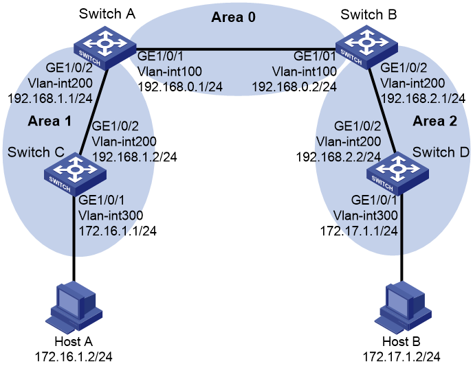

Configuring basic OSPF across multiple areas
Introduction
The following example describes the procedure to configure basic OSPF across multiple areas.
As shown in Figure 3, Switch A, Switch B, Switch C, and Switch D run OSPF. The AS is split into three areas. Switch A and Switch B act as ABRs. Configure the network to ensure that each switch can learn all of the routes in the AS.
Figure 3 Network diagram
Data preparation
Device
Router ID
Switch A
1.1.1.1
VLAN: 100
OSPF area: area 0
VLAN: 200
OSPF area: area 1
Switch B
2.2.2.2
VLAN: 100
OSPF area: area 0
VLAN: 200
OSPF area: area 2
Switch C
3.3.3.3
VLAN: 300
OSPF area: area 1
VLAN: 200
OSPF area: area 1
Switch D
4.4.4.4
VLAN: 300
OSPF area: area 2
VLAN: 200
OSPF area: area 2
Host A
N/A
Host B
N/A
# Create VLAN 100 and assign GE1/0/1 to VLAN 100.
[Switch A] vlan 100
[Switch A-vlan100] port gigabitethernet 1/0/1
[Switch A-vlan100] quit
# Create VLAN 200 and assign GE1/0/2 to VLAN 200.
[Switch A] vlan 200
[Switch A-vlan200] port gigabitethernet 1/0/2
[Switch A-vlan200] quit
# Assign IP address 192.168.0.1/24 to VLAN-interface 100 and IP address 192.168.1.1/24 to VLAN-interface 200.
[Switch A] interface vlan 100
[Switch A-Vlan-interface100] ip address 192.168.0.1 255.255.255.0
[Switch A-Vlan-interface100] quit
[Switch A] interface vlan 200
[Switch A-Vlan-interface200] ip address 192.168.1.1 255.255.255.0
[Switch A-Vlan-interface200] quit
# Enable OSPF process 1, create area 0, and then advertise subnet 192.168.0.0/24.
[Switch A] ospf 1
[Switch A-ospf-1-area-0.0.0.0] network 192.168.0.0 0.0.0.255
# Create area 1, and then advertise subnet 192.168.1.0/24.
[Switch A-ospf-1] area 1
[Switch A-ospf-1-area-0.0.0.1] network 192.168.1.0 0.0.0.255
[Switch A-ospf-1-area-0.0.0.1] quit
[Switch B] vlan 100
[Switch B-vlan100] port gigabitethernet 1/0/1
[Switch B-vlan100] quit
[Switch B] vlan 200
[Switch B-vlan200] port gigabitethernet 1/0/2
[Switch B-vlan200] quit
# Assign IP address 192.168.0.2/24 to VLAN-interface 100 and IP address 192.168.2.1/24 to VLAN-interface 200.
[Switch B] interface vlan 100
[Switch B-Vlan-interface100] ip address 192.168.0.2 255.255.255.0
[Switch B-Vlan-interface100] quit
[Switch B] interface vlan 200
[Switch B-Vlan-interface200] ip address 192.168.2.1 255.255.255.0
[Switch B-Vlan-interface200] quit
[Switch B] ospf 1
[Switch B-ospf-1-area-0.0.0.0] network 192.168.0.0 0.0.0.255
# Create area 2, and then advertise subnet 192.168.2.0/24.
[Switch B-ospf-1] area 2
[Switch B-ospf-1-area-0.0.0.2] network 192.168.2.0 0.0.0.255
[Switch B-ospf-1-area-0.0.0.2] quit
3.     Configure Switch C.
# Create VLAN 300 and assign GE1/0/1 to VLAN 300.
<Switch C> system-view
[Switch C] vlan 300
[Switch C-vlan300] port gigabitethernet 1/0/1
[Switch C-vlan300] quit
[Switch C] vlan 200
[Switch C-vlan200] port gigabitethernet 1/0/2
[Switch C-vlan200] quit
# Assign IP address 172.16.1.1/24 to VLAN-interface 300 and IP address 192.168.1.2/24 to VLAN-interface 200.
[Switch C] interface vlan 300
[Switch C-Vlan-interface300] ip address 172.16.1.1 255.255.255.0
[Switch C-Vlan-interface300] quit
[Switch C] interface vlan 200
[Switch C-Vlan-interface200] ip address 192.168.1.2 255.255.255.0
[Switch C-Vlan-interface200] quit
# Configure 3.3.3.3 as the global router ID for Switch C.
[Switch C] router id 3.3.3.3
# Enable OSPF process 1, create area 1, and then advertise subnet 192.168.1.0/24 and subnet 172.16.1.0/24.
[Switch C] ospf 1
[Switch C-ospf-1] area 1
[Switch C-ospf-1-area-0.0.0.1] network 192.168.1.0 0.0.0.255
[Switch C-ospf-1-area-0.0.0.1] network 172.16.1.0 0.0.0.255
[Switch C-ospf-1-area-0.0.0.1] quit
[Switch C-ospf-1] quit
[Switch C] save force
4.     Configure Switch D.
<Switch D> system-view
[Switch D] vlan 300
[Switch D-vlan300] port gigabitethernet 1/0/1
[Switch D-vlan300] quit
[Switch D] vlan 200
[Switch D-vlan200] port gigabitethernet 1/0/2
[Switch D-vlan200] quit
# Assign IP address 172.17.1.1/24 to VLAN-interface 300 and IP address 192.168.2.2/24 to VLAN-interface 200.
[Switch D] interface vlan 300
[Switch D-Vlan-interface300] ip address 172.17.1.1 255.255.255.0
[Switch D-Vlan-interface300] quit
[Switch D] interface vlan 200
[Switch D-Vlan-interface200] ip address 192.168.2.2 255.255.255.0
[Switch D-Vlan-interface200] quit
# Configure 4.4.4.4 as the global router ID for Switch D.

# Enable OSPF process 1, create area 2, and then advertise subnet 192.168.2.0/24 and subnet 172.17.1.0/24.
[Switch D] ospf 1
[Switch D-ospf-1] area 2
[Switch D-ospf-1-area-0.0.0.2] network 192.168.2.0 0.0.0.255
[Switch D-ospf-1-area-0.0.0.2] network 172.17.1.0 0.0.0.255
[Switch D-ospf-1-area-0.0.0.2] quit
[Switch D-ospf-1] quit
[Switch D] save force
 Area: 0.0.0.0
 2.2.2.2         192.168.0.2     1   33         Full/DR           Vlan100
 Area: 0.0.0.1
 3.3.3.3         192.168.1.2     1   34         Full/DR           Vlan200
Destinations : 19       Routes : 19
172.16.1.0/24      O_INTRA 10  2           192.168.1.2     Vlan200
172.17.1.0/24      O_INTER 10  3           192.168.0.2     Vlan100
192.168.0.0/24     Direct  0   0           192.168.0.1     Vlan100
192.168.0.0/32     Direct  0   0           192.168.0.1     Vlan100
192.168.0.1/32     Direct  0   0           127.0.0.1       InLoop0
192.168.0.255/32   Direct  0   0           192.168.0.1     Vlan100
192.168.1.0/24     Direct  0   0           192.168.1.1     Vlan200
192.168.1.0/32     Direct  0   0           192.168.1.1     Vlan200
192.168.1.1/32     Direct  0   0           127.0.0.1       InLoop0
192.168.1.255/32   Direct  0   0           192.168.1.1     Vlan200
192.168.2.0/24     O_INTER 10  2           192.168.0.2     Vlan100
The output shows that Switch A has routes to 172.16.1.0, 172.17.1.0, and 192.168.2.0.
C:\Users\HostA>ping 172.17.1.2
