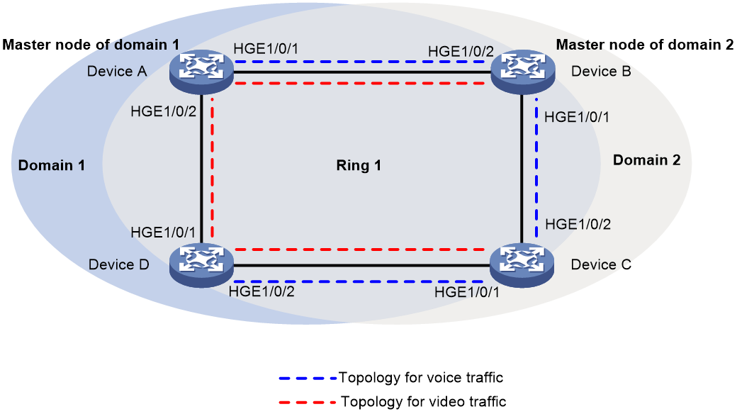

Example: Configuring a single ring
As shown in Figure 1, area A and area B are connected to a ring-shaped distribution layer network. Configure RRPP to implement the following requirements in the network:
·     Eliminate loops and implement link recovery in the Layer 2 network.
·     Implement link load balancing by forwarding voice traffic in VLAN 100 through VLAN 150 and video traffic in VLAN 151 through VLAN 200.
·     Improve RRPP topology convergence speed by setting the physical state change suppression interval to 0 seconds for all Ethernet interfaces on the RRPP ring.
Figure 1 Network diagram
Analysis

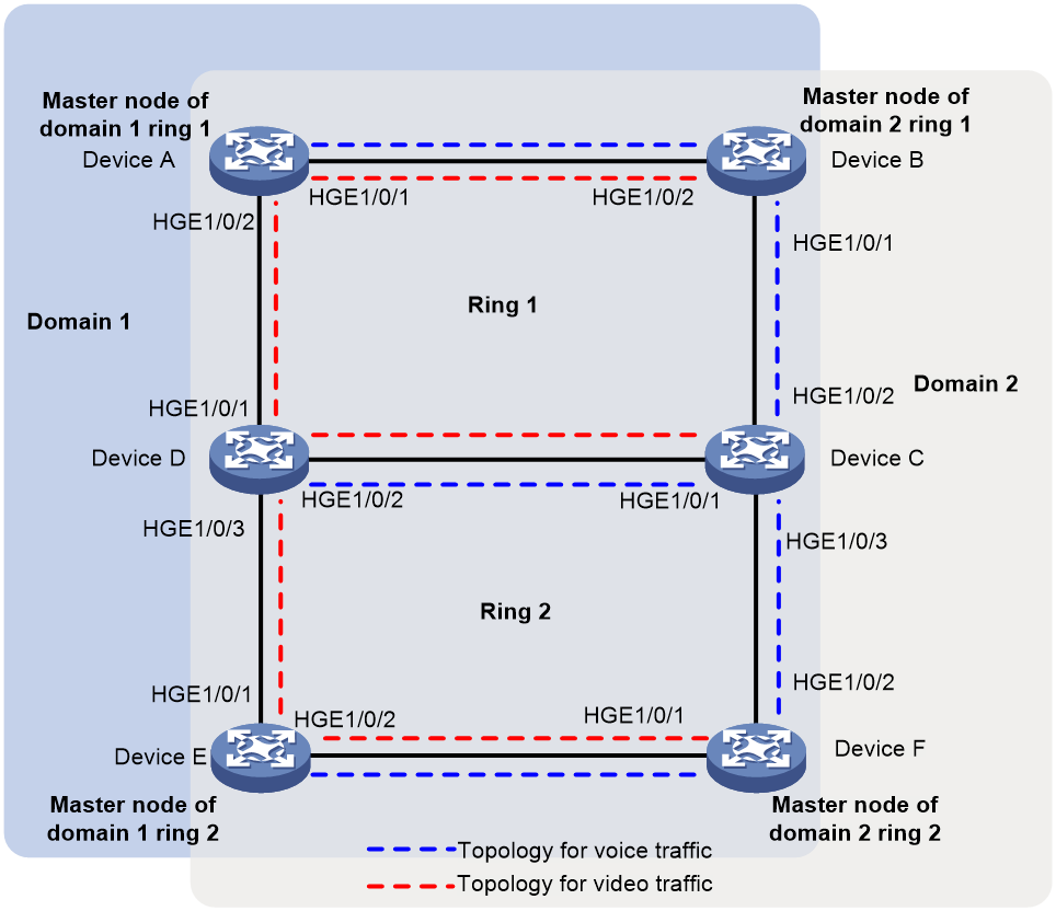

For voice and video traffic to be forwarded in different topologies, create two RRPP domains.
·     In RRPP domain 1, specify VLAN 100 through VLAN 150 as protected VLANs, and specify Device A as the master node.
·     In RRPP domain 2, specify VLAN 151 through VLAN 200 as protected VLANs, and specify Device B as the master node.
To implement load balancing for voice and video traffic, perform the following tasks:
·     On Device A, specify HundredGigE 1/0/1 as the primary port, and HundredGigE 1/0/2 as the secondary port.
·     On Device B, specify HundredGigE 1/0/2 as the primary port, and HundredGigE 1/0/1 as the secondary port.
Figure 2 Topologies for voice and video traffic

When you configure a single RRPP ring, follow these restrictions and guidelines:
·     After you configure RRPP rings for an RRPP domain, you cannot delete or modify the primary control VLAN of the domain. You can only use the undo control-vlan command to delete a primary control VLAN.
·     When you configure load balancing, you must configure different protected VLANs for different RRPP domains.
·     When you configure RRPP port roles, disable the spanning tree feature on the ports, and make sure the ports are not member ports of any smart link groups.

# View detailed information about RRPP domain 1 on Device A.
[DeviceA] display rrpp verbose domain 1
 Domain ID     : 1
Control VLAN  : Primary 1000, Secondary 1001
Protected VLAN: Reference instance 1
Hello timer   : 1 seconds, Fail timer: 3 seconds
Fast detection status: Disabled
Fast-Hello timer: 20 ms, Fast-Fail timer: 60 ms
Fast-Edge-Hello timer: 10 ms, Fast-Edge-Fail timer: 30 ms
Ring ID       : 1
Ring Level    : 0
Node Mode     : Master
Ring State    : Completed
Enable Status : Yes    Active Status: Yes
Primary port  : HGE1/0/1                    Port status: UP
Secondary port: HGE1/0/2                    Port status: BLOCKED
The output shows the following information:
·     Device A is the master node in RRPP domain 1.
·     The primary ring state of RRPP domain 1 is completed.
·     The primary port is up, and the secondary port is blocked.
# View detailed information about RRPP domain 2 on Device A.
[DeviceA] display rrpp verbose domain 2
Domain ID     : 2
Control VLAN  : Primary 2000, Secondary 2001
Protected VLAN: Reference instance 2
Ring ID       : 1
Ring Level    : 0
Node Mode     : Transit
Ring State    : -
Secondary port: HGE1/0/2                    Port status: UP
·     Device A is the transit node in RRPP domain 2.
·     The primary and secondary ports are up.
# View detailed information about RRPP domain 1 on Device B.
[DeviceB] display rrpp verbose domain 1
 Domain ID     : 1
Ring ID       : 1
Ring Level    : 0
Node Mode     : Transit
Ring State    : -
Primary port  : HGE1/0/2                    Port status: UP
Secondary port: HGE1/0/1                    Port status: UP
·     Device B is the transit node in RRPP domain 1.
# View detailed information about RRPP domain 2 on Device B.
[DeviceB] display rrpp verbose domain 2
 Domain ID     : 2
Ring ID       : 1
Ring Level    : 0
Node Mode     : Master
Secondary port: HGE1/0/1                    Port status: BLOCKED
·     Device B is the master node in RRPP domain 2.
·     The primary ring state of RRPP domain 2 is completed.
# View detailed information about RRPP domain 1 on Device C.
[DeviceC] display rrpp verbose domain 1
 Domain ID     : 1
Ring ID       : 1
Ring Level    : 0
Node Mode     : Transit
Ring State    : -
·     Device C is the transit node in RRPP domain 1.
# View detailed information about RRPP domain 2 on Device C.
[DeviceC] display rrpp verbose domain 2
 Domain ID     : 2
Ring ID       : 1
Ring Level    : 0
Node Mode     : Transit
Ring State    : -
·     Device C is the transit node in RRPP domain 2.
# View detailed RRPP domain information on Device D. (Details not shown.)

Example: Configuring intersecting rings
As shown in Figure 3, a ring-shaped access layer network is connected to a ring-shaped distribution layer network. Configure RRPP to implement the following requirements in the network:
Figure 3 Network diagram
Analysis
·     In RRPP domain 1, specify VLAN 100 through VLAN 150 as protected VLANs. Specify Device A as the master node of primary ring 1, and Device E as the master node of subring 2.
·     In RRPP domain 2, specify VLAN 151 through VLAN 200 as protected VLANs. Specify Device B as the master node of primary ring 1, and Device F as the master node of subring 2.
·     On Device E, specify HundredGigE 1/0/2 as the primary port, and HundredGigE 1/0/1 as the secondary port.
·     On Device F, specify HundredGigE 1/0/1 as the primary port, and HundredGigE 1/0/2 as the secondary port.
Figure 4 Topologies for voice and video traffic
Hardware
Software version
S6805 switch series
Release 6607, Release 6616, Release 6616P01, Release 6635 and later
S6825 switch series
S6850 switch series
S9850 switch series
Release 6555P01, Release 6607, Release 6616, Release 6616P01, Release 6635 and later
S9820-64H switch
S9820-8C switch
When you configure intersecting rings, follow these restrictions and guidelines:
·     When you configure an edge node or assistant edge node, you must configure the primary ring before configuring the subrings.
·     Before you enable subrings on a device, you must enable the primary ring. Before you disable the primary ring on the device, you must disable all subrings.
·     If a device carries multiple RRPP rings in an RRPP domain, it can only be an edge node or an assistant edge node on a subring.
·     To prevent Hello packets of subrings from being looped on the primary ring, first enable the primary ring on its master node. Then enable the subrings on their respective master nodes.
Procedures

[DeviceD-rrpp-domain1] ring 2 node-mode assistant-edge edge-port hundredgige 1/0/3
[DeviceD-rrpp-domain1] ring 2 enable
[DeviceD-rrpp-domain1] quit
# Create RRPP domain 2.
[DeviceD] rrpp domain 2
# Configure VLAN 2000 as the primary control VLAN of RRPP domain 2.
[DeviceD-rrpp-domain2] control-vlan 2000
# Configure the VLANs mapped to MSTI 2 as the protected VLANs of RRPP domain 2.
[DeviceD-rrpp-domain2] protected-vlan reference-instance 2
# Configure Device D as the transit node of primary ring 1, with HundredGigE 1/0/1 as the primary port and HundredGigE 1/0/2 as the secondary port. Enable ring 1.
[DeviceD-rrpp-domain2] ring 1 node-mode transit primary-port hundredgige 1/0/1 secondary-port hundredgige 1/0/2 level 0
[DeviceD-rrpp-domain2] ring 1 enable
# Configure Device D as the assistant edge node of subring 2, with HundredGigE 1/0/3 as the edge port. Enable ring 2.
[DeviceD-rrpp-domain2] ring 2 node-mode assistant-edge edge-port hundredgige 1/0/3
[DeviceD-rrpp-domain2] ring 2 enable
[DeviceD-rrpp-domain2] quit
# Enable RRPP.
[DeviceD] rrpp enable
Configuring Device E
# Create VLANs 100 through 200.
<DeviceE> system-view
[DeviceE] vlan 100 to 200
# Map VLANs 100 through 150 to MSTI 1, and VLANs 151 through 200 to MSTI 2.
[DeviceE] stp region-configuration
[DeviceE-mst-region] instance 1 vlan 100 to 150
[DeviceE-mst-region] instance 2 vlan 151 to 200
# Activate the MST region configuration.
[DeviceE-mst-region] active region-configuration
[DeviceE-mst-region] quit
# Configure HundredGigE 1/0/1 as a trunk port.
[DeviceE] interface hundredgige 1/0/1
[DeviceE-HundredGigE1/0/1] undo shutdown
[DeviceE-HundredGigE1/0/1] port link-type trunk
# Assign the port to VLANs 100 through 200, and remove it from VLAN 1.
[DeviceE-HundredGigE1/0/1] port trunk permit vlan 100 to 200
[DeviceE-HundredGigE1/0/1] undo port trunk permit vlan 1
# Set the physical state change suppression interval to 0 seconds on the port.
[DeviceE-HundredGigE1/0/1] link-delay up 0
[DeviceE-HundredGigE1/0/1] link-delay down 0
# Disable the spanning tree feature on the port.
[DeviceE-HundredGigE1/0/1] undo stp enable
[DeviceE-HundredGigE1/0/1] quit
# Configure HundredGigE 1/0/2 in the same way HundredGigE 1/0/1 is configured.
[DeviceE] interface hundredgige 1/0/2
[DeviceE-HundredGigE1/0/2] undo shutdown
[DeviceE-HundredGigE1/0/2] port link-type trunk
[DeviceE-HundredGigE1/0/2] port trunk permit vlan 100 to 200
[DeviceE-HundredGigE1/0/2] undo port trunk permit vlan 1
[DeviceE-HundredGigE1/0/2] link-delay up 0
[DeviceE-HundredGigE1/0/2] link-delay down 0
[DeviceE-HundredGigE1/0/2] undo stp enable
[DeviceE-HundredGigE1/0/2] quit
# Create RRPP domain 1.
[DeviceE] rrpp domain 1
# Configure VLAN 1000 as the primary control VLAN of RRPP domain 1.
[DeviceE-rrpp-domain1] control-vlan 1000
# Configure the VLANs mapped to MSTI 1 as the protected VLANs of RRPP domain 1.
[DeviceE-rrpp-domain1] protected-vlan reference-instance 1
# Configure Device E as the master node of subring 2, with HundredGigE 1/0/2 as the primary port and HundredGigE 1/0/1 as the secondary port. Enable ring 2.
[DeviceE-rrpp-domain1] ring 2 node-mode master primary-port hundredgige 1/0/2 secondary-port hundredgige 1/0/1 level 1
[DeviceE-rrpp-domain1] ring 2 enable
[DeviceE-rrpp-domain1] quit
[DeviceE] rrpp domain 2
[DeviceE-rrpp-domain2] control-vlan 2000
[DeviceE-rrpp-domain2] protected-vlan reference-instance 2
# Configure Device E as the transit node of subring 2, with HundredGigE 1/0/2 as the primary port and HundredGigE 1/0/1 as the secondary port. Enable ring 2.
[DeviceE-rrpp-domain2] ring 2 node-mode transit primary-port hundredgige 1/0/2 secondary-port hundredgige 1/0/1 level 1
[DeviceE-rrpp-domain2] ring 2 enable
[DeviceE-rrpp-domain2] quit
# Enable RRPP.
[DeviceE] rrpp enable
Configuring Device F
<DeviceF> system-view
[DeviceF] vlan 100 to 200
[DeviceF] stp region-configuration
[DeviceF-mst-region] instance 1 vlan 100 to 150
[DeviceF-mst-region] instance 2 vlan 151 to 200
[DeviceF-mst-region] active region-configuration
[DeviceF-mst-region] quit
[DeviceF] interface hundredgige 1/0/1
[DeviceF-HundredGigE1/0/1] undo shutdown
[DeviceF-HundredGigE1/0/1] port link-type trunk
[DeviceF-HundredGigE1/0/1] port trunk permit vlan 100 to 200
[DeviceF-HundredGigE1/0/1] undo port trunk permit vlan 1
[DeviceF-HundredGigE1/0/1] link-delay up 0
[DeviceF-HundredGigE1/0/1] link-delay down 0
[DeviceF-HundredGigE1/0/1] undo stp enable
[DeviceF-HundredGigE1/0/1] quit
[DeviceF] interface hundredgige 1/0/2
[DeviceF-HundredGigE1/0/2] undo shutdown
[DeviceF-HundredGigE1/0/2] port link-type trunk
[DeviceF-HundredGigE1/0/2] port trunk permit vlan 100 to 200
[DeviceF-HundredGigE1/0/2] undo port trunk permit vlan 1
[DeviceF-HundredGigE1/0/2] link-delay up 0
[DeviceF-HundredGigE1/0/2] link-delay down 0
[DeviceF-HundredGigE1/0/2] undo stp enable
[DeviceF-HundredGigE1/0/2] quit
[DeviceF] rrpp domain 1
[DeviceF-rrpp-domain1] control-vlan 1000
[DeviceF-rrpp-domain1] protected-vlan reference-instance 1
# Configure Device F as the transit node of subring 2, with HundredGigE 1/0/1 as the primary port and HundredGigE 1/0/2 as the secondary port. Enable ring 2.
[DeviceF-rrpp-domain1] ring 2 node-mode transit primary-port hundredgige 1/0/1 secondary-port hundredgige 1/0/2 level 1
[DeviceF-rrpp-domain1] ring 2 enable
[DeviceF-rrpp-domain1] quit
[DeviceF] rrpp domain 2
[DeviceF-rrpp-domain2] control-vlan 2000
[DeviceF-rrpp-domain2] protected-vlan reference-instance 2
# Configure Device F as the master node of subring 2, with HundredGigE 1/0/1 as the primary port and HundredGigE 1/0/2 as the secondary port. Enable ring 2.
[DeviceF-rrpp-domain2] ring 2 node-mode master primary-port hundredgige 1/0/1 secondary-port hundredgige 1/0/2 level 1
[DeviceF-rrpp-domain2] ring 2 enable
[DeviceF-rrpp-domain2] quit
# Enable RRPP.
[DeviceF] rrpp enable
 Domain ID     : 1
Ring ID       : 1
Ring Level    : 0
Node Mode     : Master
·     Device A is the master node of primary ring 1 in RRPP domain 1.
 Domain ID     : 2
Ring ID       : 1
Ring Level    : 0
Node Mode     : Transit
Ring State    : -
·     Device A is the transit node of primary ring 1 in RRPP domain 2.
 Domain ID     : 1
Ring ID       : 1
Ring Level    : 0
Node Mode     : Transit
Ring State    : -
·     Device B is the transit node of primary ring 1 in RRPP domain 1.
 Domain ID     : 2
Ring ID       : 1
Ring Level    : 0
Node Mode     : Master
·     Device B is the master node of primary ring 1 in RRPP domain 2.
 Domain ID     : 1
Ring ID       : 1
Ring Level    : 0
Node Mode     : Transit
Ring State    : -
Ring ID       : 2
Ring Level    : 1
Node Mode     : Edge
Ring State    : -
Common port   : HGE1/0/1                    Port status: UP
Edge port     : HGE1/0/3                    Port status: UP
·     Device C is the transit node of primary ring 1 and edge node of subring 2 in RRPP domain 1.
 Domain ID     : 2
Ring ID       : 1
Ring Level    : 0
Node Mode     : Transit
Ring State    : -
Ring ID       : 2
Ring Level    : 1
Node Mode     : Edge
Ring State    : -
·     Device C is the transit node of primary ring 1 and edge node of subring 2 in RRPP domain 2.
# View detailed information about RRPP domain 1 on Device D.
[DeviceD] display rrpp verbose domain 1
 Domain ID     : 1
Ring ID       : 1
Ring Level    : 0
Node Mode     : Transit
Ring State    : -
Ring ID       : 2
Ring Level    : 1
Node Mode     : Assistant-edge
Ring State    : -

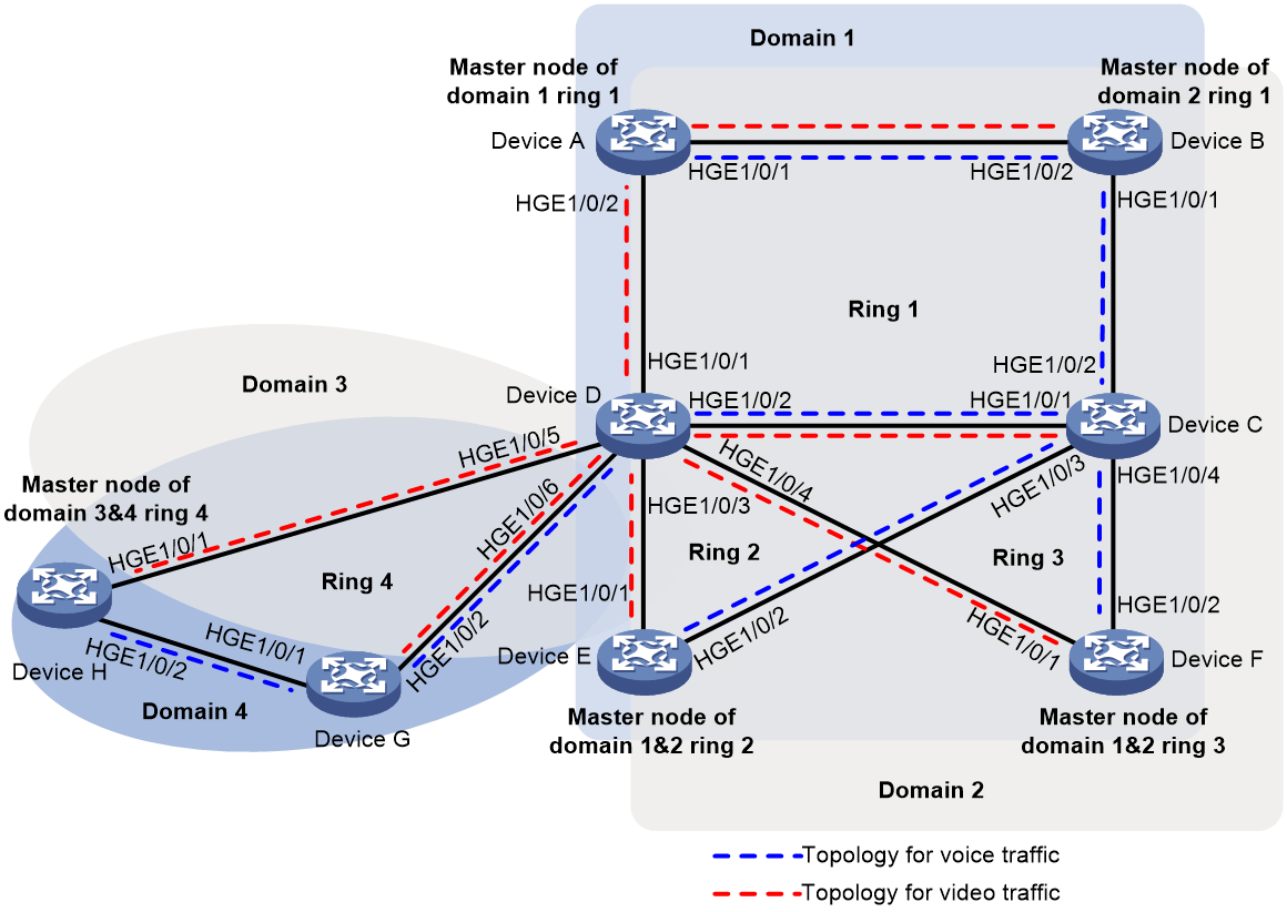

Example: Configuring dual-homed intersecting rings
As shown in Figure 5, a ring-shaped campus network is connected to a ring-shaped distribution layer network through an access layer device. Configure RRPP to implement the following requirements in the network:
·     Reduce the number of Edge-Hello packets.
Figure 5 Network diagram
Analysis
For voice and video traffic to be forwarded in different topologies, create four RRPP domains.
·     In RRPP domain 1 and domain 4, specify VLAN 100 through VLAN 150 as protected VLANs, and configure the node roles as follows:
¡     Specify Device A as the master node of primary ring 1.
¡     Specify Device E as the master node of subring 2.
¡     Specify Device F as the master node of subring 3.
¡     Specify Device H as the master node of subring 4.
·     In RRPP domain 2 and domain 3, specify VLAN 151 through VLAN 200 as protected VLANs, and configure the node roles as follows:
¡     Specify Device B as the master node of primary ring 1.
·     On Device E, specify HundredGigE 1/0/1 as the secondary port in RRPP domain 1 and primary port in RRPP domain 2. Specify HundredGigE 1/0/2 as the primary port in RRPP domain 1 and secondary port in RRPP domain 2.
·     On Device F, specify HundredGigE 1/0/1 as the secondary port in RRPP domain 1 and primary port in RRPP domain 2. Specify HundredGigE 1/0/2 as the primary port in RRPP domain 1 and secondary port in RRPP domain 2.
·     On Device H, specify HundredGigE 1/0/1 as the primary port in RRPP domain 3 and secondary port in RRPP domain 4. Specify HundredGigE 1/0/2 as the secondary port in RRPP domain 3 and primary port in RRPP domain 4.
To reduce the number of Edge-Hello packets, add ring 2 and ring 3 in RRPP domain 1 and 2 to a ring group.
Figure 6 Topologies for voice and video traffic

When you configure dual-homed intersecting rings, follow these restrictions and guidelines:
·     To avoid temporary loops when the primary ring fails, make sure the difference between the Fail timer values on the master node of the subring and primary ring is greater than twice the Hello timer value on the master node of the subring.
·     Make sure all subrings in an RRPP ring group have the same SRPTs. You can assign a subring to only one RRPP ring group. For the RRPP ring group to operate correctly, the RRPP ring groups configured on the edge node and the assistant edge node must contain the same subrings.
·     Make sure the RRPP ring groups on the edge node and the assistant edge node have the same configurations and activation status.

Configuring Device A
<DeviceA> system-view
[DeviceA] vlan 100 to 200
[DeviceA] stp region-configuration
[DeviceA-mst-region] instance 1 vlan 100 to 150
[DeviceA-mst-region] instance 2 vlan 151 to 200
[DeviceA-mst-region] active region-configuration
[DeviceA-mst-region] quit
[DeviceA] interface hundredgige 1/0/1
[DeviceA-HundredGigE1/0/1] undo shutdown
[DeviceA-HundredGigE1/0/1] port link-type trunk
[DeviceA-HundredGigE1/0/1] port trunk permit vlan 100 to 200
[DeviceA-HundredGigE1/0/1] undo port trunk permit vlan 1
[DeviceA-HundredGigE1/0/1] link-delay up 0
[DeviceA-HundredGigE1/0/1] link-delay down 0
[DeviceA-HundredGigE1/0/1] undo stp enable
[DeviceA-HundredGigE1/0/1] quit
[DeviceA] interface hundredgige 1/0/2
[DeviceA-HundredGigE1/0/2] undo shutdown
[DeviceA-HundredGigE1/0/2] port link-type trunk
[DeviceA-HundredGigE1/0/2] port trunk permit vlan 100 to 200
[DeviceA-HundredGigE1/0/2] undo port trunk permit vlan 1
[DeviceA-HundredGigE1/0/2] link-delay up 0
[DeviceA-HundredGigE1/0/2] link-delay down 0
[DeviceA-HundredGigE1/0/2] undo stp enable
[DeviceA-HundredGigE1/0/2] quit
[DeviceA] rrpp domain 1
[DeviceA-rrpp-domain1] control-vlan 1000
[DeviceA-rrpp-domain1] protected-vlan reference-instance 1
# Configure Device A as the master node of primary ring 1, with HundredGigE 1/0/1 as the primary port and HundredGigE 1/0/2 as the secondary port. Enable ring 1.
[DeviceA-rrpp-domain1] ring 1 node-mode master primary-port hundredgige 1/0/1 secondary-port hundredgige 1/0/2 level 0
[DeviceA-rrpp-domain1] ring 1 enable
[DeviceA-rrpp-domain1] quit
[DeviceA] rrpp domain 2
[DeviceA-rrpp-domain2] control-vlan 2000
[DeviceA-rrpp-domain2] protected-vlan reference-instance 2
# Configure Device A as the transit node of primary ring 1, with HundredGigE 1/0/1 as the primary port and HundredGigE 1/0/2 as the secondary port. Enable ring 1.
[DeviceA-rrpp-domain2] ring 1 node-mode transit primary-port hundredgige 1/0/1 secondary-port hundredgige 1/0/2 level 0
[DeviceA-rrpp-domain2] ring 1 enable
[DeviceA-rrpp-domain2] quit
# Enable RRPP.
[DeviceA] rrpp enable
Configuring Device B
<DeviceB> system-view
[DeviceB] vlan 100 to 200
[DeviceB] stp region-configuration
[DeviceB-mst-region] instance 1 vlan 100 to 150
[DeviceB-mst-region] instance 2 vlan 151 to 200
[DeviceB-mst-region] active region-configuration
[DeviceB-mst-region] quit
[DeviceB] interface hundredgige 1/0/1
[DeviceB-HundredGigE1/0/1] undo shutdown
[DeviceB-HundredGigE1/0/1] port link-type trunk
[DeviceB-HundredGigE1/0/1] port trunk permit vlan 100 to 200
[DeviceB-HundredGigE1/0/1] undo port trunk permit vlan 1
[DeviceB-HundredGigE1/0/1] link-delay up 0
[DeviceB-HundredGigE1/0/1] link-delay down 0
[DeviceB-HundredGigE1/0/1] undo stp enable
[DeviceB-HundredGigE1/0/1] quit
[DeviceB] interface hundredgige 1/0/2
[DeviceB-HundredGigE1/0/2] undo shutdown
[DeviceB-HundredGigE1/0/2] port link-type trunk
[DeviceB-HundredGigE1/0/2] port trunk permit vlan 100 to 200
[DeviceB-HundredGigE1/0/2] undo port trunk permit vlan 1
[DeviceB-HundredGigE1/0/2] link-delay up 0
[DeviceB-HundredGigE1/0/2] link-delay down 0
[DeviceB-HundredGigE1/0/2] undo stp enable
[DeviceB-HundredGigE1/0/2] quit
[DeviceB] rrpp domain 1
[DeviceB-rrpp-domain1] control-vlan 1000
[DeviceB-rrpp-domain1] protected-vlan reference-instance 1
# Configure Device B as the transit node of primary ring 1, with HundredGigE 1/0/2 as the primary port and HundredGigE 1/0/1 as the secondary port. Enable ring 1.
[DeviceB-rrpp-domain1] ring 1 node-mode transit primary-port hundredgige 1/0/2 secondary-port hundredgige 1/0/1 level 0
[DeviceB-rrpp-domain1] ring 1 enable
[DeviceB-rrpp-domain1] quit
[DeviceB] rrpp domain 2
[DeviceB-rrpp-domain2] control-vlan 2000
[DeviceB-rrpp-domain2] protected-vlan reference-instance 2
# Configure Device B as the master node of primary ring 1, with HundredGigE 1/0/2 as the primary port and HundredGigE 1/0/1 as the secondary port. Enable ring 1.
[DeviceB-rrpp-domain2] ring 1 node-mode master primary-port hundredgige 1/0/2 secondary-port hundredgige 1/0/1 level 0
[DeviceB-rrpp-domain2] ring 1 enable
[DeviceB-rrpp-domain2] quit
# Enable RRPP.
[DeviceB] rrpp enable
Configuring Device C
<DeviceC> system-view
[DeviceC] vlan 100 to 200
[DeviceC] stp region-configuration
[DeviceC-mst-region] instance 1 vlan 100 to 150
[DeviceC-mst-region] instance 2 vlan 151 to 200
[DeviceC-mst-region] active region-configuration
[DeviceC-mst-region] quit
# Configure HundredGigE 1/0/1 through HundredGigE 1/0/4 as trunk ports.
[DeviceC] interface range hundredgige 1/0/1 to hundredgige 1/0/4
[DeviceC-if-range] undo shutdown
[DeviceC-if-range] port link-type trunk
# Assign the ports to VLANs 100 through 200, and remove them from VLAN 1.
[DeviceC-if-range] port trunk permit vlan 100 to 200
[DeviceC-if-range] undo port trunk permit vlan 1
# Set the physical state change suppression interval to 0 seconds on the ports.
[DeviceC-if-range] link-delay up 0
[DeviceC-if-range] link-delay down 0
# Disable the spanning tree feature on the ports.
[DeviceC-if-range] undo stp enable
[DeviceC-if-range] quit
[DeviceC] rrpp domain 1
[DeviceC-rrpp-domain1] control-vlan 1000
[DeviceC-rrpp-domain1] protected-vlan reference-instance 1
# Configure Device C as the transit node of primary ring 1, with HundredGigE 1/0/1 as the primary port and HundredGigE 1/0/2 as the secondary port. Enable ring 1.
[DeviceC-rrpp-domain1] ring 1 node-mode transit primary-port hundredgige 1/0/1 secondary-port hundredgige 1/0/2 level 0
[DeviceC-rrpp-domain1] ring 1 enable
# Configure Device C as the edge node of subring 2, with HundredGigE 1/0/3 as the edge port. Enable ring 2.
[DeviceC-rrpp-domain1] ring 2 node-mode edge edge-port hundredgige 1/0/3
[DeviceC-rrpp-domain1] ring 2 enable
# Configure Device C as the edge node of subring 3, with HundredGigE 1/0/4 as the edge port. Enable ring 3.
[DeviceC-rrpp-domain1] ring 3 node-mode edge edge-port hundredgige 1/0/4
[DeviceC-rrpp-domain1] ring 3 enable
[DeviceC-rrpp-domain1] quit
[DeviceC] rrpp domain 2
[DeviceC-rrpp-domain2] control-vlan 2000
[DeviceC-rrpp-domain2] protected-vlan reference-instance 2
[DeviceC-rrpp-domain2] ring 1 node-mode transit primary-port hundredgige 1/0/1 secondary-port hundredgige 1/0/2 level 0
[DeviceC-rrpp-domain2] ring 1 enable
[DeviceC-rrpp-domain2] ring 2 node-mode edge edge-port hundredgige 1/0/3
[DeviceC-rrpp-domain2] ring 2 enable
[DeviceC-rrpp-domain2] ring 3 node-mode edge edge-port hundredgige 1/0/4
[DeviceC-rrpp-domain2] ring 3 enable
[DeviceC-rrpp-domain2] quit
# Create RRPP ring group 1, and add subrings 2 and 3 in RRPP domains 1 and 2 to the RRPP ring group.
[DeviceC] rrpp ring-group 1
[DeviceC-ring-group1] domain 1 ring 2 3
[DeviceC-ring-group1] domain 2 ring 2 3
[DeviceC-ring-group1] quit
# Enable RRPP.
[DeviceC] rrpp enable
Configuring Device D
<DeviceD> system-view
[DeviceD] vlan 100 to 200
[DeviceD] stp region-configuration
[DeviceD-mst-region] instance 1 vlan 100 to 150
[DeviceD-mst-region] instance 2 vlan 151 to 200
[DeviceD-mst-region] active region-configuration
[DeviceD-mst-region] quit
# Configure HundredGigE 1/0/1 through HundredGigE 1/0/6 as trunk ports.
[DeviceD] interface range hundredgige 1/0/1 to hundredgige 1/0/6
[DeviceD-if-range] undo shutdown
[DeviceD-if-range] port link-type trunk
[DeviceD-if-range] port trunk permit vlan 100 to 200
[DeviceD-if-range] undo port trunk permit vlan 1
[DeviceD-if-range] link-delay up 0
[DeviceD-if-range] link-delay down 0
[DeviceD-if-range] undo stp enable
[DeviceD-if-range] quit
[DeviceD] rrpp domain 1
[DeviceD-rrpp-domain1] control-vlan 1000
[DeviceD-rrpp-domain1] protected-vlan reference-instance 1
[DeviceD-rrpp-domain1] ring 1 node-mode transit primary-port hundredgige 1/0/1 secondary-port hundredgige 1/0/2 level 0
[DeviceD-rrpp-domain1] ring 1 enable
# Configure Device D as the assistant edge node of subring 3, with HundredGigE 1/0/4 as the edge port. Enable ring 3.
[DeviceD-rrpp-domain1] ring 3 node-mode assistant-edge edge-port hundredgige 1/0/4
[DeviceD-rrpp-domain1] ring 3 enable
[DeviceD-rrpp-domain2] ring 3 node-mode assistant-edge edge-port hundredgige 1/0/4
[DeviceD-rrpp-domain2] ring 3 enable
# Create RRPP domain 3.
[DeviceD] rrpp domain 3
# Configure VLAN 3000 as the primary control VLAN of RRPP domain 3.
[DeviceD-rrpp-domain3] control-vlan 3000
# Configure the VLANs mapped to MSTI 1 as the protected VLANs of RRPP domain 3.
[DeviceD-rrpp-domain3] protected-vlan reference-instance 1
# Configure Device D as the transit node of primary ring 4, with HundredGigE 1/0/5 as the primary port and HundredGigE 1/0/6 as the secondary port. Enable ring 4.
[DeviceD-rrpp-domain3] ring 4 node-mode transit primary-port hundredgige 1/0/5 secondary-port hundredgige 1/0/6 level 0
[DeviceD-rrpp-domain3] ring 4 enable
[DeviceD-rrpp-domain3] quit
# Create RRPP domain 4.
[DeviceD] rrpp domain 4
# Configure VLAN 4000 as the primary control VLAN of RRPP domain 4.
[DeviceD-rrpp-domain4] control-vlan 4000
# Configure the VLANs mapped to MSTI 2 as the protected VLANs of RRPP domain 4.
[DeviceD-rrpp-domain4] protected-vlan reference-instance 2
[DeviceD-rrpp-domain4] ring 4 node-mode transit primary-port hundredgige 1/0/5 secondary-port hundredgige 1/0/6 level 0
[DeviceD-rrpp-domain4] ring 4 enable
[DeviceD-rrpp-domain4] quit
[DeviceD] rrpp ring 1
[DeviceD-ring-group1] domain 1 ring 2 3
[DeviceD-ring-group1] domain 2 ring 2 3
[DeviceD-ring-group1] quit
# Enable RRPP.
# Configure Device E as the master node of subring 2, with HundredGigE 1/0/1 as the primary port and HundredGigE 1/0/2 as the secondary port. Enable ring 2.
[DeviceE-rrpp-domain2] ring 2 node-mode master primary-port hundredgige 1/0/1 secondary-port hundredgige 1/0/2 level 1
# Enable RRPP.
# Configure Device F as the master node of subring 3, with HundredGigE 1/0/2 as the primary port and HundredGigE 1/0/1 as the secondary port. Enable ring 3.
[DeviceF-rrpp-domain1] ring 3 node-mode master primary-port hundredgige 1/0/2 secondary-port hundredgige 1/0/1 level 1
[DeviceF-rrpp-domain1] ring 3 enable
# Configure Device F as the master node of subring 3, with HundredGigE 1/0/1 as the primary port and HundredGigE 1/0/2 as the secondary port. Enable ring 3.
[DeviceF-rrpp-domain2] ring 3 node-mode master primary-port hundredgige 1/0/1 secondary-port hundredgige 1/0/2 level 1
[DeviceF-rrpp-domain2] ring 3 enable
# Enable RRPP.
Configuring Device G
<DeviceG> system-view
[DeviceG] vlan 100 to 200
[DeviceG] stp region-configuration
[DeviceG-mst-region] instance 1 vlan 100 to 150
[DeviceG-mst-region] instance 2 vlan 151 to 200
[DeviceG-mst-region] active region-configuration
[DeviceG-mst-region] quit
[DeviceG] interface hundredgige 1/0/1
[DeviceG-HundredGigE1/0/1] undo shutdown
[DeviceG-HundredGigE1/0/1] port link-type trunk
[DeviceG-HundredGigE1/0/1] port trunk permit vlan 100 to 200
[DeviceG-HundredGigE1/0/1] undo port trunk permit vlan 1
[DeviceG-HundredGigE1/0/1] link-delay up 0
[DeviceG-HundredGigE1/0/1] link-delay down 0
[DeviceG-HundredGigE1/0/1] undo stp enable
[DeviceG-HundredGigE1/0/1] quit
[DeviceG] interface hundredgige 1/0/2
[DeviceG-HundredGigE1/0/2] undo shutdown
[DeviceG-HundredGigE1/0/2] port link-type trunk
[DeviceG-HundredGigE1/0/2] port trunk permit vlan 100 to 200
[DeviceG-HundredGigE1/0/2] undo port trunk permit vlan 1
[DeviceG-HundredGigE1/0/2] link-delay up 0
[DeviceG-HundredGigE1/0/2] link-delay down 0
[DeviceG-HundredGigE1/0/2] undo stp enable
[DeviceG-HundredGigE1/0/2] quit
[DeviceG] rrpp domain 3
[DeviceG-rrpp-domain3] control-vlan 3000
[DeviceG-rrpp-domain3] protected-vlan reference-instance 1
# Configure Device G as the transit node of primary ring 4, with HundredGigE 1/0/2 as the primary port and HundredGigE 1/0/1 as the secondary port. Enable ring 4.
[DeviceG-rrpp-domain1] ring 4 node-mode transit primary-port hundredgige 1/0/2 secondary-port hundredgige 1/0/1 level 0
[DeviceG-rrpp-domain1] ring 4 enable
[DeviceG-rrpp-domain1] quit
[DeviceG] rrpp domain 4
[DeviceG-rrpp-domain4] control-vlan 4000
[DeviceG-rrpp-domain4] protected-vlan reference-instance 2
[DeviceG-rrpp-domain4] ring 4 node-mode transit primary-port hundredgige 1/0/2 secondary-port hundredgige 1/0/1 level 0
[DeviceG-rrpp-domain4] ring 4 enable
[DeviceG-rrpp-domain4] quit
# Enable RRPP.
[DeviceG] rrpp enable
Configuring Device H
<DeviceH> system-view
[DeviceH] vlan 100 to 200
[DeviceH] stp region-configuration
[DeviceH-mst-region] instance 1 vlan 100 to 150
[DeviceH-mst-region] instance 2 vlan 151 to 200
[DeviceH-mst-region] active region-configuration
[DeviceH-mst-region] quit
[DeviceH] interface hundredgige 1/0/1
[DeviceH-HundredGigE1/0/1] undo shutdown
[DeviceH-HundredGigE1/0/1] port link-type trunk
[DeviceH-HundredGigE1/0/1] port trunk permit vlan 100 to 200
[DeviceH-HundredGigE1/0/1] undo port trunk permit vlan 1
[DeviceH-HundredGigE1/0/1] link-delay up 0
[DeviceH-HundredGigE1/0/1] link-delay down 0
[DeviceH-HundredGigE1/0/1] undo stp enable
[DeviceH-HundredGigE1/0/1] quit
[DeviceH] interface hundredgige 1/0/2
[DeviceH-HundredGigE1/0/2] undo shutdown
[DeviceH-HundredGigE1/0/2] port link-type trunk
[DeviceH-HundredGigE1/0/2] port trunk permit vlan 100 to 200
[DeviceH-HundredGigE1/0/2] undo port trunk permit vlan 1
[DeviceH-HundredGigE1/0/2] link-delay up 0
[DeviceH-HundredGigE1/0/2] link-delay down 0
[DeviceH-HundredGigE1/0/2] undo stp enable
[DeviceH-HundredGigE1/0/2] quit
[DeviceH] rrpp domain 3
[DeviceH-rrpp-domain3] control-vlan 3000
[DeviceH-rrpp-domain3] protected-vlan reference-instance 1
# Configure Device H as the master node of primary ring 4, with HundredGigE 1/0/1 as the primary port and HundredGigE 1/0/2 as the secondary port. Enable ring 4.
[DeviceH-rrpp-domain3] ring 4 node-mode master primary-port hundredgige 1/0/1 secondary-port hundredgige 1/0/2 level 0
[DeviceH-rrpp-domain3] ring 4 enable
[DeviceH-rrpp-domain3] quit
[DeviceH] rrpp domain 4
[DeviceH-rrpp-domain4] control-vlan 4000
[DeviceH-rrpp-domain4] protected-vlan reference-instance 2
# Configure Device H as the master node of primary ring 4, with HundredGigE 1/0/2 as the primary port and HundredGigE 1/0/1 as the secondary port. Enable ring 4.
[DeviceH-rrpp-domain4] ring 4 node-mode master primary-port hundredgige 1/0/2 secondary-port hundredgige 1/0/1 level 0
[DeviceH-rrpp-domain4] ring 4 enable
[DeviceH-rrpp-domain4] quit
# Enable RRPP.
[DeviceH] rrpp enable
·     Device C is the transit node of primary ring 1 and edge node of subrings 2 and 3 in RRPP domain 1.
·     Device C is the transit node of primary ring 1 and edge node of subrings 2 and 3 in RRPP domain 2.
# View RRPP ring group information for the edge node and assistant edge node on Device C.
[DeviceC] display rrpp ring-group 1
Ring Group 1:
Domain 1 Ring 2 to 3
Domain 2 Ring 2 to 3
·     Device D is the transit node of primary ring 1 and assistant edge node of subrings 2 and 3 in RRPP domain 1.
·     Device D is the transit node of primary ring 1 and assistant edge node of subrings 2 and 3 in RRPP domain 2.
·     Device D is the transit node of primary ring 4 in RRPP domain 3.
·     Device D is the transit node of primary ring 4 in RRPP domain 4.
# View RRPP ring group information for the edge node and assistant edge node on Device D.
[DeviceD] display rrpp ring-group 1
Ring Group 1:

 Domain ID     : 1
Ring ID       : 3
Ring Level    : 1
Node Mode     : Master
·     Device F is the master node of subring 3 in RRPP domain 1.
·     The subring state of RRPP domain 1 is completed.
# View detailed information about RRPP domain 2 on Device F.
[DeviceF] display rrpp verbose domain 2
 Domain ID     : 2
Ring ID       : 3
Ring Level    : 1
Node Mode     : Master
·     Device F is the master node of subring 3 in RRPP domain 2.
·     The subring state of RRPP domain 2 is completed.
# View detailed information about RRPP domain 3 on Device H.
[DeviceH] display rrpp verbose domain 3
 Domain ID     : 3
 Control VLAN  : Primary 3000, Secondary 3001
Ring ID       : 4
Ring Level    : 0
Node Mode     : Master
·     Device H is the master node of primary ring 4 in RRPP domain 3.
·     The primary ring state of RRPP domain 3 is completed.
# View detailed information about RRPP domain 4 on Device H.
[DeviceH] display rrpp verbose domain 4
 Domain ID     : 4
 Control VLAN  : Primary 4000, Secondary 4001
Ring ID       : 4
Ring Level    : 0
Node Mode     : Master
·     Device H is the master node of primary ring 4 in RRPP domain 4.
·     The primary ring state of RRPP domain 4 is completed.
# View detailed information about RRPP domain 3 on Device G.
[DeviceG] display rrpp verbose domain 3
 Domain ID     : 3
Ring ID       : 4
Ring Level    : 0
Node Mode     : Transit
Ring State    : -
·     Device G is the transit node of primary ring 4 in RRPP domain 3.
# View detailed information about RRPP domain 4 on Device G.
[DeviceG] display rrpp verbose domain 4
 Domain ID     : 4
Ring ID       : 4
Ring Level    : 0
Node Mode     : Transit
Ring State    : -
·     Device G is the transit node of primary ring 4 in RRPP domain 4.

·     Device G:
 sysname DeviceG
vlan 1
vlan 100 to 200
interface HundredGigE1/0/1
 port link-mode bridge
 link-delay up 0
 link-delay down 0
 undo stp enable
interface HundredGigE1/0/2
 link-delay up 0
 link-delay down 0
 undo stp enable
rrpp domain 3
 control-vlan 3000
 ring 4 node-mode transit primary-port HundredGigE1/0/2 secondary-port HundredGigE1/0/1 level 0
 ring 4 enable
rrpp domain 4
 control-vlan 4000
 ring 4 node-mode master primary-port HundredGigE1/0/2 secondary-port HundredGigE1/0/1 level 0
 ring 4 enable
rrpp enable
·     Device H:
 sysname DeviceH
vlan 1
vlan 100 to 200
 link-delay up 0
 link-delay down 0
 undo stp enable
 link-delay up 0
 link-delay down 0
 undo stp enable
rrpp domain 3
 control-vlan 3000
 ring 4 node-mode master primary-port HundredGigE1/0/1 secondary-port HundredGigE1/0/2 level 0
 ring 4 enable
rrpp domain 4
 control-vlan 4000
 ring 4 enable
rrpp enable
