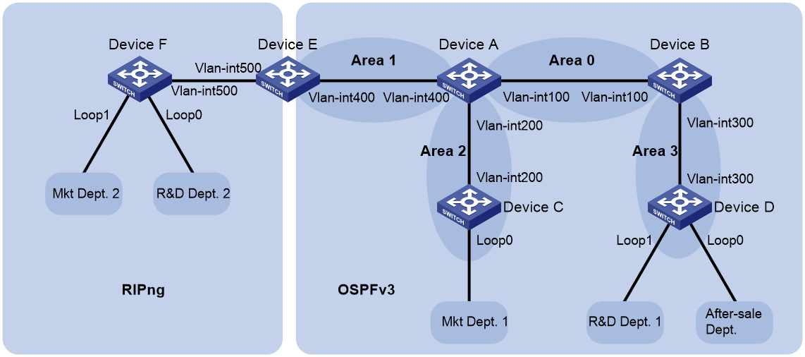

As shown in Figure 1, the devices of an enterprise reside in OSPFv3 and RIPng domains.
Configure route redistribution between OSPFv3 and RIPng to interconnect the devices.
Configure route filtering on Device E, Device C, and Device D to meet the following requirements:
·     The route destined for R&D department 2 is not redistributed to OSPFv3.
·     Marketing department 1 cannot reach R&D department 1.
·     R&D department 1 and the After-sale service department cannot reach Marketing department 2.
Figure 1 Network diagram
Device
Interface
IP address
Device
Interface
IP address
Device A
Vlan-int100
1::1/64
Device B
Vlan-int100

Configuring IPv6 addresses
# Configure an IPv6 address for VLAN-interface 100.
<DeviceA> system-view
[DeviceA] interface vlan-interface 100
[DeviceA-Vlan-interface100] ipv6 address 1::1 64
# Configure IPv6 addresses for other interfaces in the same way VLAN-interface 100 is configured. (Details not shown.)

# On Device E, configure IPv6 basic ACL 2000 to permit any subnet except 14::1/64.
<DeviceE> system-view
[DeviceE] acl ipv6 basic 2000
[DeviceE-acl-ipv6-basic-2000] rule 0 deny source 14::1 64
[DeviceE-acl-ipv6-basic-2000] rule permit source any
[DeviceE-acl-ipv6-basic-2000] quit
# On Device E, use ACL 2000 to filter routes redistributed from RIPng.
[DeviceE] ospfv3
[DeviceE-ospfv3-1] filter-policy 2000 export ripng 1
[DeviceE-ospfv3-1] quit

# Verify that Marketing department 1 cannot reach R&D department 1.

# Verify that Device D does not have a route to 15::/64.

# Verify that the After-sale service department cannot reach Marketing department 2.

# Verify that R&D department 1 cannot reach Marketing department 2.

The output on Device C and Device D shows that Device E has filtered out the route destined for R&D development 2.
