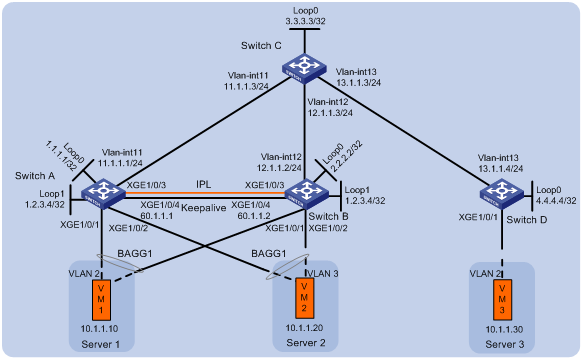

Example: Configuring DRNI using an Ethernet aggregate link as the IPL on EVPN VTEPs
As shown in Figure 1, perform the following tasks to make sure the VMs can communicate with one another:
·     Configure VXLAN 10 on Switch A, Switch B, and Switch D.
·     Configure DRNI on Switch A and Switch B to virtualize them into one VTEP. Configure an Ethernet aggregate link as the IPL between the switches.
·     Configure Switch C as a route reflector (RR).

Analysis
To make sure the overlay network has connectivity, configure a routing protocol on the switches to advertise routes for reaching their interfaces, including the loopback interfaces. In this example, OSPF is used.
To conserve resources, configure Switch C to reflect routes for Switch A, Switch B, and Switch D.

Configuring Switch B
# Specify the virtual VTEP address as 1.2.3.4.
[SwitchB] evpn drni group 1.2.3.4
# Configure DR system parameters.
[SwitchB] drni system-mac 0001-0001-0001
[SwitchB] drni system-number 2
[SwitchB] drni system-priority 10
[SwitchB] drni restore-delay 180
[SwitchB] drni keepalive ip destination 60.1.1.1 source 60.1.1.2
# Create Layer 2 dynamic aggregate interface Bridge-Aggregation 3.
[SwitchB] interface bridge-aggregation 3
[SwitchB-Bridge-Aggregation3] link-aggregation mode dynamic
[SwitchB-Bridge-Aggregation3] quit
# Assign Ten-GigabitEthernet 1/0/3 to aggregation group 3.
[SwitchB] interface ten-gigabitethernet 1/0/3
[SwitchB-Ten-GigabitEthernet1/0/3] port link-aggregation group 3
[SwitchB-Ten-GigabitEthernet1/0/3] quit
# Specify Bridge-Aggregation 3 as the IPP.
[SwitchB-Bridge-Aggregation3] port drni intra-portal-port 1
[SwitchB-Bridge-Aggregation3] undo mac-address static source-check enable
# Disable the static source check feature on Ten-GigabitEthernet 1/0/5.
[SwitchB] interface ten-gigabitethernet 1/0/5
[SwitchB-Ten-GigabitEthernet1/0/5] undo mac-address static source-check enable
[SwitchB-Ten-GigabitEthernet1/0/5] quit
# Create Layer 2 dynamic aggregate interface Bridge-Aggregation 4.
[SwitchB] interface bridge-aggregation 4
[SwitchB-Bridge-Aggregation4] link-aggregation mode dynamic
[SwitchB-Bridge-Aggregation4] quit
# Assign Ten-GigabitEthernet 1/0/1 to aggregation group 4.
[SwitchB] interface ten-gigabitethernet 1/0/1
[SwitchB-Ten-GigabitEthernet1/0/1] port link-aggregation group 4
[SwitchB-Ten-GigabitEthernet1/0/1] quit
# Assign Bridge-Aggregation 4 to DR group 4.
[SwitchB-Bridge-Aggregation4] port drni group 4
# Create Layer 2 dynamic aggregate interface Bridge-Aggregation 5.
[SwitchB] interface bridge-aggregation 5
[SwitchB-Bridge-Aggregation5] link-aggregation mode dynamic
[SwitchB-Bridge-Aggregation5] quit
# Assign Ten-GigabitEthernet 1/0/2 to aggregation group 5.
[SwitchB] interface ten-gigabitethernet 1/0/2
[SwitchB-Ten-GigabitEthernet1/0/2] port link-aggregation group 5
[SwitchB-Ten-GigabitEthernet1/0/2] quit
# Assign Bridge-Aggregation 5 to DR group 5.
[SwitchB-Bridge-Aggregation5] port drni group 5
# Exclude all interfaces used by EVPN from the shutdown action by DRNI MAD.
[SwitchB] mad exclude interface loopback 0
[SwitchB] mad exclude interface ten-gigabitethernet 1/0/4
[SwitchB] mad exclude interface ten-gigabitethernet 1/0/5
[SwitchB] mad exclude interface vlan-interface 12

Mapping Ethernet service instances to VSIs
Configuring Switch A
# On Bridge-Aggregation 4, create Ethernet service instance 1000 to match VLAN 2.
[SwitchA] interface bridge-aggregation 4
[SwitchA-Bridge-Aggregation4] service-instance 1000
[SwitchA-Bridge-Aggregation4-srv1000] encapsulation s-vid 2
# Map Ethernet service instance 1000 to VSI vpna.
[SwitchA-Bridge-Aggregation4-srv1000] xconnect vsi vpna
[SwitchA-Bridge-Aggregation4-srv1000] quit
# On Bridge-Aggregation 5, create Ethernet service instance 1000 to match VLAN 3.
[SwitchA] interface bridge-aggregation 5
[SwitchA-Bridge-Aggregation5] service-instance 1000
[SwitchA-Bridge-Aggregation5-srv1000] encapsulation s-vid 3
[SwitchA-Bridge-Aggregation5-srv1000] xconnect vsi vpna
[SwitchA-Bridge-Aggregation5-srv1000] quit
[SwitchB-Bridge-Aggregation4] service-instance 1000
[SwitchB-Bridge-Aggregation4-srv1000] encapsulation s-vid 2
[SwitchB-Bridge-Aggregation4-srv1000] xconnect vsi vpna
[SwitchB-Bridge-Aggregation4-srv1000] quit
[SwitchB-Bridge-Aggregation5] service-instance 1000
[SwitchB-Bridge-Aggregation5-srv1000] encapsulation s-vid 3
[SwitchB-Bridge-Aggregation5-srv1000] xconnect vsi vpna
[SwitchB-Bridge-Aggregation5-srv1000] quit
Configuring Switch D
# On Ten-GigabitEthernet 1/0/1, create Ethernet service instance 1000 to match VLAN 2.
[SwitchD] interface ten-gigabitethernet 1/0/1
[SwitchD-Ten-GigabitEthernet1/0/1] service-instance 1000
[SwitchD-Ten-GigabitEthernet1/0/1] encapsulation s-vid 2
[SwitchD-Ten-GigabitEthernet1/0/1] xconnect vsi vpna
[SwitchD-Ten-GigabitEthernet1/0/1] quit
Verifying the configuration on a DR member device
The verification procedure uses Switch A as an example.
# Verify that Switch A has BGP EVPN routes.
[Switch A]display bgp l2vpn evpn
 BGP local router ID is 1.2.3.4
 Status codes: * - valid, > - best, d - dampened, h - history
               s - suppressed, S - stale, i - internal, e - external
               a - additional-path
       Origin: i - IGP, e - EGP, ? - incomplete
 Total number of routes from all PEs: 1
 Route distinguisher: 1:10
 Total number of routes: 2
     Network            NextHop         MED        LocPrf     PrefVal Path/Ogn
* >  [3][0][32][1.2.3.4]/80
                        1.2.3.4         0          100        32768   i
* >i [3][0][32][4.4.4.4]/80
                        4.4.4.4         0          100        0       i
# Verify that the VXLAN tunnel to Switch D is up, and the source address of the tunnel is the virtual VTEP address.
[SwitchA] display interface tunnel
Tunnel0
Current state: UP
Line protocol state: UP
Description: Tunnel0 Interface
Bandwidth: 64 kbps
Maximum transmission unit: 1464
Internet protocol processing: Disabled
Last clearing of counters: Never
Tunnel source 1.2.3.4, destination 4.4.4.4
Tunnel protocol/transport UDP_VXLAN/IP
Last 300 seconds input rate: 0 bytes/sec, 0 bits/sec, 0 packets/sec
Last 300 seconds output rate: 0 bytes/sec, 0 bits/sec, 0 packets/sec
Input: 0 packets, 0 bytes, 0 drops
Output: 0 packets, 0 bytes, 0 drops
# Verify that ACs have been created on the IPP and mapped to VXLAN 10.
[SwitchA] display l2vpn vsi verbose
VSI Name: vpna
  VSI Index               : 0
  VSI State               : Up
  MTU                     : 1500
  Bandwidth               : Unlimited
  Broadcast Restrain      : Unlimited
  Multicast Restrain      : Unlimited
  Unknown Unicast Restrain: Unlimited
  MAC Learning            : Enabled
  MAC Table Limit         : -
  MAC Learning rate       : -
  Drop Unknown            : -
  Flooding                : Enabled
  Statistics              : Disabled
  VXLAN ID                : 10
  Tunnels:
    Tunnel Name          Link ID    State    Type        Flood proxy
    Tunnel0              0x5000000  UP       Auto        Disabled
  ACs:
    AC                               Link ID  State       Type
    BAGG4 srv1000                    0        Up          Manual
    BAGG3 srv2                       1        Up          Dynamic (MLAG)
    BAGG5 srv1000                    2        Up          Manual
    BAGG3 srv3                       3        Up          Dynamic (MLAG)
Verifying the network connectivity of the VMs
# Verify that VM 1, VM 2, and VM 3 can communicate when both Switch A and Switch B are operating correctly. (Details not shown.)
# Verify that VM 1, VM 2, and VM 3 can communicate when Switch A's or Switch B's links to the local site are disconnected. (Details not shown.)

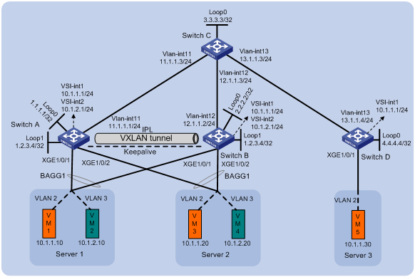

Example: Configuring DRNI using a VXLAN tunnel as the IPL on EVPN VTEPs
As shown in Figure 2, perform the following tasks to make sure the VMs can communicate with one another:
·     Configure DRNI on Switch A and Switch B to virtualize them into one VTEP. Manually set up a VXLAN tunnel as the IPL between the switches.
·     Configure Switch C as an RR.
Figure 2 Network diagram

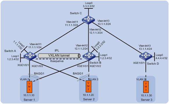

               a - additional-path
 Total number of routes from all PEs: 2
 Total number of routes: 4
* >  [3][0][32][1.1.1.1]/80
                        1.1.1.1         0          100        32768   i
* >i [3][0][32][2.2.2.2]/80
                        2.2.2.2         0          100        0       i
                        4.4.4.4         0          100        0       i
# Verify that the IPL Tunnel 1 is up, and Tunnel 0 to Switch D uses the virtual VTEP address as the source address.
[SwitchA] display interface Tunnel
Tunnel0
Current state: UP
Bandwidth: 64 kbps
Tunnel1
Current state: UP
Description: Tunnel1 Interface
Bandwidth: 64 kbps
Tunnel source 1.1.1.1, destination 2.2.2.2
Last 300 seconds input rate: 13 bytes/sec, 104 bits/sec, 0 packets/sec
Last 300 seconds output rate: 13 bytes/sec, 104 bits/sec, 0 packets/sec
Input: 332 packets, 36377 bytes, 0 drops
Output: 583 packets, 59132 bytes, 0 drops
# Verify that the VXLAN tunnels have been assigned to VXLAN 10.
VSI Name: vpna
  VSI Index               : 0
  VSI State               : Up
  MTU                     : 1500
  MAC Table Limit         : -
  Drop Unknown            : -
  Flooding                : Enabled
  VXLAN ID                : 10
  Tunnels:
    Tunnel1              0x5000001  UP       Manual      Disabled
  ACs:

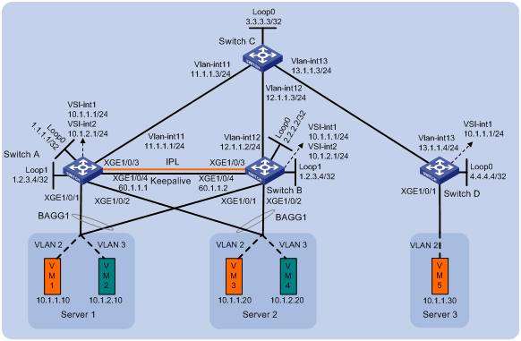

Example: Configuring DRNI using an Ethernet aggregate link as the IPL on EVPN gateways
As shown in Figure 3, perform the following tasks to make sure the VMs can communicate with one another:
·     Configure VXLAN 10 on Switch A, Switch B, and Switch D, and configure VXLAN 20 on Switch A and Switch B.
·     Configure Switch A, Switch B, and Switch D as distributed EVPN gateways to provide Layer 3 forwarding service for VMs.
Figure 3 Network diagram
Analysis
To make sure the overlay network has connectivity,, configure a routing protocol on these switches to advertise routes for reaching their interfaces, including the loopback interfaces. In this example, OSPF is used.
Software versions used
This configuration example was created and verified on S6860-CMW710-R2612.
In a DR system, DR member devices must have the same EVPN configuration.
Make sure the outer VLAN IDs configured on Ethernet service instances of different VSIs do not overlap. The Ethernet service interfaces that match the same outer VLAN ID on different ports must be mapped to the same VSI.
For EVPN to run correctly on a DR system, you must execute the undo mac-address static source-check enable command on IPPs and IRF physical interfaces of the DR member devices.
As a best practice, use the IP address of a loopback interface as the virtual VTEP address.
Procedures
Configuring Layer 3 interfaces
# Configure the Layer 3 interfaces on Switch A.
<SwitchA> system-view
[SwitchA] interface loopback 0
[SwitchA-Loopback0] ip address 1.1.1.1 32
[SwitchA-Loopback0] quit
[SwitchA] interface loopback 1
[SwitchA-Loopback1] ip address 1.2.3.4 32
[SwitchA-Loopback1] quit
[SwitchA] vlan 11
[SwitchA-vlan11] port ten-gigabitethernet 1/0/5
[SwitchA-vlan11] quit
[SwitchA] interface vlan-interface 11
[SwitchA-Vlan-interface11] ip address 11.1.1.1 24
[SwitchA-Vlan-interface11] quit
[SwitchA] interface ten-gigabitethernet 1/0/4
[SwitchA-Ten-GigabitEthernet1/0/4] port link-mode route
[SwitchA-Ten-GigabitEthernet1/0/4] ip address 60.1.1.1 24
[SwitchA-Ten-GigabitEthernet1/0/4] quit
# Configure the Layer 3 interfaces on other switches. (Details not shown.)
# On VM 1, VM 3, and VM 5, specify 10.1.1.1 as the gateway address. On VM 2 and VM 4, specify 10.1.2.1 as the gateway address. (Details not shown.)
Configuring OSPF
# Configure OSPF to advertise the networks attached to the Layer 3 interfaces.
[SwitchA] ospf 1 router-id 1.1.1.1
[SwitchA-ospf-1] area 0
[SwitchA-ospf-1-area-0.0.0.0] network 1.1.1.1 0.0.0.0
[SwitchA-ospf-1-area-0.0.0.0] network 1.2.3.4 0.0.0.0
[SwitchA-ospf-1-area-0.0.0.0] network 11.1.1.0 0.0.0.255
[SwitchA-ospf-1-area-0.0.0.0] quit
[SwitchA-ospf-1] quit
<SwitchB> system-view
[SwitchB] ospf 1 router-id 2.2.2.2
[SwitchB-ospf-1] area 0
[SwitchB-ospf-1-area-0.0.0.0] network 2.2.2.2 0.0.0.0
[SwitchB-ospf-1-area-0.0.0.0] network 1.2.3.4 0.0.0.0
[SwitchB-ospf-1-area-0.0.0.0] network 12.1.1.0 0.0.0.255
[SwitchB-ospf-1-area-0.0.0.0] quit
[SwitchB-ospf-1] quit
Configuring Switch C
<SwitchC> system-view
[SwitchC] ospf 1 router-id 3.3.3.3
[SwitchC-ospf-1] area 0
[SwitchC-ospf-1-area-0.0.0.0] network 3.3.3.3 0.0.0.0
[SwitchC-ospf-1-area-0.0.0.0] network 11.1.1.0 0.0.0.255
[SwitchC-ospf-1-area-0.0.0.0] network 12.1.1.0 0.0.0.255
[SwitchC-ospf-1-area-0.0.0.0] network 13.1.1.0 0.0.0.255
[SwitchC-ospf-1-area-0.0.0.0] quit
[SwitchC-ospf-1] quit
<SwitchD> system-view
[SwitchD] ospf 1 router-id 4.4.4.4
[SwitchD-ospf-1] area 0
[SwitchD-ospf-1-area-0.0.0.0] network 4.4.4.4 0.0.0.0
[SwitchD-ospf-1-area-0.0.0.0] network 13.1.1.0 0.0.0.255
[SwitchD-ospf-1-area-0.0.0.0] quit
[SwitchD-ospf-1] quit
Configuring EVPN
# Enable L2VPN.
[SwitchA] l2vpn enable
# Set the VXLAN hardware resource mode. (For the VXLAN hardware resource mode to take effect, you must reboot the switch. This example does not provide the steps for rebooting the switch.)
[SwitchA] hardware-resource vxlan l3gw8k
# Disable remote MAC address learning and remote ARP learning.
[SwitchA] vxlan tunnel mac-learning disable
[SwitchA] vxlan tunnel arp-learning disable
# Configure the EVPN global MAC address as 0002-0003-0004.
[SwitchA] evpn global-mac 2-3-4
# Create an EVPN instance on VSI vpna.
[SwitchA] vsi vpna
[SwitchA-vsi-vpna] evpn encapsulation vxlan
# Configure the switch to automatically generate an RD and a route target for the EVPN instance.
[SwitchA-vsi-vpna-evpn-vxlan] route-distinguisher auto
[SwitchA-vsi-vpna-evpn-vxlan] vpn-target auto
[SwitchA-vsi-vpna-evpn-vxlan] quit
# Create VXLAN 10.
[SwitchA-vsi-vpna] vxlan 10
[SwitchA-vsi-vpna-vxlan-10] quit
[SwitchA-vsi-vpna] quit
# Create an EVPN instance on VSI vpnb.
[SwitchA] vsi vpnb
[SwitchA-vsi-vpnb] evpn encapsulation vxlan
[SwitchA-vsi-vpnb-evpn-vxlan] route-distinguisher auto
[SwitchA-vsi-vpnb-evpn-vxlan] vpn-target auto
[SwitchA-vsi-vpnb-evpn-vxlan] quit
# Create VXLAN 20.
[SwitchA-vsi-vpnb] vxlan 20
[SwitchA-vsi-vpnb-vxlan-20] quit
[SwitchA-vsi-vpnb] quit
# Enable L2VPN.
[SwitchB] l2vpn enable
[SwitchB] hardware-resource vxlan l3gw8k
[SwitchB] vxlan tunnel mac-learning disable
[SwitchB] vxlan tunnel arp-learning disable
[SwitchB] evpn global-mac 2-3-4
[SwitchB] vsi vpna
[SwitchB-vsi-vpna] evpn encapsulation vxlan
[SwitchB-vsi-vpna-evpn-vxlan] route-distinguisher auto
[SwitchB-vsi-vpna-evpn-vxlan] vpn-target auto
[SwitchB-vsi-vpna-evpn-vxlan] quit
# Create VXLAN 10.
[SwitchB-vsi-vpna] vxlan 10
[SwitchB-vsi-vpna-vxlan-10] quit
[SwitchB-vsi-vpna] quit
[SwitchB] vsi vpnb
[SwitchB-vsi-vpnb] evpn encapsulation vxlan
[SwitchB-vsi-vpnb-evpn-vxlan] route-distinguisher auto
[SwitchB-vsi-vpnb-evpn-vxlan] vpn-target auto
[SwitchB-vsi-vpnb-evpn-vxlan] quit
# Create VXLAN 20.
[SwitchB-vsi-vpnb] vxlan 20
[SwitchB-vsi-vpnb-vxlan-20] quit
[SwitchB-vsi-vpnb] quit
# Enable L2VPN.
[SwitchD] l2vpn enable
[SwitchD] hardware-resource vxlan l3gw8k
[SwitchD] vxlan tunnel mac-learning disable
[SwitchD] vxlan tunnel arp-learning disable
[SwitchD] vsi vpna
[SwitchD-vsi-vpna] evpn encapsulation vxlan
[SwitchD-vsi-vpna-evpn-vxlan] route-distinguisher auto
[SwitchD-vsi-vpna-evpn-vxlan] vpn-target auto
[SwitchD-vsi-vpna-evpn-vxlan] quit
# Create VXLAN 10.
[SwitchD-vsi-vpna] vxlan 10
[SwitchD-vsi-vpna-vxlan-10] quit
[SwitchD-vsi-vpna] quit
Configuring distributed EVPN gateways
# Configure RD and route target settings for VPN instance vpna.
[SwitchA] ip vpn-instance vpna
[SwitchA-vpn-instance-vpna] route-distinguisher 1:1
[SwitchA-vpn-instance-vpna] address-family ipv4
[SwitchA-vpn-ipv4-vpna] vpn-target 2:2
[SwitchA-vpn-ipv4-vpna] quit
[SwitchA-vpn-instance-vpna] address-family evpn
[SwitchA-vpn-evpn-vpna] vpn-target 1:1
[SwitchA-vpn-evpn-vpna] quit
[SwitchA-vpn-instance-vpna] quit
# Configure VSI-interface 1 as a distributed gateway.
[SwitchA] interface vsi-interface 1
[SwitchA-Vsi-interface1] ip binding vpn-instance vpna
[SwitchA-Vsi-interface1] ip address 10.1.1.1 255.255.255.0
[SwitchA-Vsi-interface1] mac-address 1-1-1
[SwitchA-Vsi-interface1] distributed-gateway local
[SwitchA-Vsi-interface1] local-proxy-arp enable
[SwitchA-Vsi-interface1] quit
# Configure VSI-interface 2 as a distributed gateway.
[SwitchA] interface vsi-interface 2
[SwitchA-Vsi-interface2] ip binding vpn-instance vpna
[SwitchA-Vsi-interface2] ip address 10.1.2.1 255.255.255.0
[SwitchA-Vsi-interface2] mac-address 2-2-2
[SwitchA-Vsi-interface2] distributed-gateway local
[SwitchA-Vsi-interface2] local-proxy-arp enable
[SwitchA-Vsi-interface2] quit
# Create VSI-interface 3. Associate VSI-interface 3 with VPN instance vpna, and configure the L3 VXLAN ID as 1000 for the VPN instance.
[SwitchA] interface vsi-interface 3
[SwitchA-Vsi-interface3] ip binding vpn-instance vpna
[SwitchA-Vsi-interface3] l3-vni 1000
[SwitchA-Vsi-interface3] quit
# Specify VSI-interface 1 as the gateway interface for VSI vpna.
[SwitchA] vsi vpna
[SwitchA-vsi-vpna] gateway vsi-interface 1
# Specify VSI-interface 2 as the gateway interface for VSI vpnb.
[SwitchA] vsi vpnb
[SwitchA-vsi-vpnb] gateway vsi-interface 2
[SwitchB] ip vpn-instance vpna
[SwitchB-vpn-instance-vpna] route-distinguisher 1:1
[SwitchB-vpn-instance-vpna] address-family ipv4
[SwitchB-vpn-ipv4-vpna] vpn-target 2:2
[SwitchB-vpn-ipv4-vpna] quit
[SwitchB-vpn-instance-vpna] address-family evpn
[SwitchB-vpn-evpn-vpna] vpn-target 1:1
[SwitchB-vpn-evpn-vpna] quit
[SwitchB-vpn-instance-vpna] quit
[SwitchB] interface vsi-interface 1
[SwitchB-Vsi-interface1] ip binding vpn-instance vpna
[SwitchB-Vsi-interface1] ip address 10.1.1.1 255.255.255.0
[SwitchB-Vsi-interface1] mac-address 1-1-1
[SwitchB-Vsi-interface1] distributed-gateway local
[SwitchB-Vsi-interface1] local-proxy-arp enable
[SwitchB-Vsi-interface1] quit
[SwitchB] interface vsi-interface 2
[SwitchB-Vsi-interface2] ip binding vpn-instance vpna
[SwitchB-Vsi-interface2] ip address 10.1.2.1 255.255.255.0
[SwitchB-Vsi-interface2] mac-address 2-2-2
[SwitchB-Vsi-interface2] distributed-gateway local
[SwitchB-Vsi-interface2] local-proxy-arp enable
[SwitchB-Vsi-interface2] quit
[SwitchB] interface vsi-interface 3
[SwitchB-Vsi-interface3] ip binding vpn-instance vpna
[SwitchB-Vsi-interface3] l3-vni 1000
[SwitchB-Vsi-interface3] quit
[SwitchB] vsi vpna
[SwitchB-vsi-vpna] gateway vsi-interface 1
[SwitchB] vsi vpnb
[SwitchB-vsi-vpnb] gateway vsi-interface 2
[SwitchD] ip vpn-instance vpna
[SwitchD-vpn-instance-vpna] route-distinguisher 1:1
[SwitchD-vpn-instance-vpna] address-family ipv4
[SwitchD-vpn-ipv4-vpna] vpn-target 2:2
[SwitchD-vpn-ipv4-vpna] quit
[SwitchD-vpn-instance-vpna] address-family evpn
[SwitchD-vpn-evpn-vpna] vpn-target 1:1
[SwitchD-vpn-evpn-vpna] quit
[SwitchD-vpn-instance-vpna] quit
[SwitchD] interface vsi-interface 1
[SwitchD-Vsi-interface1] ip binding vpn-instance vpna
[SwitchD-Vsi-interface1] ip address 10.1.1.1 255.255.255.0
[SwitchD-Vsi-interface1] mac-address 1-1-1
[SwitchD-Vsi-interface1] distributed-gateway local
[SwitchD-Vsi-interface1] local-proxy-arp enable
[SwitchD-Vsi-interface1] quit
# Create VSI-interface 3. Associate VSI-interface 3 with VPN instance vpna and configure the L3 VXLAN ID as 1000 for the VPN instance.
[SwitchD] interface vsi-interface 3
[SwitchD-Vsi-interface3] ip binding vpn-instance vpna
[SwitchD-Vsi-interface3] l3-vni 1000
[SwitchD-Vsi-interface3] quit
[SwitchD] vsi vpna
[SwitchD-vsi-vpna] gateway vsi-interface 1
Configuring DRNI
[SwitchA] evpn drni group 1.2.3.4
[SwitchA] drni system-mac 0001-0002-0003
[SwitchA] drni system-number 1
[SwitchA] drni system-priority 10
[SwitchA] drni restore-delay 180
[SwitchA] drni keepalive ip destination 60.1.1.2 source 60.1.1.1
[SwitchA] interface bridge-aggregation 3
[SwitchA-Bridge-Aggregation3] link-aggregation mode dynamic
[SwitchA-Bridge-Aggregation3] quit
[SwitchA] interface ten-gigabitethernet 1/0/3
[SwitchA-Ten-GigabitEthernet1/0/3] port link-aggregation group 3
[SwitchA-Ten-GigabitEthernet1/0/3] quit
[SwitchA-Bridge-Aggregation3] port drni intra-portal-port 1
[SwitchA-Bridge-Aggregation3] undo mac-address static source-check enable
[SwitchA] interface ten-gigabitethernet 1/0/5
[SwitchA-Ten-GigabitEthernet1/0/5] undo mac-address static source-check enable
[SwitchA-Ten-GigabitEthernet1/0/5] quit
[SwitchA-Bridge-Aggregation4] link-aggregation mode dynamic
[SwitchA-Bridge-Aggregation4] quit
[SwitchA] interface ten-gigabitethernet 1/0/1
[SwitchA-Ten-GigabitEthernet1/0/1] port link-aggregation group 4
[SwitchA-Ten-GigabitEthernet1/0/1] quit
[SwitchA-Bridge-Aggregation4] port drni group 4
[SwitchA-Bridge-Aggregation5] link-aggregation mode dynamic
[SwitchA-Bridge-Aggregation5] quit
[SwitchA] interface ten-gigabitethernet 1/0/2
[SwitchA-Ten-GigabitEthernet1/0/2] port link-aggregation group 5
[SwitchA-Ten-GigabitEthernet1/0/2] quit
[SwitchA-Bridge-Aggregation5] port drni group 5
[SwitchA] mad exclude interface loopback 0
[SwitchA] mad exclude interface ten-gigabitethernet 1/0/4
[SwitchA] mad exclude interface ten-gigabitethernet 1/0/5
[SwitchA] mad exclude interface vlan-interface 11
[SwitchA] mad exclude interface vsi-interface 1
[SwitchA] mad exclude interface vsi-interface 2
[SwitchB] drni system-mac 0001-0002-0003
[SwitchB] mad exclude interface vsi-interface 1
[SwitchB] mad exclude interface vsi-interface 2
Configuring BGP to advertise BGP EVPN routes
# Configure BGP to advertise BGP EVPN routes.
[SwitchA] bgp 200
[SwitchA-bgp-default] peer 3.3.3.3 as-number 200
[SwitchA-bgp-default] peer 3.3.3.3 connect-interface loopback 0
[SwitchA-bgp-default] address-family l2vpn evpn
[SwitchA-bgp-default-evpn] peer 3.3.3.3 enable
[SwitchA-bgp-default-evpn] quit
[SwitchA-bgp-default] quit
[SwitchB] bgp 200
[SwitchB-bgp-default] peer 3.3.3.3 as-number 200
[SwitchB-bgp-default] peer 3.3.3.3 connect-interface loopback 0
[SwitchB-bgp-default] address-family l2vpn evpn
[SwitchB-bgp-default-evpn] peer 3.3.3.3 enable
[SwitchB-bgp-default-evpn] quit
[SwitchB-bgp-default] quit
# Configure BGP to advertise BGP EVPN routes and configure the switch as an RR.
[SwitchC] bgp 200
[SwitchC-bgp-default] group evpn
[SwitchC-bgp-default] peer 1.1.1.1 group evpn
[SwitchC-bgp-default] peer 2.2.2.2 group evpn
[SwitchC-bgp-default] peer 4.4.4.4 group evpn
[SwitchC-bgp-default] peer evpn as-number 200
[SwitchC-bgp-default] peer evpn connect-interface loopback 0
[SwitchC-bgp-default] address-family l2vpn evpn
[SwitchC-bgp-default-evpn] peer evpn enable
[SwitchC-bgp-default-evpn] undo policy vpn-target
[SwitchC-bgp-default-evpn] peer evpn reflect-client
[SwitchC-bgp-default-evpn] quit
[SwitchC-bgp-default] quit
[SwitchD] bgp 200
[SwitchD-bgp-default] peer 3.3.3.3 as-number 200
[SwitchD-bgp-default] peer 3.3.3.3 connect-interface loopback 0
[SwitchD-bgp-default] address-family l2vpn evpn
[SwitchD-bgp-default-evpn] peer 3.3.3.3 enable
[SwitchD-bgp-default-evpn] quit
[SwitchD-bgp-default] quit
# Map Ethernet service instance 1000 to VSI vpnb.
[SwitchA-Bridge-Aggregation5-srv1000] xconnect vsi vpnb
[SwitchB-Bridge-Aggregation5-srv1000] xconnect vsi vpnb
[SwitchD-Ten-GigabitEthernet1/0/1-srv1000] encapsulation s-vid 2
[SwitchD-Ten-GigabitEthernet1/0/1-srv1000] xconnect vsi vpna
[SwitchD-Ten-GigabitEthernet1/0/1-srv1000] quit
               a - additional-path
 Route distinguisher: 1:1(vpna)
* >  [5][0][24][10.1.1.0]/80
* >  [5][0][24][10.1.2.0]/80
                        4.4.4.4         0          100        0       i
 Route distinguisher: 1:20
                        4.4.4.4         0          100        0       i
Tunnel0
Current state: UP
Bandwidth: 64 kbps
# Verify that ACs have been created on the IPP and mapped to VXLAN 10 and VXLAN 20.
VSI Name: Auto_L3VNI1000_3
  VSI Index               : 1
  VSI State               : Down
  MTU                     : 1500
  MAC Table Limit         : -
  Drop Unknown            : -
  Flooding                : Enabled
  Gateway Interface       : VSI-interface 3
  VXLAN ID                : 1000
VSI Name: vpna
  VSI Index               : 0
  VSI State               : Up
  MTU                     : 1500
  MAC Table Limit         : -
  Drop Unknown            : -
  Flooding                : Enabled
  Gateway Interface       : VSI-interface 1
  VXLAN ID                : 10
  Tunnels:
  ACs:

Example: Configuring DRNI using a VXLAN tunnel as the IPL on EVPN gateways
As shown in Figure 4, perform the following tasks to make sure the VMs can communicate with one another:
·     Configure VXLAN 10 on Switch A, Switch B, and Switch D, and configure VXLAN 20 on Switch A, and Switch B.
Figure 4 Network diagram
Analysis
You can configure only the following criteria for Ethernet service instances on DR interfaces:
·     encapsulation s-vid { vlan-id | vlan-id-list }
·     encapsulation untagged
As a best practice, do not redistribute external routes on the DR member devices.
You must disable spanning tree on the Layer 2 traffic outgoing interface for the VXLAN tunnel that acts as the IPL.

Configuring DRNI
[SwitchA] drni keepalive ip destination 12.1.1.2 source 11.1.1.1
# Create a tunnel to Switch B, specify the tunnel interface as the IPP.
[SwitchA] interface tunnel 1 mode vxlan
[SwitchA-Tunnel1] source 1.1.1.1
[SwitchA-Tunnel1] destination 2.2.2.2
[SwitchA-Tunnel1] port drni intra-portal-port 1
[SwitchA-Tunnel1] quit
[SwitchA] mad exclude interface tunnel 1
[SwitchA] mad exclude interface loopback0
[SwitchA] mad exclude interface ten-gigabitethernet1/0/5
