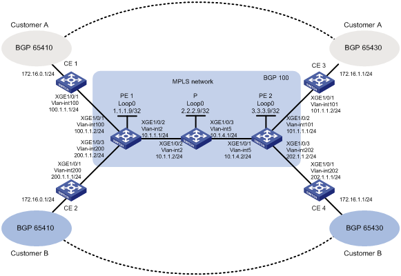

As shown in Figure 1, configure MPLS L3VPN to allow communication between different sites of a customer and to isolate different customers.
Figure 1 Network diagram
Analysis
To generate inner labels, and deliver VPN routing information to the remote PE, configure MP-BGP peers between PEs.
To generate outer labels to tunnel the VPN packets over the MPLS backbone, configure a routing protocol and MPLS LDP on the MPLS backbone.
To identify routing information for different customers on PEs, perform the following tasks on each PE:
·     Create a VPN instance for each customer.
·     Configure an RD and route targets for each VPN instance.
·     Redistribute internal routes of each site to the corresponding VPN instance.
Software versions used
This configuration example was created and verified on S6860-CMW710-R2612.
Associating an interface with a VPN instance deletes the IP address of the interface. You must reconfigure the interface's IP address after the association.

1.     Configure OSPF on the MPLS backbone to ensure IP connectivity within the backbone:
# On PE 1, configure IP addresses for the loopback interface and the core-facing interface.
<PE1> system-view
[PE1] interface loopback 0
[PE1-LoopBack0] ip address 1.1.1.9 32
[PE1-LoopBack0] quit
[PE1] vlan 2
[PE1-vlan2] port ten-gigabitethernet 1/0/2
[PE1-vlan2] quit
[PE1] interface vlan-interface 2
[PE1-Vlan-interface2] ip address 10.1.1.1 24
[PE1-Vlan-interface2] quit
# On PE 1, configure OSPF to advertise backbone networks.
[PE1] ospf
[PE1-ospf-1] area 0
[PE1-ospf-1-area-0.0.0.0] network 10.1.1.0 0.0.0.255
[PE1-ospf-1-area-0.0.0.0] network 1.1.1.9 0.0.0.0
[PE1-ospf-1-area-0.0.0.0] quit
[PE1-ospf-1] quit
# On P, configure IP addresses for interfaces, including the loopback interface.
<P> system-view
[P] interface loopback 0
[P-LoopBack0] ip address 2.2.2.9 32
[P-LoopBack0] quit
[P] vlan 2
[P-vlan2] port ten-gigabitethernet 1/0/2
[P-vlan2] quit
[P] vlan 5
[P-vlan5] port ten-gigabitethernet 1/0/3
[P-vlan5] quit
[P] interface vlan-interface 2
[P-Vlan-interface2] ip address 10.1.1.2 24
[P-Vlan-interface2] quit
[P] interface vlan-interface 5
[P-Vlan-interface5] ip address 10.1.4.1 24
[P-Vlan-interface5] quit
# On P, configure OSPF to advertise backbone networks.
[P] ospf
[P-ospf-1] area 0
[P-ospf-1-area-0.0.0.0] network 10.1.1.0 0.0.0.255
[P-ospf-1-area-0.0.0.0] network 10.1.4.0 0.0.0.255
[P-ospf-1-area-0.0.0.0] network 2.2.2.9 0.0.0.0
[P-ospf-1-area-0.0.0.0] quit
[P-ospf-1] quit
# On PE 2, configure IP addresses for the loopback interface and the core-facing interface.
<PE2> system-view
[PE2] interface loopback 0
[PE2-LoopBack0] ip address 3.3.3.9 32
[PE2-LoopBack0] quit
[PE2] vlan 5
[PE2-vlan5] port ten-gigabitethernet 1/0/1
[PE2-vlan5] quit
[PE2] interface vlan-interface 5
[PE2-Vlan-interface5] ip address 10.1.4.2 24
[PE2-Vlan-interface5] quit
# On PE 2, configure OSPF to advertise backbone networks.
[PE2] ospf
[PE2-ospf-1] area 0
[PE2-ospf-1-area-0.0.0.0] network 10.1.4.0 0.0.0.255
[PE2-ospf-1-area-0.0.0.0] network 3.3.3.9 0.0.0.0
[PE2-ospf-1-area-0.0.0.0] quit
[PE2-ospf-1] quit
# Verify that OSPF neighbor relationships in Full state have been established on the backbone devices.
[PE1] display ospf peer verbose
          OSPF Process 1 with Router ID 1.1.1.9
                  Neighbors
 Area 0.0.0.0 interface 10.1.1.1(Vlan-interface2)'s neighbors
 Router ID: 2.2.2.9          Address: 10.1.1.2        GR State: Normal
   State: Full  Mode: Nbr is Master  Priority: 1
   DR: 10.1.1.2  BDR: 10.1.1.1  MTU: 0
   Options is 0x02 (-|-|-|-|-|-|E|-)
   Dead timer due in 38  sec
   Neighbor is up for 17:30:25
   Authentication Sequence: [ 0 ]
   Neighbor state change count: 6
   BFD status: Disabled
# Verify that the PEs have learned the routes to the loopback interfaces of each other.
[PE1] display ip routing-table protocol ospf
Summary Count : 5
OSPF Routing table Status : <Active>
Summary Count : 3
Destination/Mask    Proto  Pre  Cost         NextHop         Interface
2.2.2.9/32          OSPF   10   1            10.1.1.2        Vlan2
3.3.3.9/32          OSPF   10   2            10.1.1.2        Vlan2
10.1.4.0/24         OSPF   10   2            10.1.1.2        Vlan2
OSPF Routing table Status : <Inactive>
Summary Count : 2
1.1.1.9/32          OSPF   10   0            1.1.1.9         Loop0
10.1.1.0/24         OSPF   10   1            10.1.1.1        Vlan2

4.     Establish EBGP peer relationships between PEs and CEs, and redistribute VPN routes into BGP:
# On PE 1, create BGP process 100.
[PE1] bgp 100
# On PE 1, specify CE 1 as a peer and redistribute direct routes of CE 1 into the BGP routing table of VPN instance customerA.
[PE1-bgp-default] ip vpn-instance customerA
[PE1-bgp-default-customerA] peer 100.1.1.1 as-number 65410
[PE1-bgp-default-customerA] address-family ipv4 unicast
[PE1-bgp-default-ipv4-customerA] peer 100.1.1.1 enable
[PE1-bgp-default-ipv4-customerA] import-route direct
[PE1-bgp-default-ipv4-customerA] quit
[PE1-bgp-default-customerA] quit
# On PE 1, specify CE 2 as a peer and redistribute direct routes of CE 2 into the BGP routing table of VPN instance customerB.
[PE1-bgp-default] ip vpn-instance customerB
[PE1-bgp-default-customerB] peer 200.1.1.1 as-number 65410
[PE1-bgp-default-customerB] address-family ipv4 unicast
[PE1-bgp-default-ipv4-customerB] peer 200.1.1.1 enable
[PE1-bgp-default-ipv4-customerB] import-route direct
[PE1-bgp-default-ipv4-customerB] quit
[PE1-bgp-default-customerB] quit
[PE1-bgp-default] quit
# On PE 2, create BGP process 100.
[PE2] bgp 100
# On PE 2, specify CE 3 as a peer and redistribute direct routes of CE 3 into the BGP routing table of VPN instance customerA.
[PE2-bgp-default] ip vpn-instance customerA
[PE2-bgp-default-customerA] peer 101.1.1.2 as-number 65430
[PE2-bgp-default-customerA] address-family ipv4 unicast
[PE2-bgp-default-ipv4-customerA] peer 101.1.1.2 enable
[PE2-bgp-default-ipv4-customerA] import-route direct
[PE2-bgp-default-ipv4-customerA] quit
[PE2-bgp-default-customerA] quit
# On PE 2, specify CE 4 as a peer and redistribute direct routes of CE 4 into the BGP routing table of VPN instance customerB.
[PE2-bgp-default] ip vpn-instance customerB
[PE2-bgp-default-customerB] peer 202.1.1.1 as-number 65430
[PE2-bgp-default-customerB] address-family ipv4 unicast
[PE2-bgp-default-ipv4-customerB] peer 202.1.1.1 enable
[PE2-bgp-default-ipv4-customerB] import-route direct
[PE2-bgp-default-ipv4-customerB] quit
[PE2-bgp-default-customerB] quit
[PE2-bgp-default] quit
# On CE 1, create BGP process 65410, specify 100.1.1.2 as the peer, and specify the peer's AS number as 100.
<CE1> system-view
[CE1] bgp 65410
[CE1-bgp-default] peer 100.1.1.2 as-number 100
# On CE 1, enable BGP to exchange IPv4 unicast routing information with peer 100.1.1.2.
[CE1-bgp-default] address-family ipv4 unicast
[CE1-bgp-default-ipv4] peer 100.1.1.2 enable
# On CE 1, redistribute the direct route for the site into EBGP.
[CE1-bgp-default-ipv4] import-route direct
[CE1-bgp-default-ipv4] quit
[CE1-bgp-default] quit
# On CE 2, create BGP process 65410, specify 200.1.1.2 as the peer, and specify the peer's AS number as 100.
<CE2> system-view
[CE2] bgp 65410
[CE2-bgp-default] peer 200.1.1.2 as-number 100
# On CE 2, enable BGP to exchange IPv4 unicast routing information with peer 200.1.1.2.
[CE2-bgp-default] address-family ipv4 unicast
[CE2-bgp-default-ipv4] peer 200.1.1.2 enable
# On CE 2, redistribute the direct route for the site into EBGP.
[CE2-bgp-default-ipv4] import-route direct
[CE2-bgp-default-ipv4] quit
[CE2-bgp-default] quit
# On CE 3, create BGP process 65430, specify 101.1.1.1 as the peer, and specify the peer's AS number as 100.
<CE3> system-view
[CE3] bgp 65430
[CE3-bgp-default] peer 101.1.1.1 as-number 100
# On CE 3, enable BGP to exchange IPv4 unicast routing information with peer 101.1.1.1.
[CE3-bgp-default] address-family ipv4 unicast
[CE3-bgp-default-ipv4] peer 101.1.1.1 enable
# On CE 3, redistribute the direct route for the site into EBGP.
[CE3-bgp-default-ipv4] import-route direct
[CE3-bgp-default-ipv4] quit
[CE3-bgp-default] quit
# On CE 4, create BGP process 65430, specify 202.1.1.2 as the peer, and specify the peer's AS number as 100.
<CE4> system-view
[CE4] bgp 65430
[CE4-bgp-default] peer 202.1.1.2 as-number 100
# On CE 4, enable BGP to exchange IPv4 unicast routing information with peer 202.1.1.2.
[CE4-bgp-default] address-family ipv4 unicast
[CE4-bgp-default-ipv4] peer 202.1.1.2 enable
# On CE 4, redistribute the direct route for the site into EBGP.
[CE4-bgp-default-ipv4] import-route direct
[CE4-bgp-default-ipv4] quit
[CE4-bgp-default] quit
# Verify that a BGP peer relationship in Established state has been established between a PE and a CE.
[PE1] display bgp peer ipv4 vpn-instance customerA
 BGP local router ID: 1.1.1.9
 Local AS number: 100
 Total number of peers: 1                  Peers in established state: 1
  * - Dynamically created peer
  Peer                    AS  MsgRcvd  MsgSent OutQ PrefRcv Up/Down  State
  100.1.1.1            65410        4        4    0       2 13:35:25 Established
5.     Create an MP-IBGP peer relationship between PEs:
# On PE 1, configure 3.3.3.9 as the BGP peer and specify Loopback 0 as the source interface for sending routing updates to the peer.
[PE1] bgp 100
[PE1-bgp-default] peer 3.3.3.9 as-number 100
[PE1-bgp-default] peer 3.3.3.9 connect-interface loopback 0
# On PE 1, enable the peer 3.3.3.9 for the BGP-VPNv4 address family.
[PE1-bgp-default] address-family vpnv4
[PE1-bgp-default-vpnv4] peer 3.3.3.9 enable
[PE1-bgp-default-vpnv4] quit
# On PE 2, configure 1.1.1.9 as the BGP peer and specify Loopback 0 as the source interface for sending routing updates to the peer.
[PE2] bgp 100
[PE2-bgp-default] peer 1.1.1.9 as-number 100
[PE2-bgp-default] peer 1.1.1.9 connect-interface loopback 0
# On PE 2, enable the peer 1.1.1.9 for the BGP-VPNv4 address family.
[PE2-bgp-default] address-family vpnv4
[PE2-bgp-default-vpnv4] peer 1.1.1.9 enable
[PE2-bgp-default-vpnv4] quit
# Verify that a BGP peer relationship in Established state has been established between the PEs.
[PE1] display bgp peer vpnv4
  3.3.3.9                100        8        8    0       0 00:00:08 Established
# Execute the display ip routing-table vpn-instance command on the PEs.
[PE1] display ip routing-table vpn-instance customerA
Destinations : 13        Routes : 13
0.0.0.0/32          Direct 0    0            127.0.0.1       InLoop0
100.1.1.0/24        Direct 0    0            100.1.1.2       Vlan100
100.1.1.0/32        Direct 0    0            100.1.1.2       Vlan100
100.1.1.2/32        Direct 0    0            127.0.0.1       InLoop0
100.1.1.255/32      Direct 0    0            100.1.1.2       Vlan100
101.1.1.0/24        BGP    255  0            3.3.3.9         Vlan2
127.0.0.0/8         Direct 0    0            127.0.0.1       InLoop0
127.0.0.0/32        Direct 0    0            127.0.0.1       InLoop0
127.0.0.1/32        Direct 0    0            127.0.0.1       InLoop0
127.255.255.255/32  Direct 0    0            127.0.0.1       InLoop0
224.0.0.0/4         Direct 0    0            0.0.0.0         NULL0
224.0.0.0/24        Direct 0    0            0.0.0.0         NULL0
255.255.255.255/32  Direct 0    0            127.0.0.1       InLoop0
The output shows that PE 1 has a route to the remote CE of Customer A. Output on PE 2 is similar.
# Verify that CEs of the same VPN can ping each other, whereas those of different VPNs cannot. For example, CE 1 can ping CE 3 (101.1.1.2), but it cannot ping CE 4 (202.1.1.1). (Details not shown.)
Configuration files
·     PE 1:
 route-distinguisher 100:1
 vpn-target 111:1 import-extcommunity
 vpn-target 222:1 export-extcommunity
 route-distinguisher 200:1
 vpn-target 333:1 import-extcommunity
 vpn-target 444:1 export-extcommunity
ospf 1
 area 0.0.0.0
 mpls lsr-id 1.1.1.9
vlan 2
vlan 100
vlan 200
mpls ldp
interface LoopBack0
 ip address 1.1.1.9 255.255.255.255
interface Vlan-interface2
 mpls enable
 mpls ldp enable
interface Vlan-interface100
 ip binding vpn-instance customerA
 ip address 100.1.1.2 255.255.255.0
interface Vlan-interface200
 ip binding vpn-instance customerB
 ip address 200.1.1.2 255.255.255.0
interface Ten-GigabitEthernet1/0/1
 port link-mode bridge
 port access vlan 100
interface Ten-GigabitEthernet1/0/2
 port access vlan 2
interface Ten-GigabitEthernet1/0/3
 port access vlan 200
bgp 100
 peer 3.3.3.9 connect-interface LoopBack0
  peer 3.3.3.9 enable
   import-route direct
   import-route direct
·     P:
ospf 1
 area 0.0.0.0
 mpls lsr-id 2.2.2.9
vlan 2
vlan 5
mpls ldp
interface LoopBack0
 ip address 2.2.2.9 255.255.255.255
 ip address 10.1.1.2 255.255.255.0
 mpls enable
 mpls ldp enable
interface Vlan-interface5
 ip address 10.1.4.1 255.255.255.0
 mpls enable
 mpls ldp enable
 port access vlan 2
 port access vlan 5
·     PE 2:
 vpn-target 111:1 export-extcommunity
 vpn-target 222:1 import-extcommunity
 vpn-target 333:1 export-extcommunity
 vpn-target 444:1 import-extcommunity
ospf 1
 area 0.0.0.0
 mpls lsr-id 3.3.3.9
vlan 5
vlan 101
vlan 202
mpls ldp
interface LoopBack0
 ip address 3.3.3.9 255.255.255.255
 ip address 10.1.4.2 255.255.255.0
 mpls enable
 mpls ldp enable
interface Vlan-interface101
 ip address 101.1.1.1 255.255.255.0
interface Vlan-interface202
 ip address 202.1.1.2 255.255.255.0
 port access vlan 5
 port access vlan 101
 port access vlan 202
bgp 100
 peer 1.1.1.9 connect-interface LoopBack0
  peer 1.1.1.9 enable
   import-route direct
   import-route direct
·     CE 1:
vlan 100
 ip address 100.1.1.1 255.255.255.0
bgp 65410
  import-route direct
·     CE 2:
vlan 200
 ip address 200.1.1.1 255.255.255.0
bgp 65410
  import-route direct
·     CE 3:
vlan 101
 ip address 101.1.1.2 255.255.255.0
bgp 65430
  import-route direct
·     CE 4:
vlan 202
 ip address 202.1.1.1 255.255.255.0
bgp 65430
  import-route direct

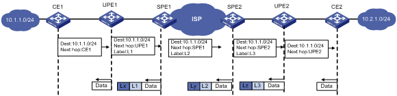

Example: Configuring HoVPN
Hierarchy of VPN (HoVPN) divides PEs into underlayer PEs (UPEs) or user-end PEs, and superstratum PEs (SPEs) or service provider-end PEs. UPEs and SPEs form a hierarchical PE structure.
UPEs and SPEs together provide the functions of a conventional PE.
·     UPE—Provides user access. It maintains the routes of directly connected VPN sites. It does not maintain the routes of the remote sites in the VPN, or it only maintains their summary routes. A UPE assigns inner labels to the routes of its directly connected sites, and advertises the labels along with VPN routes to the SPE through MP-BGP.
·     SPE—Manages and advertises VPN routes. It maintains all the routes of the VPNs connected through UPEs, including the routes of both the local and remote sites. An SPE advertises routes along with labels to UPEs, including the default routes of VPN instances or summary routes and the routes permitted by the routing policy. By using routing policies, you can control which sites in a VPN can communicate with each other.
Figure 2 Routing process and label exchange for HoVPN

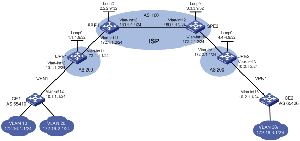

As shown in Figure 3, configure HoVPN and routing policies to allow communication between VLAN 10 and VLAN 30 and to disallow communication between VLAN 20 and VLAN 30.
Figure 3 Network diagram
Analysis
To ensure that VLAN 10 can communicate with VLAN 30 but VLAN 20 cannot, configure a routing policy on SPE 2 to advertise only the route of subnet 172.16.1.0/24 to UPE 2.
When you configure HoVPN, follow these restrictions and guidelines:
·     For an SPE to advertise routes to its connected UPE, perform the following configurations on the SPE:
¡     Configure a routing policy to specify the routes that can be advertised.
¡     Configure the BGP to advertise the routes permitted by the routing policy to the UPE.
·     For an SPE and a UPE (EBGP peers) to advertise labels to each other, perform the following configurations:
¡     Enable BGP to exchange labeled routes with the peer.
¡     Configure a routing policy to specify the routes that can be advertised, and assign MPLS labels to the matching routes.
¡     Apply the routing policy to routes outgoing to the peer.
·     Associating an interface with a VPN instance deletes the IP address of the interface. You must reconfigure the IP address of the interface after the association. To avoid configuring the interface's IP address twice, configure the association first.
Procedures
1.     Enable MPLS and MPLS LDP on SPEs, and configure the IGP protocol (OSPF, in this example):
# On SPE 1, configure basic MPLS and MPLS LDP to establish LDP LSPs.
<SPE1> system-view
[SPE1] interface loopback 0
[SPE1-LoopBack0] ip address 2.2.2.9 32
[SPE1-LoopBack0] quit
[SPE1] mpls lsr-id 2.2.2.9
[SPE1] mpls ldp
[SPE1-ldp] quit
[SPE1] interface vlan-interface 11
[SPE1-Vlan-interface11] ip address 172.1.1.2 24
[SPE1-Vlan-interface11] mpls enable
[SPE1-Vlan-interface11] quit
[SPE1] interface vlan-interface 12
[SPE1-Vlan-interface12] ip address 180.1.1.1 24
[SPE1-Vlan-interface12] mpls enable
[SPE1-Vlan-interface12] mpls ldp enable
[SPE1-Vlan-interface12] quit
# On SPE 1, configure OSPF.
[SPE1] ospf
[SPE1-ospf-1] area 0
[SPE1-ospf-1-area-0.0.0.0] network 2.2.2.9 0.0.0.0
[SPE1-ospf-1-area-0.0.0.0] network 180.1.1.0 0.0.0.255
[SPE1-ospf-1-area-0.0.0.0] quit
[SPE1-ospf-1] quit
# On SPE 2, configure basic MPLS and MPLS LDP to establish LDP LSPs.
<SPE2> system-view
[SPE2] interface loopback 0
[SPE2-LoopBack0] ip address 3.3.3.9 32
[SPE2-LoopBack0] quit
[SPE2] mpls lsr-id 3.3.3.9
[SPE2] mpls ldp
[SPE2-ldp] quit
[SPE2] interface vlan-interface 12
[SPE2-Vlan-interface12] ip address 180.1.1.2 24
[SPE2-Vlan-interface12] mpls enable
[SPE2-Vlan-interface12] mpls ldp enable
[SPE2-Vlan-interface12] quit
[SPE2] interface vlan-interface 11
[SPE2-Vlan-interface11] ip address 172.2.1.2 24
[SPE2-Vlan-interface11] mpls enable
[SPE2-Vlan-interface11] quit
# On SPE 2, configure OSPF.
[SPE2] ospf
[SPE2-ospf-1] area 0
[SPE2-ospf-1-area-0.0.0.0] network 3.3.3.9 0.0.0.0
[SPE2-ospf-1-area-0.0.0.0] network 180.1.1.0 0.0.0.255
[SPE2-ospf-1-area-0.0.0.0] quit
[SPE2-ospf-1] quit
# Execute the display mpls ldp peer command to verify that an LDP session in Operational state has been established between the SPEs. (Details not shown.)
# Execute the display ospf peer command to verify that an OSPF neighbor relationship in FULL state has been established between the SPEs. (Details not shown.)
2.     Establish an MP-IBGP peer relationship between SPE 1 and SPE 2 to exchange VPNv4 routes:
# On SPE 1, establish an MP-IBGP peer relationship with SPE 2.
[SPE1] bgp 100
[SPE1-bgp-default] peer 3.3.3.9 as-number 100
[SPE1-bgp-default] peer 3.3.3.9 connect-interface loopback 0
[SPE1-bgp-default] address-family vpnv4
[SPE1-bgp-default-vpnv4] peer 3.3.3.9 enable
[SPE1-bgp-default-vpnv4] quit
[SPE1-bgp-default] quit
# On SPE 2, establish an MP-IBGP peer relationship with SPE 1.
[SPE2] bgp 100
[SPE2-bgp-default] peer 2.2.2.9 as-number 100
[SPE2-bgp-default] peer 2.2.2.9 connect-interface loopback 0
[SPE2-bgp-default] address-family vpnv4
[SPE2-bgp-default-vpnv4] peer 2.2.2.9 enable
[SPE2-bgp-default-vpnv4] quit
[SPE2-bgp-default] quit
# Execute the display bgp peer vpnv4 command on the SPEs to verify that a BGP peer relationship in Established state has been established. (Details not shown.)
3.     Configure basic MPLS on UPEs:
# Configure UPE 1.
<UPE1> system-view
[UPE1] interface loopback 0
[UPE1-LoopBack0] ip address 1.1.1.9 32
[UPE1-LoopBack0] quit
[UPE1] mpls lsr-id 1.1.1.9
[UPE1] interface vlan-interface 11
[UPE1-Vlan-interface11] ip address 172.1.1.1 24
[UPE1-Vlan-interface11] mpls enable
[UPE1-Vlan-interface11] quit
# Configure UPE 2.
<UPE2> system-view
[UPE2] interface loopback 0
[UPE2-Loopback0] ip address 4.4.4.9 32
[UPE2-Loopback0] quit
[UPE2] mpls lsr-id 4.4.4.9
[UPE2] interface vlan-interface 11
[UPE2-Vlan-interface11] ip address 172.2.1.1 24
[UPE2-Vlan-interface11] mpls enable
[UPE2-Vlan-interface11] quit
4.     Establish EBGP peer relationships between SPEs and UPEs, and enable them to exchange labeled routes to establish BGP LSPs:
# Configure SPE 1.
[SPE1] bgp 100
[SPE1-bgp-default] peer 172.1.1.1 as-number 200
[SPE1-bgp-default] address-family ipv4
[SPE1-bgp-default-ipv4] peer 172.1.1.1 enable
[SPE1-bgp-default-ipv4] peer 172.1.1.1 label-route-capability
[SPE1-bgp-default-ipv4] peer 172.1.1.1 route-policy policy1 export
[SPE1-bgp-default-ipv4] network 2.2.2.9 255.255.255.255
[SPE1-bgp-default-ipv4] quit
# On SPE 1, configure routing policy policy1 and set MPLS labels for routes.
[SPE1] route-policy policy1 permit node 0
[SPE1-route-policy-policy1-0] apply mpls-label
[SPE1-route-policy-policy1-0] quit
# Configure UPE 1.
[UPE1] bgp 200
[UPE1-bgp-default] peer 172.1.1.2 as-number 100
[UPE1-bgp-default] address-family ipv4
[UPE1-bgp-default-ipv4] peer 172.1.1.2 enable
[UPE1-bgp-default-ipv4] peer 172.1.1.2 label-route-capability
[UPE1-bgp-default-ipv4] peer 172.1.1.2 route-policy policy1 export
[UPE1-bgp-default-ipv4] network 1.1.1.9 255.255.255.255
[UPE1-bgp-default-ipv4] quit
[UPE1-bgp-default] quit
# On UPE 1, configure routing policy policy1 and set MPLS labels for routes.
[UPE1] route-policy policy1 permit node 0
[UPE1-route-policy-policy1-0] apply mpls-label
[UPE1-route-policy-policy1-0] quit
# Configure SPE 2.
[SPE2] bgp 100
[SPE2-bgp-default] peer 172.2.1.1 as-number 200
[SPE2-bgp-default] address-family ipv4
[SPE2-bgp-default-ipv4] peer 172.2.1.1 enable
[SPE2-bgp-default-ipv4] peer 172.2.1.1 label-route-capability
[SPE2-bgp-default-ipv4] peer 172.2.1.1 route-policy policy1 export
[SPE2-bgp-default-ipv4] network 3.3.3.9 255.255.255.255
[SPE2-bgp-default-ipv4] quit
# On SPE 2, configure routing policy policy1 and set MPLS labels for routes.
[SPE2] route-policy policy1 permit node 0
[SPE2-route-policy-policy1-0] apply mpls-label
[SPE2-route-policy-policy1-0] quit
# Configure UPE 2.
[UPE2] bgp 200
[UPE2-bgp-default] peer 172.2.1.2 as-number 100
[UPE2-bgp-default] address-family ipv4
[UPE2-bgp-default-ipv4] peer 172.2.1.2 enable
[UPE2-bgp-default-ipv4] peer 172.2.1.2 label-route-capability
[UPE2-bgp-default-ipv4] peer 172.2.1.2 route-policy policy1 export
[UPE2-bgp-default-ipv4] network 4.4.4.9 255.255.255.255
[UPE2-bgp-default-ipv4] quit
[UPE2-bgp-default] quit
# On UPE 2, configure routing policy policy1 and set MPLS labels for routes.
[UPE2] route-policy policy1 permit node 0
[UPE2-route-policy-policy1-0] apply mpls-label
[UPE2-route-policy-policy1-0] quit
# Execute the display mpls lsp command on the SPEs and UPEs to verify that BGP LSPs have been established between each SPE and its connected UPE. (Details not shown.)
5.     Establish MP-EBGP peer relationships between SPEs and UPEs, and configure HoVPN:
# On UPE 1, establish an MP-EBGP peer relationship with SPE 1.
[UPE1] bgp 200
[UPE1-bgp-default] peer 2.2.2.9 as-number 100
[UPE1-bgp-default] peer 2.2.2.9 connect-interface loopback 0
[UPE1-bgp-default] address-family vpnv4
[UPE1-bgp-default-vpnv4] peer 2.2.2.9 enable
# On UPE 1, allow the local AS number to appear in the AS_PATH attribute of the routes received.
[UPE1-bgp-default-vpnv4] peer 2.2.2.9 allow-as-loop
[UPE1-bgp-default-vpnv4] quit
# On SPE 1, configure VPN instance vpn1.
[SPE1] ip vpn-instance vpn1
[SPE1-vpn-instance-vpn1] route-distinguisher 100:1
[SPE1-vpn-instance-vpn1] vpn-target 100:1 both
[SPE1-vpn-instance-vpn1] quit
# On SPE 1, establish an MP-EBGP peer relationship with UPE 1, and specify UPE 1 as a UPE.
[SPE1] bgp 100
[SPE1-bgp-default] peer 1.1.1.9 as-number 200
[SPE1-bgp-default] peer 1.1.1.9 connect-interface loopback 0
[SPE1-bgp-default-vpnv4] peer 1.1.1.9 enable
[SPE1-bgp-default-vpnv4] peer 1.1.1.9 upe
# On SPE 1, create a BGP-VPN instance so the learned VPNv4 routes can be added into the BGP routing table of the VPN instance.
[SPE1-bgp-default] ip vpn-instance vpn1
[SPE1-bgp-default-vpn1] quit
# On UPE 2, establish an MP-EBGP peer relationship with SPE 2.
[UPE2] bgp 200
[UPE2-bgp-default] peer 3.3.3.9 as-number 100
[UPE2-bgp-default] peer 3.3.3.9 connect-interface loopback 0
[UPE2-bgp-default] address-family vpnv4
[UPE2-bgp-default-vpnv4] peer 3.3.3.9 enable
# On UPE 2, allow the local AS number to appear in the AS_PATH attribute of the routes received.
[UPE2-bgp-default-vpnv4] peer 3.3.3.9 allow-as-loop
[UPE2-bgp-default-vpnv4] quit
# On SPE 2, configure VPN instance vpn1.
[SPE2] ip vpn-instance vpn1
[SPE2-vpn-instance-vpn1] route-distinguisher 100:1
[SPE2-vpn-instance-vpn1] vpn-target 100:1 both
[SPE2-vpn-instance-vpn1] quit
# On SPE 2, establish an MP-EBGP peer relationship with UPE 2, and specify UPE 2 as a UPE.
[SPE2] bgp 100
[SPE2-bgp-default] peer 4.4.4.9 as-number 200
[SPE2-bgp-default] peer 4.4.4.9 connect-interface loopback 0
[SPE2-bgp-default-vpnv4] peer 4.4.4.9 enable
[SPE2-bgp-default-vpnv4] peer 4.4.4.9 upe
# On SPE 2, create a BGP-VPN instance so the learned VPNv4 routes can be added into the BGP routing table of the VPN instance.
[SPE2-bgp-default] ip vpn-instance vpn1
[SPE2-bgp-default-vpn1] quit
# Execute the display bgp peer vpnv4 command on the SPEs and UPEs to verify that a BGP peer relationship in Established state has been established between each SPE and its connected UPE. (Details not shown.)
6.     Allow CE access to UPEs:
# On UPE 1, configure VPN instance vpn1 to allow CE 1 to access UPE 1.
[UPE1] ip vpn-instance vpn1
[UPE1-vpn-instance-vpn1] route-distinguisher 100:1
[UPE1-vpn-instance-vpn1] vpn-target 100:1 both
[UPE1-vpn-instance-vpn1] quit
[UPE1] interface vlan-interface 12
[UPE1-Vlan-interface12] ip binding vpn-instance vpn1
[UPE1-Vlan-interface12] ip address 10.1.1.2 24
[UPE1-Vlan-interface12] quit
# On UPE 1, establish an EBGP peer relationship with CE 1, and redistribute VPN routes into BGP.
[UPE1] bgp 200
[UPE1-bgp-default] ip vpn-instance vpn1
[UPE1-bgp-default-vpn1] peer 10.1.1.1 as-number 65410
[UPE1-bgp-default-vpn1] address-family ipv4 unicast
[UPE1-bgp-default-ipv4-vpn1] peer 10.1.1.1 enable
[UPE1-bgp-default-ipv4-vpn1] import-route direct
[UPE1-bgp-default-ipv4-vpn1] quit
[UPE1-bgp-default-vpn1] quit
# On CE 1, establish an EBGP peer relationship with UPE 1, and redistribute direct routes into BGP.
<CE1> system-view
[CE1] interface vlan-interface 12
[CE1-Vlan-interface12] ip address 10.1.1.1 255.255.255.0
[CE1-Vlan-interface12] quit
[CE1] bgp 65410
[CE1-bgp-default] peer 10.1.1.2 as-number 200
[CE1-bgp-default-ipv4] peer 10.1.1.2 enable
# On UPE 2, configure VPN instance vpn1 to allow CE 2 to access UPE 2.
[UPE2] ip vpn-instance vpn1
[UPE2-vpn-instance-vpn1] route-distinguisher 100:1
[UPE2-vpn-instance-vpn1] vpn-target 100:1 both
[UPE2-vpn-instance-vpn1] quit
[UPE2] interface vlan-interface 12
[UPE2-Vlan-interface12] ip binding vpn-instance vpn1
[UPE2-Vlan-interface12] ip address 10.2.1.2 24
[UPE2-Vlan-interface12] quit
# On UPE 2, establish an EBGP peer relationship with CE 2, and redistribute VPN routes into BGP.
[UPE2] bgp 200
[UPE2-bgp-default] ip vpn-instance vpn1
[UPE2-bgp-default-vpn1] peer 10.2.1.1 as-number 65420
[UPE2-bgp-default-vpn1] address-family ipv4 unicast
[UPE2-bgp-default-ipv4-vpn1] peer 10.2.1.1 enable
[UPE2-bgp-default-ipv4-vpn1] import-route direct
[UPE2-bgp-default-ipv4-vpn1] quit
[UPE2-bgp-default-vpn1] quit
# On CE 2, establish an EBGP peer relationship with UPE 2, and redistribute direct routes into BGP.
<CE2> system-view
[CE2] interface vlan-interface 12
[CE2-Vlan-interface12] ip address 10.2.1.1 255.255.255.0
[CE2-Vlan-interface12] quit
[CE2] bgp 65420
[CE2-bgp-default] peer 10.2.1.2 as-number 200
[CE2-bgp-default-ipv4] peer 10.2.1.2 enable
# Execute the display bgp peer ipv4 command on the UPEs and CEs to verify that a BGP peer relationship in Established state has been established between each UPE and its connected CE. (Details not shown.)
7.     Configure routing policies on SPEs to filter VPN routes to be advertised:
# On SPE 1, advertise the routes permitted by routing policy policy2 (the routes of CE 2) to UPE 1.
[SPE1] ip prefix-list list1 index 10 permit 172.16.3.0 24
[SPE1] route-policy policy2 permit node 0
[SPE1-route-policy-policy2-0] if-match ip address prefix-list list1
[SPE1-route-policy-policy2-0] quit
[SPE1] bgp 100
[SPE1-bgp-default-vpnv4] peer 1.1.1.9 upe route-policy policy2 export
# On SPE 2, advertise the routes permitted by routing policy policy2 (the routes of subnet 172.16.1.0 connected to CE 1) to UPE 2.
[SPE2] ip prefix-list list1 index 10 permit 172.16.1.0 24
[SPE2] route-policy policy2 permit node 0
[SPE2-route-policy-policy2-0] if-match ip address prefix-list list1
[SPE2-route-policy-policy2-0] quit
[SPE2] bgp 100
[SPE2-bgp-default-vpnv4] peer 4.4.4.9 upe route-policy policy2 export
# Verify that CE 1 has learned the route to subnet 172.16.3.0/24 of CE 2.
[CE1]display ip routing-table
Destinations : 25        Routes : 25
172.16.1.0/24       Direct 0    0            172.16.1.1      VLAN10
172.16.1.0/32       Direct 0    0            172.16.1.1      VLAN10
172.16.1.1/32       Direct 0    0            127.0.0.1       InLoop0
172.16.1.255/32     Direct 0    0            172.16.1.1      VLAN10
172.16.2.0/24       Direct 0    0            172.16.2.1      VLAN20
172.16.2.0/32       Direct 0    0            172.16.2.1      VLAN20
172.16.2.1/32       Direct 0    0            127.0.0.1       InLoop0
172.16.2.255/32     Direct 0    0            172.16.2.1      VLAN20
172.16.3.0/24       BGP    255  0            10.1.1.2        VLAN12
# Verify that CE 2 has learned the route to subnet 172.16.1.0/24 of CE 1, but it has not learned the route to 172.16.2.0/24 of CE 1.
[CE2] display ip routing-table
Destinations : 21        Routes : 21
172.16.1.0/24       BGP    255  0            10.2.1.2        VLAN13
172.16.3.0/24       Direct 0    0            172.16.3.1      VLAN30
172.16.3.0/32       Direct 0    0            172.16.3.1      VLAN30
172.16.3.1/32       Direct 0    0            127.0.0.1       InLoop0
172.16.3.255/32     Direct 0    0            172.16.3.1      VLAN30
# Verify that VLAN 10 and VLAN 30 can ping each other, and VLAN 20 and VLAN 30 cannot ping each other. (Details not shown.)
Configuration files
·     CE 1:
vlan 10
vlan 12
vlan 20
 ip address 172.16.1.1 255.255.255.0
interface Vlan-interface12
 ip address 172.16.2.1 255.255.255.0
 port access vlan 10
 port access vlan 20
 port access vlan 12
bgp 65410
  import-route direct
·     CE 2:
vlan 13
vlan 30
interface Vlan-interface13
interface Vlan-interface30
ip address 172.16.3.1 255.255.255.0
 port access vlan 30
 port access vlan 13
bgp 65420
  import-route direct
·     UPE 1:
 vpn-target 100:1 import-extcommunity
 vpn-target 100:1 export-extcommunity
 mpls lsr-id 1.1.1.9
vlan 11 to 12
interface LoopBack0
interface Vlan-interface11
ip address 172.1.1.1 255.255.255.0
 mpls enable
 port access vlan 11
 port access vlan 12
bgp 200
 peer 2.2.2.9 connect-interface LoopBack0
  import-route direct
  network 172.1.1.0 255.255.255.0
  peer 172.1.1.2 route-policy hope export
  peer 2.2.2.9 enable
  peer 2.2.2.9 allow-as-loop 1
   import-route direct
route-policy hope permit node 0
 apply mpls-label
·     SPE 1:
ospf 1
 area 0.0.0.0
 mpls lsr-id 2.2.2.9
vlan 11 to 12
mpls ldp
interface LoopBack0
 ip address 172.1.1.2 255.255.255.0
 mpls enable
 ip address 180.1.1.1 255.255.255.0
 mpls enable
 mpls ldp enable
 port access vlan 11
 port access vlan 12
bgp 100
  peer 1.1.1.9 enable
  peer 1.1.1.9 upe
  peer 3.3.3.9 enable
 apply mpls-label
·     UPE 2:
 mpls lsr-id 4.4.4.9
vlan 11
vlan 13
interface LoopBack0
 ip address 4.4.4.9 255.255.255.255
 ip address 172.2.1.1 255.255.255.0
 mpls enable
 ip address 10.2.1.2 255.255.255.0
 port access vlan 11
 port access vlan 13
bgp 200
  peer 172.2.1.2 route-policy hope export
  peer 3.3.3.9 enable
  peer 3.3.3.9 allow-as-loop 1
   import-route direct
 apply mpls-label
·     SPE 2:
ospf 1
 area 0.0.0.0
 mpls lsr-id 3.3.3.9
vlan 11 to 12
mpls ldp
interface LoopBack0
 ip address 172.2.1.2 255.255.255.0
mpls enable
 ip address 180.1.1.2 255.255.255.0
 mpls enable
 mpls ldp enable
 port access vlan 11
 port access vlan 12
bgp 100
 router-id 3.3.3.9
 peer 4.4.4.9 connect-interface LoopBack0
  peer 2.2.2.9 enable
  peer 4.4.4.9 enable
  peer 4.4.4.9 upe
 apply mpls-label
