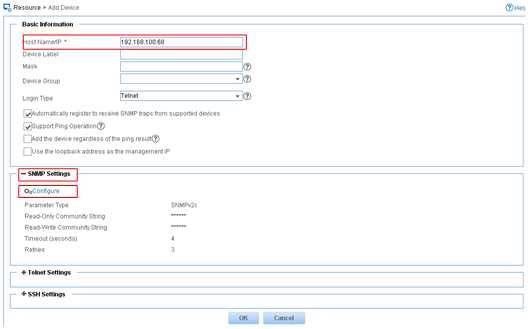

1.     Add the device (SNMP agent) to the IMC:
a.     Click the Resource tab.
b.     From the navigation tree, select Resource Management > Add Device.
c.     On the Add Device page, configure the following parameters:
-     Enter 192.168.100.68 in the Host Name/IP field.
-     Use the default values for other parameters.
Figure 2 Adding a device

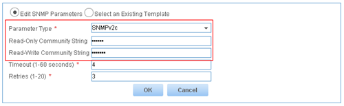

2.     Configure SNMP parameters:
a.     Expand the SNMP Settings area.
b.     Click Configure.
c.     On the page that appears, configure the following parameters:
-     Select SNMPv2c from the Parameter Type list.
-     Enter readtest in the Read-Only Community String field.
-     Enter writetest in the Read-Write Community String field.
-     Click OK.
Figure 3 Configuring SNMP parameters

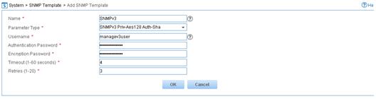

1.     Add an SNMP template:
a.     Click the System tab.
b.     From the navigation tree, select Resource Management > SNMP Template.
c.     On the SNMP Template page, click Add.
d.     On the Add SNMP Template page, configure the following parameters:
-     Enter SNMPv3 in the Name field.
-     Select SNMPv3 Priv-Aes128 Auth-Sha from the Parameter Type list.
-     Enter managev3user in the Username field.
-     Enter 123456TESTauth&! in the Authentication Password field.
-     Enter 123456TESTencr&! in the Encryption Password field.
-     Click OK.
Figure 6 Adding an SNMP template

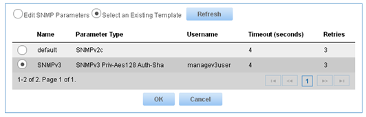

3.     Configure SNMP parameters:
b.     Click Configure.
c.     Select the Select an Existing Template option.
d.     Select template name SNMPv3.
e.     Click OK.
Figure 8 Selecting an existing template
