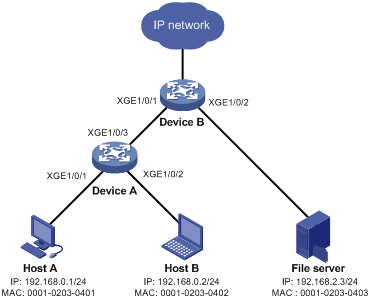

Example: Configuring static IPv4SG
As shown in Figure 1, Host A, Host B, and the file server use static IPv4 addresses.
Enable static IPv4SG and configure static IPSG bindings on Device A and Device B to meet the following requirements:
·     The interface Ten-GigabitEthernet 1/0/1 of Device A allows IP packets from Host A to pass.
·     All interfaces of Device A allow IP packets from Host B to pass.
·     The interface Ten-GigabitEthernet 1/0/1 of Device B allows only IP packets from Host A and Host B to pass.
·     The interface Ten-GigabitEthernet 1/0/2 of Device B allows only IP packets from the file server to pass.
Figure 1 Network diagram
Analysis
To meet the network requirements, you must perform the following tasks:
·     To allow IP packets from Host A to pass through Ten-GigabitEthernet 1/0/1 on Device A, configure a static IPSG binding for Host A on the interface.
·     To allow IP packets from Host B to pass through all interfaces on Device A, configure a global static IPSG binding for Host B.
·     To allow IP packets from both hosts to pass through Ten-GigabitEthernet 1/0/1 on Device B, configure static IPSG bindings for the hosts on the interface.
·     To allow only IP packets from the file server to pass through Ten-GigabitEthernet 1/0/2 on Device B, configure a static IPSG binding for the file server on the interface.
Software versions used
This configuration example was created and verified on S6860-CMW710-R2612.
IPSG does not use the VLAN information (if specified) in static IPSG bindings to filter packets.
Procedures
1.     Configure Device A:
# Create VLAN 10, and assign Ten-GigabitEthernet 1/0/1 through Ten-GigabitEthernet 1/0/3 to VLAN 10.
<DeviceA> system-view
[DeviceA] vlan 10
[DeviceA-vlan10] port ten-gigabitethernet 1/0/1 to ten-gigabitethernet 1/0/3
[DeviceA-vlan10] quit
# Create VLAN-interface 10, and assign an IP address to VLAN-interface 10.
[DeviceA] interface vlan-interface 10
[DeviceA-Vlan-interface10] ip address 192.168.0.10 255.255.255.0
[DeviceA-Vlan-interface10] quit
# Enable IPv4SG on Ten-GigabitEthernet 1/0/1 and GigabitEthernet 1/0/2.
[DeviceA] interface ten-gigabitethernet 1/0/2
[DeviceA-Ten-GigabitEthernet1/0/2] ip verify source ip-address mac-address
[DeviceA-Ten-GigabitEthernet1/0/2] quit
[DeviceA] interface ten-gigabitethernet 1/0/1
[DeviceA-Ten-GigabitEthernet1/0/1] ip verify source ip-address mac-address
# Configure a static IPSG binding for Host A on Ten-GigabitEthernet 1/0/1.
[DeviceA-Ten-GigabitEthernet1/0/1] ip source binding ip-address 192.168.0.1 mac-address 0001-0203-0401
[DeviceA-Ten-GigabitEthernet1/0/1] quit
# Configure a static IPSG binding for Host B.
[DeviceA] ip source binding ip-address 192.168.0.2 mac-address 0001-0203-0402
2.     Configure Device B:
# Create VLAN 10, and assign Ten-GigabitEthernet 1/0/1 to VLAN 10.
<DeviceB> system-view
[DeviceB] vlan 10
[DeviceB-vlan10] port ten-gigabitethernet 1/0/1
[DeviceB-vlan10] quit
[DeviceB] interface vlan-interface 10
[DeviceB-Vlan-interface10] ip address 192.168.0.100 255.255.255.0
[DeviceB-Vlan-interface10] quit
# Create VLAN 20, and assign Ten-GigabitEthernet 1/0/2 to VLAN 20.
[DeviceB] vlan 20
[DeviceB-vlan20] port ten-gigabitethernet 1/0/2
[DeviceB-vlan20] quit
# Create VLAN-interface 20, and assign an IP address to VLAN-interface 20.
[DeviceB] interface vlan-interface 20
[DeviceB-Vlan-interface20] ip address 192.168.2.100 255.255.255.0
[DeviceB-Vlan-interface20] quit
# Enable IPv4SG on Ten-GigabitEthernet 1/0/1.
[DeviceB] interface ten-gigabitethernet 1/0/1
[DeviceB-Ten-GigabitEthernet1/0/1] ip verify source ip-address mac-address
# Configure static IPSG bindings for Host A and Host B on Ten-GigabitEthernet 1/0/1.
[DeviceB-Ten-GigabitEthernet1/0/1] ip source binding ip-address 192.168.0.1 mac-address 0001-0203-0401
[DeviceB-Ten-GigabitEthernet1/0/1] ip source binding ip-address 192.168.0.2 mac-address 0001-0203-0402
[DeviceB-Ten-GigabitEthernet1/0/1] quit
# Enable IPSG on Ten-GigabitEthernet 1/0/2.
[DeviceB] interface ten-gigabitethernet 1/0/2
[DeviceB-Ten-GigabitEthernet1/0/2] ip verify source ip-address mac-address
# Configure a static IPSG binding for the file server on Ten-GigabitEthernet 1/0/2.
[DeviceB-Ten-GigabitEthernet1/0/2] ip source binding ip-address 192.168.2.3 mac-address 0001-0203-0403
[DeviceB-Ten-GigabitEthernet1/0/2] quit
# Verify that Host A can ping the IP addresses of Ten-GigabitEthernet 1/0/1 on both Device A and Device B. (Details not shown.)
# Verify that Host B can ping the IP addresses of all interfaces of Device A and Ten-GigabitEthernet 1/0/1 of Device B. (Details not shown.)
# Verify that the file server can ping the IP address of VLAN-interface 20 of Device B. (Details not shown.)
# Verify that Device A has static IPSG bindings for Host A and Host B.
[DeviceA] display ip source binding static
Total entries found: 2
IP Address      MAC Address    Interface                VLAN Type
192.168.0.2     0001-0203-0402 N/A                      N/A  Static
192.168.0.1     0001-0203-0401 XGE1/0/1                 N/A  Static
# Verify that Device B has static IPSG bindings for Host A, Host B, and the file server.
[DeviceB] display ip source binding static
Total entries found: 3
192.168.0.2     0001-0203-0402 XGE1/0/1                 N/A  Static
192.168.2.3     0001-0203-0403 XGE1/0/2                 N/A  Static
# Verify that Host B can ping Device A when Host B is connected to Device A through Ten-GigabitEthernet 1/0/1. (Details not shown.)
# Verify that Host B cannot ping Device A when Host B is assigned an IP address different from 192.168.0.2. (Details not shown.)
# Verify that Host A cannot ping Device A when any of following conditions exist (details not shown):
·     Host A is connected to Device A through Ten-GigabitEthernet 1/0/2 or Ten-GigabitEthernet 1/0/3.
·     Host A is assigned an IP address different from 192.168.0.1.

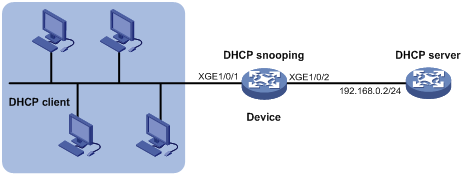

Example: Configuring dynamic IPv4SG based on DHCP snooping
As shown in Figure 2, the DHCP clients obtain IP addresses from the DHCP server.
·     Enable DHCP snooping on the device to make sure the DHCP clients obtain IP addresses from the authorized DHCP server.
·     Enable dynamic IPv4SG on Ten-GigabitEthernet 1/0/1 to filter incoming packets by using the IPSG bindings that are generated based on DHCP snooping entries. Only packets from the DHCP clients are allowed to pass.
Figure 2 Network diagram
Analysis
·     To enable the DHCP clients to obtain IP addresses from the DHCP server, configure Ten-GigabitEthernet 1/0/2 as the DHCP trusted port. By default, all ports are untrusted ports after DHCP snooping is enabled.
·     To generate DHCP snooping entries for the DHCP clients, enable recording of client information in DHCP snooping entries on Ten-GigabitEthernet 1/0/1. By default, recording of DHCP snooping entries is disabled.
Procedures
This example uses an S6860 switch as the DHCP server.
1.     Configure the DHCP server:
# Create VLAN-interface 1, and assign an IP address to VLAN-interface 1.
<DHCPserver> system-view
[DHCPserver] interface vlan-interface 1
[DHCPserver-Vlan-interface1] ip address 192.168.0.2 24
# Enable the DHCP server on VLAN-interface 1.
[DHCPserver-Vlan-interface1] dhcp select server
[DHCPserver-Vlan-interface1] quit
# Enable DHCP.
[DHCPserver] dhcp enable
# Create DHCP address pool 1.
[DHCPserver] dhcp server ip-pool 1
# Specify the assignable subnet as 192.168.0.0/24 and the address lease duration as 7 days.
[DHCPserver-dhcp-pool-1] network 192.168.0.0 24
[DHCPserver-dhcp-pool-1] expired day 7
[DHCPserver-dhcp-pool-1] quit
2.     Configure the device:
# Enable DHCP snooping.
<Device> system-view
[Device] dhcp snooping enable
# Configure Ten-GigabitEthernet 1/0/2 as a trusted port.
[Device] interface ten-gigabitethernet 1/0/2
[Device-Ten-GigabitEthernet1/0/2] dhcp snooping trust
[Device-Ten-GigabitEthernet1/0/2] quit
# Enable IPv4SG on Ten-GigabitEthernet 1/0/1 and verify the source IP address and MAC address for dynamic IPv4SG.
[Device] interface ten-gigabitethernet 1/0/1
[Device-Ten-GigabitEthernet1/0/1] ip verify source ip-address mac-address
# Enable recording of client information in DHCP snooping entries on Ten-GigabitEthernet 1/0/1.
[Device-Ten-GigabitEthernet1/0/1] dhcp snooping binding record
[Device-Ten-GigabitEthernet1/0/1] quit
3.     Configure the DHCP clients to use DHCP for IP address acquisition. (Details not shown.)
# Verify that the device has generated dynamic IPSG bindings for the clients based on DHCP snooping entries.
[Device] display ip source binding dhcp-snooping
Total entries found: 4
192.168.0.1     0001-0203-0401 XGE1/0/1                  1    DHCP snooping
192.168.0.3     0001-0203-0403 XGE1/0/1                  1    DHCP snooping
192.168.0.4     0001-0203-0404 XGE1/0/1                  1    DHCP snooping
192.168.0.5     0001-0203-0405 XGE1/0/1                  1    DHCP snooping
# Verify that the DHCP server can be pinged from the clients. (Details not shown.)
# Verify that the DHCP server cannot be pinged from the clients when the clients are assigned IP addresses manually. (Details not shown.)

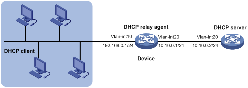

Example: Configuring dynamic IPv4SG based on DHCP relay agent
As shown in Figure 3, DHCP relay is enabled on the device. The DHCP clients obtain IP addresses from the DHCP server through the DHCP relay agent.
Enable dynamic IPv4SG on VLAN-interface 10 to filter incoming packets by using the dynamic IPSG bindings generated based on the DHCP relay entries.
Figure 3 Network diagram
Analysis
To generate DHCP relay entries for the DHCP clients, enable recording of relay entries on the delay agent. By default, the DHCP relay agent does not record client information in relay entries.
Procedures
[DHCPserver] interface vlan-interface 20
[DHCPserver-Vlan-interface20] ip address 10.10.0.2
# Enable the DHCP server on VLAN-interface 20.
[DHCPserver-Vlan-interface20] dhcp select server
[DHCPserver-Vlan-interface20] quit
# Enable DHCP.
# Configure a static route for the subnet where VLAN-interface 10 of the DHCP relay agent resides on the DHCP server.
[DHCPserver] ip route-static 192.168.0.0 24 10.10.0.1
[Device] vlan 10
[Device-vlan10] port ten-gigabitethernet 1/0/1
[Device-vlan10] quit
# Assign an IP address to VLAN-interface 10.
[Device] interface vlan-interface 10
[Device-Vlan-interface10] ip address 192.168.0.1 255.255.255.0
[Device-Vlan-interface10] quit
[Device] vlan 20
[Device-vlan20] port ten-gigabitethernet 1/0/2
[Device-vlan20] quit
# Assign an IP address to VLAN-interface 20.
[Device] interface vlan-interface 20
[Device-Vlan-interface20] ip address 10.10.0.1 255.255.255.0
[Device-Vlan-interface20] quit
# Enable DHCP.
[Device] dhcp enable
# Enable recording of relay entries on the delay agent.
[Device] dhcp relay client-information record
# Enable the DHCP relay agent on VLAN-interface 10.
[Device-Vlan-interface10] dhcp select relay
# Specify the IP address of the DHCP server on the relay agent.
[Device-Vlan-interface10] dhcp relay server-address 10.10.0.2
# Enable IPv4SG on VLAN-interface 10 and verify the source IP address and MAC address for dynamic IPSG.
[Device-Vlan-interface10] ip verify source ip-address mac-address
# Verify that the device has generated dynamic IPSG bindings for the clients based on DHCP relay entries.
<Device> display ip source binding dhcp-relay
192.168.0.2     0001-0203-0402 Vlan10                   10   DHCP relay
192.168.0.3     0001-0203-0403 Vlan10                   10   DHCP relay
192.168.0.4     0001-0203-0404 Vlan10                   10   DHCP relay
192.168.0.5     0001-0203-0405 Vlan10                   10   DHCP relay
Configuration files
 dhcp enable
vlan 10
vlan 20
interface Vlan-interface10
 dhcp select relay
interface Vlan-interface20
interface Ten-GigabitEthernet1/0/1
 port link-mode bridge
 port access vlan 10
interface Ten-GigabitEthernet1/0/2
 port access vlan 20
