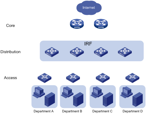

Example: Setting up a four-chassis LACP MAD-enabled IRF fabric

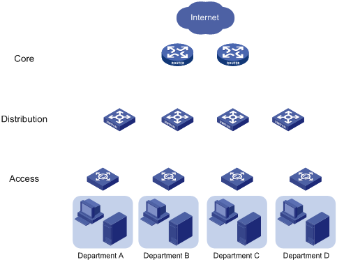

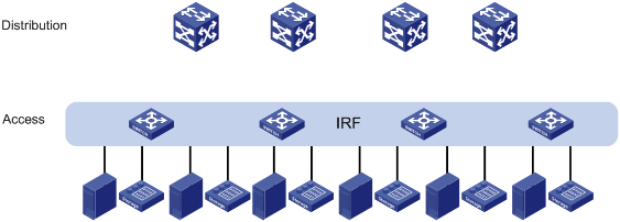

As shown in Figure 2, use a four-chassis IRF fabric to replace the ToR switches in Figure 1 at the access layer of the data center. The access-layer IRF fabric provides Layer 2 forwarding services.
Run LACP MAD to detect IRF split.
Figure 1 Network diagram before IRF deployment
Figure 2 Network diagram after IRF deployment

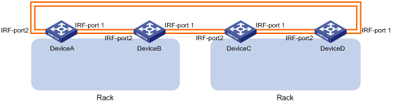

Topology
You can use a ring or daisy-chain topology for a three- or four-chassis IRF fabric.
For reliability, use the ring topology.
Ring topology (see Figure 3).

Figure 3 IRF fabric topology
Table 3 IRF physical interface bindings
IRF port
IRF physical interfaces
Device A:
IRF-port 1
FortyGigE 1/0/51
FortyGigE 1/0/52
IRF-port 2
FortyGigE 1/0/53
FortyGigE 1/0/54
Device B:
IRF-port 1
FortyGigE 2/0/51
FortyGigE 2/0/52
IRF-port 2
FortyGigE 2/0/53
FortyGigE 2/0/54
Device C:
IRF-port 1
FortyGigE 3/0/51
FortyGigE 3/0/52
IRF-port 2
FortyGigE 3/0/53
FortyGigE 3/0/54
Device D:
IRF-port 1
FortyGigE 4/0/51
FortyGigE 4/0/52
IRF-port 2
FortyGigE 4/0/53
FortyGigE 4/0/54

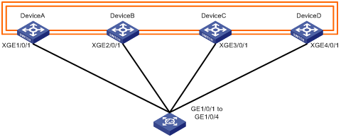

LACP MAD configuration
IMPORTANT
IMPORTANT:
For LACP MAD to run correctly, you must make sure the intermediate device supports extended LACPDUs for LACP MAD.

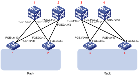

To run LACP MAD, the IRF fabric and intermediate device must each have a dynamic Ethernet link aggregation. LACP MAD cannot run on a static link aggregation.
If the intermediate device is also an IRF fabric, you must configure MAD for both IRF fabrics, and assign the two IRF fabrics different domain IDs for correct split detection. This example uses a four-chassis IRF fabric at the distribution layer. The access-layer and distribution-layer IRF fabrics are the intermediate device of each other, as shown in Figure 4.
In this example, each member in the access-layer IRF fabric has only two links to the distribution-layer IRF fabric. For high availability, you can connect each member in the access-layer IRF fabric to each member in the distribution-layer IRF fabric. After you aggregate these links, they are regarded as one link in the topology.
For quick split detection, assign high-speed ports for uplink aggregation connections. This example uses 40-GE ports.
Figure 4 LACP MAD

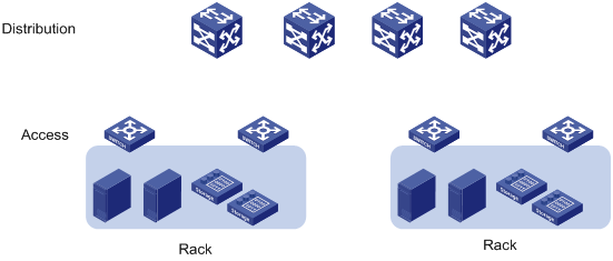

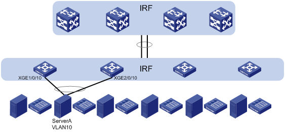

In a Layer 2 network, IRF is typically used with link aggregation to simplify the network topology.
For high availability, you can connect each host or server to two ToR switches in the access-layer IRF fabric, and aggregate the links. On each link aggregation, you do not need to run the spanning tree protocol feature because an IRF fabric appears as one node in the network.
For VLAN tags to be processed correctly, assign ports and aggregate interfaces to the correct VLANs.
A link aggregation could span one member device, some of the member devices, or all member devices, depending on the link redundancy requirements and number of available links. The link aggregation used for LACP MAD must span all member devices.
Figure 5 Connection diagram for the IRF fabrics in a Layer 2 network

# Connect Device C to Device B, as shown in Figure 3.
# Activate the IRF port configuration.
<DeviceC> system-view
[DeviceC] irf-port-configuration active
Device C reboots to join the IRF fabric. A three-chassis IRF fabric is formed.

# Connect Device D to Device A and Device C, as shown in Figure 3.
<DeviceD> system-view
[DeviceD] irf-port-configuration active
Device D reboots to join the IRF fabric. A four-chassis IRF fabric is formed. The command prompt changes to the name of Device A (the master).

1.     Configure the IRF fabric at the access layer:
# Assign domain ID 1 to the IRF fabric.
<IRF> system-view
[IRF] irf domain 1
# Create Bridge-Aggregation 2, set its aggregation mode to dynamic, and enable LACP MAD.
[IRF] interface bridge-aggregation 2
[IRF-Bridge-Aggregation2] link-aggregation mode dynamic
[IRF-Bridge-Aggregation2] mad enable
You need to assign a domain ID (range: 0-4294967295)
[Current domain is: 1]:
The assigned domain ID is: 1
Info: MAD LACP only enable on dynamic aggregation interface.
[IRF-Bridge-Aggregation2] quit
# Create a named interface range that contains uplink ports to the distribution layer IRF fabric. In this example, the interface range name is lacp, and each member device has two links to the distribution layer IRF fabric.
[IRF] interface range name lacp interface fortygige 1/0/49 to fortygige 1/0/50 fortygige 2/0/49 to fortygige 2/0/50 fortygige 3/0/49 to fortygige 3/0/50 fortygige 4/0/49 to fortygige 4/0/50
# Assign the ports in the interface range to Bridge-Aggregation 2.
[IRF-if-range-lacp] port link-aggregation group 2
[IRF-if-range-lacp] quit
2.     Configure the IRF fabric at the distribution layer:
# Assign IRF domain ID 2 to the IRF fabric.
<Sysname> system-view
[Sysname] irf domain 2
[Sysname] interface bridge-aggregation 2
[Sysname-Bridge-Aggregation2] link-aggregation mode dynamic
[Sysname-Bridge-Aggregation2] mad enable
[Current domain is: 2]:
The assigned domain ID is: 2
[Sysname-Bridge-Aggregation2] quit
# Assign the downlink ports that connect to the access-layer IRF fabric to Bridge-Aggregation 2.
[Sysname] interface fortygige 1/2/0/1
[Sysname-FortyGigE1/2/0/1] port link-aggregation group 2
[Sysname-FortyGigE1/2/0/1] quit
[Sysname] interface fortygige 1/3/0/1
[Sysname-FortyGigE1/3/0/1] port link-aggregation group 2
[Sysname-FortyGigE1/3/0/1] quit
[Sysname] interface fortygige 2/3/0/1
[Sysname-FortyGigE2/3/0/1] port link-aggregation group 2
[Sysname-FortyGigE2/3/0/1] quit
[Sysname] interface fortygige 2/4/0/2
[Sysname-FortyGigE2/4/0/2] port link-aggregation group 2
[Sysname-FortyGigE2/4/0/2] quit
[Sysname] interface fortygige 3/4/0/1
[Sysname-FortyGigE3/4/0/1] port link-aggregation group 2
[Sysname-FortyGigE3/4/0/1] quit
[Sysname] interface fortygige 3/3/0/2
[Sysname-FortyGigE3/3/0/2] port link-aggregation group 2
[Sysname-FortyGigE3/3/0/2] quit
[Sysname] interface fortygige 4/2/0/1
[Sysname-FortyGigE4/2/0/1] port link-aggregation group 2
[Sysname-FortyGigE4/2/0/1] quit
[Sysname] interface fortygige 4/3/0/1
[Sysname-FortyGigE4/3/0/1] port link-aggregation group 2
[Sysname-FortyGigE4/3/0/1] quit
Configuring network connectivity settings
This section provides the VLAN and link aggregation configuration procedure for end devices (for example, a server in VLAN 10).
# Create VLAN 10.
<IRF> system-view
[IRF] vlan 10
# Create Bridge-Aggregation 3, and set its aggregation mode to dynamic.
[IRF] interface bridge-aggregation 3
[IRF-Bridge-Aggregation3] link-aggregation mode dynamic
[IRF-Bridge-Aggregation3] quit
# Assign Ten-GigabitEthernet 1/0/10 and Ten-GigabitEthernet 2/0/10 to the aggregation group for Bridge-Aggregation 3.
[IRF] interface ten-gigabitethernet 1/0/10
[IRF-Ten-GigabitEthernet1/0/10] port link-aggregation group 3
[IRF-Ten-GigabitEthernet1/0/10] quit
[IRF] interface ten-gigabitethernet 2/0/10
[IRF-Ten-GigabitEthernet2/0/10] port link-aggregation group 3
[IRF-Ten-GigabitEthernet2/0/10] quit
# Assign Bridge-Aggregation 3 to VLAN 10.
[IRF-Bridge-Aggregation3] port access vlan 10
# Configure Bridge-Aggregation 2 as a trunk port, and assign it to VLAN 10.
[IRF-Bridge-Aggregation2] port link-type trunk
[IRF-Bridge-Aggregation2] port trunk permit vlan 10

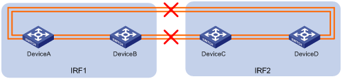

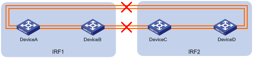

Verifying the LACP MAD configuration
# As shown in Figure 6, disconnect two IRF connections: one between Device A and Device D, and the other between Device B and Device C. The disconnect actions cause the IRF fabric to break up into two parts.
Figure 6 IRF split
# Observe the output messages to verify that LACP MAD takes the following actions:
·     Changes IRF 2 (Device C and Device D) to the Recovery state, because the master device in IRF 1 has a lower member ID than the master device in IRF 2.
·     Shuts down all service interfaces on Device C and Device D, except for the IRF physical interfaces and the service interfaces excluded from the MAD shutdown action.
The following is the sample output on IRF 1:
%Jan  1 05:19:10:176 2018 H3C STM/3/STM_LINK_STATUS_DOWN: IRF port 2 is down.
%Jan  1 05:19:10:184 2018 H3C IFNET/3/PHY_UPDOWN: FortyGigE1/0/53 link status is down.
%Jan  1 05:19:10:184 2018 H3C IFNET/3/PHY_UPDOWN: FortyGigE1/0/54 link status is down.
%Jan  1 05:19:10:176 2018 H3C STM/3/STM_LINK_STATUS_DOWN: IRF port 1 is down.
%Jan  1 05:19:10:184 2018 H3C IFNET/3/PHY_UPDOWN: FortyGigE2/0/51 link status is down.
%Jan  1 05:19:10:184 2018 H3C IFNET/3/PHY_UPDOWN: FortyGigE2/0/52 link status is down.
%Jan  1 05:19:10:186 2018 H3C DEV/3/BOARD_REMOVED: Board is removed from Slot 3, type is MAIN_BOARD_TYPE_54QT.
%Jan  1 05:19:10:186 2018 H3C DEV/3/BOARD_REMOVED: Board is removed from Slot 4, type is MAIN_BOARD_TYPE_54QT.
The following is the sample output from IRF 2:
%Jan  1 05:53:20:784 2018 H3C HA/5/HA_STANDBY_TO_MASTER: Standby board in slot 3 changes to master.
%Jan  1 05:53:20:831 2018 H3C DEV/3/BOARD_REMOVED: Board is removed from Slot 1, type is MAIN_BOARD_TYPE_54QT.
%Jan  1 05:53:20:831 2018 H3C DEV/3/BOARD_REMOVED: Board is removed from Slot 2, type is MAIN_BOARD_TYPE_54QT.
%Jan  1 05:53:20:860 2018 H3C DEV/1/MAD_DETECT: Multi-active devices detected, please fix it.
%Jan  1 05:53:20:886 2018 H3C IFNET/3/PHY_UPDOWN: M-GigabitEthernet0/0/0 link status is down.
%Jan  1 05:53:20:887 2018 H3C IFNET/5/LINK_UPDOWN: Line protocol on the interface M-GigabitEthernet0/0/0 is down.
%Jan  1 05:53:20:912 2018 H3C IFNET/3/PHY_UPDOWN: FortyGigE3/0/49 link status is down.
%Jan  1 05:53:20:914 2018 H3C IFNET/5/LINK_UPDOWN: Line protocol on the interface FortyGigE3/0/49 is down.
%Jan  1 05:53:20:912 2018 H3C IFNET/3/PHY_UPDOWN: FortyGigE3/0/50 link status is down.
%Jan  1 05:53:20:912 2018 H3C IFNET/3/PHY_UPDOWN: FortyGigE4/0/49 link status is down.
%Jan  1 05:53:20:912 2018 H3C IFNET/3/PHY_UPDOWN: FortyGigE4/0/50 link status is down.
The output shows that initially IRF 2 took over the master role because it falsely identified that IRF 1 has failed. LACP MAD shut down the service interfaces on IRF 2 after it detected an MAD conflict.
# If IRF 1 fails, use the mad restore command on IRF 2 to recover the member devices and bring up all service interfaces that have been shut down by LACP MAD.
You can log in to IRF 2 through the console port on Device C or Device D. If you have excluded a service interface from the MAD shutdown action, you can Telnet to IRF 2 through the service interface.
[Sysname] mad restore
This command will restore the device from multi-active conflict state. Continue? [Y/N]:y
Restoring from multi-active conflict state, please wait...
[Sysname]
%Jan  1 05:24:41:249 2018 H3C IFNET/3/PHY_UPDOWN: Ten-GigabitEthernet2/0/10 link status is up.
%Jan  1 05:24:41:249 2018 H3C IFNET/5/LINK_UPDOWN: Line protocol on the interface Ten-GigabitEthernet2/0/10 is up.
%Jan  1 05:24:41:325 2018 H3C IFNET/3/PHY_UPDOWN: FortyGigE2/0/49 link status is up.
%Jan  1 05:24:41:325 2018 H3C IFNET/3/PHY_UPDOWN: FortyGigE2/0/50 link status is up.

# Remove all IRF 1 and IRF link failures.
# After the link failure of IRF 1 is removed, the IRF ports recover. The following is the sample output on IRF 1:
%Jan  1 05:29:06:913 2018 H3C IFNET/3/PHY_UPDOWN: FortyGigE1/0/53 link status is up.
%Jan  1 05:29:06:914 2018 H3C IFNET/5/LINK_UPDOWN: Line protocol on the interface FortyGigE1/0/53 is up.
%Jan  1 05:29:06:913 2018 H3C IFNET/3/PHY_UPDOWN: FortyGigE1/0/54 link status is up.
%Jan  1 05:29:06:914 2018 H3C IFNET/5/LINK_UPDOWN: Line protocol on the interface FortyGigE1/0/54 is up.
%Jan  1 05:29:07:106 2018 H3C STM/6/STM_LINK_STATUS_UP: IRF port 2 is up.
%Jan  1 05:29:07:810 2018 H3C STM/4/STM_LINK_RECOVERY: Merge occurs.
IRF 2 reboots automatically to merge with IRF 1.

·     IRF fabric at the distribution layer:
 irf domain 2
 vlan10
interface Bridge-Aggregation2
 mad enable
interface FortyGigE1/2/0/1
 port link-mode bridge
interface FortyGigE1/3/0/1
interface FortyGigE2/3/0/1
interface FortyGigE2/4/0/2
interface FortyGigE3/3/0/2
interface FortyGigE3/4/0/1
interface FortyGigE4/2/0/1
interface FortyGigE4/3/0/1
Example: Setting up a four-chassis BFD MAD-enabled IRF fabric
As shown in Figure 8, set up a four-chassis IRF fabric to replace the switches at the distribution layer of the enterprise network (see Figure 7).
Use BFD MAD to detect IRF split.
The IRF fabric provides gateway services for servers and runs OSPF.
Figure 7 Network diagram before IRF deployment
Figure 8 Network diagram after IRF deployment

IRF setup
To set up an IRF fabric, determine the items in Table 4.
Table 4 Basic IRF setup
Item
Analysis
Choice in this example
Topology
Ring topology (see Figure 9).
Member ID assignment
IRF member IDs must be unique.
Device A—1.
Device B—2.
Device C—3.
Device D—4.
Master device
IRF members elect a master automatically. For a member device to be elected the master, assign it the highest member priority.
Device A.
IRF port bindings
Make sure the IRF port bindings are consistent with the physical connections.
For high availability, bind multiple physical interfaces to an IRF port. These ports will automatically aggregate for load balancing and redundancy.
See Table 5.
Figure 9 IRF fabric topology

BFD MAD configuration
You can deploy BFD MAD by using one of the following methods:
·     Connect all member devices with dedicated BFD MAD links into a full mesh topology. This method is suitable for two-chassis IRF fabrics.
·     Set up a dedicated BFD MAD link with an intermediate device for each IRF member device, as shown in Figure 10. This method is suitable for IRF fabrics that have more than two member devices, because it uses fewer physical interfaces than the previous method.
The intermediate device forwards BFD MAD packets transparently. You do not need to configure any special settings on the intermediate device except that you must assign all BFD MAD links to the VLAN used for BFD MAD.
Figure 10 BFD MAD connection diagram

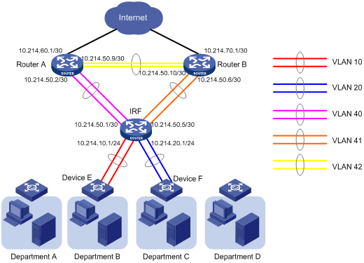

Network connectivity configuration
IRF is typically used with link aggregation to simplify the network topology. For high availability, set up multichassis link aggregations with the downstream switches and the upstream egress routers, as shown in Figure 11. The figure uses a single device to represents the four-chassis IRF fabric.
A link aggregation could span one member device, some of the member devices, or all member devices, depending on the link redundancy requirements and number of available links. Because this example does not use LACP MAD, the link aggregation mode can be dynamic or static. This example uses dynamic aggregation mode for all link aggregations.
To use the IRF fabric as the gateway for servers, you must configure VLAN interfaces to provide gateway services, as shown in Table 6.
To use the IRF fabric in a Layer 3 network, you must configure routing. In this example, OSPF is configured.
Figure 11 Connection diagram for the IRF fabric in a Layer 3 network
Table 6 Link aggregations and VLAN assignment scheme
Aggregate interface
Member ports
VLANs
VLAN interface's IP address
Router A:
Bridge-Aggregation 40
Ten-GigabitEthernet 1/0/2
Ten-GigabitEthernet 1/0/3
Ten-GigabitEthernet 1/0/4
VLAN 40
10.214.50.2/30
Bridge-Aggregation 42
Ten-GigabitEthernet 1/0/5
Ten-GigabitEthernet 1/0/6
VLAN 42
10.214.50.9/30
Router B:
Bridge-Aggregation 41
VLAN 41
10.214.50.6/30
VLAN 42
10.214.50.10/30
IRF fabric:
Bridge-Aggregation 10
Ten-GigabitEthernet 3/0/10
Ten-GigabitEthernet 4/0/10
VLAN 10
10.214.10.1/24
Bridge-Aggregation 20
Ten-GigabitEthernet 1/0/11
Ten-GigabitEthernet 2/0/11
Ten-GigabitEthernet 3/0/11
Ten-GigabitEthernet 4/0/11
VLAN 20
10.214.20.1/24
Ten-GigabitEthernet 1/0/13
Ten-GigabitEthernet 2/0/13
Ten-GigabitEthernet 3/0/13
Ten-GigabitEthernet 4/0/13
VLAN 40
10.214.50.1/30
Ten-GigabitEthernet 1/0/14
Ten-GigabitEthernet 2/0/14
Ten-GigabitEthernet 3/0/14
Ten-GigabitEthernet 4/0/14
VLAN 41
10.214.50.5/30
Device E:
Ten-GigabitEthernet 1/0/49
Ten-GigabitEthernet 1/0/50
Ten-GigabitEthernet 1/0/51
Ten-GigabitEthernet 1/0/52
VLAN 10
No VLAN interface is required.
Device F:
VLAN 20

# Connect Device C to Device B, as shown in Figure 9.
[DeviceC] irf-port-configuration active.

# Connect Device D to Device C and Device A, as shown in Figure 9.
Device D reboots to join the IRF fabric. A four-chassis IRF fabric is formed. The command prompt changes to the name of Device A.

Configuring BFD MAD
1.     Configure the IRF fabric:
# Create VLAN 1000 (BFD MAD VLAN).
<IRF> system-view
[IRF] vlan 1000
# Add all ports used for BFD MAD to the VLAN, including Ten-GigabitEthernet 1/0/1, Ten-GigabitEthernet 2/0/1, Ten-GigabitEthernet 3/0/1, and Ten-GigabitEthernet 4/0/1.
[IRF-vlan1000] port ten-gigabitethernet 1/0/1 ten-gigabitethernet 2/0/1 ten-gigabitethernet 3/0/1 ten-gigabitethernet 4/0/1
[IRF-vlan3] quit
# Create VLAN-interface 1000, and configure a MAD IP address for each member device on the interface.
[IRF] interface vlan-interface 1000
[IRF-Vlan-interface1000] mad bfd enable
[IRF-Vlan-interface1000] mad ip address 192.168.2.1 24 member 1
[IRF-Vlan-interface1000] mad ip address 192.168.2.2 24 member 2
[IRF-Vlan-interface1000] mad ip address 192.168.2.3 24 member 3
[IRF-Vlan-interface1000] mad ip address 192.168.2.4 24 member 4
[IRF-Vlan-interface1000] quit
# Disable the spanning tree feature on the ports in the BFD MAD VLAN.
[IRF-Ten-GigabitEthernet1/0/1] undo stp enable
[IRF-Ten-GigabitEthernet1/0/1] quit
[IRF-Ten-GigabitEthernet2/0/1] undo stp enable
[IRF-Ten-GigabitEthernet2/0/1] quit
[IRF] interface ten-gigabitethernet 3/0/1
[IRF-Ten-GigabitEthernet3/0/1] undo stp enable
[IRF-Ten-GigabitEthernet3/0/1] quit
[IRF] interface ten-gigabitethernet 4/0/1
[IRF-Ten-GigabitEthernet4/0/1] undo stp enable
[IRF-Ten-GigabitEthernet4/0/1] quit
2.     Configure the intermediate device:
[Sysname] vlan 1000
# Add all ports used for BFD MAD to the VLAN, including GigabitEthernet 1/0/1, GigabitEthernet 1/0/2, GigabitEthernet 1/0/3, and GigabitEthernet 1/0/4.
[Sysname-vlan1000] port gigabitethernet 1/0/1 gigabitethernet 1/0/2 gigabitethernet 1/0/3 gigabitethernet 1/0/4
[Sysname-vlan3] quit
This example only contains network connectivity configuration for Department B and Department C. The core router configuration does not include the connection to the public network.
1.     Configure Router A:
# Create VLANs 40 and 42.
<RouterA> system-view
[RouterA] vlan 40
[RouterA-vlan40] quit
[RouterA] vlan 42
[RouterA-vlan42] quit
# Create Bridge-Aggregation 40, and set its link aggregation mode to dynamic.
[RouterA] interface bridge-aggregation 40
[RouterA-Bridge-Aggregation40] link-aggregation mode dynamic
[RouterA-Bridge-Aggregation40] quit
# Assign Ten-GigabitEthernet 1/0/1, Ten-GigabitEthernet 1/0/2, Ten-GigabitEthernet 1/0/3, and Ten-GigabitEthernet 1/0/4 to the aggregation group for Bridge-Aggregation 40.
[RouterA] interface ten-gigabitethernet 1/0/1
[RouterA-Ten-GigabitEthernet1/0/1] port link-aggregation group 40
[RouterA-Ten-GigabitEthernet1/0/1] quit
[RouterA] interface ten-gigabitethernet 1/0/2
[RouterA-Ten-GigabitEthernet1/0/2] port link-aggregation group 40
[RouterA-Ten-GigabitEthernet1/0/2] quit
[RouterA] interface ten-gigabitethernet 1/0/3
[RouterA-Ten-GigabitEthernet1/0/3] port link-aggregation group 40
[RouterA-Ten-GigabitEthernet1/0/3] quit
[RouterA] interface ten-gigabitethernet 1/0/4
[RouterA-Ten-GigabitEthernet1/0/4] port link-aggregation group 40
[RouterA-Ten-GigabitEthernet1/0/4] quit
# Assign Bridge-Aggregation 40 to VLAN 40.
[RouterA-Bridge-Aggregation40] port access vlan 40
# Create Bridge-Aggregation 42, and set its link aggregation mode to dynamic.
[RouterA] interface bridge-aggregation 42
[RouterA-Bridge-Aggregation42] link-aggregation mode dynamic
[RouterA-Bridge-Aggregation42] quit
# Assign Ten-GigabitEthernet 1/0/5 and Ten-GigabitEthernet 1/0/6 to the aggregation group for Bridge-Aggregation 42.
[RouterA] interface ten-gigabitethernet 1/0/5
[RouterA-Ten-GigabitEthernet1/0/5] port link-aggregation group 42
[RouterA-Ten-GigabitEthernet1/0/5] quit
[RouterA] interface ten-gigabitethernet 1/0/6
[RouterA-Ten-GigabitEthernet1/0/6] port link-aggregation group 42
[RouterA-Ten-GigabitEthernet1/0/6] quit
# Assign Bridge-Aggregation 42 to VLAN 42.
[RouterA-Bridge-Aggregation42] port access vlan 42
# Create VLAN-interface 40 and VLAN-interface 42, and assign IP addresses to the VLAN interfaces.
[RouterA] interface vlan-interface 40
[RouterA-Vlan-interface40] ip address 10.214.50.2 30
[RouterA-Vlan-interface40] quit
[RouterA] interface vlan-interface 42
[RouterA-Vlan-interface42] ip address 10.214.50.9 30
[RouterA-Vlan-interface42] quit
# Configure OSPF.
[RouterA] ospf
[RouterA-ospf-1] import-route direct
[RouterA-ospf-1] area 0
[RouterA-ospf-1-area-0.0.0.0] network 10.214.60.0 0.0.0.3
[RouterA-ospf-1-area-0.0.0.0] network 10.214.50.0 0.0.0.3
[RouterA-ospf-1-area-0.0.0.0] network 10.214.50.8 0.0.0.3
[RouterA-ospf-1-area-0.0.0.0] quit
[RouterA-ospf-1] quit
2.     Configure Router B:
# Create VLANs 41 and 42.
<RouterB> system-view
[RouterB] vlan 41 to 42
# Create Bridge-Aggregation 41, and set its link aggregation mode to dynamic.
[RouterB] interface bridge-aggregation 41
[RouterB-Bridge-Aggregation41] link-aggregation mode dynamic
[RouterB-Bridge-Aggregation41] quit
# Assign Ten-GigabitEthernet 1/0/1, Ten-GigabitEthernet 1/0/2, Ten-GigabitEthernet1/0/3, and Ten-GigabitEthernet 1/0/4 to the aggregation group for Bridge-Aggregation 41.
[RouterB] interface ten-gigabitethernet 1/0/1
[RouterB-Ten-GigabitEthernet1/0/1] port link-aggregation group 41
[RouterB-Ten-GigabitEthernet1/0/1] quit
[RouterB] interface ten-gigabitethernet 1/0/2
[RouterB-Ten-GigabitEthernet1/0/2] port link-aggregation group 41
[RouterB-Ten-GigabitEthernet1/0/2] quit
[RouterB] interface ten-gigabitethernet 1/0/3
[RouterB-Ten-GigabitEthernet1/0/3] port link-aggregation group 41
[RouterB-Ten-GigabitEthernet1/0/3] quit
[RouterB] interface ten-gigabitethernet 1/0/4
[RouterB-Ten-GigabitEthernet1/0/4] port link-aggregation group 41
[RouterB-Ten-GigabitEthernet1/0/4] quit
# Assign Bridge-Aggregation 41 to VLAN 41.
[RouterB-Bridge-Aggregation41] port access vlan 41
[RouterB] interface bridge-aggregation 42
[RouterB-Bridge-Aggregation42] link-aggregation mode dynamic
[RouterB-Bridge-Aggregation42] port access vlan 42
[RouterB-Bridge-Aggregation42] quit
[RouterB] interface ten-gigabitethernet 1/0/5
[RouterB-Ten-GigabitEthernet1/0/5] port link-aggregation group 42
[RouterB-Ten-GigabitEthernet1/0/5] quit
[RouterB] interface ten-gigabitethernet 1/0/6
[RouterB-Ten-GigabitEthernet1/0/6] port link-aggregation group 42
[RouterB-Ten-GigabitEthernet1/0/6] quit
# Create VLAN-interface 41 and VLAN-interface 42, and assign IP addresses to the VLAN interfaces.
[RouterB] interface vlan-interface 41
[RouterB-Vlan-interface41] ip address 10.214.50.6 30
[RouterB-Vlan-interface41] quit
[RouterB] interface vlan-interface 42
[RouterB-Vlan-interface42] ip address 10.214.50.10 30
[RouterB-Vlan-interface42] quit
# Configure OSPF.
[RouterB] ospf
[RouterB-ospf-1] import-route direct
[RouterB-ospf-1] area 0
[RouterB-ospf-1-area-0.0.0.0] network 10.214.70.0 0.0.0.3
[RouterB-ospf-1-area-0.0.0.0] network 10.214.50.0 0.0.0.3
[RouterB-ospf-1-area-0.0.0.0] network 10.214.50.8 0.0.0.3
[RouterB-ospf-1-area-0.0.0.0] quit
[RouterB-ospf-1] quit
3.     Configure the IRF fabric:
# Create VLANs 10, 20, 40, and 41.
<IRF> system-view
[IRF] vlan 10
[IRF-vlan10] quit
[IRF] vlan 20
[IRF-vlan20] quit
[IRF] vlan 40
[IRF-vlan40] quit
[IRF] vlan 41
[IRF-vlan41] quit
# Create Bridge-Aggregation 10, and set its link aggregation mode to dynamic.
[IRF] interface bridge-aggregation 10
[IRF-Bridge-Aggregation10] link-aggregation mode dynamic
[IRF-Bridge-Aggregation10] quit
# Assign Ten-GigabitEthernet 1/0/10, Ten-GigabitEthernet 2/0/10, Ten-GigabitEthernet 3/0/10, and Ten-GigabitEthernet 4/0/10 to the aggregation group for Bridge-Aggregation 10.
[IRF-Ten-GigabitEthernet1/0/10] port link-aggregation group 10
[IRF-Ten-GigabitEthernet2/0/10] port link-aggregation group 10
[IRF] interface ten-gigabitethernet 3/0/10
[IRF-Ten-GigabitEthernet3/0/10] port link-aggregation group 10
[IRF-Ten-GigabitEthernet3/0/10] quit
[IRF] interface ten-gigabitethernet 4/0/10
[IRF-Ten-GigabitEthernet4/0/10] port link-aggregation group 10
[IRF-Ten-GigabitEthernet4/0/10] quit
# Assign Bridge-Aggregation 10 to VLAN 10.
[IRF-Bridge-Aggregation10] port access vlan 10
# Repeat the previous Bridge-Aggregation 10 configuration steps to configure Bridge-Aggregation interfaces 20, 40, and 41, in compliance with the scheme in Table 6. (Details not shown.)
# Create interfaces for VLANs 10, 20, 40, and 41, and assign IP addresses to the interfaces.
[IRF-Vlan-interface10] ip address 10.214.10.1 24
[IRF-Vlan-interface10] quit
[IRF] interface vlan-interface 20
[IRF-Vlan-interface20] ip address 10.214.20.1 24
[IRF-Vlan-interface20] quit
[IRF] interface vlan-interface 40
[IRF-Vlan-interface40] ip address 10.214.50.1 30
[IRF-Vlan-interface40] quit
[IRF] interface vlan-interface 41
[IRF-Vlan-interface41] ip address 10.214.50.5 30
[IRF-Vlan-interface41] quit
# Configure OSPF.
[IRF] ospf
[IRF-ospf-1] import-route direct
[IRF-ospf-1] area 0
[IRF-ospf-1-area-0.0.0.0] network 10.214.10.0 0.0.0.255
[IRF-ospf-1-area-0.0.0.0] network 10.214.20.0 0.0.0.255
[IRF-ospf-1-area-0.0.0.0] network 10.214.50.0 0.0.0.3
[IRF-ospf-1-area-0.0.0.0] network 10.214.50.4 0.0.0.3
[IRF-ospf-1-area-0.0.0.0] quit
[IRF-ospf-1] quit
4.     Configure Device E:
[DeviceE] interface bridge-aggregation 10
[DeviceE-Bridge-Aggregation10] link-aggregation mode dynamic
[DeviceE-Bridge-Aggregation10] quit
# Assign Ten-GigabitEthernet 1/0/49, Ten-GigabitEthernet 1/0/50, Ten-GigabitEthernet 1/0/51, and Ten-GigabitEthernet 1/0/52 to the aggregation group for Bridge-Aggregation 10.
[DeviceE] interface ten-gigabitethernet 1/0/49
[DeviceE-Ten-GigabitEthernet1/0/49] port link-aggregation group 10
[DeviceE-Ten-GigabitEthernet1/0/49] quit
[DeviceE] interface ten-gigabitethernet 1/0/50

# Verify IRF fabric connectivity.
[IRF] display irf topology
Topology Info
               IRF-Port1                IRF-Port2
 MemberID    Link       neighbor      Link       neighbor    Belong To
 1           UP         2             UP         4           0cda-414a-859b
 2           UP         3             UP         1           0cda-414a-859b
 3           UP         4             UP         2           0cda-414a-859b
 4           UP         1             UP         3           0cda-414a-859b
The output shows that all the IRF links are in UP state. The four-chassis IRF fabric is established.
Verifying the routing configuration
# Verify that routes can be learned correctly.
[IRF] display ip routing-table
Routing Tables: Public
         Destinations : 13       Routes : 13
Destination/Mask        Proto  Pre  Cost         NextHop         Interface
10.214.10.0/24          Direct 0    0            10.214.10.1     Vlan10
10.214.10.1/32          Direct 0    0            127.0.0.1       InLoop0
10.214.20.0/24          Direct 0    0            10.214.20.1     Vlan20
10.214.20.1/32          Direct 0    0            127.0.0.1       InLoop0
10.214.50.0/30          Direct 0    0            10.214.50.1     Vlan40
10.214.50.1/32          Direct 0    0            127.0.0.1       InLoop0
10.214.50.4/30          Direct 0    0            10.214.50.5     Vlan41
10.214.50.5/32          Direct 0    0            127.0.0.1       InLoop0
10.214.50.8/30          OSPF   10   2            10.214.50.2     Vlan40
10.214.60.0/30          OSPF   10   2            10.214.50.2     Vlan40
10.214.70.0/30          OSPF   10   2            10.214.50.6     Vlan41
127.0.0.0/8             Direct 0    0            127.0.0.1       InLoop0
127.0.0.1/32            Direct 0    0            127.0.0.1       InLoop0
The output shows that the IRF fabric has learned routing information from the core routers correctly.
Verifying the link backup function of multichassis aggregations
# Ping 10.214.50.2 (Router A) from any server.
C:\Users>ping 10.214.50.2 –t
# On the IRF fabric, shut down Ten-GigabitEthernet 1/0/13, a member port of Bridge-Aggregation 40.
[IRF] interface ten-gigabitethernet 1/0/13
[IRF-Ten-GigabitEthernet1/0/13] shutdown
[IRF-Ten-GigabitEthernet1/0/13] quit
# Observe the output on the configuration terminal for the server.
Pinging 10.214.50.2 with 32 bytes of data:
Reply from 10.214.50.2: bytes=32 time=8ms TTL=127
Reply from 10.214.50.2: bytes=32 time=7ms TTL=127
Reply from 10.214.50.2: bytes=32 time=2ms TTL=127
Reply from 10.214.50.2: bytes=32 time=278ms TTL=127
The output shows that the address can be pinged after a short delay.
Verifying link failure protection of the ring topology
# Disconnect all IRF links between two IRF member devices. (Details not shown.)
# Verify that the IRF fabric operates correctly in daisy-chain topology. (Details not shown.)
Verifying the BFD MAD configuration
# Disconnect two IRF connections: one between Device A and Device D, and the other between Device B and Device C. The disconnect actions cause the IRF fabric to break down into two parts, as shown in Figure 12.
Figure 12 IRF split
# Verify that BFD MAD detects the split and displays IRF link state and member device failure messages. The following is the sample output from IRF 1:
%Jan  1 00:40:22:534 2018 H3C BFD/5/BFD_CHANGE_FSM: Sess[192.168.2.1/192.168.2.3, LD/RD:33/33, Interface:Vlan1000, SessType:Ctrl, LinkType:INET], Sta: DOWN->INIT, Diag: 0
%Jan  1 00:40:22:791 2018 H3C BFD/5/BFD_CHANGE_FSM: Sess[192.168.2.1/192.168.2.3, LD/RD:33/33, Interface:Vlan1000, SessType:Ctrl, LinkType:INET], Sta: INIT->UP, Diag: 0
%Jan  1 00:40:27:962 2018 H3C BFD/5/BFD_CHANGE_FSM: Sess[192.168.2.1/192.168.2.3, LD/RD:33/33, Interface:Vlan1000, SessType:Ctrl, LinkType:INET], Sta: UP->DOWN, Diag: 1
The output shows that the BFD session was up for a short time after the IRF split. Because the master device in IRF 1 has a lower member ID than the master device in IRF 2, BFD MAD then changed IRF 2 (Device C and Device D) to the Recovery state. The BFD session was down after BFD MAD shut down all service interfaces on Device C and Device D, except for the IRF physical interfaces and the service interfaces excluded from the MAD shutdown action.

 ip address 10.214.50.2 255.255.255.252
interface Vlan-interface42
 ip address 10.214.50.9 255.255.255.252
interface Ten-GigabitEthernet1/0/1
 port access vlan 40
interface Ten-GigabitEthernet1/0/2
 port access vlan 40
interface Ten-GigabitEthernet1/0/3
 port access vlan 40
interface Ten-GigabitEthernet1/0/4
 port access vlan 40
interface Ten-GigabitEthernet1/0/5
 port access vlan 42
interface Ten-GigabitEthernet1/0/6
 port access vlan 42
ospf 1
 area 0.0.0.0
·     Router B:
vlan 41
vlan 42
interface Bridge-Aggregation41
 port access vlan 41
interface Bridge-Aggregation42
 port access vlan 42
interface Vlan-interface41
 ip address 10.214.50.6 255.255.255.252
 ip address 10.214.50.10 255.255.255.252
 port access vlan 41
 port access vlan 41
 port access vlan 41
 port access vlan 41
 port access vlan 42
 port access vlan 42
ospf 1
 area 0.0.0.0
