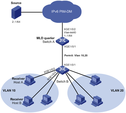

As shown in Figure 1:
·     VLAN 10 and VLAN 20 are Department 1 and Department 2, respectively.
·     VLAN-interface 10 and VLAN-interface 20 on Layer 3 device Switch A are the gateways of VLAN 10 and VLAN 20, respectively.
·     MLDv1 runs in VLAN 10 on Switch A, and MLDv1 snooping runs in VLAN 10 on Layer 2 device Switch B.
·     The source sends IPv6 multicast data to IPv6 multicast group FF1E::101.
·     Host A and Host B in VLAN 10 join IPv6 multicast group FF1E::101. They can receive the IPv6 multicast data that the source sends to the group.
Figure 1 Network diagram
Now, Host C and Host D in VLAN 20 also join the group to receive the IPv6 multicast data, as shown in Figure 2. You can enable MLDv1 for VLAN 20 on Switch A and MLDv1 snooping for VLAN 20 on Switch B. In this way, Host C and Host D can receive the data addressed to the group. However, this occupies a large amount of bandwidth and increases the burden on Switch A.
To avoid the problems, you can configure a sub-VLAN-based IPv6 multicast VLAN on Switch B.

5.     Configure VLAN 30 as an IPv6 multicast VLAN, and assign Ten-GigabitEthernet 1/0/1 through Ten-GigabitEthernet 1/0/5 to IPv6 multicast VLAN 30.
[SwitchB] ipv6 multicast-vlan 30
[SwitchB-ipv6-mvlan-30] port ten-gigabitethernet 1/0/2 to ten-gigabitethernet 1/0/5
[SwitchB-ipv6-mvlan-30] quit
# Display information about IPv6 multicast VLANs on Switch B.
[SwitchB] display ipv6 multicast-vlan
Total 1 IPv6 multicast VLANs.
IPv6 multicast VLAN 30:
  Sub-VLAN list(0 in total):
  Port list(4 in total):
    XGE1/0/2
    XGE1/0/3
    XGE1/0/4
    XGE1/0/5
# Display MLD snooping group entries for IPv6 multicast VLANs.
[SwitchB] display mld-snooping group
Total 1 entries.
VLAN 30: Total 1 entries.
  (::, FF1E::101)
    Host slots (0 in total):
    Host ports (4 in total):
      XGE1/0/2         (00:03:23)
      XGE1/0/3         (00:04:07)
      XGE1/0/4         (00:04:16)
      XGE1/0/5         (00:05:10)
The output shows that MLD snooping maintains the user ports in the multicast VLAN (VLAN 30). Switch B will forward the IPv6 multicast data of VLAN 10 through these user ports.
