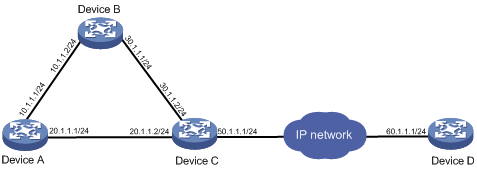

Example: Configuring an NQA ICMP echo operation
As shown in Figure 1, configure an NQA ICMP echo operation to test the roundtrip time between Device A and Device D through Device B.
Figure 1 Network diagram

The output shows that the packets sent by Device A can reach Device D through Device B. No packet loss occurs during the operation. The minimum, maximum, and average round-trip times are 2, 5, and 3 milliseconds, respectively.

Example: Configuring an NQA DHCP operation
As shown in Figure 3, configure an NQA DHCP operation to test the time required for Device A to obtain an IP address from the DHCP server (Device B).
Figure 3 Network diagram
Software versions used
This configuration example was created and verified on S6860-CMW710-R2612.

Example: Configuring an NQA UDP tracert operation
As shown in Figure 11, configure a UDP tracert operation to determine the routing path from Device A to Device B.
Figure 11 Network diagram
When you configure an NQA UDP tracert operation, follow these restrictions and guidelines:
·     Make sure the devices can reach each other before you start the NQA operation.
·     Configure Device B as the NQA server before you start the NQA UDP tracert operation.
·     You cannot modify the operation configuration for a running NQA operation.
Procedures
1.     Execute the ip ttl-expires enable command on the intermediate devices and execute the ip unreachables enable command on Device B. (Details not shown.)
2.     Configure Device A:
# Create a UDP tracert operation.
<DeviceA> system-view
[DeviceA] nqa entry admin test
[DeviceA-nqa-admin-test] type udp-tracert
# Specify 10.2.2.2 as the destination IP address for the operation.
[DeviceA-nqa-admin-test-udp-tracert] destination ip 10.2.2.2
# Set the destination port number to 33434. (This step is optional because it is the default setting.)
[DeviceA-nqa-admin-test-udp-tracert] destination port 33434
# Configure Device A to perform three probes to each hop.
[DeviceA-nqa-admin-test-udp-tracert] probe count 3
# Set the probe timeout time to 500 milliseconds.
[DeviceA-nqa-admin-test-udp-tracert] probe timeout 500
# Configure the UDP tracert operation to repeat every 5000 milliseconds.
[DeviceA-nqa-admin-test-udp-tracert] frequency 5000
# Specify M-GigabitEthernet 0/0/0 as the output interface for the probe packets.
[DeviceA-nqa-admin-test-udp-tracert] out interface m-gigabitethernet0/0/0
# Enable the no-fragmentation feature.
[DeviceA-nqa-admin-test-udp-tracert] no-fragment enable
# Set the maximum number of consecutive probe failures to 6.
[DeviceA-nqa-admin-test-udp-tracert] max-failure 6
# Set the TTL value to 1 for UDP packets in the start round of the UDP tracert operation.
[DeviceA-nqa-admin-test-udp-tracert] init-ttl 1
# Start the UDP tracert operation.
[DeviceA] nqa schedule admin test start-time now lifetime forever
# After the UDP tracert operation runs for a period of time, stop the operation.
# Display the most recent result of the UDP tracert operation.
[DeviceA] display nqa result admin test
NQA entry (admin admin, tag test) test results:
    Send operation times: 6              Receive response times: 6
    Min/Max/Average round trip time: 1/1/1
