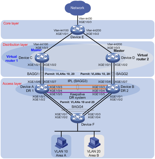

Example: Configuring DRNI at the access Layer
As shown in Figure 1:
·     Configure Device A and Device B as a DR system to establish one multichassis aggregate link with Device F and one with Device C and Device D.
·     Set up a keepalive link between Ten-GigabitEthernet 1/0/5 of Device A and Ten-GigabitEthernet 1/0/5 of Device B, and exclude the interfaces from the shutdown action by DRNI MAD.
·     Configure two VRRP groups on Device C and Device D to provide gateway services for VLAN 10 and VLAN 20.
¡     Configure VRRP group 1 to provide gateway services for hosts in VLAN 10 (Area A). Add Device C and Device D to the group as the master and backup devices, respectively.
¡     Configure VRRP group 2 to provide gateway services for hosts in VLAN 20 (Area B). Add Device D and Device C to the group as the master and backup devices, respectively.
·     Configure OSPF on Device C, Device D, and Device E for the hosts to communicate with external networks at Layer 3.
Figure 1 Network diagram
Device
Interface
IP address
Device
Interface
IP address
Device A
XGE 1/0/5
1.1.1.1/24
Device B
XGE1/0/5
1.1.1.2/24
Device C
VLAN-interface 100
100.1.1.1/24
Device D
VLAN-interface 100
200.1.1.1/24
VLAN-interface 10
10.1.1.1/24
VLAN-interface 10
10.1.1.2/24
VLAN-interface 20
20.1.1.1/24
VLAN-interface 20
20.1.1.2/24
Virtual IP 1
10.1.1.100/24
Virtual IP 1
10.1.1.100/24
Virtual IP 2
20.1.1.100/24
Virtual IP 2
20.1.1.100/24
Device E
VLAN-interface 100
100.1.1.2/24
VLAN-interface 200
200.1.1.2/24
VLAN-interface 30
30.1.1.1/24
Analysis
For the secondary DR device to monitor the state of the primary device, establish a Layer 3 keepalive link between the DR member devices.
To balance traffic between two VRRP gateway devices, you can assign them to two VRRP groups with different priorities. In this example, Device C is assigned a higher priority than Device D in VRRP group 1 so Device C can become the master in this group. Device D is assigned a higher priority than Device C in VRRP group 2 so Device D can become the master in this group.

Configuring Device A
# Configure DR system settings.
<DeviceA> system-view
[DeviceA] drni system-mac 1-1-1
Changing the system MAC might flap the intra-portal link and cause DR system setup failure. Continue? [Y/N]:y
[DeviceA] drni system-number 1
Changing the system number might flap the intra-portal link and cause DR system setup failure. Continue? [Y/N]:y
[DeviceA] drni system-priority 123
Changing the system priority might flap the intra-portal link and cause DR system setup failure. Continue? [Y/N]:y
# Configure DR keepalive packet parameters.
[DeviceA] drni keepalive ip destination 1.1.1.2 source 1.1.1.1
# Configure Ten-GigabitEthernet 1/0/5 as a routed (Layer 3) interface and assign the interface an IP address. The IP address will be used as the source IP address of keepalive packets.
[DeviceA] interface ten-gigabitethernet 1/0/5
[DeviceA-Ten-GigabitEthernet1/0/5] port link-mode route
[DeviceA-Ten-GigabitEthernet1/0/5] ip address 1.1.1.1 24
[DeviceA-Ten-GigabitEthernet1/0/5] quit
# Exclude the interface used for DR keepalive detection (Ten-GigabitEthernet 1/0/5) from the shutdown action by DRNI MAD.
[DeviceA] drni mad exclude interface ten-gigabitethernet 1/0/5
# Create VLAN 10 and VLAN 20.
[DeviceA] vlan 10
[DeviceA-vlan10] quit
[DeviceA] vlan 20
[DeviceA-vlan20] quit
# Create Layer 2 dynamic aggregate interface Bridge-Aggregation 1.
[DeviceA] interface bridge-aggregation 1
[DeviceA-Bridge-Aggregation1] link-aggregation mode dynamic
[DeviceA-Bridge-Aggregation1] quit
# Assign Ten-GigabitEthernet 1/0/6 and Ten-GigabitEthernet 1/0/7 to aggregation group 1.
[DeviceA] interface ten-gigabitethernet 1/0/6
[DeviceA-Ten-GigabitEthernet1/0/6] port link-aggregation group 1
[DeviceA-Ten-GigabitEthernet1/0/6] quit
[DeviceA] interface ten-gigabitethernet 1/0/7
[DeviceA-Ten-GigabitEthernet1/0/7] port link-aggregation group 1
[DeviceA-Ten-GigabitEthernet1/0/7] quit
# Set the link type of Bridge-Aggregation 1 to trunk and assign it to VLAN 10 and VLAN 20.
[DeviceA-Bridge-Aggregation1] port link-type trunk
Configuring Ten-GigabitEthernet1/0/6 done.
Configuring Ten-GigabitEthernet1/0/7 done.
[DeviceA-Bridge-Aggregation1] port trunk permit vlan 10 20
# Create Layer 2 dynamic aggregate interface Bridge-Aggregation 3 and specify it as the IPP.
[DeviceA] interface bridge-aggregation 3
[DeviceA-Bridge-Aggregation3] link-aggregation mode dynamic
[DeviceA-Bridge-Aggregation3] port drni intra-portal-port 1
[DeviceA-Bridge-Aggregation3] quit
# Assign Ten-GigabitEthernet 1/0/3 and Ten-GigabitEthernet 1/0/4 to aggregation group 3.
[DeviceA] interface ten-gigabitethernet 1/0/3
[DeviceA-Ten-GigabitEthernet1/0/3] port link-aggregation group 3
[DeviceA-Ten-GigabitEthernet1/0/3] quit
[DeviceA] interface ten-gigabitethernet 1/0/4
[DeviceA-Ten-GigabitEthernet1/0/4] port link-aggregation group 3
[DeviceA-Ten-GigabitEthernet1/0/4] quit
# Set the link type of Bridge-Aggregation 3 to trunk and assign it to VLAN 10 and VLAN 20.
[DeviceA-Bridge-Aggregation3] port link-type trunk
Configuring Ten-GigabitEthernet1/0/3 done.
Configuring Ten-GigabitEthernet1/0/4 done.
[DeviceA-Bridge-Aggregation3] port trunk permit vlan 10 20
# Create Layer 2 dynamic aggregate interface Bridge-Aggregation 4 and assign it to DR group 4.
[DeviceA] interface bridge-aggregation 4
[DeviceA-Bridge-Aggregation4] link-aggregation mode dynamic
[DeviceA-Bridge-Aggregation4] port drni group 4
[DeviceA-Bridge-Aggregation4] quit
# Assign Ten-GigabitEthernet 1/0/1 and Ten-GigabitEthernet 1/0/2 to aggregation group 4.
[DeviceA] interface ten-gigabitethernet 1/0/1
[DeviceA-Ten-GigabitEthernet1/0/1] port link-aggregation group 4
[DeviceA-Ten-GigabitEthernet1/0/1] quit
[DeviceA] interface ten-gigabitethernet 1/0/2
[DeviceA-Ten-GigabitEthernet1/0/2] port link-aggregation group 4
[DeviceA-Ten-GigabitEthernet1/0/2] quit
# Set the link type of Bridge-Aggregation 4 to trunk and assign it to VLAN 10 and VLAN 20.
[DeviceA-Bridge-Aggregation4] port link-type trunk
Configuring Ten-GigabitEthernet1/0/1 done.
Configuring Ten-GigabitEthernet1/0/2 done.
[DeviceA-Bridge-Aggregation4] port trunk permit vlan 10 20
[DeviceB-Bridge-Aggregation3] port trunk permit vlan 10 20
[DeviceB-Bridge-Aggregation3] quit
[DeviceB] interface bridge-aggregation 4
[DeviceB-Bridge-Aggregation4] link-aggregation mode dynamic
[DeviceB-Bridge-Aggregation4] port drni group 4
[DeviceB-Bridge-Aggregation4] quit
[DeviceB] interface ten-gigabitethernet 1/0/1
[DeviceB-Ten-GigabitEthernet1/0/1] port link-aggregation group 4
[DeviceB-Ten-GigabitEthernet1/0/1] quit
[DeviceB] interface ten-gigabitethernet 1/0/2
[DeviceB-Ten-GigabitEthernet1/0/2] port link-aggregation group 4
[DeviceB-Ten-GigabitEthernet1/0/2] quit
[DeviceB-Bridge-Aggregation4] port link-type trunk
[DeviceB-Bridge-Aggregation4] port trunk permit vlan 10 20
Configuring Device C
# Create VLAN 10, VLAN 20, and VLAN 100.
<DeviceC> system-view
[DeviceC] vlan 10
[DeviceC-vlan10] quit
[DeviceC] vlan 20
[DeviceC-vlan20] quit
[DeviceC] vlan 100
# Assign Ten-GigabitEthernet 1/0/3 to VLAN 100.
[DeviceC] vlan 100
[DeviceC-vlan100] port ten-gigabitethernet 1/0/3
[DeviceC-vlan100] quit
[DeviceC] interface bridge-aggregation 1
[DeviceC-Bridge-Aggregation1] link-aggregation mode dynamic
[DeviceC-Bridge-Aggregation1] quit
# Assign Ten-GigabitEthernet 1/0/1 and Ten-GigabitEthernet1/0/2 to aggregation group 1.
[DeviceC] interface range ten-gigabitethernet 1/0/1 to ten-gigabitethernet 1/0/2
[DeviceC-if-range] port link-aggregation group 1
[DeviceC-if-range] quit
[DeviceC-Bridge-Aggregation1] port link-type trunk
[DeviceC-Bridge-Aggregation1] port trunk permit vlan 10 20
# Create uplink interface VLAN-interface 100 and assign it an IP address.
[DeviceC] interface vlan-interface 100
[DeviceC-Vlan-interface100] ip address 100.1.1.1 24
[DeviceC-Vlan-interface100] quit
# Create VLAN-interface 10 and VLAN-interface 20 and assign an IP address to each of them.
[DeviceC-vlan-interface10] ip address 10.1.1.1 24
[DeviceC-vlan-interface10] quit
[DeviceC] interface vlan-interface 20
[DeviceC-vlan-interface20] ip address 20.1.1.1 24
[DeviceC-vlan-interface20] quit
# Create VRRP group 1 on VLAN-interface 10 and set its virtual IP address to 10.1.1.100.
[DeviceC-Vlan-interface10] vrrp vrid 1 virtual-ip 10.1.1.100
# Set the priority of Device C to 200 for it to become the master in VRRP group 1.
[DeviceC-Vlan-interface10] vrrp vrid 1 priority 200
[DeviceC-Vlan-interface10] quit
# Create VRRP group 2 on VLAN-interface 20 and set its virtual IP address to 20.1.1.100.
[DeviceC-Vlan-interface20] vrrp vrid 2 virtual-ip 20.1.1.100
# Configure Device C to operate in preemptive mode in VRRP group 1. Set the preemption delay to 500 centiseconds to avoid frequent status switchover.
[DeviceC-Vlan-interface10] vrrp vrid 1 preempt-mode delay 500
# Create track entry 1 to monitor the upstream link status of Ten-GigabitEthernet 1/0/3.
[DeviceC] track 1 interface ten-gigabitethernet 1/0/3
# Configure Device C in VRRP group 1 to monitor track entry 1, and decrease its priority by 150 when the track entry transits to Negative.
[DeviceC-Vlan-interface10] vrrp vrid 1 track 1 priority reduced 150
# Configure OSPF.
[DeviceC] ospf
[DeviceC-ospf-1] area 0
[DeviceC-ospf-1-area-0.0.0.0] network 10.1.1.0 0.0.0.255
[DeviceC-ospf-1-area-0.0.0.0] network 20.1.1.0 0.0.0.255
[DeviceC-ospf-1-area-0.0.0.0] network 100.1.1.0 0.0.0.255
[DeviceC-ospf-1-area-0.0.0.0] quit
[DeviceC-ospf-1] quit
Configuring Device D
# Create VLAN 10, VLAN 20, and VLAN 200.
<DeviceD> system-view
[DeviceD] vlan 10
[DeviceD-vlan10] quit
[DeviceD] vlan 20
[DeviceD-vlan20] quit
[DeviceD] vlan 200
# Assign Ten-GigabitEthernet 1/0/3 to VLAN 200.
[DeviceD] vlan 200
[DeviceD-vlan200] port ten-gigabitethernet 1/0/3
[DeviceD-vlan200] quit
# Create Layer 2 dynamic aggregate interface Bridge-Aggregation 2.
[DeviceD] interface bridge-aggregation 2
[DeviceD-Bridge-Aggregation2] link-aggregation mode dynamic
[DeviceD-Bridge-Aggregation2] quit
# Assign Ten-GigabitEthernet 1/0/1 and Ten-GigabitEthernet 1/0/2 to aggregation group 2.
[DeviceD] interface range ten-gigabitethernet 1/0/1 to ten-gigabitethernet 1/0/2
[DeviceD-if-range] port link-aggregation group 2
[DeviceD-if-range] quit
# Set the link type of Bridge-Aggregation 2 to trunk and assign it to VLAN 10 and VLAN 20.
[DeviceD-Bridge-Aggregation2] port link-type trunk
[DeviceD-Bridge-Aggregation2] port trunk permit vlan 10 20
# Create uplink interface VLAN-interface 200 and assign it an IP address.
[DeviceD] interface vlan-interface 200
[DeviceD-Vlan-interface200] ip address 200.1.1.1 24
[DeviceD-Vlan-interface200] quit
[DeviceD] interface vlan-interface 10
[DeviceD-vlan-interface10] ip address 10.1.1.2 24
[DeviceD-vlan-interface10] quit
[DeviceD-vlan-interface20] ip address 20.1.1.2 24
[DeviceD-vlan-interface20] quit
[DeviceD-Vlan-interface10] vrrp vrid 1 virtual-ip 10.1.1.100
[DeviceD-Vlan-interface20] vrrp vrid 2 virtual-ip 20.1.1.100
# Set the priority of Device D to 200 for it to become the master in VRRP group 2.
[DeviceD-Vlan-interface20] vrrp vrid 2 priority 200
# Configure Device D to operate in preemptive mode in VRRP group 2. Set the preemption delay to 500 centiseconds to avoid frequent status switchover.
[DeviceD-Vlan-interface20] vrrp vrid 2 preempt-mode delay 500
[DeviceD-Vlan-interface20] quit
# Create track entry 2 to monitor the upstream link status of Ten-GigabitEthernet 1/0/3.
[DeviceD] track 2 interface ten-gigabitethernet 1/0/3
# Configure Device D in VRRP group 2 to monitor track entry 2, and decrease its priority by 150 when the track entry transits to Negative.
[DeviceD-Vlan-interface20] vrrp vrid 2 track 2 priority reduced 150
# Configure OSPF.
[DeviceD] ospf
[DeviceD-ospf-1] area 0
[DeviceD-ospf-1-area-0.0.0.0] network 10.1.1.0 0.0.0.255
[DeviceD-ospf-1-area-0.0.0.0] network 20.1.1.0 0.0.0.255
[DeviceD-ospf-1-area-0.0.0.0] network 200.1.1.0 0.0.0.255
[DeviceD-ospf-1-area-0.0.0.0] quit
[DeviceD-ospf-1] quit
Configuring Device E
# Create VLAN 100 and assign Ten-GigabitEthernet 1/0/1 to the VLAN.
<DeviceE> system-view
[DeviceE] vlan 100
[DeviceE-vlan100] port ten-gigabitethernet 1/0/1
[DeviceE-vlan100] quit
# Create VLAN-interface 100 and assign it an IP address.
[DeviceE] interface vlan-interface 100
[DeviceE-vlan-interface100] ip address 100.1.1.2 24
[DeviceE-vlan-interface100] quit
# Create VLAN 200 and assign Ten-GigabitEthernet 1/0/2 to the VLAN.
[DeviceE] vlan 200
[DeviceE-vlan200] port ten-gigabitethernet 1/0/2
[DeviceE-vlan200] quit
# Create VLAN-interface 200 and assign it an IP address.
[DeviceE] interface vlan-interface 200
[DeviceE-vlan-interface200] ip address 200.1.1.2 24
[DeviceE-vlan-interface200] quit
# Create VLAN 30 and assign Ten-GigabitEthernet 1/0/3 to the VLAN.
[DeviceE] vlan 30
[DeviceE-vlan30] port ten-gigabitethernet 1/0/3
[DeviceE-vlan30] quit
# Create VLAN-interface 30 and assign it an IP address.
[DeviceE] interface vlan-interface 30
[DeviceE-vlan-interface30] ip address 30.1.1.1 24
[DeviceE-vlan-interface30] quit
# Configure OSPF.
[DeviceD] ospf
[DeviceD-ospf-1-area-0.0.0.0] network 100.1.1.0 0.0.0.255
[DeviceD-ospf-1-area-0.0.0.0] network 30.1.1.0 0.0.0.255
Configuring Device F
[DeviceF] vlan 10
[DeviceF-vlan10] quit
[DeviceF] vlan 20
[DeviceF-vlan20] quit
# Create Layer 2 dynamic aggregate interface Bridge-Aggregation 4.
[DeviceF] interface bridge-aggregation 4
[DeviceF-Bridge-Aggregation4] link-aggregation mode dynamic
[DeviceF-Bridge-Aggregation4] quit
# Assign Ten-GigabitEthernet 1/0/1 through Ten-GigabitEthernet 1/0/4 to aggregation group 4.
[DeviceF] interface range ten-gigabitethernet 1/0/1 to ten-gigabitethernet 1/0/4
[DeviceF-if-range] port link-aggregation group 4
[DeviceF-if-range] quit
[DeviceF-Bridge-Aggregation4] port link-type trunk
[DeviceF-Bridge-Aggregation4] port trunk permit vlan 10 20
# Verify that Device A and Device B have formed a DR system.
[DeviceA] display drni summary
Global consistency check           : SUCCESS
Inconsistent type 1 global settings: -
IPP             IPP ID        State
BAGG3           1             UP
DR interface    DR group ID   State    Check result   Type 1 inconsistency
BAGG4           4             UP       SUCCESS        -
[DeviceA] display drni verbose
Flags: A -- Home_Gateway, B -- Neighbor_Gateway, C -- Other_Gateway,
       D -- IPP_Activity, E -- DRCP_Timeout, F -- Gateway_Sync,
       G -- Port_Sync, H -- Expired
IPP/IPP ID: BAGG3/1
State: UP
Local state/Peer state: ABDFG/ABDFG
Local Selected ports Index: 2, 5
Peer Selected ports Index: 2, 5
DR interface/DR group ID: BAGG4/4
State: UP
Local Selected ports Index: 16385, 16388
Peer Selected ports Index: 32769, 32772
# Verify that all member ports of aggregation group 4 are in Selected state on Device F, which indicates a successful link aggregation between the DR system and Device F.
[DeviceF] display link-aggregation verbose
Loadsharing Type: Shar -- Loadsharing, NonS -- Non-Loadsharing
Port Status: S -- Selected, U -- Unselected, I -- Individual
Port: A -- Auto port, M -- Management port, R -- Reference port
Flags:  A -- LACP_Activity, B -- LACP_Timeout, C -- Aggregation,
        G -- Defaulted, H -- Expired
Aggregate Interface: Bridge-Aggregation4
Aggregation Mode: Dynamic
Management VLANs: None
System ID: 0x8000, 1eba-3c46-0300
Local:
  Port                Status   Priority Index    Oper-Key               Flag
  XGE1/0/1            S        32768    1        1                      {ACDEF}
  XGE1/0/2            S        32768    2        1                      {ACDEF}
  XGE1/0/3            S        32768    3        1                      {ACDEF}
  XGE1/0/4            S        32768    4        1                      {ACDEF}
Remote:
  Actor               Priority Index    Oper-Key SystemID               Flag
  XGE1/0/1(R)         32768    16385    40004    0x7b  , 0001-0001-0001 {ACDEF}
  XGE1/0/2            32768    16388    40004    0x7b  , 0001-0001-0001 {ACDEF}
  XGE1/0/3            32768    32769    40004    0x7b  , 0001-0001-0001 {ACDEF}
  XGE1/0/4            32768    32772    40004    0x7b  , 0001-0001-0001 {ACDEF}
# Verify that Device C is the master in VRRP group 1 and Device D is the master in VRRP group 2.
[DeviceC] display vrrp
IPv4 Virtual Router Information:
 Running mode : Standard
 Total number of virtual routers : 2
 Interface          VRID  State        Running Adver   Auth     Virtual
                                       Pri     Timer   Type        IP
 Vlan10             1     Master       200     100     None     10.1.1.100
 Vlan20             2     Backup       100     100     None     20.1.1.100
[DeviceD] display vrrp
                                       Pri     Timer   Type        IP
 Vlan10             1     Backup       100     100     None     10.1.1.100
 Vlan20             2     Master       200     100     None     20.1.1.100
# Verify that Device E has established OSPF neighbor relationships with Device C and Device D.
[DeviceE] display ospf peer
         OSPF Process 1 with Router ID 200.1.1.2
               Neighbor Brief Information
 Area: 0.0.0.0
 Router ID       Address         Pri Dead-Time  State             Interface
 100.1.1.1       100.1.1.1       1   35         Full/BDR          Vlan100
 200.1.1.1       200.1.1.1       1   33         Full/BDR          Vlan200
# Verify that the host in Area A can ping VLAN-interface 30 (30.1.1.1) on Device E.
C:\Documents and Settings\Administrator>ping 30.1.1.1
Pinging 30.1.1.1 with 32 bytes of data:
Reply from 30.1.1.1: bytes=32 time=1ms TTL=126
Ping statistics for 30.1.1.1:
Configuration files
·     Device A:
vlan 10
vlan 20
interface Bridge-Aggregation1
 port trunk permit vlan 1 10 20
interface Bridge-Aggregation3
interface Bridge-Aggregation4
 port drni group 4
interface Ten-GigabitEthernet1/0/5
 ip address 1.1.1.1 255.255.255.0
interface Ten-GigabitEthernet1/0/1
 port link-mode bridge
interface Ten-GigabitEthernet1/0/2
interface Ten-GigabitEthernet1/0/3
interface Ten-GigabitEthernet1/0/4
interface Ten-GigabitEthernet1/0/6
interface Ten-GigabitEthernet1/0/7
 drni system-mac 0001-0001-0001
 drni mad exclude interface Ten-GigabitEthernet1/0/5
·     Device B:
vlan 10
vlan 20
interface Bridge-Aggregation2
 port drni group 4
 ip address 1.1.1.2 255.255.255.0
 drni system-number 2
 drni keepalive ip destination 1.1.1.1 source 1.1.1.2
·     Device C:
ospf 1
 area 0.0.0.0
vlan 10
vlan 20
vlan 100
interface Vlan-interface10
interface Vlan-interface20
 ip address 20.1.1.1 255.255.255.0
interface Vlan-interface100
 ip address 100.1.1.1 255.255.255.0
 port access vlan 100
 track 1 interface Ten-GigabitEthernet1/0/3
·     Device D:
ospf 1
 area 0.0.0.0
vlan 10
vlan 20
vlan 200
 ip address 10.1.1.2 255.255.255.0
 ip address 20.1.1.2 255.255.255.0
interface Vlan-interface200
 ip address 200.1.1.1 255.255.255.0
 port access vlan 200
 track 2 interface Ten-GigabitEthernet1/0/3
·     Device E:
ospf 1
 area 0.0.0.0
  network 3.3.3.3 0.0.0.0
vlan 30
vlan 100
vlan 200
interface Vlan-interface30
 ip address 30.1.1.1 255.255.255.0
 ip address 100.1.1.2 255.255.255.0
 ip address 200.1.1.2 255.255.255.0
 port access vlan 30
·     Device F:
vlan 10
vlan 20

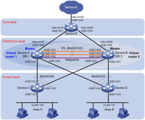

Example: Configuring DRNI at the distribution Layer
As shown in Figure 2:
·     Configure Device A and Device B as a DR system to establish one multichassis aggregate link with Device C and Device D.
·     Configure two VRRP groups on Device A and Device B to provide gateway services for VLAN 100 and VLAN 101.
¡     Configure VRRP group 1 to provide gateway services for hosts in VLAN 100 (Area A). Add Device A and Device B to the group as the master and backup devices, respectively.
¡     Configure VRRP group 2 to provide gateway services for hosts in VLAN 101 (Area B). Add Device B and Device A to the group as the master and backup devices, respectively.
·     Configure OSPF on Device A, Device B, and Device E for the hosts to communicate with external networks at Layer 3.
Figure 2 Network diagram
Device
Interface
IP address
Device
Interface
IP address
Device A
XGE 1/0/5
1.1.1.1/24
Device B
XGE 1/0/5
1.1.1.2/24
VLAN-interface 100
100.1.1.1/24
VLAN-interface 100
100.1.1.2/24
VLAN-interface 101
101.1.1.1/24
VLAN-interface 101
101.1.1.2/24
VLAN-interface 10
10.1.1.1/24
VLAN-interface 20
20.1.1.1/24
Virtual IP 1
100.1.1.100/24
Virtual IP 1
100.1.1.100/24
Virtual IP 2
101.1.1.100/24
Virtual IP 2
101.1.1.100/24
Device E
VLAN-interface 10
10.1.1.2/24
VLAN-interface 20
20.1.1.2/24
VLAN-interface 30
30.1.1.1/24
Analysis
For Device A to be the master in VRRP group 1, assign it a higher priority than Device B. For Device B to be the master in VRRP group 2, assign it a higher priority than Device A.
Software versions used
This configuration example was created and verified on S6860-CMW710-R2612.
DRNI restrictions and guidelines
For the DR member devices to be identified as one DR system, you must configure the same DR system MAC address and DR system priority on them. You must assign different DR system numbers to the DR member devices.
To balance traffic between two VRRP gateway devices, you can assign them to two VRRP groups with different priorities. In this example, Device A is assigned a higher priority than Device B in VRRP group 1 so Device A can become the master in this group. Device B is assigned a higher priority than Device A in VRRP group 2 so Device B can become the master in this group.
A DR member device can have only one IPP.
For correct keepalive detection, you must exclude the interfaces used for keepalive detection from the shutdown action by DRNI MAD.
VRRP restrictions and guidelines
You cannot specify the virtual IP address as any of the following IP addresses:
·     All-zero address (0.0.0.0).
·     Broadcast address (255.255.255.255).
·     Loopback address.
·     IP address of other than Class A, Class B, and Class C.
·     Invalid IP address (for example, 0.0.0.1).
The virtual IP address of an IPv4 VRRP group must be on the same subnet as the downlink interface IP addresses of the VRRP group members to ensure successful traffic forwarding.
Procedures
# Create Layer 2 dynamic aggregate interface Bridge-Aggregation 125 and specify it as the IPP.
[DeviceA] interface bridge-aggregation 125
[DeviceA-Bridge-Aggregation125] link-aggregation mode dynamic
[DeviceA-Bridge-Aggregation125] port drni intra-portal-port 1
[DeviceA-Bridge-Aggregation125] quit
# Assign Ten-GigabitEthernet 1/0/3 and Ten-GigabitEthernet 1/0/4 to aggregation group 125.
[DeviceA-Ten-GigabitEthernet1/0/3] port link-aggregation group 125
[DeviceA-Ten-GigabitEthernet1/0/4] port link-aggregation group 125
# Create Layer 2 dynamic aggregate interface Bridge-Aggregation 100 and assign it to DR group 1.
[DeviceA] interface bridge-aggregation 100
[DeviceA-Bridge-Aggregation100] link-aggregation mode dynamic
[DeviceA-Bridge-Aggregation100] port drni group 1
[DeviceA-Bridge-Aggregation100] quit
# Assign Ten-GigabitEthernet 1/0/1 to aggregation group 100.
[DeviceA-Ten-GigabitEthernet1/0/1] port link-aggregation group 100
# Create Layer 2 dynamic aggregate interface Bridge-Aggregation 101 and assign it to DR group 2.
[DeviceA] interface bridge-aggregation 101
[DeviceA-Bridge-Aggregation101] link-aggregation mode dynamic
[DeviceA-Bridge-Aggregation101] port drni group 2
[DeviceA-Bridge-Aggregation101] quit
# Assign Ten-GigabitEthernet 1/0/2 to aggregation group 101.
[DeviceA-Ten-GigabitEthernet1/0/2] port link-aggregation group 101
# Create VLAN 10, VLAN 100, and VLAN 101.
[DeviceA] vlan 10
[DeviceA] vlan 100
[DeviceA-vlan100] quit
[DeviceA] vlan 101
[DeviceA-vlan101] quit
# Assign Ten-GigabitEthernet 1/0/6 to VLAN 10.
[DeviceA] vlan 10
[DeviceA-vlan10] port ten-gigabitethernet 1/0/6
# Set the link type of Bridge-Aggregation 100 to trunk and assign it to VLAN 100.
[DeviceA-Bridge-Aggregation100] port link-type trunk
[DeviceA-Bridge-Aggregation100] port trunk permit vlan 100
# Set the link type of Bridge-Aggregation 101 to trunk and assign it to VLAN 101.
[DeviceA-Bridge-Aggregation101] port link-type trunk
[DeviceA-Bridge-Aggregation101] port trunk permit vlan 101
# Set the link type of Bridge-Aggregation 125 to trunk and assign it to VLAN 100 and VLAN 101.
[DeviceA-Bridge-Aggregation125] port link-type trunk
[DeviceA-Bridge-Aggregation125] port trunk permit vlan 100 101
# Create VLAN-interface 10, VLAN-interface 100, and VLAN-interface 101 and assign an IP address to each of them.
[DeviceA] interface vlan-interface 10
[DeviceA-vlan-interface10] ip address 10.1.1.1 24
[DeviceA-vlan-interface10] quit
[DeviceA] interface vlan-interface 100
[DeviceA-vlan-interface100] ip address 100.1.1.1 24
[DeviceA-vlan-interface100] quit
[DeviceA] interface vlan-interface 101
[DeviceA-vlan-interface101] ip address 101.1.1.1 24
[DeviceA-vlan-interface101] quit
# Configure OSPF.
[DeviceA] ospf
[DeviceA-ospf-1] area 0
[DeviceA-ospf-1-area-0.0.0.0] network 10.1.1.0 0.0.0.255
[DeviceA-ospf-1-area-0.0.0.0] network 100.1.1.0 0.0.0.255
[DeviceA-ospf-1-area-0.0.0.0] network 101.1.1.0 0.0.0.255
[DeviceA-ospf-1-area-0.0.0.0] quit
[DeviceA-ospf-1] quit
# Create VRRP group 1 on VLAN-interface 100 and set its virtual IP address to 100.1.1.100.
[DeviceA-Vlan-interface100] vrrp vrid 1 virtual-ip 100.1.1.100
# Set the priority of Device A to 200 for it to become the master in VRRP group 1.
[DeviceA-Vlan-interface100] vrrp vrid 1 priority 200
[DeviceA-Vlan-interface100] quit
# Create VRRP group 2 on VLAN-interface 101 and set its virtual IP address to 101.1.1.100.
[DeviceA-Vlan-interface101] vrrp vrid 2 virtual-ip 101.1.1.100
[DeviceA-Vlan-interface101] quit
# Configure Device A to operate in preemptive mode in VRRP group 1. Set the preemption delay to 500 centiseconds to avoid frequent status switchover.
[DeviceA-Vlan-interface100] vrrp vrid 1 preempt-mode delay 500
# Create track entry 1 to monitor the upstream link status of Ten-GigabitEthernet 1/0/6.
[DeviceA] track 1 interface ten-gigabitethernet 1/0/6
# Configure Device A in VRRP group 1 to monitor track entry 1, and decrease its priority by 150 when the track entry transits to Negative.
[DeviceA-Vlan-interface100] vrrp vrid 1 track 1 priority reduced 150
Configuring Device B
<DeviceB> system-view
[DeviceB] drni system-mac 1-1-1
[DeviceB] drni system-number 2
[DeviceB] drni system-priority 123
[DeviceB] drni keepalive ip destination 1.1.1.1 source 1.1.1.2
[DeviceB] interface ten-gigabitethernet 1/0/5
[DeviceB-Ten-GigabitEthernet1/0/5] port link-mode route
[DeviceB-Ten-GigabitEthernet1/0/5] ip address 1.1.1.2 24
[DeviceB-Ten-GigabitEthernet1/0/5] quit
[DeviceB] drni mad exclude interface ten-gigabitethernet 1/0/5
[DeviceB] interface bridge-aggregation 125
[DeviceB-Bridge-Aggregation125] link-aggregation mode dynamic
[DeviceB-Bridge-Aggregation125] port drni intra-portal-port 1
[DeviceB-Bridge-Aggregation125] quit
[DeviceB] interface ten-gigabitethernet 1/0/3
[DeviceB-Ten-GigabitEthernet1/0/3] port link-aggregation group 125
[DeviceB-Ten-GigabitEthernet1/0/3] quit
[DeviceB] interface ten-gigabitethernet 1/0/4
[DeviceB-Ten-GigabitEthernet1/0/4] port link-aggregation group 125
[DeviceB-Ten-GigabitEthernet1/0/4] quit
[DeviceB] interface bridge-aggregation 100
[DeviceB-Bridge-Aggregation100] link-aggregation mode dynamic
[DeviceB-Bridge-Aggregation100] port drni group 1
[DeviceB-Bridge-Aggregation100] quit
# Assign Ten-GigabitEthernet 1/0/2 to aggregation group 100.
[DeviceB-Ten-GigabitEthernet1/0/2] port link-aggregation group 100
[DeviceB] interface bridge-aggregation 101
[DeviceB-Bridge-Aggregation101] link-aggregation mode dynamic
[DeviceB-Bridge-Aggregation101] port drni group 2
[DeviceB-Bridge-Aggregation101] quit
# Assign Ten-GigabitEthernet 1/0/1 to aggregation group 101.
[DeviceB-Ten-GigabitEthernet1/0/1] port link-aggregation group 101
# Create VLAN 20, VLAN 100, and VLAN 101.
[DeviceB] vlan 20
[DeviceB-vlan20] quit
[DeviceB] vlan 100
[DeviceB-vlan100] quit
[DeviceB] vlan 101
[DeviceB-vlan101] quit
# Assign Ten-GigabitEthernet 1/0/6 to VLAN 20.
[DeviceB] vlan 20
[DeviceB-vlan20] port ten-gigabitethernet 1/0/6
[DeviceB-Bridge-Aggregation100] port link-type trunk
[DeviceB-Bridge-Aggregation100] port trunk permit vlan 100
[DeviceB-Bridge-Aggregation101] port link-type trunk
[DeviceB-Bridge-Aggregation101] port trunk permit vlan 101
[DeviceB-Bridge-Aggregation125] port link-type trunk
[DeviceB-Bridge-Aggregation125] port trunk permit vlan 100 101
# Create VLAN-interface 20, VLAN-interface 100, and VLAN-interface 101 and assign an IP address to each of them.
[DeviceB] interface vlan-interface 20
[DeviceB-vlan-interface20] ip address 20.1.1.1 24
[DeviceB-vlan-interface20] quit
[DeviceB] interface vlan-interface 100
[DeviceB-vlan-interface100] ip address 100.1.1.2 24
[DeviceB-vlan-interface100] quit
[DeviceB] interface vlan-interface 101
[DeviceB-vlan-interface101] ip address 101.1.1.2 24
[DeviceB-vlan-interface101] quit
# Configure OSPF.
[DeviceB] ospf
[DeviceB-ospf-1] area 0
[DeviceB-ospf-1-area-0.0.0.0] network 20.1.1.0 0.0.0.255
[DeviceB-ospf-1-area-0.0.0.0] network 100.1.1.0 0.0.0.255
[DeviceB-ospf-1-area-0.0.0.0] network 101.1.1.0 0.0.0.255
[DeviceB-ospf-1-area-0.0.0.0] quit
[DeviceB-ospf-1] quit
[DeviceB-Vlan-interface100] vrrp vrid 1 virtual-ip 100.1.1.100
[DeviceB-Vlan-interface100] quit
[DeviceB-Vlan-interface101] vrrp vrid 2 virtual-ip 101.1.1.100
# Set the priority of Device B to 200 for it to become the master in VRRP group 2.
[DeviceB-Vlan-interface101] vrrp vrid 2 priority 200
# Configure Device B to operate in preemptive mode in VRRP group 2. Set the preemption delay to 500 centiseconds to avoid frequent status switchover.
[DeviceB-Vlan-interface101] vrrp vrid 2 preempt-mode delay 500
[DeviceB-Vlan-interface101] quit
# Create track entry 2 to monitor the upstream link status of Ten-GigabitEthernet 1/0/6.
[DeviceB] track 2 interface ten-gigabitethernet 1/0/6
# Configure Device B in VRRP group 2 to monitor track entry 2, and decrease its priority by 150 when the track entry transits to Negative.
[DeviceB-Vlan-interface101] vrrp vrid 2 track 2 priority reduced 150
# Create VLAN 100.
[DeviceC] vlan 100
[DeviceC] interface ten-gigabitethernet 1/0/3
[DeviceC-Ten-GigabitEthernet1/0/3] port access vlan 100
[DeviceC-Ten-GigabitEthernet1/0/3] quit
# Create Layer 2 dynamic aggregate interface Bridge-Aggregation 100.
[DeviceC] interface bridge-aggregation 100
[DeviceC-Bridge-Aggregation100] link-aggregation mode dynamic
[DeviceC-Bridge-Aggregation100] quit
# Assign Ten-GigabitEthernet 1/0/1 and Ten-GigabitEthernet 1/0/2 to aggregation group 100.
[DeviceC-if-range] port link-aggregation group 100
[DeviceC-Bridge-Aggregation100] port link-type trunk
[DeviceC-Bridge-Aggregation100] port trunk permit vlan 100
# Create VLAN 101.
[DeviceD] vlan 101
[DeviceD-vlan101] quit
# Assign Ten-GigabitEthernet 1/0/3 to VLAN 101.
[DeviceD] interface ten-gigabitethernet 1/0/3
[DeviceD-Ten-GigabitEthernet1/0/3] port access vlan 101
[DeviceD-Ten-GigabitEthernet1/0/3] quit
# Create Layer 2 dynamic aggregate interface Bridge-Aggregation 101.
[DeviceD] interface bridge-aggregation 101
[DeviceD-Bridge-Aggregation101] link-aggregation mode dynamic
[DeviceD-Bridge-Aggregation101] quit
# Assign Ten-GigabitEthernet 1/0/1 and Ten-GigabitEthernet 1/0/2 to aggregation group 101.
[DeviceD-if-range] port link-aggregation group 101
[DeviceD-Bridge-Aggregation101] port link-type trunk
[DeviceD-Bridge-Aggregation101] port trunk permit vlan 101
# Create VLAN 10 and assign Ten-GigabitEthernet 1/0/1 to the VLAN.
[DeviceE] vlan 10
[DeviceE-vlan10] port ten-gigabitethernet 1/0/1
[DeviceE-vlan10] quit
# Create VLAN-interface 10 and assign it an IP address.
[DeviceE-vlan-interface10] ip address 10.1.1.2 24
[DeviceE-vlan-interface10] quit
# Create VLAN 20 and assign Ten-GigabitEthernet 1/0/2 to the VLAN.
[DeviceE] vlan 20
[DeviceE-vlan20] port ten-gigabitethernet 1/0/2
[DeviceE-vlan20] quit
# Create VLAN-interface 20 and assign it an IP address.
[DeviceE-vlan-interface20] ip address 20.1.1.2 24
[DeviceE-vlan-interface20] quit
[DeviceE] vlan 30
# Configure OSPF.
[DeviceE] ospf
IPP             IPP ID        State
BAGG125         1             UP
BAGG100         1             UP       SUCCESS        -
BAGG101         2             UP       SUCCESS        -
IPP/IPP ID: BAGG125/1
State: UP
Local Selected ports Index: 1, 4
Peer Selected ports Index: 1, 4
DR interface/DR group ID: BAGG100/1
State: UP
Local Selected ports Index: 16386
Peer Selected ports Index: 32771
DR interface/DR group ID: BAGG101/2
State: UP
Local Selected ports Index: 16387
Peer Selected ports Index: 32772
# Verify that all member ports of aggregation group 100 are in Selected state on Device C, which indicates a successful link aggregation between the DR system and Device C.
[DeviceC] display link-aggregation verbose
Aggregate Interface: Bridge-Aggregation100
System ID: 0x8000, 8e33-8e4a-0300
Local:
Remote:
  XGE1/0/1(R)         32768    16386    40001    0x7b  , 0001-0001-0001 {ACDEF}
  XGE1/0/2            32768    32770    40001    0x7b  , 0001-0001-0001 {ACDEF}
# Verify that all member ports of aggregation group 101 are in Selected state on Device D, which indicates a successful link aggregation between the DR system and Device D.
[DeviceD] display link-aggregation verbose
Aggregate Interface: Bridge-Aggregation101
System ID: 0x8000, 8e33-9400-0400
Local:
Remote:
  XGE1/0/1(R)         32768    16387    40002    0x7b  , 0001-0001-0001 {ACDEF}
  XGE1/0/2            32768    32771    40002    0x7b  , 0001-0001-0001 {ACDEF}
# Verify that Device A is the master in VRRP group 1 and Device B is the master in VRRP group 2.
[DeviceA] display vrrp
                                       Pri     Timer   Type        IP
 Vlan100            1     Master       200     100     None     100.1.1.100
 Vlan101            2     Backup       100     100     None     101.1.1.100
[DeviceB] display vrrp
                                       Pri     Timer   Type        IP
 Vlan100            1     Backup       100     100     None     100.1.1.100
 Vlan101            2     Master       200     100     None     101.1.1.100
# Verify that Device E has established OSPF neighbor relationships with Device A and Device B.
         OSPF Process 1 with Router ID 30.1.1.1
 Area: 0.0.0.0
 101.1.1.1       10.1.1.1        1   34         Full/DR           Vlan10
 101.1.1.2       20.1.1.1        1   36         Full/DR           Vlan20
# Verify that a host in Area A can ping the host at 101.1.1.4 in Area B.
C:\Documents and Settings\Administrator>ping 101.1.1.4
Pinging 101.1.1.4 with 32 bytes of data:
Reply from 101.1.1.4: bytes=32 time=1ms TTL=126
Ping statistics for 101.1.1.4:
# Verify that a host in Area A can ping VLAN-interface 30 (30.1.1.1) on Device E.
