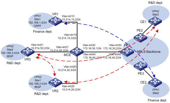

As shown in Figure 1, an enterprise has two MPLS L3VPNs. VPN 1 for the finance department uses static routes, and VPN 2 for the R&D department uses RIP routes. Site 1 of VPN 1 and Site 1 of VPN 2 are connected to the MPLS backbone through the same CE device (MCE). Site 2 of VPN 1 and Site 2 of VPN 2 are connected to the MPLS backbone through separate CEs (CE 1 and CE 2).
Configure the MCE to allow communication between the local and remote sites of the same VPN and isolate access between sites of different VPNs.
Configure the MCE and PE 1 to use OSPF to exchange VPN routes.
Figure 1 Network diagram

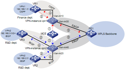

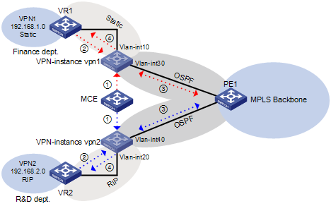

Analysis
To meet the network requirements, you must perform the following tasks:
1.     Create VPN instances on the MCE and PE 1, and bind each VPN instance to the interfaces that need to forward data for that VPN instance.
2.     Redistribute the VPN routes to the routing table of the corresponding VPN instance.
3.     Advertise the VPN routes to PE 1 through OSPF, and receive remote VPN routes from PE 1.
4.     Redistribute the remote VPN routes to the local VPN sites.
Figure 2 Network diagram

Example: Configuring the MCE to advertise VPN routes to the PE by using BGP (on switches)
As shown in Figure 3, an enterprise has two MPLS L3VPNs. VPN 1 for the finance department uses OSPF, and VPN 2 for the R&D department uses IBGP. Site 1 of VPN 1, Site 2 of VPN 2, and Site 1 of VPN 2 are connected to the MPLS backbone through the same CE device (MCE). Site 3 of VPN 2 and Site 2 of VPN 1 are connected to the MPLS backbone through separate CEs (CE 1 and CE 2).
Configure the MCE and PE 1 to use BGP to exchange VPN routes.

Analysis
IBGP requires a fully meshed network or a router reflector. In this example, you must configure the MCE as the IBGP route reflector.
3.     Advertise the VPN routes to PE 1 through EBGP, and receive remote VPN routes from PE 1.
