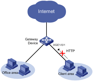

Example: Filtering packets by MAC address
As shown in Figure 1, the R&D department and the Administration department have video devices deployed. The video devices use MAC addresses prefixed with 000f-e2. Configure packet filtering on the device to allow outgoing video data to pass through only from 8:30 to 18:00 every day.
Figure 1 Network diagram
Analysis
Because the MAC addresses of the video devices are fixed, you can use an Ethernet frame header ACL to filter packets by MAC address. In the ACL, specify a MAC address and a mask to match the MAC addresses that have the same prefix.
Software versions used
This configuration example was created and verified on S6860-CMW710-R2612.

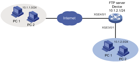

Example: Controlling FTP access
As shown in Figure 2, the device is an FTP server. Configure FTP access control on the device to meet the following requirements:
·     Users on subnet 10.1.2.0/24 can access the FTP server at any time.
·     Users on subnet 10.1.1.0/24 can access the FTP server during working hours (8:30 to 18:00) on working days (Monday to Friday).
·     Qualified users are assigned the level-15 user role.
Figure 2 Network diagram
Analysis
To meet the network requirements, you must perform the following tasks:
·     Configure two rules for the ACL. One rule permits packets from subnet 10.1.2.0/24. The other one permits packets from subnet 10.1.1.0/24 and takes effect only during working hours on working days.
·     Use the ACL to control access to the FTP server.

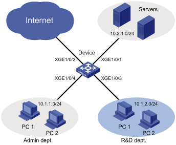

Example: Filtering packets by IP address
As shown in Figure 3, a company's internal network connects to the Internet through the device. The R&D department, Administration department, and servers are on different subnets.
Configure packet filtering to meet the following requirements:
·     The Administration department can access the Internet and servers at any time, but cannot access the R&D department at any time.
·     The R&D department can access only the servers during working hours (8:30 to 18:00) on working days (Monday to Friday). It can access the Internet and servers, but cannot access the Administration department outside working hours.
Figure 3 Network diagram
Analysis
·     To deny the Administration department to access the R&D department, perform the following tasks:
¡     Configure an advanced ACL to deny packets destined for subnet 10.1.2.0/24.
¡     Apply the ACL to filter incoming packets on Ten-GigabitEthernet 1/0/4.
·     To implement access control for the R&D department, perform the following tasks:
¡     Create a time range for the working hours (8:30 to 18:00) on working days (Monday to Friday).
¡     Create an advanced ACL and configure the following rules:
-     Configure rules to allow only packets destined for subnet 10.2.1.0/24 to pass through. Set the rules to be active during the time range.
-     To deny the R&D department to access the Administration department, configure a rule to deny packets destined for subnet 10.1.1.0/24.
¡     Apply the ACL to filter incoming packets on Ten-GigabitEthernet 1/0/3.
When you configure ACL rules to allow the R&D department to access only the servers during working hours on working days, configure the permit rule before the deny rule. Otherwise, the interface denies all packets during working hours on working days.

Configuration files
interface Ten-GigabitEthernet1/0/3
 port link-mode bridge
 packet-filter 3001 inbound
interface Ten-GigabitEthernet1/0/4
 packet-filter 3000 inbound
 time-range worktime 08:30 to 18:00 working-day
acl advanced 3000
 rule 0 deny ip destination 10.1.2.0 0.0.0.255
acl advanced 3001
 rule 0 permit ip destination 10.2.1.0 0.0.0.255 time-range worktime
 rule 5 deny ip time-range worktime
 rule 10 deny ip destination 10.1.1.0 0.0.0.255

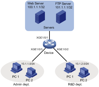

Example: Filtering TCP packets
As shown in Figure 4, the R&D department, Administration department, and servers are on different networks, and they are connected through the device.
·     The Web server provides HTTP services to only the Administration department.
·     The FTP server provides FTP services to only the R&D department.
·     The TCP connections between hosts and the Web server can only be initiated by the hosts. The TCP connections between hosts and the FTP server can be initiated by either the hosts or the FTP server.
Figure 4 Network diagram
Analysis
·     To allow TCP connections initiated by the hosts to the Web server, perform the following tasks:
¡     Configure an advanced ACL rule as follows to allow packets sent by the Web server through established TCP connections to pass through:
-     Specify the established keyword (the ACK or RST flag bit set) in the rule to match established TCP connections.
-     Because a TCP initiator typically uses a TCP port number higher than 1023, specify a port number range higher than 1023 to match established TCP connections.
¡     Configure an advanced ACL rule to deny packets sent from the subnet where the Web server resides to the subnet where the hosts reside.
·     FTP uses TCP port 20 for data transfer and port 21 for FTP control. To identify FTP traffic, you must specify TCP ports 20 and 21 in ACL rules.
·     To identify HTTP packets, specify TCP port 80 in ACL rules.
Procedures
Configuring access control for the Administration department
# Create IPv4 advanced ACL 3000.
<Device> system-view
[Device] acl advanced 3000
# Configure a rule to allow TCP packets from the Web server to the hosts on subnet 10.1.1.0/24, with TCP port number higher than 1023 and the ACK or RST flag set.
[Device-acl-ipv4-adv-3000] rule permit tcp established source 100.1.1.1 0 destination 10.1.1.0 0.0.0.255 destination-port gt 1023
# Configure a rule to deny TCP packets from subnet 100.1.1.1/32 to subnet 10.1.1.0/24 to pass through.
[Device-acl-ipv4-adv-3000] rule deny tcp source 100.1.1.1 0 destination 10.1.1.0 0.0.0.255
# Configure a rule to deny FTP packets sourced from 101.1.1.1/32 to pass through.
[Device-acl-ipv4-adv-3000] rule deny tcp source 101.1.1.1 0 source-port range 20 21
[Device-acl-ipv4-adv-3000] quit
# Apply ACL 3000 to filter outgoing packets on Ten-GigabitEthernet 1/0/3.
[Device] interface ten-gigabitethernet 1/0/3
[Device-Ten-GigabitEthernet1/0/3] packet-filter 3000 outbound
[Device-Ten-GigabitEthernet1/0/3] quit
Configuring access control for the R&D department
# Create IPv4 advanced ACL 3001.
[Device] acl advanced 3001
# Configure a rule to deny HTTP packets sourced from 100.1.1.1/32 to pass through.
[Device-acl-ipv4-adv-3001] rule deny tcp source 100.1.1.1 0 source-port eq 80
[Device-acl-ipv4-adv-3001] quit
# Apply ACL 3001 to filter outgoing packets on Ten-GigabitEthernet 1/0/2.
[Device] interface ten-gigabitethernet 1/0/2
[Device-Ten-GigabitEthernet1/0/2] packet-filter 3001 outbound
[Device-Ten-GigabitEthernet1/0/2] quit
1.     Verify that the ACLs are successfully applied for packet filtering.
[Device] display packet-filter interface outbound
Interface: Ten-GigabitEthernet1/0/2
 Outbound policy:
  IPv4 ACL 3001
Interface: Ten-GigabitEthernet1/0/3
 Outbound policy:
  IPv4 ACL 3000
2.     Verify that you cannot Telnet to the FTP server from the Administration department.
C:\>telnet 101.1.1.1 21
Connecting To 101.1.1.1...Could not open connection to the host, on port 21:
 Connect failed
C:\>
3.     Verify that from the Web server, you can ping a host in the Administration department, but cannot access a shared folder on the host:
# Set a shared folder on a host in the Administration department. (Details not shown.)
# Ping the host from the Web server. The ping operation succeeds.
C:\>ping 10.1.1.110
Pinging 10.1.1.110 with 32 bytes of data:
Reply from 10.1.1.110: bytes=32 time=2ms TTL=128
Reply from 10.1.1.110: bytes=32 time=14ms TTL=128
Reply from 10.1.1.110: bytes=32 time=1ms TTL=128
Ping statistics for 10.1.1.110:
    Minimum = 1ms, Maximum = 14ms, Average = 4ms
C:\>
# Verify that you cannot access the share folder from the Web server. (Details not shown.)
4.     Verify that you cannot Telnet to the Web server from the R&D department.
C:\>telnet 100.1.1.1 80
Connecting To 100.1.1.1...Could not open connection to the host, on port 80:
 Connect failed
C:\>
Configuration files
acl advanced 3000
 rule 0 permit tcp source 100.1.1.1 0 destination 10.1.1.0 0.0.0.255 destination
-port gt 1023 established
 rule 5 deny tcp source 100.1.1.1 0 destination 10.1.1.0 0.0.0.255
 rule 10 deny tcp source 101.1.1.1 0 source-port range ftp-data ftp
acl advanced 3001
 rule 0 deny tcp source 100.1.1.1 0 source-port eq www
Example: Filtering HTTP packets
As shown in Figure 5, configure packet filtering on the device to deny all HTTP requests from the client area.
Figure 5 Network diagram
Procedures
# Create user-defined ACL 5000.
[Device] acl user-defined 5000
# Configure a rule to deny HTTP requests to pass through.
[Device-acl-user-5000] rule deny l4 1f90 ffff 0
[Device-acl-user-5000] quit
# Apply ACL 5000 to the inbound direction of Ten-GigabitEthernet 1/0/1.
[Device] interface ten-gigabitethernet 1/0/1
[Device-Ten-GigabitEthernet1/0/1] packet-filter user-defined 5000 inbound
[Device-Ten-GigabitEthernet1/0/1] quit
# Verify that the ACL is successfully applied to Ten-GigabitEthernet 1/0/1.
[Device] display packet-filter interface inbound
Interface: Ten-GigabitEthernet1/0/1
 Inbound policy:
  User-defined ACL 5000
Configuration files
interface Ten-GigabitEthernet1/0/1
 rule 0 deny l4 1f90 ffff 0
