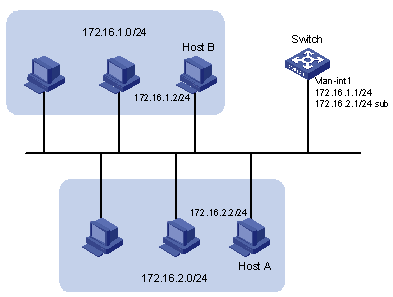

IP Address Configuration Example II
Network requirements
As shown in Figure 1-4, VLAN-interface 1 on Switch is connected to a LAN comprising two segments: 172.16.1.0/24 and 172.16.2.0/24.
To enable the hosts on the two network segments to communicate with the external network through Switch, and the hosts on the LAN can communicate with each other, do the following:
l Assign two IP addresses to VLAN-interface 1 on Switch.
l Set Switch as the gateway on all PCs of the two networks.
Figure 1-4 Network diagram for IP address configuration
Configuration procedure
# Assign a primary IP address and a secondary IP address to VLAN-interface 1.
<Switch> system-view
[Switch] interface vlan-interface 1
[Switch-Vlan-interface1] ip address 172.16.1.1 255.255.255.0
[Switch-Vlan-interface1] ip address 172.16.2.1 255.255.255.0 sub
# Set the gateway address to 172.16.1.1 on the PCs attached to the subnet 172.16.1.0/24, and to 172.16.2.1 on the PCs attached to the subnet 172.16.2.0/24.
# Ping a host on the subnet 172.16.1.0/24 from Switch to check the connectivity.

The output information shows that Switch can communicate with the hosts on the subnet 172.16.1.0/24.
# Ping a host on the subnet 172.16.2.0/24 from Switch to check the connectivity.

The output information shows that Switch can communicate with the hosts on the subnet 172.16.2.0/24.
