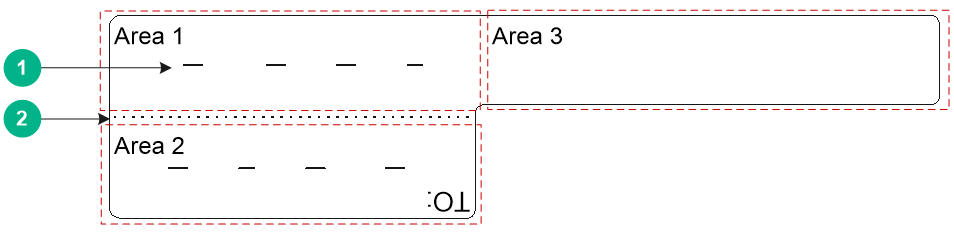

A label for network cables is L-shaped with fixed dimensions. The light-blue dividing lines on the label help to specify more clearly the position of the cable. For example, there is one dividing line between the rack number and the chassis number and another one between the chassis number and the slot number. The cut dotted line helps to fold the label when you affix it to the cable. A mark "TO:" is located at the lower right corner of the label to identify the peer end of the cable on which the label is affixed.
As shown in Figure 1, write a network cable label as follows:
· Write the position of the cable in Area 1.
· Write the position of the cable on the peer end in Area 2.
· Area 3 is the part that is folded up inside the label when the label is affixed to the cable.
Figure 1 Label for network cables
(1) Dividing line |
(2) Cut dotted line |

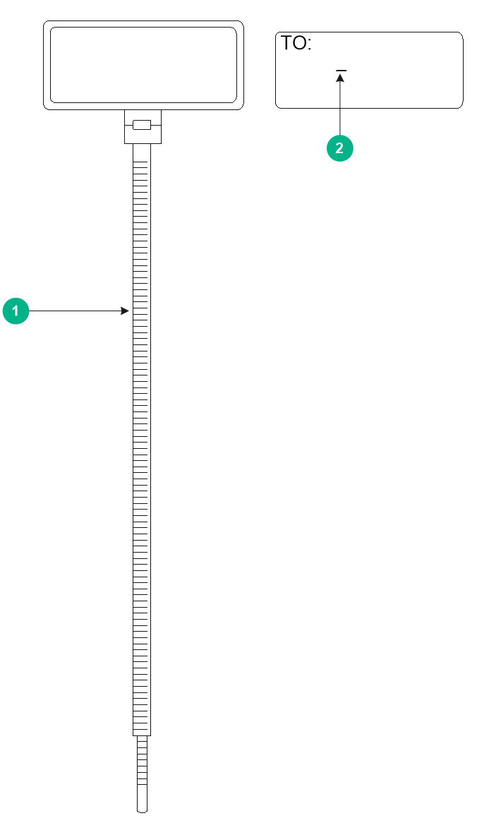

Labels for power cords
Attach a label for power cords to the identification plate on a cable tie that binds the power cords. The identification plate has an embossment of 0.2 × 0.6 mm (0.008 × 0.02 in) around (symmetric on both sides), and the area in the middle is for affixing the label.
A mark "TO:" is located at the upper left corner of the label to identify the peer end of the cable on which the label is affixed. You can write the position of the peer device, control cabinet, distribution box, or power socket. The meaning of the dividing lines is the same as labels for network cables.
Figure 2 Label for power cords
(1) Cable tie |
(2) Dividing line on the label |

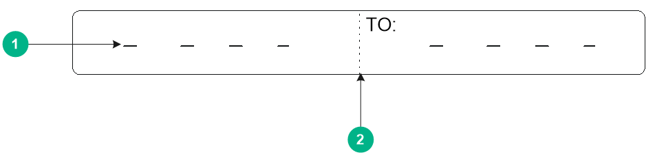

A generic label is bar-shaped with fixed dimensions. It is applicable to all cables. A mark "TO:" is located at the upper left corner in the right area of the label to identify the peer end of the cable on which the label is affixed. The meaning of the dividing lines is the same as labels for network cables.
Figure 3 Generic label
(1) Dividing line on the label |

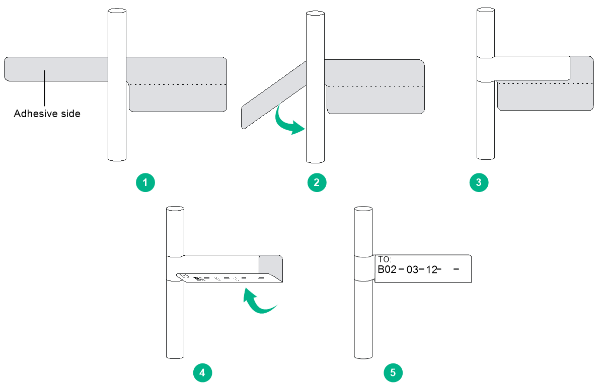

Affixing a label to a network cable
Typically, a label is affixed 2 cm (0.79 in) away from the connector on a network cable. You can affix the label to other positions as needed. Figure 4 shows how to affix a label when a cable is laid vertically.

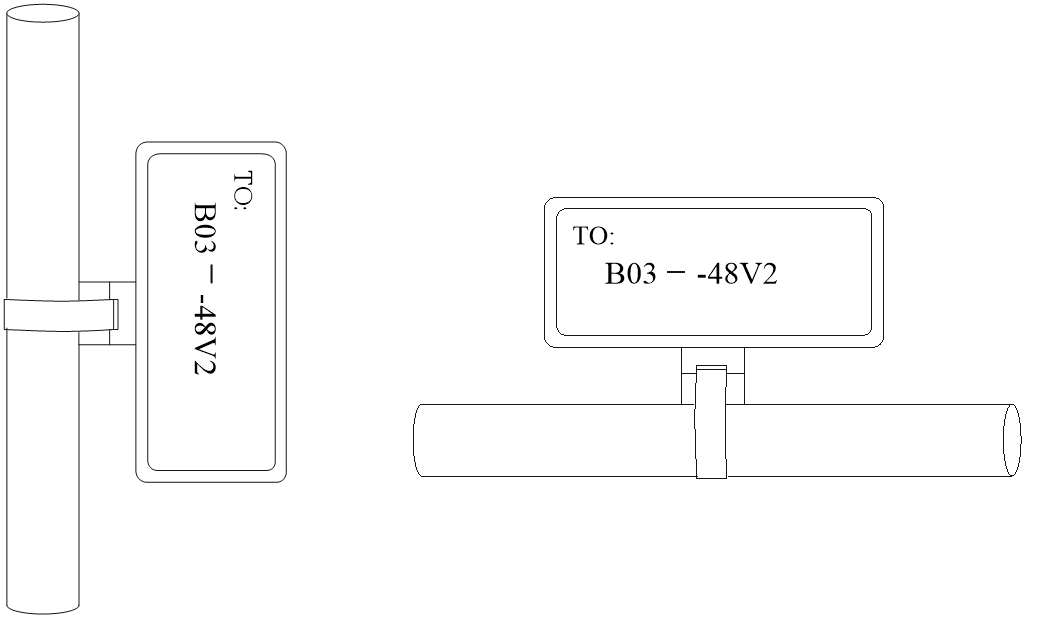

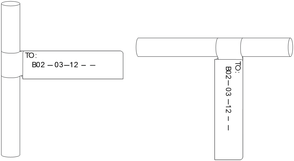

Figure 5 shows the affixed labels when the cable is laid vertically and horizontally.
Figure 5 Affixed labels

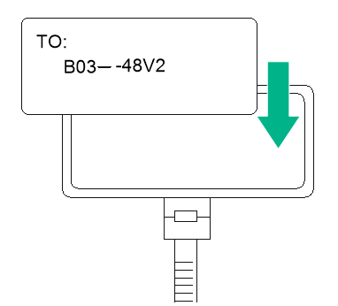

Affixing a label to a power cord
Stick the label to the recessed rectangular area on the identification plate. You can stick the label to either side of the identification plate. Be sure to affix the labels on the same side of the identification plates.
A cable tie is bundled 2 cm (0.79 in) away from the connector. You can affix the label to other positions as needed. Figure 6 shows how to affix a label when a cable is laid horizontally.
Bind cable ties on both ends of a cable. After the bundling, the finished identification plate must be on top of the cable in horizontal cabling, or on the right side of the cable in vertical cabling. Make sure the label is facing out, as shown in Figure 7.

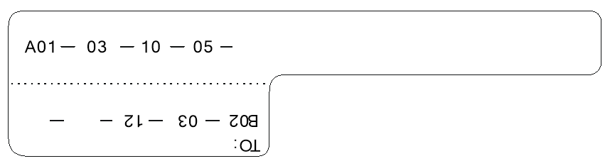

Figure 9 Example of a label on a twisted-pair cable
· A01-03-10-05—The local end of the twisted-pair cable is connected to Ethernet Port 05, Slot 10, Chassis 03 of the rack on Row A, Column 01 in the equipment room.
· B02-03-12—The peer end of the twisted-pair cable is connected to Ethernet Port 12, Chassis 03 of the rack on Row B, Column 02 in the equipment room.

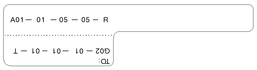

Figure 10 Example of a label on an optical fiber between two devices
· A01-01-05-05-R—The local end of the optical fiber is connected to Optical Receiving Interface 05 on Slot 5, Chassis 01 in the rack on Row A, Column 01 in the equipment room.
· G01-01-01-01-T—The peer end of the optical fiber is connected to Optical Transmitting Interface 01 on Slot 01, Chassis 01 in the rack on Row G, Column 01 in the equipment room

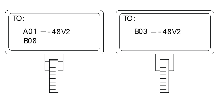

Engineering labels for DC power cords
These labels are affixed to DC power cords that provide power for racks, and the protection grounding cables including the –48V, PGND, and RTN cables. The labels for DC power cords are affixed to one side of the identification plates on cable ties.
Table 4 Information on labels affixed to DC power cords
Content |
Meaning |
MN(BC)-–48Vn |
· Loaded cabinet side—Only MN is used to identify the cabinet number (row number and column number in the equipment room). · Power cabinet side—MN identifies the row and column number of the power distribution equipment like the control cabinet and distribution box. BC identifies the row and column number of the –48V connector (if there is no row number or column number, or the connector can be identified without them, BC can be omitted). RTN and PGND have no row and column number for identification. · n—Power port number in down-top and left-right order, in the range of 1 to 3. |
MN(BC)-RTN |
MN(BC)-PGND |
The label only carries location information about the peer equipment, control cabinet, or distribution box, while information about the local end is not necessary. Table 4 lists information about two –48V power supplies on the label. Give information for other DC voltages (such as 24V, 60V) in similar methods.
Make sure labels are affixed in the correct direction. After the cable ties are bundled onto the cable, the identification plates with the labels must face up, and the text on the labels in the same cabinet must be in the same direction, as shown in Figure 12.
Figure 12 Example of labels on a DC power cord
· A01/B08––48V2 (loaded cabinet side)—The power cord is –48V2 DC supply, which is from the 8th connector on the second row of –48V bus bar in the cabinet on Row A, and Column 1 in the equipment room.
· B03––48V2 (distribution box side)—The power cord is –48V2 DC supply, which is from the loaded cabinet on Row B, Column 03 in the equipment room.
In the power distribution box (or the first power cabinet of a row in the transmission equipment room), every terminal block on the –48V connector bar has a numeric identification. For example, in the above label of "A01/B08--48V2", "08" (or sometimes "8") is the numeric identification of the terminal block.
PGND and RTN are two copper bars, on which the terminal blocks are short-circuited, so which terminal is connected makes no difference. You only need to give the row and column numbers of the power distribution box, instead of giving the specific serial number of the terminal block on the copper bar. For example, if the label on the loaded cabinet side is "A01-RTN", it means that the power cord is an RTN that connects RTN copper bar in the power distribution box on Row A, Column 01 in the equipment room. Give information on the labels for PGND cables in the similar way.

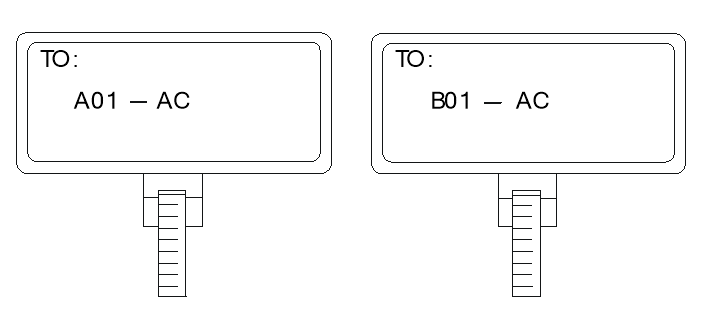

Figure 13 Example of labels on an AC power cord
· A01-AC (loaded cabinet side)—The power cord is connected to the socket of Row A and Column 01 in the equipment room.
· B01-AC (power socket side)—The power cord is connected to the loaded cabinet of Row B, Column 01 in the equipment room.

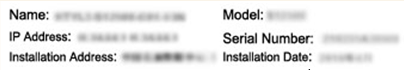

You can fill in the device name, model, IP address, serial number, installation address, and installation date on a device label.
Figure 14 Example of a device label
