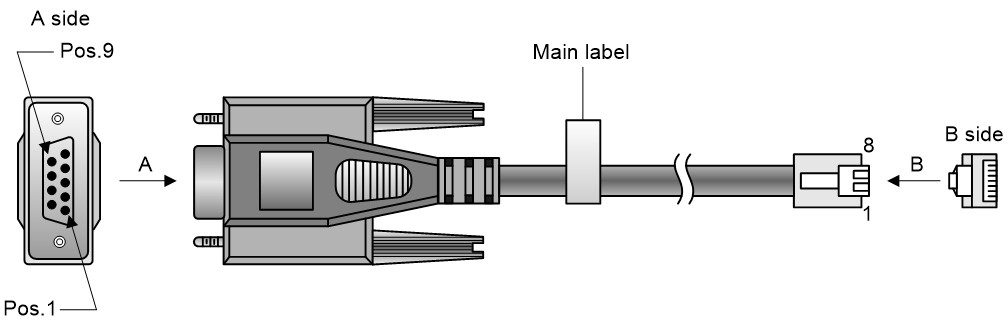

Console cable
A console cable is an 8-core shielded cable, with a crimped RJ-45 connector at one end for connecting to the console port of the gateway, and a DB-9 female connector/standard USB connector at the other end for connecting to the serial port on the console terminal.
Figure 1 Console cable (DB9-to-RJ45 console cable)
Table 2 DB9-to-RJ45 console cable pinout
RJ-45 |
Signal |
DB-9 |
Signal |
1 |
RTS |
8 |
CTS |
2 |
DTR |
6 |
DSR |
3 |
TXD |
2 |
RXD |
4 |
SG |
5 |
SG |
5 |
SG |
5 |
SG |
6 |
RXD |
3 |
TXD |
7 |
DSR |
4 |
DTR |
8 |
CTS |
7 |
RTS |

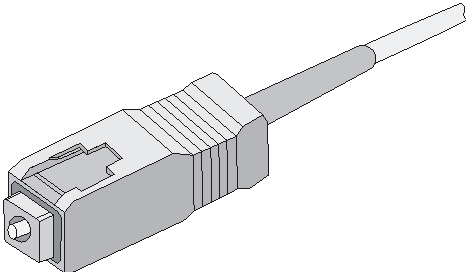

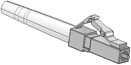

Fiber connector
Figure 5 SC connector
Figure 7 MPO connector
