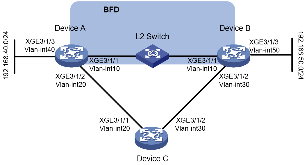

Example: Configuring BFD for static routing
As shown in Figure 2:
·     Device A has two paths to reach Device B: one over a Layer 2 switch, and the other over Device C.
·     A Layer 2 switch connects Device A and Device B.
Because Device B does not support BFD, enable BFD echo packet mode on Device A. When the link between Device B and the Layer 2 switch fails, Device A switches the path over Device C to reach Device B.
Figure 2 Network diagram

Example: Configuring BFD for RIP
As shown in Figure 3, Device A, Device B, and Device C run RIP. Device A and Device C are connected through a Layer 2 switch.
Enable BFD echo packet mode on Device A (Device C does not support BFD) to monitor the path over the Layer 2 switch. When BFD detects a link failure, it notifies RIP to switch to the path over Device B.
Figure 3 Network diagram

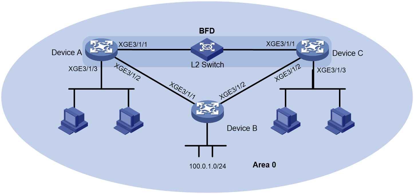

XGE3/1/1
10.1.0.101/24
Device A
XGE3/1/2
192.168.0.101/24
Device A
XGE3/1/3
120.1.1.1/24
Device B
XGE3/1/1
192.168.0.102/24
Device B
XGE3/1/2
13.1.1.101/24
Device C
XGE3/1/1
10.1.0.102/24
Device C
XGE3/1/2
13.1.1.102/24
Device C
XGE3/1/3
121.1.1.1/24
Procedures
Configuring interface IP addresses
1.     Configure Device A:
<DeviceA> system-view
[DeviceA] interface ten-gigabitethernet 3/1/1
[DeviceA-Ten-GigabitEthernet3/1/1] ip address 10.1.0.101 24
[DeviceA-Ten-GigabitEthernet3/1/1] quit
2.     Configure other devices in the same way Device A is configured. (Details not shown.)
Configuring RIP
# Configure basic RIP functions, import direct routes, and enable BFD for RIP.
[DeviceA] rip 1
[DeviceA-rip-1] version 2
[DeviceA-rip-1] undo summary
[DeviceA-rip-1] network 10.1.0.0
[DeviceA-rip-1] network 192.168.0.0
[DeviceA-rip-1] import-route direct
[DeviceA-rip-1] quit
[DeviceA-Ten-GigabitEthernet3/1/1] rip bfd enable
2.     Configure Device B:
# Configure basic RIP functions, and import direct routes.
<DeviceB> system-view
[DeviceB] rip 1
[DeviceB-rip-1] version 2
[DeviceB-rip-1] undo summary
[DeviceB-rip-1] network 192.168.0.0
[DeviceB-rip-1] network 13.1.1.0
[DeviceB-rip-1] import-route direct
[DeviceB-rip-1] quit
3.     Configure Device C:
<DeviceC> system-view
[DeviceC] rip 1
[DeviceC-rip-1] version 2
[DeviceC-rip-1] undo summary
[DeviceC-rip-1] network 10.1.0.0
[DeviceC-rip-1] network 13.1.1.0
[DeviceC-rip-1] import-route direct
[DeviceC-rip-1] quit
Configuring BFD parameters on Device A
# Configure the source IP address for BFD echo packets.
[DeviceA] bfd echo-source-ip 11.11.11.11
# Configure the minimum interval for receiving BFD echo packets and the single-hop detection time multiplier.
[DeviceA-Ten-GigabitEthernet3/1/1] bfd min-echo-receive-interval 100
[DeviceA-Ten-GigabitEthernet3/1/1] bfd detect-multiplier 3
# Display BFD session information on Device A.
[DeviceA] display bfd session verbose
 Total Session Num: 1     Up Session Num: 1     Init Mode: Active
 IPv4 Session Working Under Echo Mode:
       Local Discr: 2049
         Source IP: 10.1.0.101         Destination IP: 10.1.0.102
     Session State: Up                      Interface: Ten-GigabitEthernet3/1/1
         Hold Time: 300ms                Act Tx Inter: 100ms
      Min Rx Inter: 100ms                Detect Inter: 300ms
          Rx Count: 464                      Tx Count: 465
      Connect Type: Direct             Running Up for: 00:00:46
       Detect Mode: Async                        Slot: 0
          Protocol: RIP
         Diag Info: No Diagnostic
The output shows that a BFD session has been established and is up.
# Display information about the routes to network 121.1.1.0/24 on Device A.
<DeviceA> display ip routing-table 121.1.1.0 24 verbose
Summary Count : 1
Destination: 121.1.1.0/24
   Protocol: RIP             Process ID: 1
  SubProtID: 0x1                    Age: 04h20m37s
       Cost: 1               Preference: 100
        Tag: 0                    State: Active Adv
  OrigTblID: 0x0                OrigVrf: default-vrf
    TableID: 0x2                 OrigAs: 0
      NBRID: 0x26000002          LastAs: 0
     AttrID: 0xffffffff        Neighbor: 10.1.0.102
      Flags: 0x1008c        OrigNextHop: 10.1.0.102
      Label: NULL           RealNextHop: 10.1.0.102
    BkLabel: NULL             BkNextHop: N/A
  Tunnel ID: Invalid          Interface: Ten-GigabitEthernet3/1/1
BkTunnel ID: Invalid        BkInterface: N/A
The output shows that Device A communicates with Device C through the Layer 2 switch.
# When the link between Device C and the Layer 2 switch fails, view BFD log information.
%Oct  9 18:42:17:650 2013 Device A BFD/5/BFD_CHANGE_FSM: -MDC=1;Sess[10.1.0.101/10.1.0.102, LD/RD:2049/2049, Interface: Ten-GigabitEthernet3/1/1, SessType:Echo, LinkType:INET] , Sta: UP-> DOWN, Diag:1
The output shows that BFD can quickly detect the failure and notify RIP.
Summary Count : 1
   Protocol: RIP             Process ID: 2
       Cost: 2               Preference: 100
     AttrID: 0xffffffff        Neighbor: 192.168.0.102
      Flags: 0x1008c        OrigNextHop: 192.168.0.102
      Label: NULL           RealNextHop: 192.168.0.102
  Tunnel ID: Invalid          Interface: Ten-GigabitEthernet3/1/2
The output shows that Device A communicates with Device C through Device B.

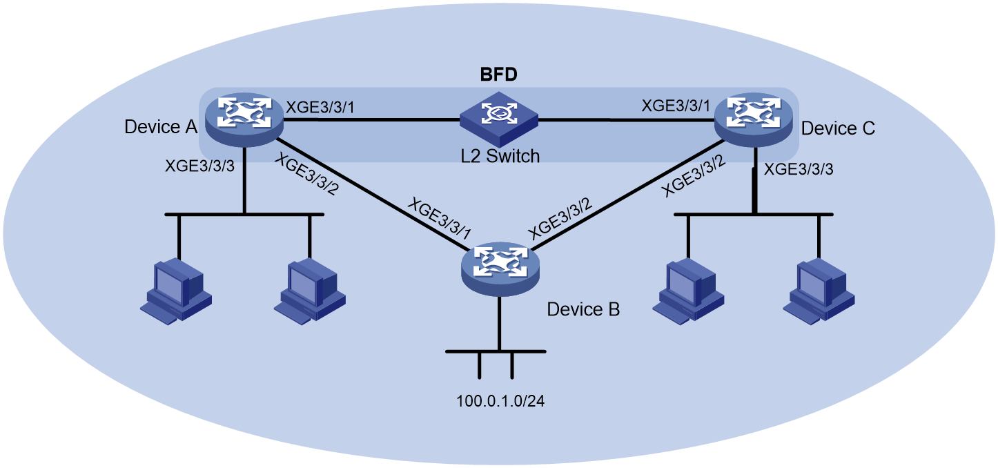

Example: Configuring BFD for OSPF
As shown in Figure 4, Device A, Device B, and Device C run OSPF. Device A and Device C are connected through a Layer 2 switch.
Enable BFD control packet mode on Device A and Device C to monitor the path over the Layer 2 switch. When BFD detects a link failure, it notifies OSPF to switch to the path over Device B.
Figure 4 Network diagram
Table 3 Interface and IP address assignment
Device
Interface
IP address
Device A
XGE3/1/1
10.1.0.101/24
Device A
XGE3/1/2
192.168.0.101/24
Device A
XGE3/1/3
120.1.1.1/24
Device B
XGE3/1/1
192.168.0.102/24
Device B
XGE3/1/2
13.1.1.101/24
Device C
XGE3/1/1
10.1.0.102/24
Device C
XGE3/1/2
13.1.1.102/24
Device C
XGE3/1/3
121.1.1.1/24
%Apr  2 11:34:26:880 2014 DeviceA BFD/5/BFD_CHANGE_FSM: Sess[10.1.0.101/10.1.0.102,1026/1026, Ten-GigabitEthernet3/1/1,Ctrl] , Sta: UP-> DOWN, Diag: 5
%Apr  2 11:34:27:011 2014 DeviceA OSPF/5/OSPF_NBR_CHG: OSPF 1 Neighbor 10.1.0.102 Ten-GigabitEthernet3/1/1) from Full to Down.
The output shows that BFD can quickly detect the failure and notify OSPF.
<DeviceA> display ip routing-table 121.1.1.0 verbose
Summary Count : 1
   Protocol: OSPF            Process ID: 1
     AttrID: 0xffffffff        Neighbor: 0.0.0.0

As shown in Figure 5, Device A, Device B, and Device C run IS-IS. Device A and Device C are connected through a Layer 2 switch.
Enable BFD control packet mode on Device A and Device C to monitor the path over the Layer 2 switch. When BFD detects a link failure, it notifies IS-IS to switch to the path over Device B.
Figure 5 Network diagram
Table 4 Interface and IP address assignment
Device
Interface
IP address
Device A
XGE3/1/1
10.1.0.101/24
Device A
XGE3/1/2
192.168.0.101/24
Device A
XGE3/1/3
120.1.1.1/24
Device B
XGE3/1/1
192.168.0.102/24
Device B
XGE3/1/2
13.1.1.101/24
Device C
XGE3/1/1
10.1.0.102/24
Device C
XGE3/1/2
13.1.1.102/24
Device C
XGE3/1/3
121.1.1.1/24
Procedures
Configuring IS-IS
# Configure basic IS-IS functions, and enable BFD for IS-IS.
[DeviceA] isis
[DeviceA-isis-1] network-entity 10.0000.0000.0001.00
[DeviceA-isis-1] quit
[DeviceA] interface ten-gigabitethernet 3/1/2
[DeviceA-Ten-GigabitEthernet3/1/2] isis enable
[DeviceA-Ten-GigabitEthernet3/1/2] quit
[DeviceA-Ten-GigabitEthernet3/1/1] isis enable
[DeviceA-Ten-GigabitEthernet3/1/1] isis bfd enable
# Configure basic IS-IS functions.
[DeviceB] isis
[DeviceB-isis-1] network-entity 10.0000.0000.0003.00
[DeviceB-isis-1] quit
[DeviceB] interface ten-gigabitethernet 3/1/1
[DeviceB-Ten-GigabitEthernet3/1/1] isis enable
[DeviceB-Ten-GigabitEthernet3/1/1] quit
[DeviceB] interface ten-gigabitethernet 3/1/2
[DeviceB-Ten-GigabitEthernet3/1/2] isis enable
[DeviceB-Ten-GigabitEthernet3/1/2] quit
[DeviceC] isis
[DeviceC-isis-1] network-entity 10.0000.0000.0002.00
[DeviceC-isis-1] quit
[DeviceC] interface ten-gigabitethernet 3/1/1
[DeviceC-Ten-GigabitEthernet3/1/1] isis enable
[DeviceC-Ten-GigabitEthernet3/1/1] isis bfd enable
[DeviceC-Ten-GigabitEthernet3/1/1] quit
[DeviceC] interface ten-gigabitethernet 3/1/2
[DeviceC-Ten-GigabitEthernet3/1/2] isis enable
[DeviceC-Ten-GigabitEthernet3/1/2] quit
# Configure the session establishment mode as active (this is the default mode).
[DeviceA] bfd session init-mode active
# Configure the minimum interval for sending and receiving single-hop BFD control packets and the single-hop detection time multiplier.
[DeviceA-Ten-GigabitEthernet3/1/1] bfd min-transmit-interval 100
[DeviceA-Ten-GigabitEthernet3/1/1] bfd min-receive-interval 100
2.     Configure Device C:
[DeviceC] bfd session init-mode active
[DeviceC-Ten-GigabitEthernet3/1/1] bfd min-transmit-interval 100
[DeviceC-Ten-GigabitEthernet3/1/1] bfd min-receive-interval 100
[DeviceC-Ten-GigabitEthernet3/1/1] bfd detect-multiplier 3
# Display detailed IS-IS neighbor information on Device A.
[DeviceA] display isis peer verbose
                         Peer information for IS-IS(1)
 System ID: 0000.0000.0002
 Interface: Ten-GigabitEthernet3/1/1      Circuit Id:  0000.0000.0002.01
 State: Up     HoldTime: 6s         Type: L1(L1L2)     PRI: 64
 Area address(es): 00
 Peer IP address(es): 10.1.0.102
 Peer local circuit ID: 1
 Peer circuit SNPA address: ce9d-d91d-d100
 Uptime: 00:01:19
 Adj protocol:  IPv4
 Graceful Restart capable
   Restarting signal: No
   Suppress adjacency advertisement: No
 Local topology:
   0
 Remote topology:
   0
The output shows that Device A has established IS-IS neighbor relationship with Device C.
# Display BFD session information on Device A and Device C.
 IPv4 Session Working Under Ctrl Mode:
       Local Discr: 2049                 Remote Discr: 2049
      Min Tx Inter: 100ms                Act Tx Inter: 100ms
          Rx Count: 3                        Tx Count: 3
      Connect Type: Direct             Running Up for: 00:06:09
         Hold Time: 300ms                   Auth mode: None
          Protocol: ISIS_BR_L1/ISIS_BR_L2
[DeviceC] display bfd session verbose
         Source IP: 10.1.0.102         Destination IP: 10.1.0.101
      Connect Type: Direct             Running Up for: 00:07:10
The output shows that BFD sessions have been established and are up.
Summary Count : 1
   Protocol: isis            Process ID: 1
       Cost: 20              Preference: 15
  OrigTblID: 0x2                OrigVrf: default-vrf
%Oct  9 16:11:24:163 2013 DeviceC BFD/5/BFD_CHANGE_FSM: -MDC=1; Sess[10.1.0.102/10.1.0.101, LD/RD:2049/2049, Interface: Ten-GigabitEthernet3/1/1, SessType:Ctrl, LinkType:INET] , S
ta: UP-> DOWN, Diag: 1
%Oct  9 16:11:24:164 2013 DeviceC ISIS/5/ISIS_NBR_CHG: -MDC=1; IS-IS 1, Level-1 adj
acency 0000.0000.0001 (Ten-GigabitEthernet3/1/1), state change to: DOWN.
%Oct  9 16:11:24:164 2013 DeviceC ISIS/5/ISIS_NBR_CHG: -MDC=1; IS-IS 1, Level-2 adj
The output shows that BFD can quickly detect the failure and notify IS-IS.
Summary Count : 1
       Cost: 21              Preference: 10

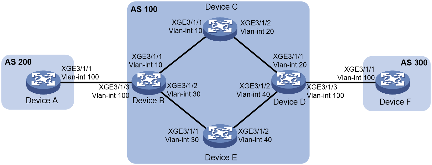

Example: Configuring BFD for BGP
As shown in Figure 6, the devices in AS 100 run OSPF to reach each other. There are two paths between Device B and Device D:
·     Path A—Path over Device C.
·     Path B—Path over Device E.
When both paths are available, BGP uses the path over Device C to forward traffic between Device A and Device F.
Enable BFD control packet mode on Device B and Device D to monitor the path over Device C. When BFD detects a link failure, it notifies BGP to switch to the path over Device E.
Figure 6 Network diagram
Table 5 Interface and IP address assignment
Device
Interface
IP address
Device A
XGE3/1/1
120.1.0.1/24
Device B
XGE3/1/1
10.1.0.101/24
Device B
XGE3/1/2
192.168.0.101/24
Device B
XGE3/1/3
120.1.0.2/24
Device C
XGE3/1/1
10.1.0.102/24
Device C
XGE3/1/2
10.2.0.102/24

Analysis
For Path A to become the primary path, use a routing policy to set a lower cost for Path A than Path B.
In BFD control packet mode, a minimum of one end must operate in active mode for a BFD session to be established.
Procedures
[DeviceA-Ten-GigabitEthernet3/1/1] ip address 120.1.0.1 24
Configuring OSPF in AS 100
1.     Configure Device B:
[DeviceB] ospf
[DeviceB-ospf-1] import-route direct
[DeviceB-ospf-1] area 0
[DeviceB-ospf-1-area-0.0.0.0] network 10.1.0.0 0.0.0.255
[DeviceB-ospf-1-area-0.0.0.0] network 192.168.0.0 0.0.0.255
[DeviceB-ospf-1-area-0.0.0.0] quit
[DeviceB-ospf-1] quit
[DeviceC] ospf
[DeviceC-ospf-1] area 0
[DeviceC-ospf-1-area-0.0.0.0] network 10.1.0.0 0.0.0.255
[DeviceC-ospf-1-area-0.0.0.0] network 10.2.0.0 0.0.0.255
[DeviceC-ospf-1-area-0.0.0.0] quit
[DeviceC-ospf-1] quit
3.     Configure Device D:
[DeviceD] ospf
[DeviceD-ospf-1] import-route direct
[DeviceD-ospf-1] area 0
[DeviceD-ospf-1-area-0.0.0.0] network 10.2.0.0 0.0.0.255
[DeviceD-ospf-1-area-0.0.0.0] network 13.1.1.0 0.0.0.255
[DeviceD-ospf-1-area-0.0.0.0] quit
[DeviceD-ospf-1] quit
4.     Configure Device E:
[DeviceE] ospf
[DeviceE-ospf-1] area 0
[DeviceE-ospf-1-area-0.0.0.0] network 13.1.1.0 0.0.0.255
[DeviceE-ospf-1-area-0.0.0.0] network 192.168.0.0 0.0.0.255
[DeviceE-ospf-1-area-0.0.0.0] quit
[DeviceE-ospf-1] quit
Configuring BGP
# Enable BGP and set the local AS number to 200.
[DeviceA] bgp 200
[DeviceA-bgp-default] router-id 1.1.1.1
# Establish an EBGP connection with Device B.
[DeviceA-bgp-default] peer 120.1.0.2 as-number 100
# Create the BGP IPv4 unicast address family and enter its view.
[DeviceA-bgp-default] address-family ipv4 unicast
# In BGP IPv4 unicast address family view, inject local network 120.1.0.0/24 to the BGP routing table.
[DeviceA-bgp-default-ipv4] network 120.1.0.0 255.255.255.0
# Enable BGP to exchange IPv4 unicast routing information with peer 120.1.0.2.
[DeviceA-bgp-default-ipv4] peer 120.1.0.2 enable
[DeviceA-bgp-default-ipv4] quit
# Enable BGP and set the local AS number to 100.
[DeviceB] bgp 100
[DeviceB-bgp-default] router-id 2.2.2.2
# Establish an EBGP connection with Device A.
[DeviceB-bgp-default] peer 120.1.0.1 as-number 200
# Establish IBGP connections with Device D.
[DeviceB-bgp-default] peer 10.2.0.101 as-number 100
[DeviceB-bgp-default] peer 13.1.1.101 as-number 100
[DeviceB-bgp-default] address-family ipv4 unicast
# Enable BGP to exchange IPv4 unicast routing information with peer 10.2.0.101.
[DeviceB-bgp-default-ipv4] peer 10.2.0.101 enable
# In BGP IPv4 unicast address family view, specify the device as the next hop for routes sent to peer 10.2.0.101.
[DeviceB-bgp-default-ipv4] peer 10.2.0.101 next-hop-local
# Enable BGP to exchange IPv4 unicast routing information with peer 13.1.1.101.
[DeviceB-bgp-default-ipv4] peer 13.1.1.101 enable
# In BGP IPv4 unicast address family view, specify the device as the next hop for routes sent to peer 13.1.1.101.
[DeviceB-bgp-default-ipv4] peer 13.1.1.101 next-hop-local
# Enable BGP to exchange IPv4 unicast routing information with peer 120.1.0.1.
[DeviceB-bgp-default-ipv4] peer 120.1.0.1 enable
[DeviceB-bgp-default-ipv4] quit
[DeviceD] bgp 100
[DeviceD-bgp-default] router-id 4.4.4.4
# Establish IBGP connections with Device B.
[DeviceD-bgp-default] peer 10.1.0.101 as-number 100
[DeviceD-bgp-default] peer 192.168.0.101 as-number 100
# Establish an EBGP connection with Device F.
[DeviceD-bgp-default] peer 120.2.0.1 as-number 300
[DeviceD-bgp-default] address-family ipv4 unicast
# Enable BGP to exchange IPv4 unicast routing information with peer 10.1.0.101.
[DeviceD-bgp-default-ipv4] peer 10.1.0.101 enable
# In BGP IPv4 unicast address family view, specify the device as the next hop for routes sent to peer 10.1.0.101.
[DeviceD-bgp-default-ipv4] peer 10.1.0.101 next-hop-local
# Enable BGP to exchange IPv4 unicast routing information with peer 192.168.0.101.
[DeviceD-bgp-default-ipv4] peer 192.168.0.101 enable
# In BGP IPv4 unicast address family view, specify the device as the next hop for routes sent to peer 192.168.0.101.
[DeviceD-bgp-default-ipv4] peer 192.168.0.101 next-hop-local
# Enable BGP to exchange IPv4 unicast routing information with peer 120.2.0.1.
[DeviceD-bgp-default-ipv4] peer 120.2.0.1 enable
[DeviceD-bgp-default-ipv4] quit
4.     Configure Device F:
# Enable BGP and set the local AS number to 300.
[DeviceF] bgp 300
[DeviceF-bgp-default] router-id 6.6.6.6
# Establish an EBGP connection with Device D.
[DeviceF-bgp-default] peer 120.2.0.2 as-number 100
[DeviceF-bgp-default] address-family ipv4 unicast
# In BGP IPv4 unicast address family view, inject local network 120.2.0.0/24 to the BGP routing table.
[DeviceF-bgp-default-ipv4] network 120.2.0.0 255.255.255.0
# Enable BGP to exchange IPv4 unicast routing information with peer 120.2.0.2.
[DeviceF-bgp-default-ipv4] peer 120.2.0.2 enable
[DeviceF-bgp-default-ipv4] quit
Configuring routing policies
# Create ACL 2000 to permit packets sourced from 120.1.0.0/24.
[DeviceB] acl basic 2000
[DeviceB-acl-ipv4-basic-2000] rule permit source 120.1.0.0 0.0.0.255
[DeviceB-acl-ipv4-basic-2000] quit
# Set a local preference of 200 for routes advertised to peer 10.2.0.101, and set the preference for IBGP routes to 100.
[DeviceB] route-policy local-pre permit node 10
[DeviceB-route-policy-local-pre-10] if-match ip address acl 2000
[DeviceB-route-policy-local-pre-10] apply local-preference 200
[DeviceB-route-policy-local-pre-10] quit
[DeviceB] bgp 100
[DeviceB-bgp-default-ipv4] peer 10.2.0.101 route-policy local-pre export
[DeviceB-bgp-default-ipv4] preference 255 100 130
[DeviceB-bgp-default] quit
2.     Configure Device D:
# Create ACL 2000 to permit packets sourced from 120.2.0.0/24.
[DeviceD] acl basic 2000
[DeviceD-acl-ipv4-basic-2000] rule permit source 120.2.0.0 0.0.0.255
[DeviceD-acl-ipv4-basic-2000] quit
# Set a local preference of 200 for routes learned from peer 10.1.0.101, and configure the preference for IBGP routes as 100.
[DeviceD] route-policy local-pre permit node 10
[DeviceD-route-policy-local-pre-10] if-match ip address acl 2000
[DeviceD-route-policy-local-pre-10] apply local-preference 200
[DeviceD-route-policy-local-pre-10] quit
[DeviceD] bgp 100
[DeviceD-bgp-default-ipv4] peer 10.1.0.101 route-policy local-pre export
[DeviceD-bgp-default-ipv4] preference 255 100 130
[DeviceD-bgp-default] quit
Configuring BFD
# Enable BFD for the link to BGP peer 10.2.0.101.
[DeviceB] bgp 100
[DeviceB-bgp-default] peer 10.2.0.101 bfd
# Enable BFD for the link to BGP peer 10.1.0.101.
[DeviceD] bgp 100
[DeviceD-bgp-default] peer 10.1.0.101 bfd
# Ping Device F from Device A to verify the connectivity.
[DeviceA] ping 120.2.0.1
Ping 120.2.0.1 (120.2.0.1): 56 data bytes, press CTRL_C to break
56 bytes from 120.2.0.1: icmp_seq=0 ttl=252 time=1.189 ms
56 bytes from 120.2.0.1: icmp_seq=1 ttl=252 time=1.095 ms
56 bytes from 120.2.0.1: icmp_seq=2 ttl=252 time=1.086 ms
56 bytes from 120.2.0.1: icmp_seq=3 ttl=252 time=1.097 ms
56 bytes from 120.2.0.1: icmp_seq=4 ttl=252 time=1.089 ms
--- Ping statistics for 120.2.0.1 ---
round-trip min/avg/max/std-dev = 1.086/1.111/1.189/0.039 ms
The output shows that Device F can be pinged successfully.
# Display BGP peer information on Device B.
[DeviceB] display bgp peer ipv4
 BGP local router ID: 2.2.2.2
 Local AS number: 100
 Total number of peers: 3                  Peers in established state: 3
  Peer                    AS  MsgRcvd  MsgSent OutQ PrefRcv Up/Down  State
  10.2.0.101             100        6        4    0       1 00:00:56 Established
  13.1.1.101             100        6        5    0       1 00:00:56 Established
  120.1.0.1              200        6        5    0       1 00:00:56 Established
The output shows the following information:
·     Two IBGP connections have been established between Device B and Device D.
·     An EBGP connection has been established between Device B and Device A.
# Display detailed BFD session information on Device B.
[DeviceB] display bfd session verbose
 Total Session Num: 1     Up Session Num: 0     Init Mode: Active
       Local Discr: 2049                 Remote Discr: 0
         Source IP: 10.1.0.101         Destination IP: 10.2.0.101
     Session State: UP                      Interface: N/A
      Min Tx Inter: 1000400ms               Act Tx Inter: 1000400ms
      Min Rx Inter: 1000400ms               Detect Inter: 50002000ms
          Rx Count: 0                        Tx Count: 910
      Connect Type: Indirect           Running Up for: 00:00:00
         Hold Time: 0ms                     Auth mode: None
          Protocol: BGP
# Display information about the routes to network 120.2.0.0/24 on Device B.
    TableID: 0x2                 OrigAs: 300
      NibID: 0x15000001          LastAs: 300
     AttrID: 0x1               Neighbor: 10.2.0.101
      Flags: 0x10060        OrigNextHop: 10.2.0.101
Destination: 120.2.0.0/24
  SubProtID: 0x8                    Age: 00h00m18s
       Cost: 1               Preference: 150
        Tag: 1                    State: Inactive Adv
      NibID: 0x13000001          LastAs: 0
      Flags: 0x41           OrigNextHop: 192.168.0.102
The output shows that Device B communicates with Device D through path over Device E.
