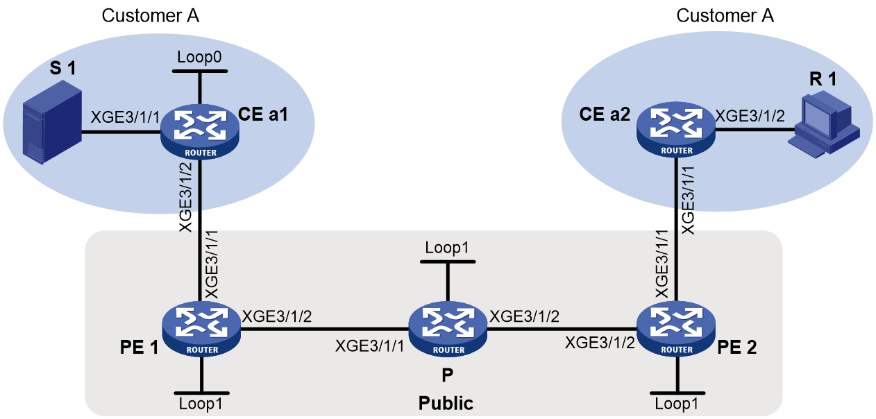

Example: Configuring intra-AS MDT-based MVPN
As shown in Figure 1:
·     Customer A has two branches that connect to the MPLS L3VPN network of a service provider.
·     PIM-SM runs within the two branches.
·     The multicast source and the receiver host are in different branches.
Configure intra-AS MDT-based MVPN so that the receiver host can receive the multicast data from the source.
Figure 1 Network diagram
Device
Interface
IP address
Device
Interface
IP address
S 1
10.11.3.2/24
PE 2
XGE3/1/2
192.168.2.2/24
PE 1
XGE3/1/2
192.168.1.2/24
PE 2
XGE3/1/1
10.11.2.1/24
PE 1
XGE3/1/1
10.11.1.1/24
PE 2
Loop1
1.1.1.2/32
PE 1
Loop1
1.1.1.1/32
CE a1
XGE3/1/1
10.11.3.1/24
P
XGE3/1/1
192.168.1.1/24
CE a1
XGE3/1/2
10.11.1.2/24
P
XGE3/1/2
192.168.2.1/24
CE a1
Loop0
2.2.2.2/32
P
Loop1
3.3.3.3/32
CE a2
XGE3/1/2
10.11.4.1/24
R 1
10.11.4.2/24
CE a2
XGE3/1/1
10.11.2.2/24
Analysis
To meet the network requirement, you must run PIM on the devices of the public network, and configure MDT-based MVPN on each PE. In addition, make sure the PIM protocol on the public network is independent from the PIM protocol for the VPN instance.
The MTI interfaces take effect only after the default-group and the MVPN source interface are specified and the MVPN source interface obtains the public IP address.
You must enable the same PIM mode on all interfaces that belong to the same VPN instance (including the interfaces associated with the VPN instance on the PEs).
You must specify the same default-group for the same VPN instance on different PEs.
The IP address of the MVPN source interface must be the same as the source address used for establishing BGP peer relationship. Otherwise, correct routing information cannot be obtained.
Procedures
Assigning IP addresses to interfaces
# Assign an IP address and subnet mask to each interface on CE a1, as shown in Table 1.
<CEa1> system-view
[CEa1] interface ten-gigabitethernet 3/1/1
[CEa1-Ten-GigabitEthernet3/1/1] ip address 10.11.3.1 24
[CEa1-Ten-GigabitEthernet3/1/1] quit
[CEa1] interface loopback 0
[CEa1-LoopBack0] ip address 2.2.2.2 32
[CEa1-LoopBack0] quit
[CEa1] interface ten-gigabitethernet 3/1/2
[CEa1-Ten-GigabitEthernet3/1/2] ip address 10.11.1.2 24
[CEa1-Ten-GigabitEthernet3/1/2] quit
# Configure PE 1, P, PE 2, and CE a2 in the same way CE a1 is configured. (Details not shown.)
Configuring routing and basic MPLS L3VPN
# Configure a unicast routing protocol and basic MPLS VPN on all devices so that all devices are interoperable at the network layer. (Details not shown.) For more information about configuring basic MPLS VPN, see H3C CR16000-F Routers MPLS Configuration Guide.

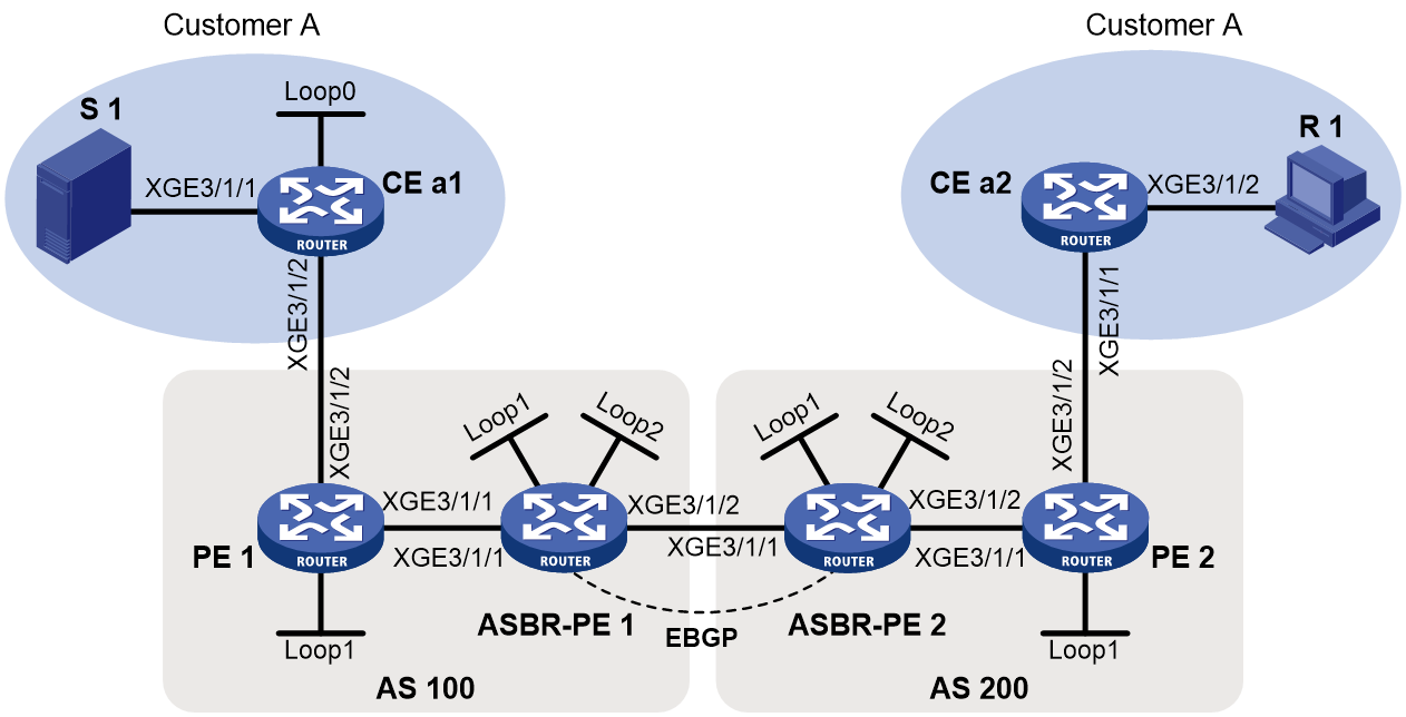

Example: Configuring inter-AS option A MDT-based MVPN
As shown in Figure 2:
·     Customer A has two branches that separately connect to AS 100 and AS 200.
·     ASBR-PE 1 and ASBR-PE 2 are interconnected by using the inter-AS option A solution.
Configure inter-AS option A MDT-based MVPN so that the receiver host can receive the multicast data from the source.
Figure 2 Network diagram
Device
Interface
IP address
Device
Interface
IP address
S 1
10.11.3.2/24
R 1
10.11.4.2/24
PE 1
XGE3/1/1
192.168.1.2/24
ASBR-PE 2
XGE3/1/1
192.168.2.2/24
PE 1
XGE3/1/2
10.11.1.1/24
ASBR-PE 2
XGE3/1/2
192.168.3.2/24
PE 1
Loop1
1.1.1.1/32
ASBR-PE 2
Loop1
1.1.1.3/32
ASBR-PE 1
XGE3/1/1
192.168.1.1/24
ASBR-PE 2
Loop2
22.22.22.22/32
ASBR-PE 1
XGE3/1/2
192.168.2.1/24
PE 2
XGE3/1/1
192.168.3.1/24
ASBR-PE 1
Loop1
1.1.1.2/32
PE 2
XGE3/1/2
10.11.2.1/24
ASBR-PE 1
Loop2
11.11.11.11/32
PE 2
Loop1
1.1.1.4/32
CE a1
XGE3/1/1
10.11.3.1/24
CE a2
XGE3/1/1
10.11.2.2/24
CE a1
XGE3/1/2
10.11.1.2/24
CE a2
XGE3/1/2
10.11.4.1/24
CE a1
Loopback 0
2.2.2.2/32
Analysis
To meet the network requirement, you must create a separate MDT-based MVPN for each AS.
You must enable the same PIM mode for all interfaces that belong to the same VPN instance (including the interface associated with the VPN instance). You may enable different PIM modes for the public network in different ASs.
You must specify the same default-group for the same VPN instance in the same AS. You may specify different default-groups for the same VPN instance in different ASs.
Procedures
# Assign an IP address and subnet mask to each interface on CE a1, as shown in Table 2.
<CEa1> system-view

Example: Configuring inter-AS option C MDT-based MVPN
As shown in Figure 3:
·     ASBR-PE 1 and ASBR-PE 2 are interconnected by using the inter-AS option C solution.
Configure inter-AS option C MDT-based MVPN so that the receiver host can receive the multicast data from the source.
Figure 3 Network diagram

Analysis
To meet the network requirement, you must perform the following tasks:
·     Create the same MDT-based MVPN for each AS.
·     Establish MSDP peering relationships between the RPs in the ASs to share the multicast source information in different PIM-SM domains.
Procedures

The output shows that an RPT for (*, 239.1.1.1), an SPT for (1.1.1.1, 239.1.1.1), and an SPT for (1.1.1.4, 239.1.1.1) have been established on the public network. The RPT and SPTs constitute the default-MDT for the public network.
Configuration files
·     PE 1:
ip vpn-instance customerA
 route-distinguisher 100:1
 vpn-target 100:1 import-extcommunity
 vpn-target 100:1 export-extcommunity
interface LoopBack1
 ip address 1.1.1.1 255.255.255.255
 pim sm
interface Ten-GigabitEthernet3/1/1
 ip address 192.168.1.2 255.255.255.0
 pim sm
interface Ten-GigabitEthernet3/1/2
 ip binding vpn-instance customerA
 ip address 10.11.1.1 255.255.255.0
 pim sm
multicast routing
multicast routing vpn-instance customerA
multicast-vpn vpn-instance customerA mode mdt
 address-family ipv4
  source LoopBack1
  default-group 239.1.1.1
  data-group 225.1.1.0 255.255.255.240
·     PE 2:
 route-distinguisher 200:1
interface LoopBack1
 ip address 1.1.1.4 255.255.255.255
 pim sm
 ip address 192.168.3.1 255.255.255.0
 pim sm
 ip address 10.11.2.1 255.255.255.0
 pim sm
multicast routing
 address-family ipv4
  source LoopBack1
·     ASBR-PE 1:
interface LoopBack1
 ip address 1.1.1.2 255.255.255.255
 pim sm
interface LoopBack2
 ip address 11.11.11.11 255.255.255.255
 pim sm
 pim sm
 ip address 192.168.2.1 255.255.255.0
 pim sm
 pim bsr-boundary
multicast routing
pim
 c-bsr 11.11.11.11
 c-rp 11.11.11.11
msdp
 encap-data-enable
 peer 192.168.2.2 connect-interface Ten-GigabitEthernet3/1/2
·     ASBR-PE 2:
interface LoopBack1
 ip address 1.1.1.3 255.255.255.255
 pim sm
interface LoopBack2
 ip address 22.22.22.22 255.255.255.255
 pim sm
 ip address 192.168.2.2 255.255.255.0
 pim sm
 pim bsr-boundary
 ip address 192.168.3.2 255.255.255.0
 pim sm
multicast routing
pim
 c-bsr 22.22.22.22
 c-rp 22.22.22.22
msdp
 encap-data-enable
 peer 192.168.2.1 connect-interface Ten-GigabitEthernet3/1/1
·     CE a1:
interface LoopBack0
 ip address 2.2.2.2 255.255.255.255
 pim sm
 ip address 10.11.3.1 255.255.255.0
 pim sm
 ip address 10.11.1.2 255.255.255.0
 pim sm
multicast routing
pim
 c-bsr 2.2.2.2
 c-rp 2.2.2.2
·     CE a2:
 ip address 10.11.2.2 255.255.255.0
 pim sm
 ip address 10.11.4.1 255.255.255.0
 igmp enable
multicast routing
Related documentation
·     H3C CR16000-F Routers IP Multicast Command Reference-R8385P09
·     H3C CR16000-F Routers IP Multicast Configuration Guide-R8385P09
