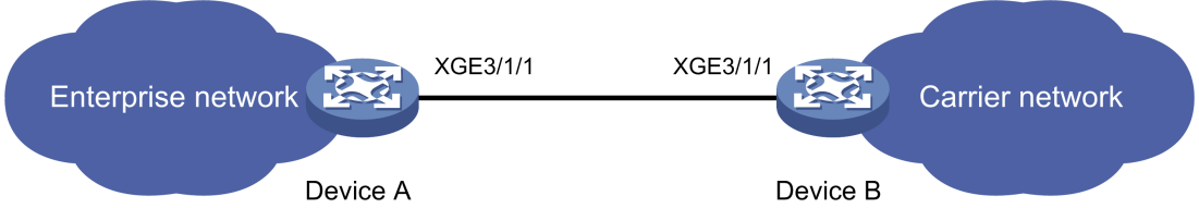

As shown in Figure 1, the edge devices Device A and Device B connect the enterprise network and the carrier network. Configure Ethernet OAM on Device A and Device B to meet the following Service Level Agreement (SLA) requirements:
· Device A and Device B automatically monitor the link between them.
· The administrator can view critical link events on the link between Device A and Device B.
· The administrator can obtain the link status by observing link error event statistics.
Analysis
To implement link event detection based on the network environment, configure errored frame event detection parameters and use global settings for other detection parameters.
To change the Ethernet OAM mode on an Ethernet OAM-enabled port, first disable Ethernet OAM on the port.
