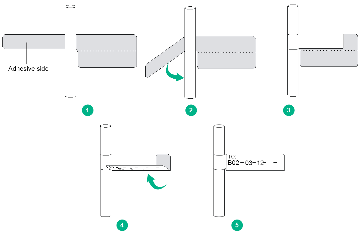

A label for signal cables is L-shaped with fixed dimensions. The light-blue dividing lines on the label help to specify more clearly the position of the cable. For example, there is one dividing line between the rack number and the chassis number and another one between the chassis number and the slot number. The cut dotted line helps to fold the label when you affix it to the cable. A mark "TO:" is located at the lower right corner of the label to identify the peer end of the cable on which the label is affixed.
As shown in Figure10-1, write a signal cable label as follows:
·     Write the position of the cable in Area 1.
·     Write the position of the cable on the peer end in Area 2.
·     Area 3 is the part that is folded up inside the label when the label is affixed to the cable.

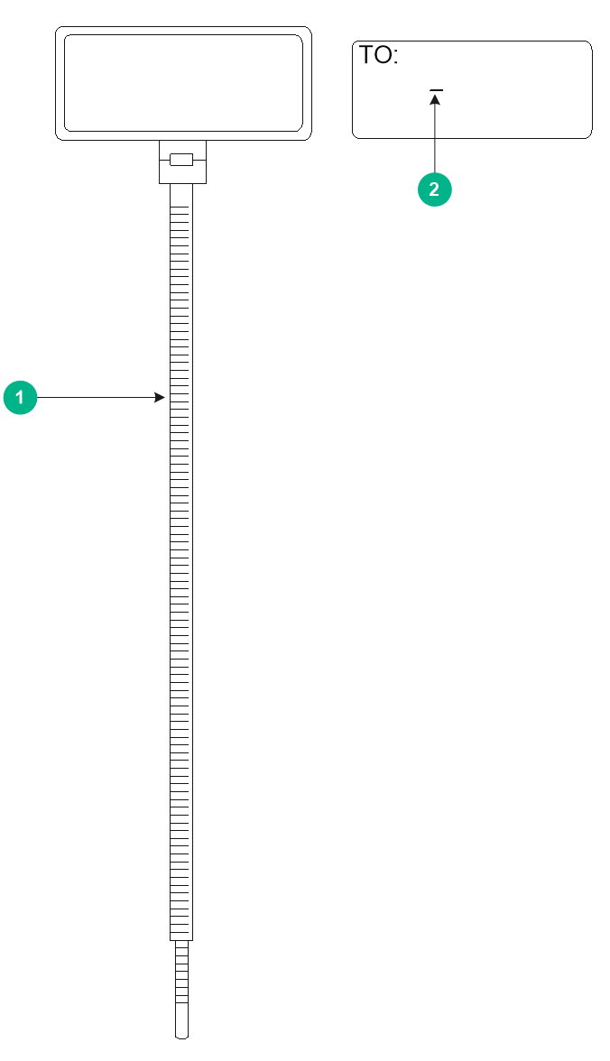

Labels for power cords
A label for power cords must be attached to the identification plate on a cable tie that binds the power cords. The identification plate has an embossment of 0.2 × 0.6 mm (0.01 × 0.02 in) around (symmetric on both sides), and the area in the middle is for affixing the label.
A mark "TO:" is located at the upper left corner of the label to identify the peer end of the cable on which the label is affixed. You can write the position of the peer device, control cabinet, distribution box, or power socket. The meaning of the dividing lines is the same as labels for signal cables.
Figure10-2 Label for power cords
(1) Cable tie
(2) Dividing line on the label

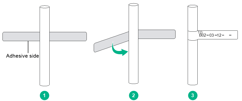

Generic labels
A generic label is bar-shaped with fixed dimensions. It is applicable to both signal cables and power cords. A mark "TO:" is located at the upper left corner in the right area of the label to identify the peer end of the cable on which the label is affixed. The meaning of the dividing lines is the same as labels for signal cables.
Figure10-3 Generic label
(1) Dividing line on the label
(2) Cut dotted line

Affixing a label to a signal cable

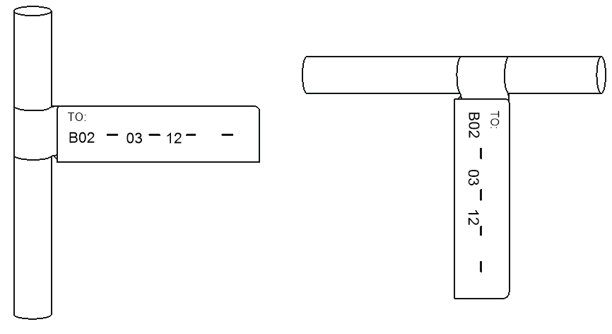

Typically, a label is affixed 2 cm (0.79 in) away from the connector on a signal cable. You can affix the label to other positions as needed. Figure10-4 shows how to affix a label when a cable is laid vertically.
Figure10-4 Affixing a label
Figure10-5 shows the affixed labels when the cable is laid vertically and horizontally.
Figure10-5 Affixed labels

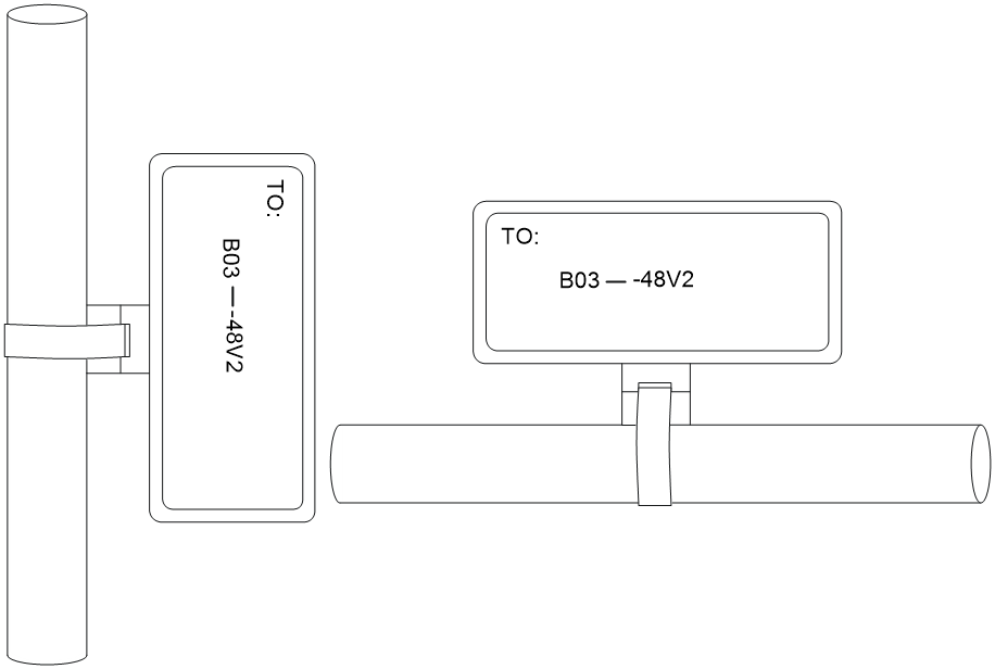

Affixing a label to a power cord
Stick the label to the recessed rectangular area on the identification plate. You can stick the label to either side of the identification plate. Be sure to affix the labels on the same side of the identification plates.
A cable tie is bundled 2 cm (0.79 in) away from the connector. You can affix the label to other positions as needed. Figure10-6 shows how to affix a label when a cable is laid horizontally.
Figure10-6 Affixing a label
Bind cable ties on both ends of a cable. After the bundling, the finished identification plate must be on top of the cable in horizontal cabling, or on the right side of the cable in vertical cabling. Make sure the label is facing out, as shown in Figure10-7.
Figure10-7 Affixed labels
Affixing a generic label
The requirements for affixing a generic label are the same as affixing a label on a signal cable. For more information, see "Affixing a label to a signal cable." For the example of affixed labels, see Figure10-8.
Figure10-8 Affixing a generic label

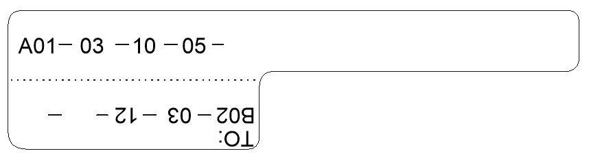

Engineering labels for network cables
These labels are affixed to Ethernet cables that connect modules in a chassis.

Figure10-9 Example of a label on an Ethernet cable
·     A01-03-10-05—The local end of the Ethernet cable is connected to Ethernet Port 05, Slot 10, Chassis 03 of the rack on Row A, Column 01 in the equipment room.
·     B02-03-12—The peer end of the Ethernet cable is connected to Ethernet Port 12, Chassis 03 of the rack on Row B, Column 02 in the equipment room.
