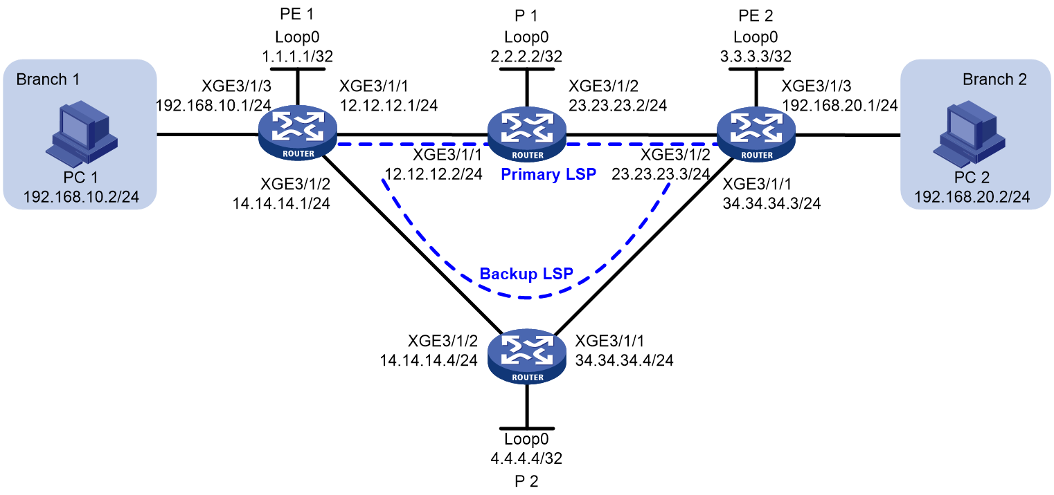

As shown in Figure 1, Branch 1 and Branch 2 of a company are connected to each other through an MPLS backbone of the ISP. The branches need to exchange real-time data.
To ensure high availability of the real-time service between the branches, deploy LDP FRR on the MPLS backbone to provide a primary LSP and a backup LSP. Configure BFD for the primary LSP, so when the primary LSP fails, BFD can quickly detect the failure and notify LDP of the failure to trigger a traffic switchover to the backup LSP.
Figure 1 Network diagram

1.     Assign IP addresses to interfaces:
# Assign an IP address to Ten-GigabitEthernet 3/1/1 on PE 1.
<PE1> system-view
[PE1] interface ten-gigabitethernet 3/1/1
[PE1-Ten-GigabitEthernet3/1/1] ip address 12.12.12.1 24
[PE1-Ten-GigabitEthernet3/1/1] quit
# Assign IP addresses to other interfaces (including the loopback interfaces) according to Figure 1. (Details not shown.)
2.     On the MPLS backbone, configure OSPF to ensure IP connectivity between the routers, and enable OSPF FRR.

2.     On PE 1, execute the tracert mpls ipv4 command to verify that the current LSP in use is the primary LSP. (To use the tracert feature, you must also enable sending of ICMP time exceeded messages on the transit devices and enable sending of ICMP destination unreachable messages on the destination device.)
<PE1>tracert mpls -a 192.168.10.1 ipv4 192.168.20.0 24
MPLS trace route FEC 192.168.20.0/24
  TTL   Replier            Time    Type      Downstream
  0                                Ingress   12.12.12.2/[1141]
  1     12.12.12.2         2 ms    Transit   23.23.23.3/[1141]
  2     23.23.23.3         2 ms    Egress

Example: Configuring BFD for an MPLS TE tunnel
As shown in Figure 2, Branch 1 and Branch 2 of a company are connected to each other through an MPLS TE tunnel. The branches need to exchange real-time data.
To ensure high availability of the real-time service between the branches, deploy CRLSP backup for the MPLS TE tunnel to provide a primary CRLSP and a backup CRLSP. Configure BFD for the MPLS TE tunnel, so when the primary CRLSP fails, BFD can quickly detect the failure and notify RSVP of the failure to trigger a traffic switchover to the backup CRLSP.
Figure 2 Network diagram

Configuration files
·     Router A:
ospf 1
 area 0.0.0.0
  network 1.1.1.1 0.0.0.0
  network 12.12.12.0 0.0.0.255
  network 14.14.14.0 0.0.0.255
  network 192.168.10.0 0.0.0.255
  mpls te enable
 mpls lsr-id 1.1.1.1
mpls te
explicit-path cr-lsp1
 nexthop index 1 12.12.12.2 include strict
explicit-path cr-lsp2
 nexthop index 1 14.14.14.4 include strict
rsvp
 mpls bfd enable
interface LoopBack0
 ip address 1.1.1.1 255.255.255.255
interface Ten-GigabitEthernet3/1/1
 port link-mode route
 ip address 12.12.12.1 255.255.255.0
 mpls enable
 mpls te enable
 rsvp enable
interface Ten-GigabitEthernet3/1/2
 ip address 14.14.14.1 255.255.255.0
 mpls enable
 mpls te enable
 rsvp enable
interface Ten-GigabitEthernet3/1/3
 ip address 192.168.10.1 255.255.255.0
interface Tunnel3 mode mpls-te
 ip address 9.1.1.1 255.255.255.0
 mpls te path preference 1 explicit-path cr-lsp1
 mpls te path preference 2 explicit-path cr-lsp2
 mpls te backup hot-standby
 mpls bfd
 destination 3.3.3.3
 ip route-static 192.168.20.0 24 Tunnel3 preference 1
·     Router B:
ospf 1
 area 0.0.0.0
  network 2.2.2.2 0.0.0.0
  network 23.23.23.0 0.0.0.255
  mpls te enable
 mpls lsr-id 2.2.2.2
mpls te
rsvp
interface LoopBack0
 ip address 2.2.2.2 255.255.255.255
 ip address 12.12.12.2 255.255.255.0
 mpls enable
 mpls te enable
 rsvp enable
 ip address 23.23.23.2 255.255.255.0
 mpls enable
 mpls te enable
 rsvp enable
·     Router C:
ospf 1
 area 0.0.0.0
  network 3.3.3.3 0.0.0.0
  network 34.34.34.0 0.0.0.255
  network 192.168.20.0 0.0.0.255
  mpls te enable
 mpls lsr-id 3.3.3.3
mpls te
 nexthop index 1 23.23.23.2 include strict
 nexthop index 1 34.34.34.4 include strict
rsvp
 mpls bfd enable
interface LoopBack0
 ip address 3.3.3.3 255.255.255.255
 ip address 34.34.34.3 255.255.255.0
 mpls enable
 mpls te enable
 rsvp enable
 ip address 23.23.23.3 255.255.255.0
 mpls enable
 mpls te enable
 rsvp enable
 ip address 192.168.20.1 255.255.255.0
 ip address 9.3.3.3 255.255.255.0
 mpls bfd
 destination 1.1.1.1
 ip route-static 192.168.10.0 24 Tunnel3 preference 1
·     Router D:
ospf 1
 area 0.0.0.0
  network 4.4.4.4 0.0.0.0
  mpls te enable
 mpls lsr-id 4.4.4.4
mpls te
rsvp
interface LoopBack0
 ip address 4.4.4.4 255.255.255.255
 ip address 34.34.34.4 255.255.255.0
 mpls enable
 mpls te enable
 rsvp enable
 ip address 14.14.14.4 255.255.255.0
 mpls enable
 mpls te enable
 rsvp enable
