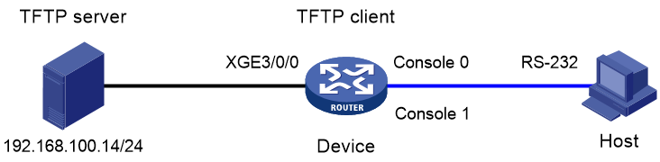

As shown in Figure 1, use TFTP to download a software upgrade file from a TFTP server to upgrade the device.
Figure 1 Network diagram

1.     Configure the TFTP server:
# Assign the IP address 192.168.100.14/24 to the TFTP server. (Details not shown.)
# Start the TFTP server and specify a working directory. (Details not shown.)

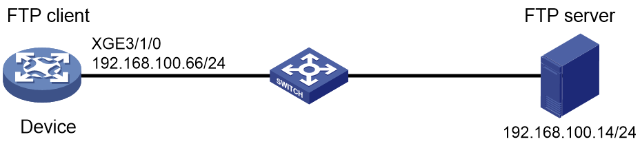

As shown in Figure 2, use FTP to download a software upgrade file from an FTP server to upgrade the device.
Figure 2 Network diagram

1.     Configure the FTP server:
# Assign the IP address 192.168.100.14/24 to the FTP server. (Details not shown.)
# Start the FTP server and specify a working directory. (Details not shown.)
# Add a local user account. (Details not shown.)
# Set the username to 123456 and the password to 123456 for the user account. (Details not shown.)

Example: Using the device as an FTP server to upgrade software
As shown in Figure 3, enable the FTP server and configure a local user account on the device to provide FTP service. Use FTP to upload a software upgrade file from an FTP client to upgrade the device.
Figure 3 Network diagram

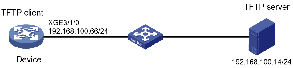

Example: Using the device as a TFTP client to upgrade software
As shown in Figure 4, the device cannot start up.
Use TFTP to upgrade the device from the BootWare menu.
Figure 4 Network diagram
