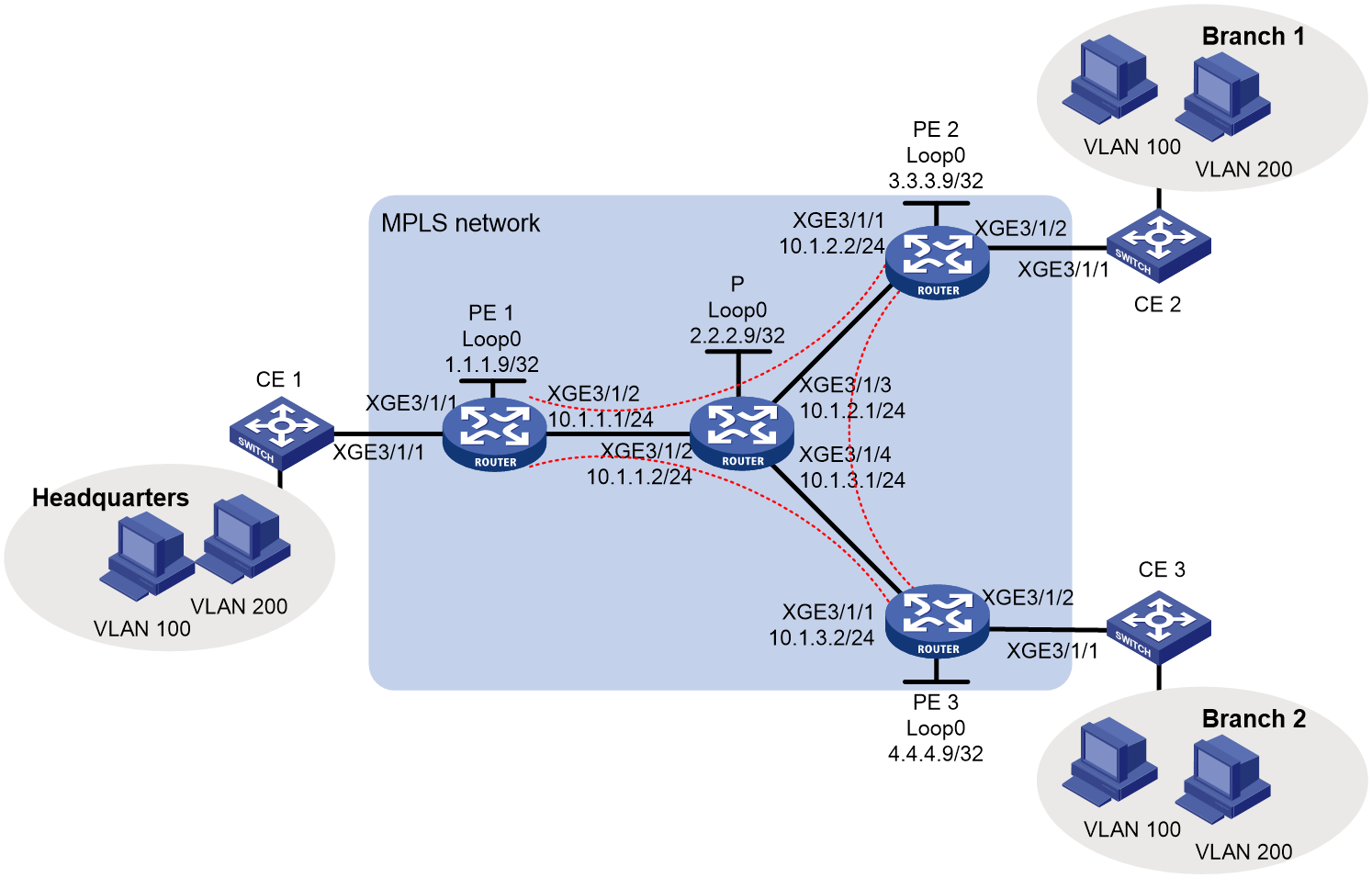

As shown in Figure 1, the MPLS network provides L2VPN services for a company. The company has a headquarters and two branches, and it will not add sites in the future.
Configure full-mesh VPLS using LDP signaling to allow communication among the three sites at Layer 2.
Figure 1 Network diagram
Analysis
To meet the network requirements, you must perform the following tasks:
·     To implement LDP VPLS over the MPLS backbone, you must perform the following tasks:
¡     Establish LDP LSPs on the MPLS backbone as public tunnels to deliver the private data over the MPLS network.
¡     Configure an LDP PW between any two PEs to forward data among the branches.
¡     Configure Layer 3 subinterfaces of the CE-facing interfaces on PEs to identify packets to be transported by VPLS.
·     To implement VLAN isolation among the sites, create VSIs user_a and user_b. Bind VSI user_a to the subinterface that matches packets of VLAN 100, and bind VSI user_b to the subinterface that matches packets of VLAN 200.

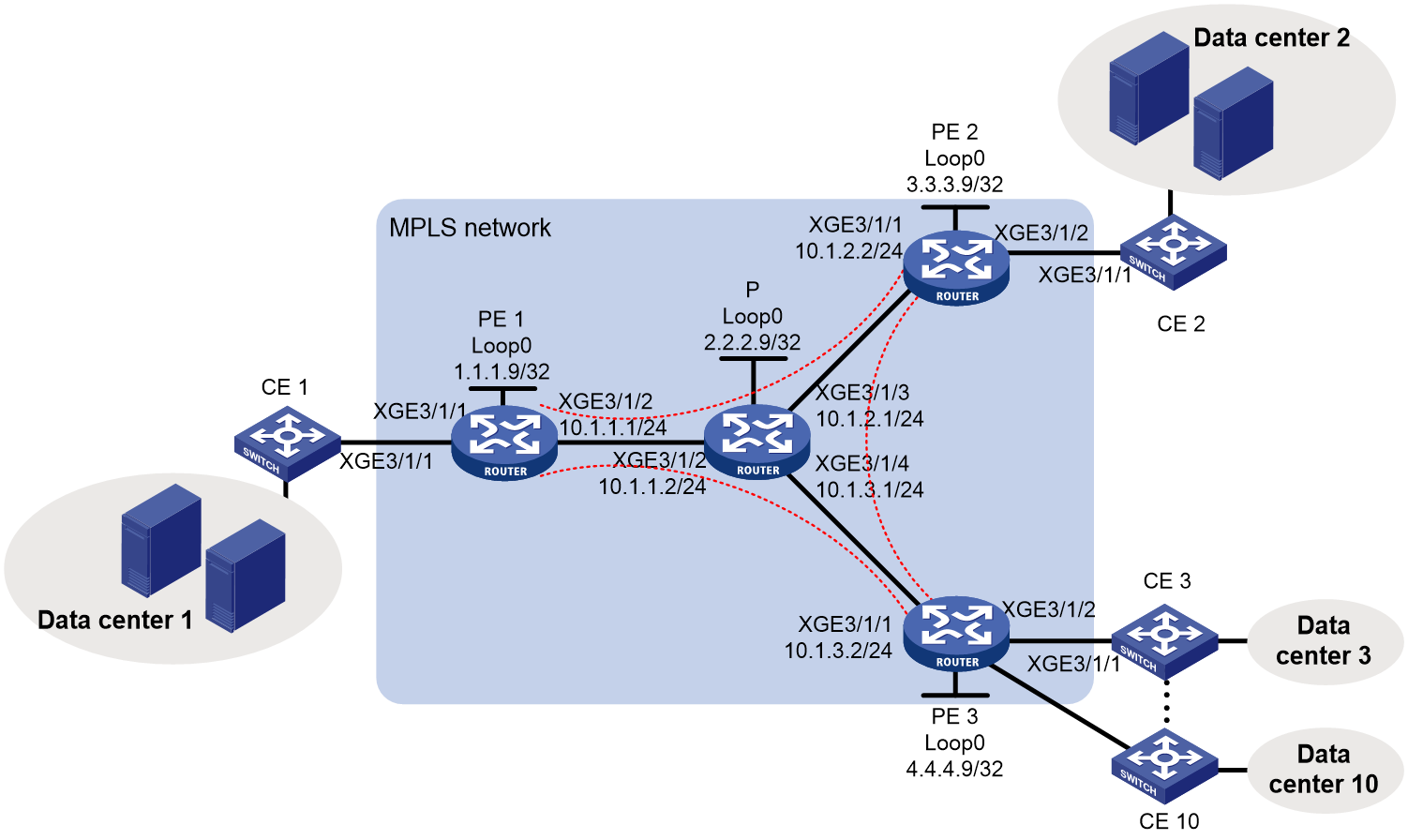

Example: Configuring full-mesh LDP VPLS using BGP auto-discovery
As shown in Figure 2, the MPLS network provides L2VPN services for a company. The company has a headquarters and a large number of branches, and it will not add sites in the future.
Configure full-mesh VPLS using BGP auto-discovery and LDP signaling to allow communication among all the sites at Layer 2.
Figure 2 Network diagram
Analysis
·     To implement LDP VPLS using BGP auto-discovery over the MPLS backbone, you must perform the following tasks:
¡     Configure a BGP auto-discovery LDP PW between any two PEs to forward data among the branches.

Example: Configuring full-mesh BGP VPLS
As shown in Figure 3, the MPLS network provides L2VPN services for a company. The company has 10 data centers and will add 15 data centers in the future.
Configure full-mesh VPLS using BGP signaling to allow communication among the data centers at Layer 2.
Figure 3 Network diagram
Analysis
·     To implement BGP VPLS over the MPLS backbone, you must perform the following tasks:
¡     Configure a BGP PW between any two PEs to forward data among the data centers.
¡     Configure subinterfaces and match criteria of the CE-facing interfaces on PEs to identify packets to be transported by VPLS.
·     For future expansion of the customer network, set the maximum number of sites in the VPN to 25.
Procedures
1.     Configure an IGP on the MPLS backbone to ensure IP connectivity within the backbone:
# On PE 1, configure an IP address for Loopback 0.
<PE1> system-view
[PE1] interface loopback 0
[PE1-LoopBack0] ip address 1.1.1.9 32
[PE1-LoopBack0] quit
# Configure an IP address for Ten-GigabitEthernet 3/1/2.
[PE1] interface ten-gigabitethernet 3/1/2
[PE1-Ten-GigabitEthernet3/1/2] ip address 10.1.1.1 24
[PE1-Ten-GigabitEthernet3/1/2] quit
# On PE 1, configure OSPF.
[PE1] ospf
[PE1-ospf-1] area 0
[PE1-ospf-1-area-0.0.0.0] network 10.1.1.0 0.0.0.255
[PE1-ospf-1-area-0.0.0.0] network 1.1.1.9 0.0.0.0
[PE1-ospf-1-area-0.0.0.0] quit
[PE1-ospf-1] quit
# On PE 2, configure an IP address for Loopback 0.
<PE2> system-view
[PE2] interface loopback 0
[PE2-LoopBack0] ip address 3.3.3.9 32
[PE2-LoopBack0] quit
# Configure an IP address for Ten-GigabitEthernet 3/1/1.
[PE2] interface ten-gigabitethernet 3/1/1
[PE2-Ten-GigabitEthernet3/1/1] ip address 10.1.2.2 24
[PE2-Ten-GigabitEthernet3/1/1] quit
# On PE 2, configure OSPF.
[PE2] ospf
[PE2-ospf-1] area 0
[PE2-ospf-1-area-0.0.0.0] network 10.1.2.0 0.0.0.255
[PE2-ospf-1-area-0.0.0.0] network 3.3.3.9 0.0.0.0
[PE2-ospf-1-area-0.0.0.0] quit
[PE2-ospf-1] quit
# On PE 3, configure an IP address for Loopback 0.
<PE3> system-view
[PE3] interface loopback 0
[PE3-LoopBack0] ip address 4.4.4.9 32
[PE3-LoopBack0] quit
[PE3] interface ten-gigabitethernet 3/1/1
[PE3-Ten-GigabitEthernet3/1/1] ip address 10.1.3.2 24
[PE3-Ten-GigabitEthernet3/1/1] quit
# On PE 3, configure OSPF.
[PE3] ospf
[PE3-ospf-1] area 0
[PE3-ospf-1-area-0.0.0.0] network 10.1.3.0 0.0.0.255
[PE3-ospf-1-area-0.0.0.0] network 4.4.4.9 0.0.0.0
[PE3-ospf-1-area-0.0.0.0] quit
[PE3-ospf-1] quit
# On P, configure an IP address for Loopback 0.
<P> system-view
[P] interface loopback 0
[P-LoopBack0] ip address 2.2.2.9 32
[P-LoopBack0] quit
[P] interface ten-gigabitethernet 3/1/2
[P-Ten-GigabitEthernet3/1/2] ip address 10.1.1.2 24
[P-Ten-GigabitEthernet3/1/2] quit
# Configure an IP address for Ten-GigabitEthernet 3/1/3.
[P] interface ten-gigabitethernet 3/1/3
[P-Ten-GigabitEthernet3/1/3] ip address 10.1.2.1 24
[P-Ten-GigabitEthernet3/1/3] quit
# Configure an IP address for Ten-GigabitEthernet 3/1/4.
[P] interface ten-gigabitethernet 3/1/4
[P-Ten-GigabitEthernet3/1/4] ip address 10.1.3.1 24
[P-Ten-GigabitEthernet3/1/4] quit
# On P, configure OSPF.
[P] ospf
[P-ospf-1] area 0
[P-ospf-1-area-0.0.0.0] network 10.1.1.0 0.0.0.255
[P-ospf-1-area-0.0.0.0] network 10.1.2.0 0.0.0.255
[P-ospf-1-area-0.0.0.0] network 10.1.3.0 0.0.0.255
[P-ospf-1-area-0.0.0.0] network 2.2.2.9 0.0.0.0
[P-ospf-1-area-0.0.0.0] quit
[P-ospf-1] quit
2.     Configure basic MPLS and MPLS LDP on the MPLS backbone to establish LDP LSPs:
# On PE 1, configure an LSR ID.
[PE1] mpls lsr-id 1.1.1.9
# On PE 1, enable LDP globally.
[PE1] mpls ldp
[PE1-ldp] quit
# On PE 1, enable MPLS and LDP on Ten-GigabitEthernet 3/1/2.
[PE1-Ten-GigabitEthernet3/1/2] mpls enable
[PE1-Ten-GigabitEthernet3/1/2] mpls ldp enable
# On PE 2, configure an LSR ID.
[PE2] mpls lsr-id 3.3.3.9
# On PE 2, enable LDP globally.
[PE2] mpls ldp
[PE2-ldp] quit
# On PE 2, enable MPLS and LDP on Ten-GigabitEthernet 3/1/1.
[PE2-Ten-GigabitEthernet3/1/1] mpls enable
[PE2-Ten-GigabitEthernet3/1/1] mpls ldp enable
# On PE 3, configure an LSR ID.
[PE3] mpls lsr-id 4.4.4.9
# On PE 3, enable LDP globally.
[PE3] mpls ldp
[PE3-ldp] quit
# On PE 3, enable MPLS and LDP on Ten-GigabitEthernet 3/1/1.
[PE3-Ten-GigabitEthernet3/1/1] mpls enable
[PE3-Ten-GigabitEthernet3/1/1] mpls ldp enable
# On P, configure an LSR ID.
[P] mpls lsr-id 2.2.2.9
# On P, enable LDP globally.
[P] mpls ldp
[P-ldp] quit
# On P, enable MPLS and LDP on Ten-GigabitEthernet 3/1/2.
[P-Ten-GigabitEthernet3/1/2] mpls enable
[P-Ten-GigabitEthernet3/1/2] mpls ldp enable
# On P, enable MPLS and LDP on Ten-GigabitEthernet 3/1/3.
[P-Ten-GigabitEthernet3/1/3] mpls enable
[P-Ten-GigabitEthernet3/1/3] mpls ldp enable
# On P, enable MPLS and LDP on Ten-GigabitEthernet 3/1/4.
[P-Ten-GigabitEthernet3/1/4] mpls enable
[P-Ten-GigabitEthernet3/1/4] mpls ldp enable
3.     Configure VSIs and BGP PWs:
# On PE 1, establish IBGP connections to PE 2 and PE 3.
[PE1] bgp 100
[PE1-bgp] peer 3.3.3.9 as-number 100
[PE1-bgp] peer 3.3.3.9 connect-interface loopback 0
[PE1-bgp] peer 4.4.4.9 as-number 100
[PE1-bgp] peer 4.4.4.9 connect-interface loopback 0
# On PE 1, enable BGP to exchange L2VPN information with the peers.
[PE1-bgp] address-family l2vpn
[PE1-bgp-l2vpn] peer 3.3.3.9 enable
[PE1-bgp-l2vpn] peer 4.4.4.9 enable
[PE1-bgp-l2vpn] quit
[PE1-bgp] quit
# On PE 1, enable MPLS L2VPN globally.
[PE1] l2vpn enable
# On PE 1, create VSI user_a and enable the VSI to automatically discover neighbors through BGP.
[PE1] vsi user_a
[PE1-vsi-user_a] auto-discovery bgp
# On PE 1, configure an RD and route targets for the VSI.
[PE1-vsi-user_a-auto] route-distinguisher 100:1
[PE1-vsi-user_a-auto] vpn-target 111:1
# On PE 1, use BGP to establish a PW to a remote PE discovered by BGP.
[PE1-vsi-user_a-auto] signaling-protocol bgp
# On PE 1, set the site number in the VSI to 1 and the maximum number of sites in the VSI to 25.
[PE1-vsi-user_a-auto-bgp] site 1 range 25
[PE1-vsi-user_a-auto-bgp] quit
[PE1-vsi-user_a-auto] quit
[PE1-vsi-user_a] quit
# On PE 1, create VSI user_b and enable the VSI to automatically discover neighbors through BGP.
[PE1] vsi user_b
[PE1-vsi-user_b] auto-discovery bgp
[PE1-vsi-user_b-auto] route-distinguisher 100:1
[PE1-vsi-user_b-auto] vpn-target 111:1
[PE1-vsi-user_b-auto] signaling-protocol bgp
[PE1-vsi-user_b-auto-bgp] site 1 range 25
[PE1-vsi-user_b-auto-bgp] quit
[PE1-vsi-user_b-auto] quit
[PE1-vsi-user_b] quit
# On PE 2, establish IBGP connections to PE 1 and PE 3.
[PE2] bgp 100
[PE2-bgp] peer 1.1.1.9 as-number 100
[PE2-bgp] peer 1.1.1.9 connect-interface loopback 0
[PE2-bgp] peer 4.4.4.9 as-number 100
[PE2-bgp] peer 4.4.4.9 connect-interface loopback 0
# On PE 2, enable BGP to exchange L2VPN information with the peers.
[PE2-bgp] address-family l2vpn
[PE2-bgp-l2vpn] peer 1.1.1.9 enable
[PE2-bgp-l2vpn] peer 4.4.4.9 enable
[PE2-bgp-l2vpn] quit
[PE2-bgp] quit
# On PE 2, enable MPLS L2VPN globally.
[PE2] l2vpn enable
# On PE 2, create VSI user_a and enable the VSI to automatically discover neighbors through BGP.
[PE2] vsi user_a
[PE2-vsi-user_a] auto-discovery bgp
# On PE 2, configure an RD and route targets for the VSI.
[PE2-vsi-user_a-auto] route-distinguisher 100:1
[PE2-vsi-user_a-auto] vpn-target 111:1
# On PE 2, use BGP to establish a PW to a remote PE discovered by BGP.
[PE2-vsi-user_a-auto] signaling-protocol bgp
# On PE 2, set the site number in the VSI to 2 and the maximum number of sites in the VSI to 25.
[PE2-vsi-user_a-auto-bgp] site 2 range 25
[PE2-vsi-user_a-auto-bgp] quit
[PE2-vsi-user_a-auto] quit
[PE2-vsi-user_a] quit
# On PE 2, create VSI user_b and enable the VSI to automatically discover neighbors through BGP.
[PE2] vsi user_b
[PE2-vsi-user_b] auto-discovery bgp
[PE2-vsi-user_b-auto] route-distinguisher 200:1
[PE2-vsi-user_b-auto] vpn-target 222:1
[PE2-vsi-user_b-auto] signaling-protocol bgp
[PE2-vsi-user_b-auto-bgp] site 2 range 25
[PE2-vsi-user_b-auto-bgp] quit
[PE2-vsi-user_b-auto] quit
[PE2-vsi-user_b] quit
# On PE 3, establish IBGP connections to PE 1 and PE 2.
[PE3] bgp 100
[PE3-bgp] peer 1.1.1.9 as-number 100
[PE3-bgp] peer 1.1.1.9 connect-interface loopback 0
[PE3-bgp] peer 3.3.3.9 as-number 100
[PE3-bgp] peer 3.3.3.9 connect-interface loopback 0
# On PE 3, enable BGP to exchange L2VPN information with the peers.
[PE3-bgp] address-family l2vpn
[PE3-bgp-l2vpn] peer 1.1.1.9 enable
[PE3-bgp-l2vpn] peer 3.3.3.9 enable
[PE3-bgp-l2vpn] quit
[PE3-bgp] quit
# On PE 3, enable MPLS L2VPN globally.
[PE3] l2vpn enable
# On PE 3, create VSI user_a and enable the VSI to automatically discover neighbors through BGP.
[PE3] vsi user_a
[PE3-vsi-user_a] auto-discovery bgp
# On PE 3, configure an RD and route targets for the VSI.
[PE3-vsi-user_a-auto] route-distinguisher 100:1
[PE3-vsi-user_a-auto] vpn-target 111:1
# On PE 3, use BGP to establish a PW to a remote PE discovered by BGP.
[PE3-vsi-user_a-auto] signaling-protocol bgp
# On PE 3, set the site number in the VSI to 3 and the maximum number of sites in the VSI to 25.
[PE3-vsi-user_a-auto-bgp] site 3 range 25
[PE3-vsi-user_a-auto-bgp] quit
[PE3-vsi-user_a-auto] quit
[PE3-vsi-user_a] quit
# Enable MPLS L2VPN globally.
[PE3] l2vpn enable
# On PE 3, create VSI user_b and enable the VSI to automatically discover neighbors through BGP.
[PE3] vsi user_b
[PE3-vsi-user_b] auto-discovery bgp
[PE3-vsi-user_b-auto] route-distinguisher 200:1
[PE3-vsi-user_b-auto] vpn-target 222:1
[PE3-vsi-user_b-auto] signaling-protocol bgp
[PE3-vsi-user_b-auto-bgp] site 3 range 25
[PE3-vsi-user_b-auto-bgp] quit
[PE3-vsi-user_b-auto] quit
[PE3-vsi-user_b] quit
4.     Configure Layer 3 subinterfaces for different VLANs and bind the subinterfaces to VSIs:
# On PE 1, create subinterface Ten-GigabitEthernet3/1/1.100, configure the subinterface to terminate packets whose outermost VLAN ID is 100, and bind the subinterface to VSI user_a.
[PE1] interface ten-gigabitethernet 3/1/1.100
[PE1-Ten-GigabitEthernet3/1/1.100] vlan-type dot1q vid 100
[PE1-Ten-GigabitEthernet3/1/1.100] xconnect vsi user_a
[PE1-Ten-GigabitEthernet3/1/1.100] quit
# On PE 1, create subinterface Ten-GigabitEthernet3/1/1.200, configure the subinterface to terminate packets whose outermost VLAN ID is 200, and bind the subinterface to VSI user_b.
[PE1] interface ten-gigabitethernet 3/1/1.200
[PE1-Ten-GigabitEthernet3/1/1.200] vlan-type dot1q vid 200
[PE1-Ten-GigabitEthernet3/1/1.200] xconnect vsi user_b
[PE1-Ten-GigabitEthernet3/1/1.200] quit
# On PE 2, create subinterface Ten-GigabitEthernet3/1/2.100, configure the subinterface to terminate packets whose outermost VLAN ID is 100, and bind the subinterface to VSI user_a.
[PE2] interface ten-gigabitethernet 3/1/2.100
[PE2-Ten-GigabitEthernet3/1/2.100] vlan-type dot1q vid 100
[PE2-Ten-GigabitEthernet3/1/2.100] xconnect vsi user_a
[PE2-Ten-GigabitEthernet3/1/2.100] quit
# On PE 2, create subinterface Ten-GigabitEthernet3/1/2.200, configure the subinterface to terminate packets whose outermost VLAN ID is 200, and bind the subinterface to VSI user_b.
[PE2] interface ten-gigabitethernet 3/1/2.200
[PE2-Ten-GigabitEthernet3/1/1.200] vlan-type dot1q vid 200
[PE2-Ten-GigabitEthernet3/1/2.200] xconnect vsi user_b
[PE2-Ten-GigabitEthernet3/1/2.200] quit
# On PE 3, create subinterface Ten-GigabitEthernet3/1/2.100, configure the subinterface to terminate packets whose outermost VLAN ID is 100, and bind the subinterface to VSI user_a.
[PE3] interface ten-gigabitethernet 3/1/2.100
[PE3-Ten-GigabitEthernet3/1/2.100] vlan-type dot1q vid 100
[PE3-Ten-GigabitEthernet3/1/2.100] xconnect vsi user_a
[PE3-Ten-GigabitEthernet3/1/2.100] quit
# On PE 3, create subinterface Ten-GigabitEthernet3/1/2.200, configure the subinterface to terminate packets whose outermost VLAN ID is 200, and bind the subinterface to VSI user_b.
[PE3] interface ten-gigabitethernet 3/1/2.200
[PE3-Ten-GigabitEthernet3/1/2.200] vlan-type dot1q vid 200
[PE3-Ten-GigabitEthernet3/1/2.200] xconnect vsi user_b
[PE3-Ten-GigabitEthernet3/1/2.200] quit
# On PE 3, configure other CE-facing interfaces in the same way that Ten-GigabitEthernet3/1/2 is configured. (Details not shown.)
5.     Allow CE access to PEs:
# On CE 1, configure the interface connected to the PE to permit tagged packets from the customer VLANs.
<CE1> system-view
[CE1] vlan 100
[CE1-vlan100] quit
[CE1] vlan 200
[CE1-vlan200] quit
[CE1] interface ten-gigabitethernet 3/1/1
[CE1-Ten-GigabitEthernet3/1/1] port link-type trunk
[CE1-Ten-GigabitEthernet3/1/1] port trunk permit vlan 100 200
# Configure other CEs in the same way that CE 1 is configured. (Details not shown.)
# Verify that LDP LSPs have been established on each switch in the MPLS network. This example uses PE 1.
[PE1] display mpls ldp lsp
VPN instance: public instance
Status Flags: * - stale, L - liberal, B - backup, N/A – unavailable

# Verify BGP PWs in up state have been established on each PE. This example uses PE 1.
[PE1] display l2vpn pw
Flags: M - main, B - backup, E - ecmp, BY - bypass, H - hub link, S - spoke link
       N - no split horizon, A – administration, ABY – ac-bypass
       PBY – pw-bypass
Total number of PWs: 4
4 up, 0 blocked, 0 down, 0 defect, 0 idle, 0 duplicate
VSI Name: user_a
Peer            PWID/RmtSite/SrvID In/Out Label   Proto  Flag Link ID  State
3.3.3.9         2                  131074/131073  BGP    M    257      Up
4.4.4.9         3                  131075/131073  BGP    M    258      Up
VSI Name: user_b
3.3.3.9         2                  131071/131070  BGP    M    257      Up
4.4.4.9         3                  131072/131070  BGP    M    258      Up
# Verify that hosts in the same VLAN but different sites can ping each other. (Details not shown.)
Configuration files
·     PE 1:
ospf 1
 area 0.0.0.0
 mpls lsr-id 1.1.1.9
mpls ldp
 l2vpn enable
vsi user_a
 auto-discovery bgp
  vpn-target 111:1 export-extcommunity
  vpn-target 111:1 import-extcommunity
   site 1 range 25 default-offset 0
vsi user_b
 auto-discovery bgp
  vpn-target 222:1 export-extcommunity
  vpn-target 222:1 import-extcommunity
interface LoopBack0
 ip address 1.1.1.9 255.255.255.255
 port link-mode route
 xconnect vsi user_a
 xconnect vsi user_b
 mpls enable
 mpls ldp enable
bgp 100
 peer 3.3.3.9 connect-interface LoopBack0
 peer 4.4.4.9 connect-interface LoopBack0
  peer 3.3.3.9 enable
  peer 4.4.4.9 enable
·     PE 2:
ospf 1
 area 0.0.0.0
 mpls lsr-id 3.3.3.9
mpls ldp
 l2vpn enable
vsi user_a
 auto-discovery bgp
   site 2 range 25 default-offset 0
vsi user_b
 auto-discovery bgp
interface LoopBack0
 ip address 3.3.3.9 255.255.255.255
 ip address 10.1.2.2 255.255.255.0
 mpls enable
 mpls ldp enable
 xconnect vsi user_a
 xconnect vsi user_b
bgp 100
 peer 1.1.1.9 connect-interface LoopBack0
  peer 1.1.1.9 enable
  peer 4.4.4.9 enable
·     PE 3:
ospf 1
 area 0.0.0.0
 mpls lsr-id 4.4.4.9
mpls ldp
 l2vpn enable
vsi user_a
 auto-discovery bgp
   site 3 range 25 default-offset 0
vsi user_b
 auto-discovery bgp
interface LoopBack0
 ip address 4.4.4.9 255.255.255.255
 ip address 10.1.3.2 255.255.255.0
 mpls enable
 mpls ldp enable
 xconnect vsi user_a
 xconnect vsi user_b
bgp 100
  peer 1.1.1.9 enable
  peer 3.3.3.9 enable
·     P:
ospf 1
 area 0.0.0.0
 mpls lsr-id 2.2.2.9
mpls ldp
interface LoopBack0
 ip address 2.2.2.9 255.255.255.255
 ip address 10.1.1.2 255.255.255.0
 mpls enable
 mpls ldp enable
interface Ten-GigabitEthernet3/1/3
 ip address 10.1.2.1 255.255.255.0
 mpls enable
 mpls ldp enable
 ip address 10.1.3.1 255.255.255.0
 mpls enable
 mpls ldp enable
·     CE 1 through CE 10:
vlan 100
vlan 200
 port link-mode bridge
Example: Configuring H-VPLS with LSP access
