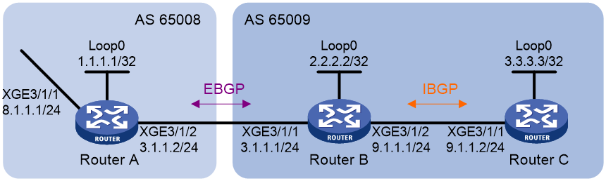

Example: Configuring basic BGP
As shown in Figure 1, all routers run BGP. Run EBGP between Router A and Router B, and run IBGP between Router B and Router C so that Router C can access the network 8.1.1.0/24 connected to Router A.
Figure 1 Network diagram
Analysis
To enable Router B to communicate with Router C through loopback interfaces, enable OSPF in AS 65009.
By default, BGP does not advertise local networks. To enable Router C to access the network 8.1.1.0/24 connected directly to Router A, perform the following tasks:
·     Add network 8.1.1.0/24 to the BGP routing table of Router A.
·     Add networks 3.1.1.0/24 and 9.1.1.0/24 to the BGP routing table of Router B.
When you configure basic BGP, follow these restrictions and guidelines:
·     Use loopback interfaces to establish IBGP connections to prevent route flapping caused by port state changes.
·     Loopback interfaces are virtual interfaces. Use the peer connect-interface command to specify the loopback interface as the source interface for establishing BGP connections.
·     The EBGP peers, Router A and Router B, are located in different ASs. Typically, their loopback interfaces are not reachable to each other, so the routers use directly connected interfaces to establish EBGP sessions.

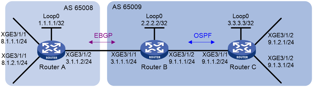

Examples: Configuring BGP and IGP route redistribution
As shown in Figure 2, all devices of company A belong to AS 65008 and all devices of company B belong to AS 65009. Run EBGP between Router A and Router B, and run OSPF between Router B and Router C to allow communication only between networks 9.1.2.0/24 and 8.1.1.0/24.
Figure 2 Network diagram
Analysis
To enable Router A to obtain the route to 9.1.2.0/24, configure BGP to redistribute routes from OSPF on Router B. To enable Router C to obtain the route to 8.1.1.0/24, configure OSPF to redistribute routes from BGP on Router B.

3.     Configure the EBGP connection and add network 8.1.1.0/24 to the BGP routing table of Router A:
# Configure Router A.
<RouterA> system-view
[RouterA] bgp 65008
[RouterA-bgp-default] router-id 1.1.1.1
[RouterA-bgp-default] peer 3.1.1.1 as-number 65009
[RouterA-bgp-default] address-family ipv4 unicast
[RouterA-bgp-default-ipv4] peer 3.1.1.1 enable
[RouterA-bgp-default-ipv4] network 8.1.1.0 24
[RouterA-bgp-default-ipv4] quit
[RouterA-bgp-default] quit
# Configure Router B.
[RouterB] bgp 65009
[RouterB-bgp-default] router-id 2.2.2.2
[RouterB-bgp-default] peer 3.1.1.2 as-number 65008
[RouterB-bgp-default] address-family ipv4 unicast
[RouterB-bgp-default-ipv4] peer 3.1.1.2 enable
4.     Configure BGP and IGP route redistribution:
# Configure route redistribution between BGP and OSPF on Router B.
[RouterB-bgp-default-ipv4] import-route ospf 1
[RouterB-bgp-default-ipv4] quit
[RouterB-bgp-default] quit
[RouterB] ospf 1
[RouterB-ospf-1] import-route bgp
[RouterB-ospf-1] quit
# Display the BGP routing table on Router A.
[RouterA] display bgp routing-table ipv4
 Total number of routes: 3
 BGP local router ID is 1.1.1.1
 Status codes: * - valid, > - best, d - dampened, h - history
               s - suppressed, S - stale, i - internal, e – external
               a - additional-path
       Origin: i - IGP, e - EGP, ? - incomplete
     Network            NextHop         MED        LocPrf     PrefVal Path/Ogn
* >  8.1.1.0/24         8.1.1.1         0                     32768   i
* >e 9.1.2.0/24         3.1.1.1         1                     0       65009?
The output shows that Router A has obtained the route to 9.1.2.0/24.
# Display the OSPF routing table on Router C.
[RouterC] display ospf routing
          OSPF Process 1 with Router ID 3.3.3.3
                   Routing Table
                Topology base (MTID 0)
 Routing for Network
 Destination        Cost     Type    NextHop         AdvRouter       Area
 9.1.1.0/24         1        Transit 9.1.1.2         3.3.3.3         0.0.0.0
9.1.2.0/24         1        Stub    9.1.2.1         192.168.0.63    0.0.0.0
 2.2.2.2/32         1        Stub    9.1.1.1         2.2.2.2         0.0.0.0
 Routing for ASEs
 Destination        Cost     Type    Tag         NextHop         AdvRouter
 8.1.1.0/24         1        Type2   1           9.1.1.1         2.2.2.2
 Total Nets: 3
 Intra Area: 2  Inter Area: 0  ASE: 1  NSSA: 0
The output shows that Router C has obtained the route to 8.1.1.0/24.
# Verify that 8.1.1.1 can ping 9.1.2.1.
[RouterA] ping -a 8.1.1.1 9.1.2.1
Ping 9.1.2.1 (9.1.2.1) from 8.1.1.1: 56 data bytes, press CTRL_C to break
56 bytes from 9.1.2.1: icmp_seq=0 ttl=254 time=10.000 ms
56 bytes from 9.1.2.1: icmp_seq=1 ttl=254 time=12.000 ms
